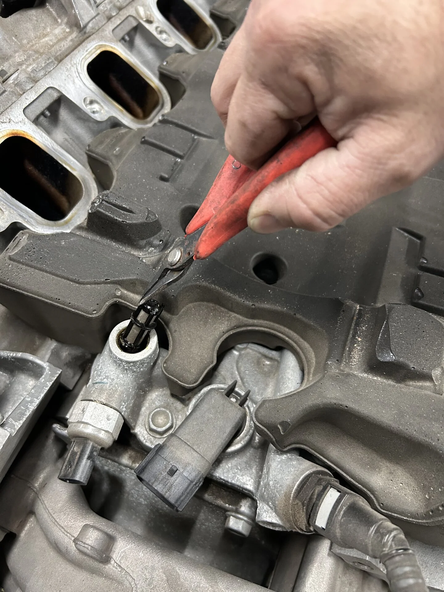

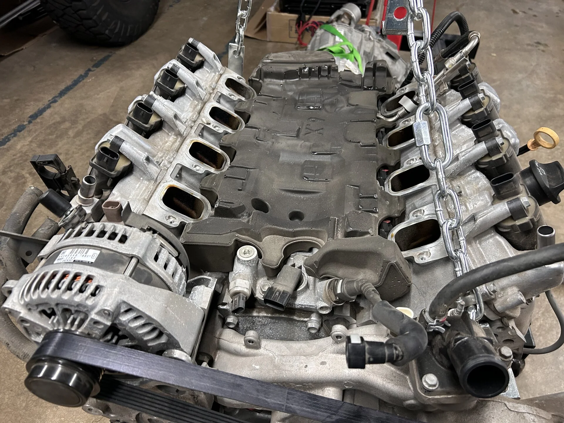

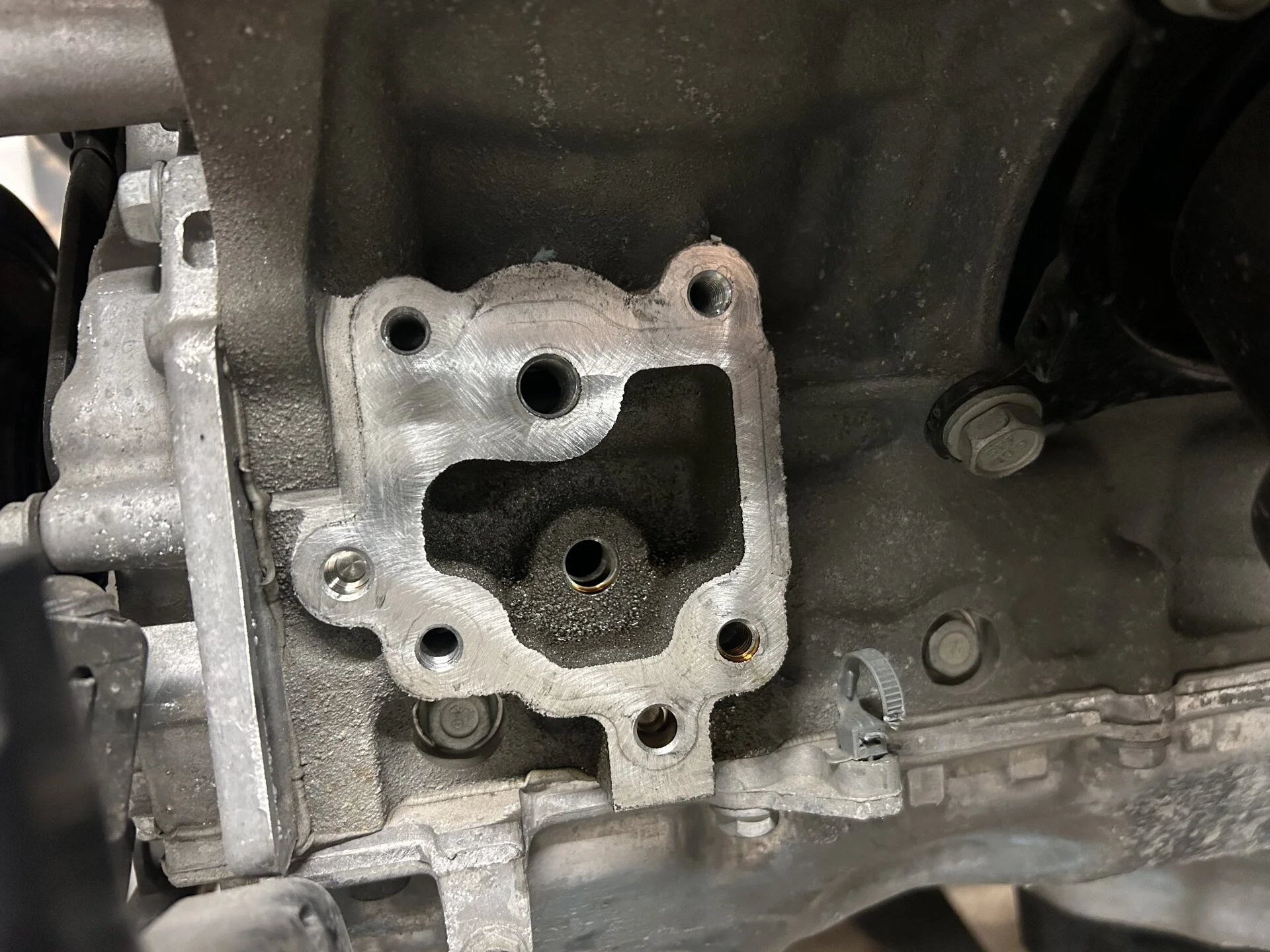

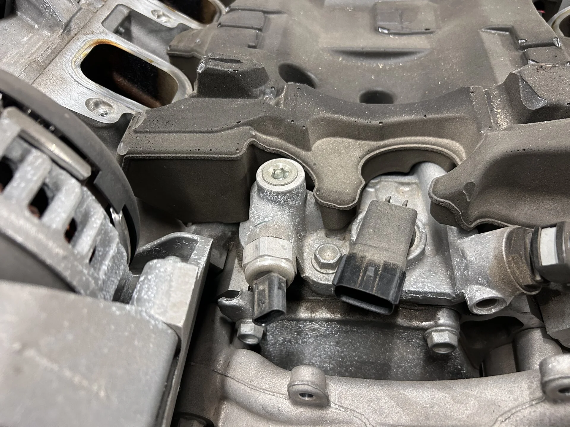

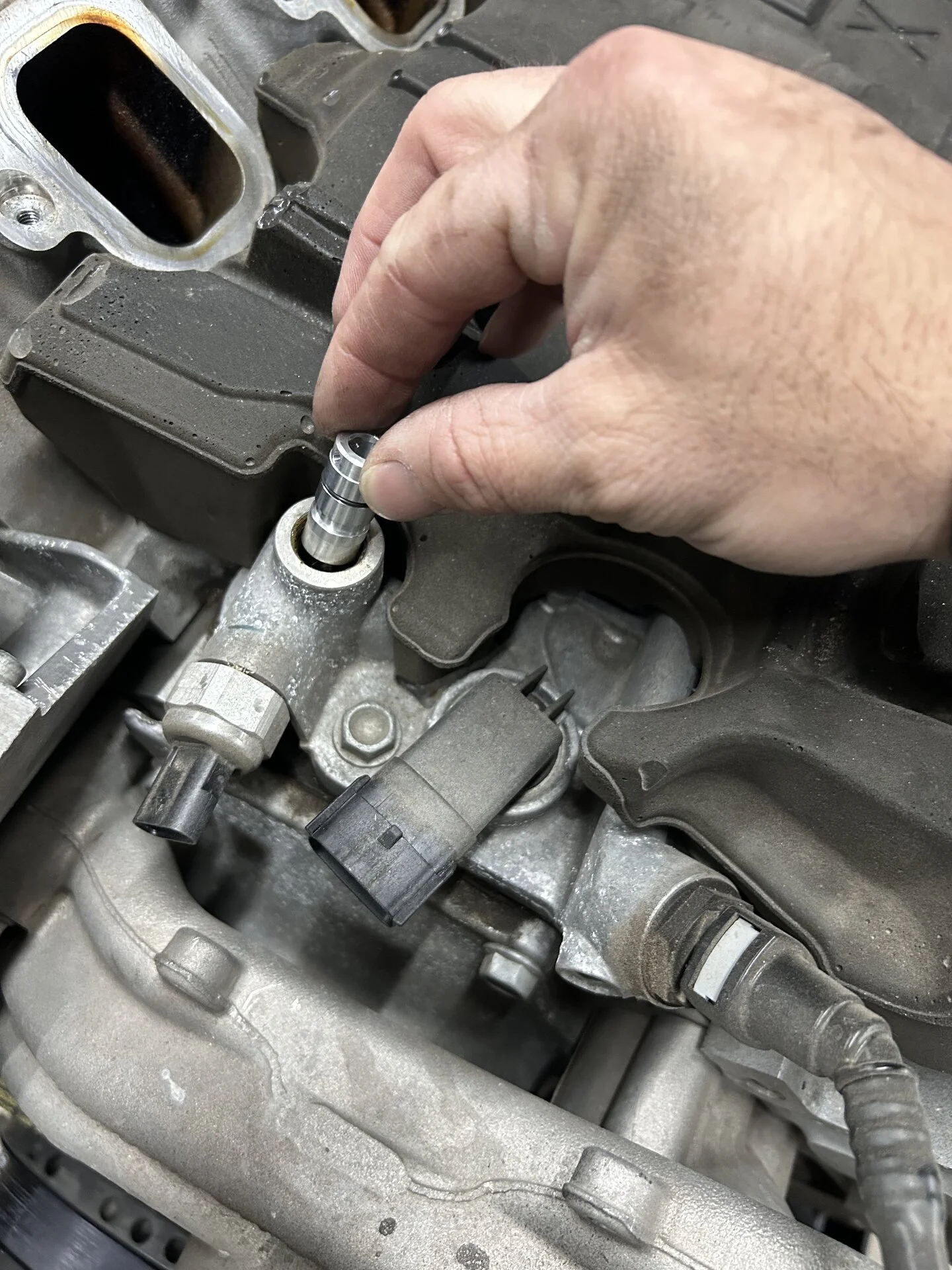

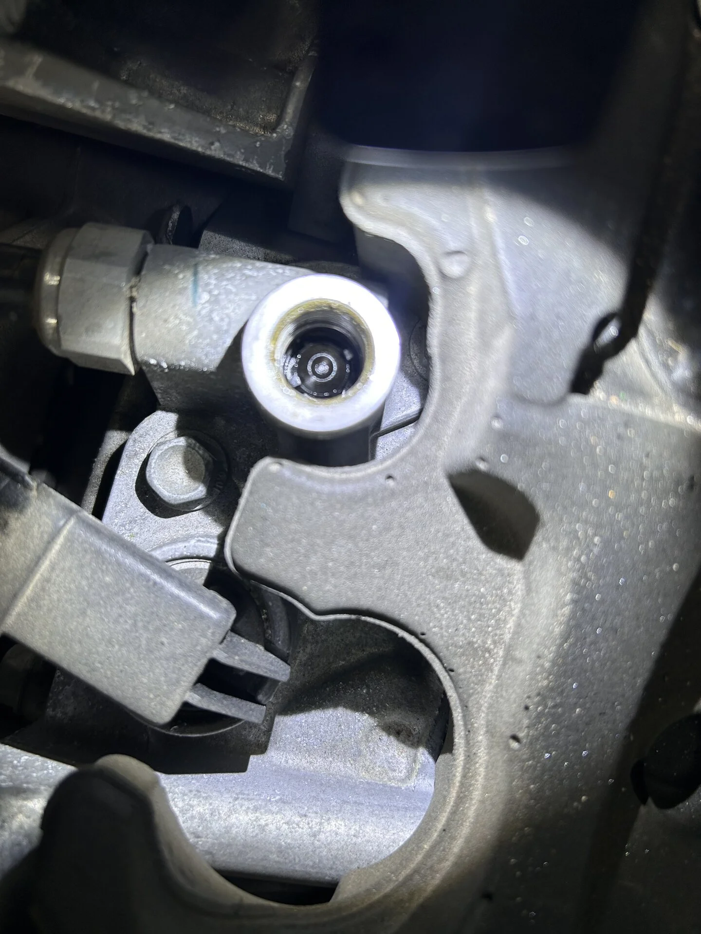

Next up was an AFM oil restrictor plug which is installed below the intake into the VLOM. This keeps the hydrolic lifters, which unlock/lock during AFM from activiating and collapsing. This plus having SWAPTIME delete AFM from the tune means is a cheap way to hopefully avoid lifter failure.
Pull intake, pull big Allen plug behind oil pressure sensor, pull screen out, drop in restrictor plug, reassemble
Is the idea here with the programming + essentially a plug blocking all the lifters, you aren't going the more mechanical route of putting in 8 plugs further downstream?
Where did you get that plug insert?Next up was an AFM oil restrictor plug which is installed below the intake into the VLOM. This keeps the hydrolic lifters, which unlock/lock during AFM from activiating and collapsing. This plus having SWAPTIME delete AFM from the tune means is a cheap way to hopefully avoid lifter failure.

Trailen DesignsWhere did you get that plug insert?
Is that the right name? Not finding anything.Trailen Designs
It looks like it's kind of a more sophisticatedly designed version of this? VLOM Oil Galley Feed Plug | Crazed Performance R - https://www.crazedperformancerepair.com/product-page/vlom-oil-galley-feed-plug
Thanks! They’ve gotta work on their SEO.
