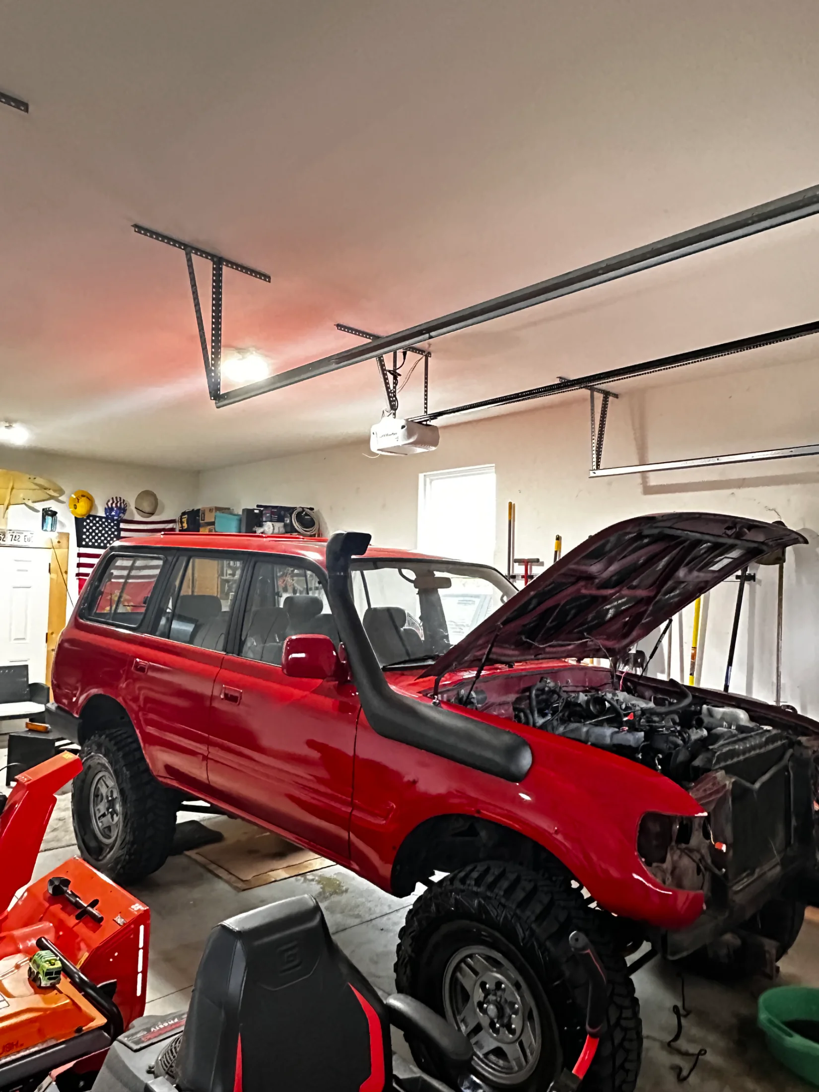

Hello everyone!
First post, so I apologize if it’s long, and not in the right place. I bought a 91fj80 almost a year ago and I love it, my kids love getting taken to school in it, and I enjoy using it as an errand runner around town. It has been a love hate relationship with the original 3fe. When I bought it you could tell it was being held together with bandaids and bubble gum, but it held together none the less. last week it finally decided to kick the bucket, and I am unsure of what to do next. I fully intend to replace it with a 2UZ. That being said I am a little over my head in this as I have never done an engine swap. If I understand right, I need the OEM harness and ECM for the 2UZ and the A340F trans. As well as a stand alone harness to integrate them to the dash harness. But I am unsure of what will and will not work as well as what else I need to make this happen. Also what I should update while have the engine out. My other issue is I am located in Wisconsin, and I am very far away from any useful specialty shops, so it appears I am on my own. Any help is GREATLY appreciated.

I never thought amount the marine angle that’s a good out the box idea! I would like to stay with an automatic (I know manual is is always better) but out of convenience I want an automatic. I was going to also install the delta vs pro harness wiring kit, and dual battery set up to cut down on the old wiring.

Not 100% sure what happened I’ve noticed that it’s been a little sluggish the last couple of weeks and started sounding a little rough. I was driving home from the store and stopped at a stop sign. Started knocking and sputtering when I pressed the throttle. Had no power and wouldn’t stay running unless I pressed the pedal (eventually stopped running all together). Also ran extremely hot, which has never happened before.

Well since we are being so forward, I don’t really care or want to save the 3FE. It leaks oil from just about everywhere, and didn’t run when I bought it, I got it running, and knew it was only a matter of time before the neglect caught up to it. The current situation has all the signs of a blown head gasket but it’s not worth it to me to sink money into an engine I don’t want. You’re more than welcome to come give me a hand!
