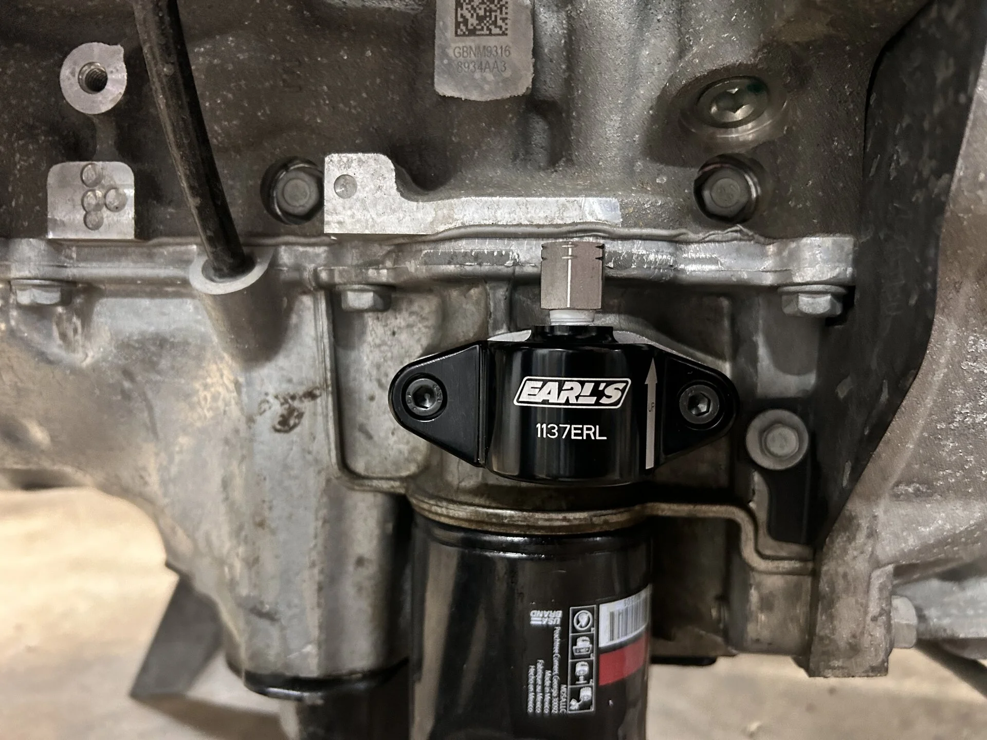

Earls oil cooler block off with port for factory Toyota oil pressure sender. An adapter is needed to convert the 1/8 npt to the 1/8 bspt for the factory Toyota sender. Adapter part number is EARLS 968699ERL
Another option is to just drill and tap the factory block off plate. They are plenty thick. I did this on one of mine, been doing great for almost 9 years.

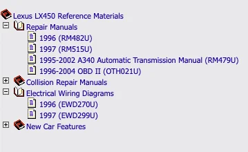

Does the factory FSM/EWD not have what you are looking for?
I believe I found one that works on the forum. Turns out the LX450 has slight and major variations from the Land Cruiser. For instance, the hot wire from the ignition coil on the LC80 is black/green and on the LX it’s black/red.
