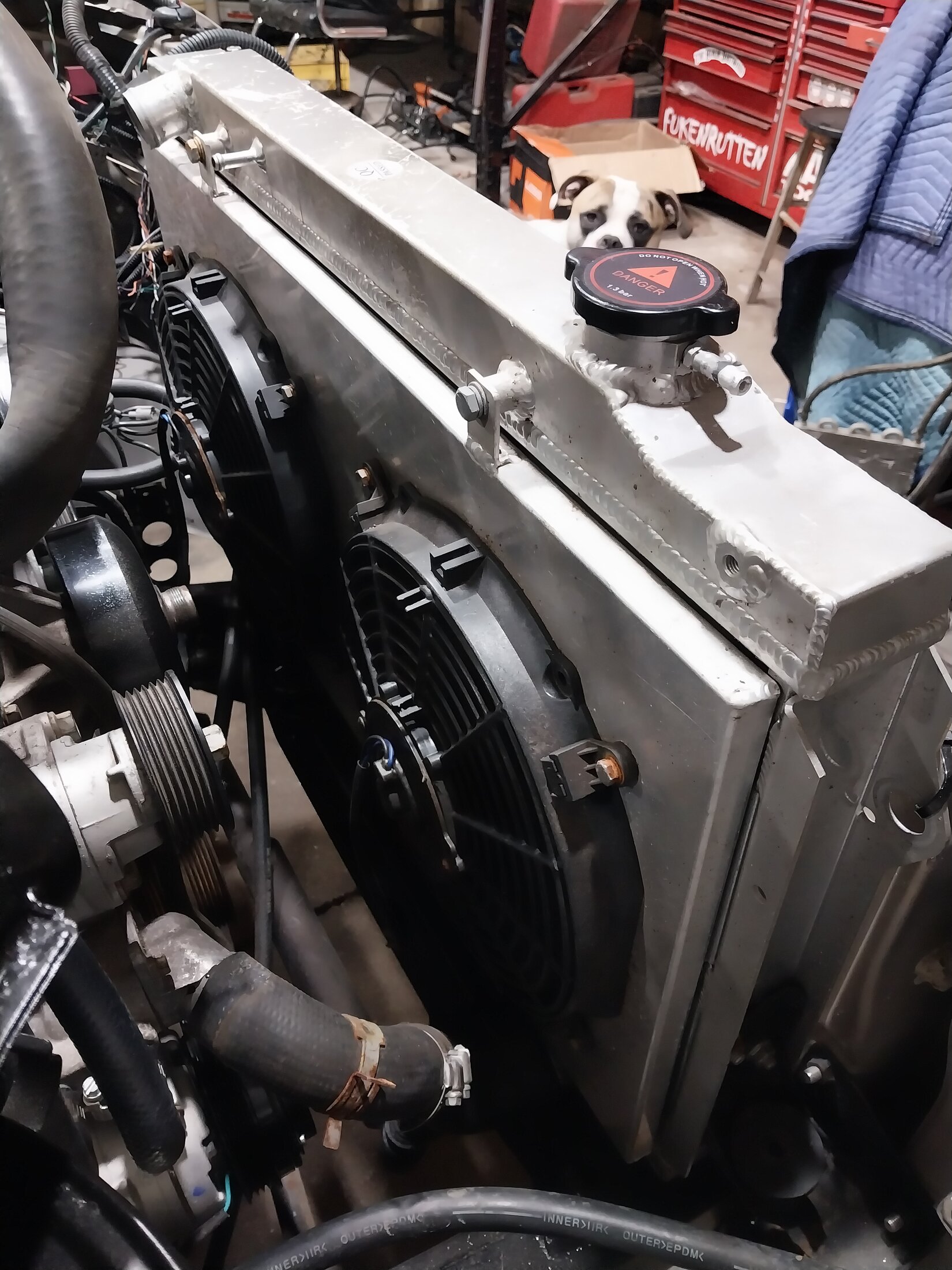

What did you do for your radiator? I saw your fan. That’s not the stock radiator is it?
Most use the stock radiator, or buy a new cheap aluminum radiator. I am using a Ron Davis radiator.
Some will use a mechanical fan, like myself or use dual electric fans. GM ECMs, depending on the OS it is running, can control one or two fans. Both require a shroud to be made or adapted to fit a Toyota radiator. My mechanical fan is a combination of Silverado (fan clutch) and Savanah (fan) parts.
Ron davis radiator custom fan shroud and mechanical fan on this swap heading to Arizona. Second picture is I believe an ebay special or something customer supplied it not a fan but I'm sure it was cheaper than the ron davis.
