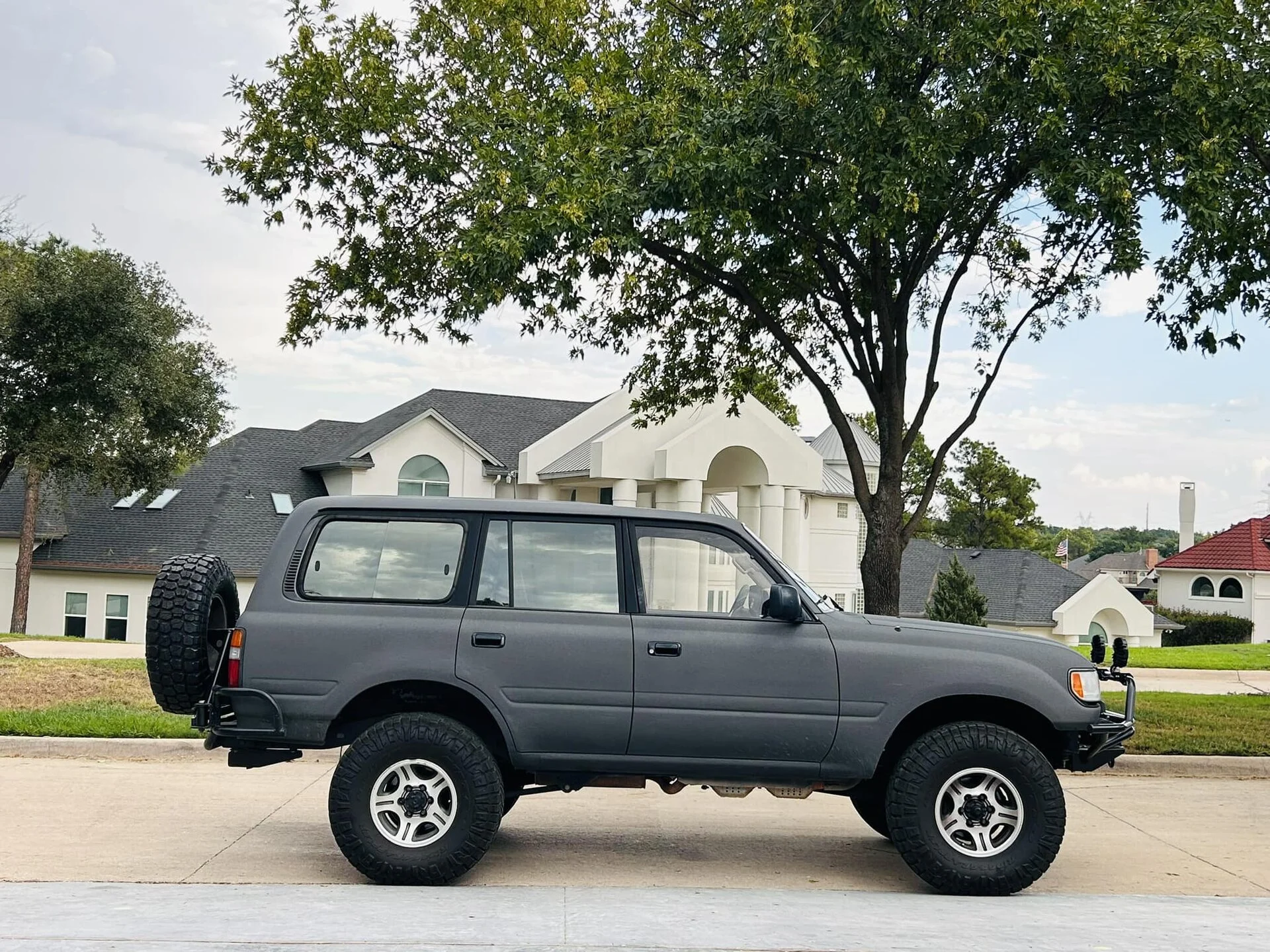

I bought this LX in November 2022 (day one is the first pic). It was purchased from the original owner with 360,000 miles. Its factory "triple locked" and came with a ton of service records. A great start at $3500. Yes. $3500 for a rust free Texas one owner. SCORE.
I replaced all the leaky seals with a Wits End Kit (RIP), replaced the locker actuators and started on a few fun things:
OME J-Spring lift with their shocks, stabilizer and caster bushings.
315/75/16 Nitto RT's
Front and Rear Trail Gear bumpers. Added a winch and some Amazon lights up front and welded on a 4xInnovations rear swing out kit with table. (I can share more on that if anyone is interested)
I decided I hated puppies, ripped off all the plastic cladding and roof rack, filled all holes and Raptor coated the truck in Metallic Charcoal. It shimmered in the sun and my 5 y/o daughter named it Sparkles.
That brings us to now (Mostly). The 1FZ FE still runs strong and smooth but burns a little oil as to be expected. And the transmission is still strong as ever. But, we tow a 2900lb pop up camper. That with the weight of the truck and its gear leaves more power to be desired.
Wife gave her blessing and so the next stage begins.
