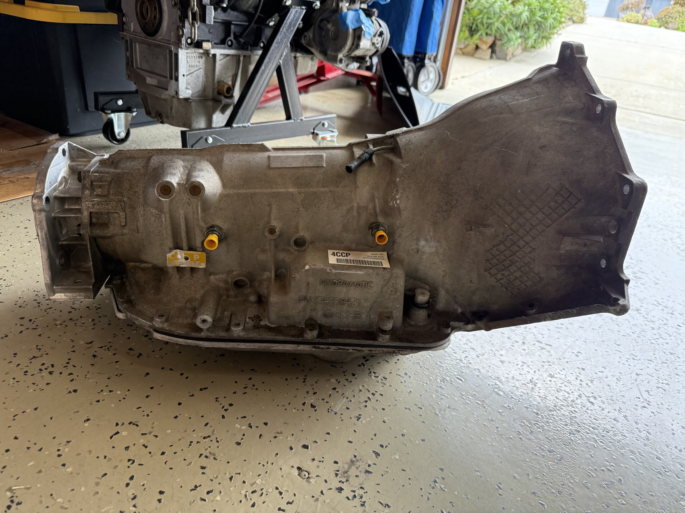

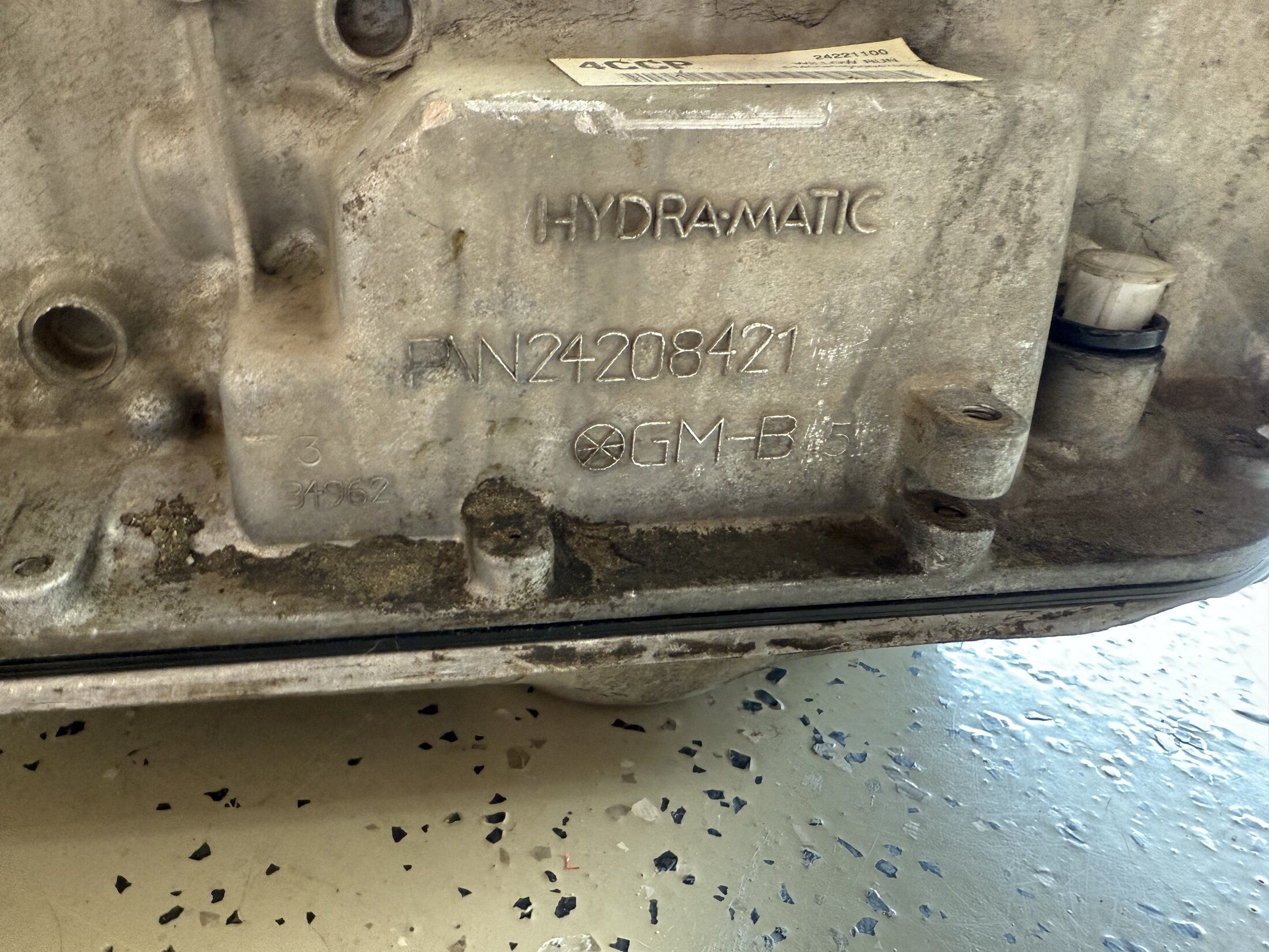

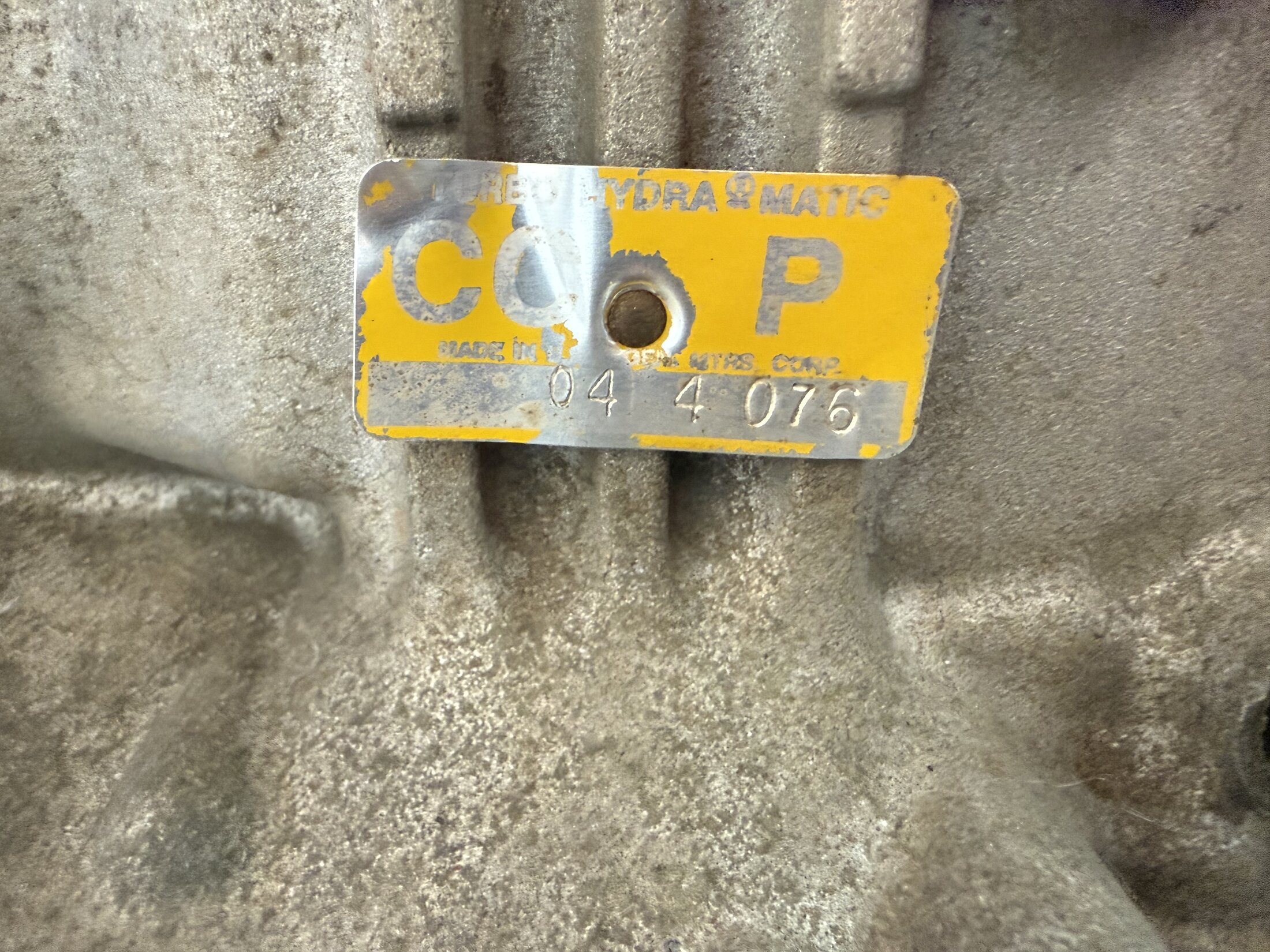

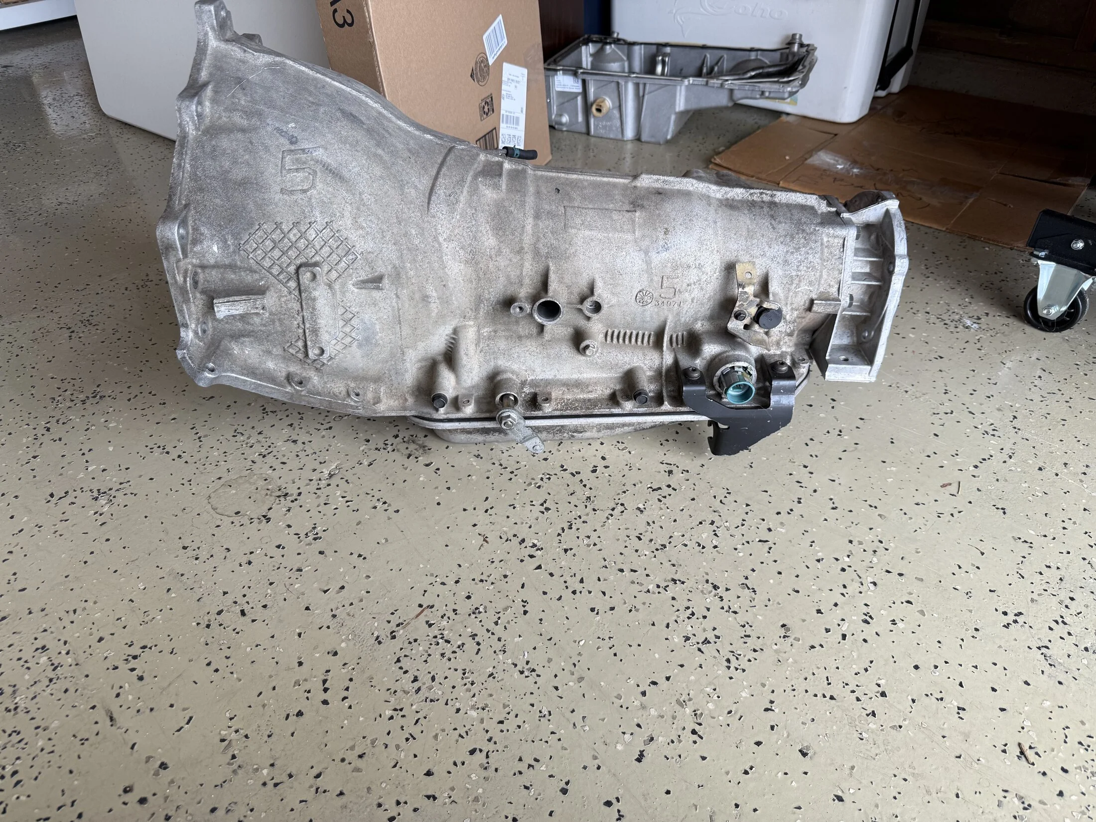

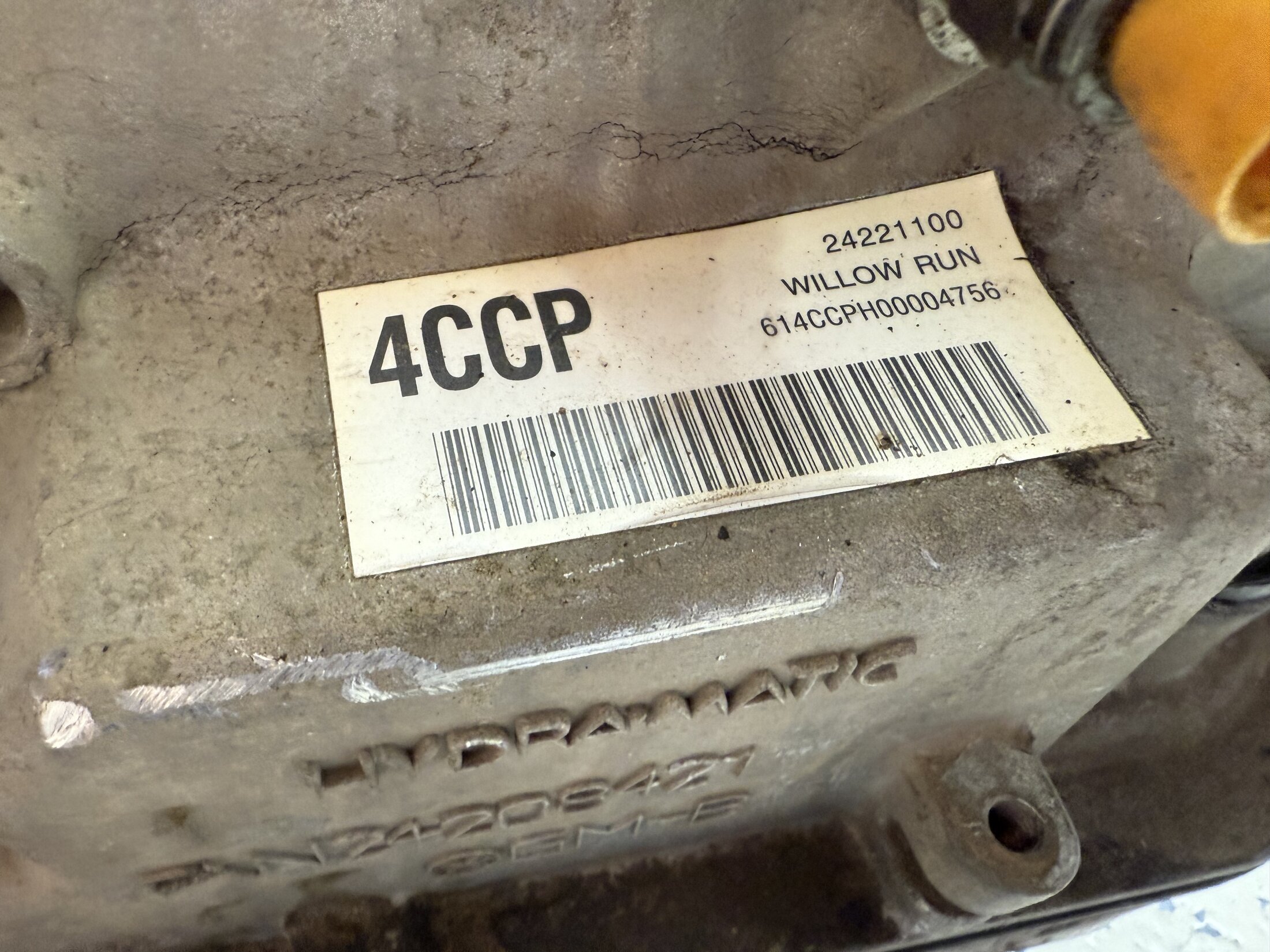

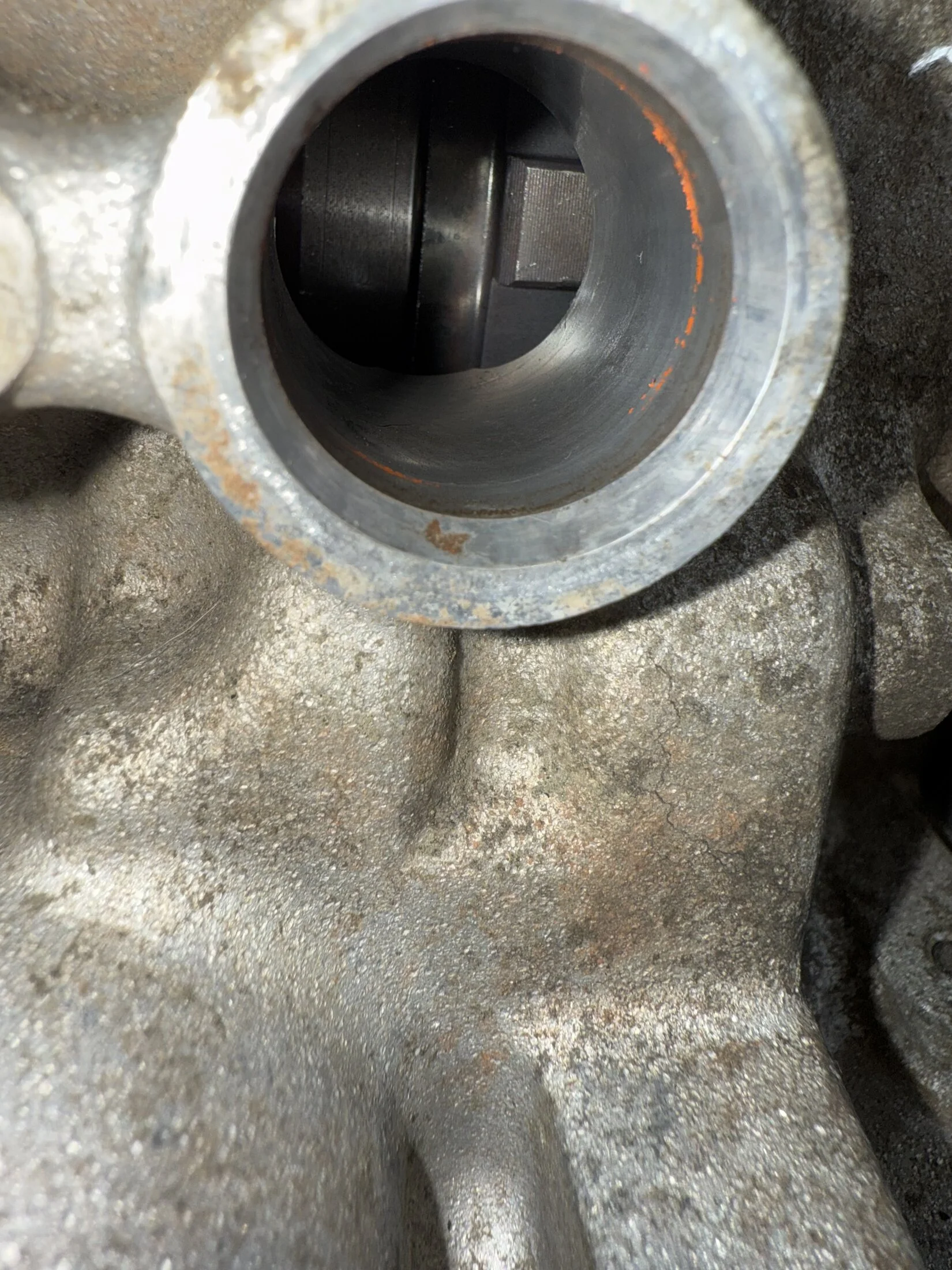

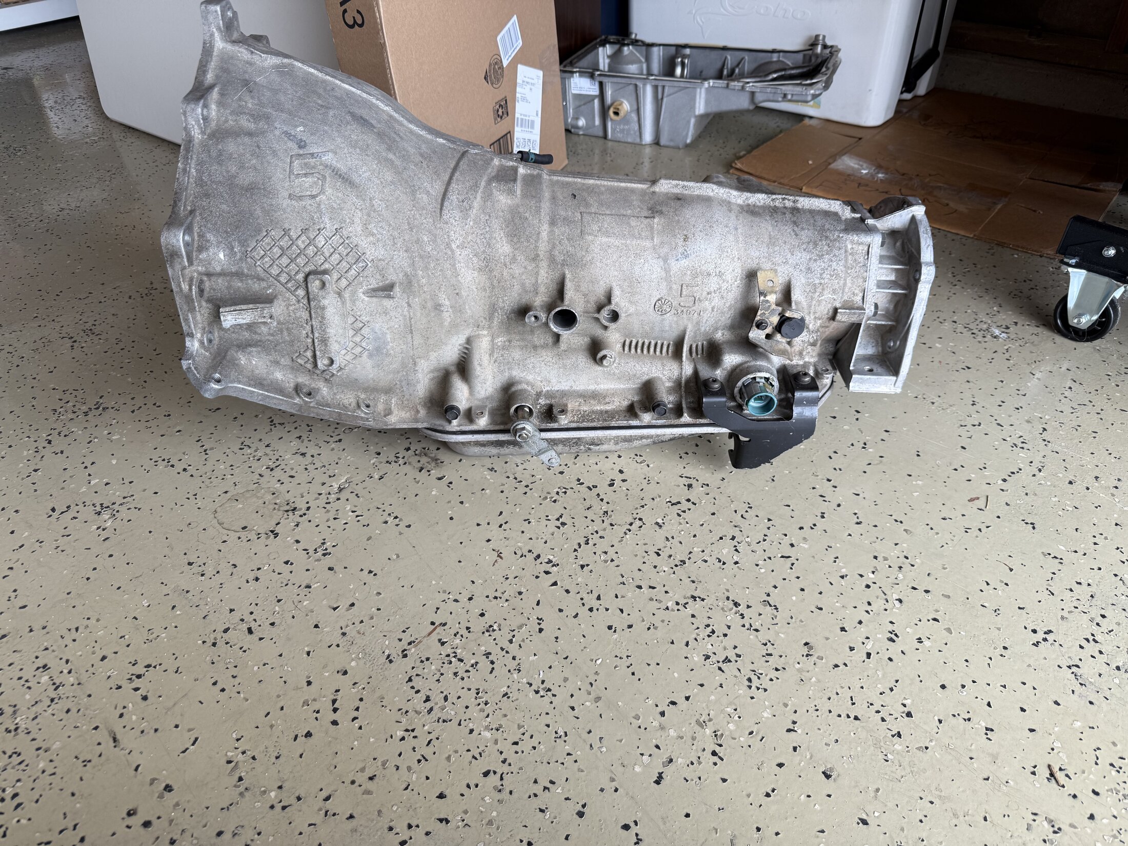

Here are photos of my trans that I had sent to me.
Looks like I don’t have sensor installed, looks like a plug. But I don’t know if the if the reluctor ring is installed in the rear
So to anyone else wanting to run the 4l80e you will need to either source one with the rear vss reluctor ring or have a transmission shop or you yourself will have to do the install of it. There is a work around but this is way less technical less wiring less thinking less stuff to go wrong not sure on less money but most will go with less thinking lol
