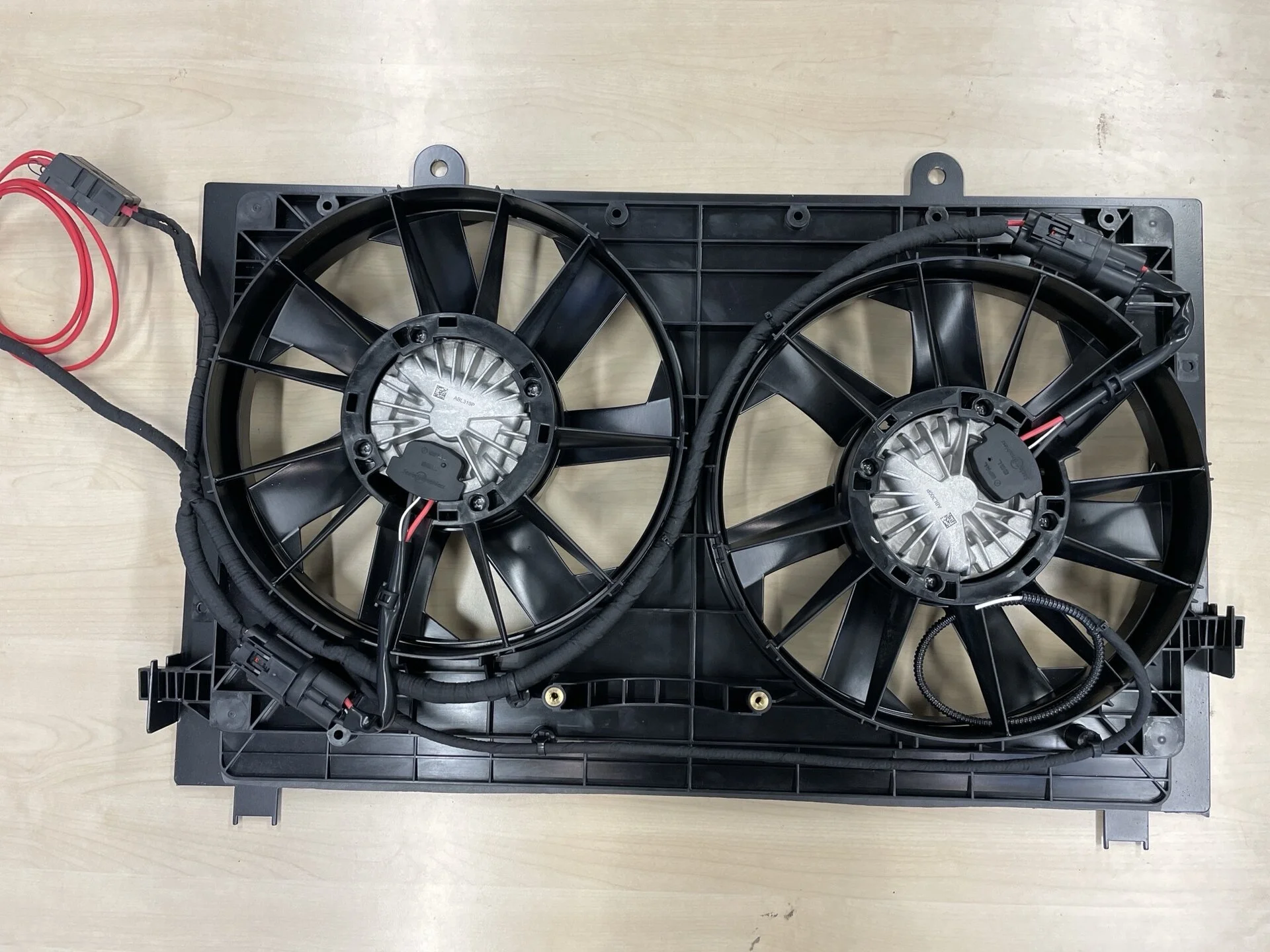

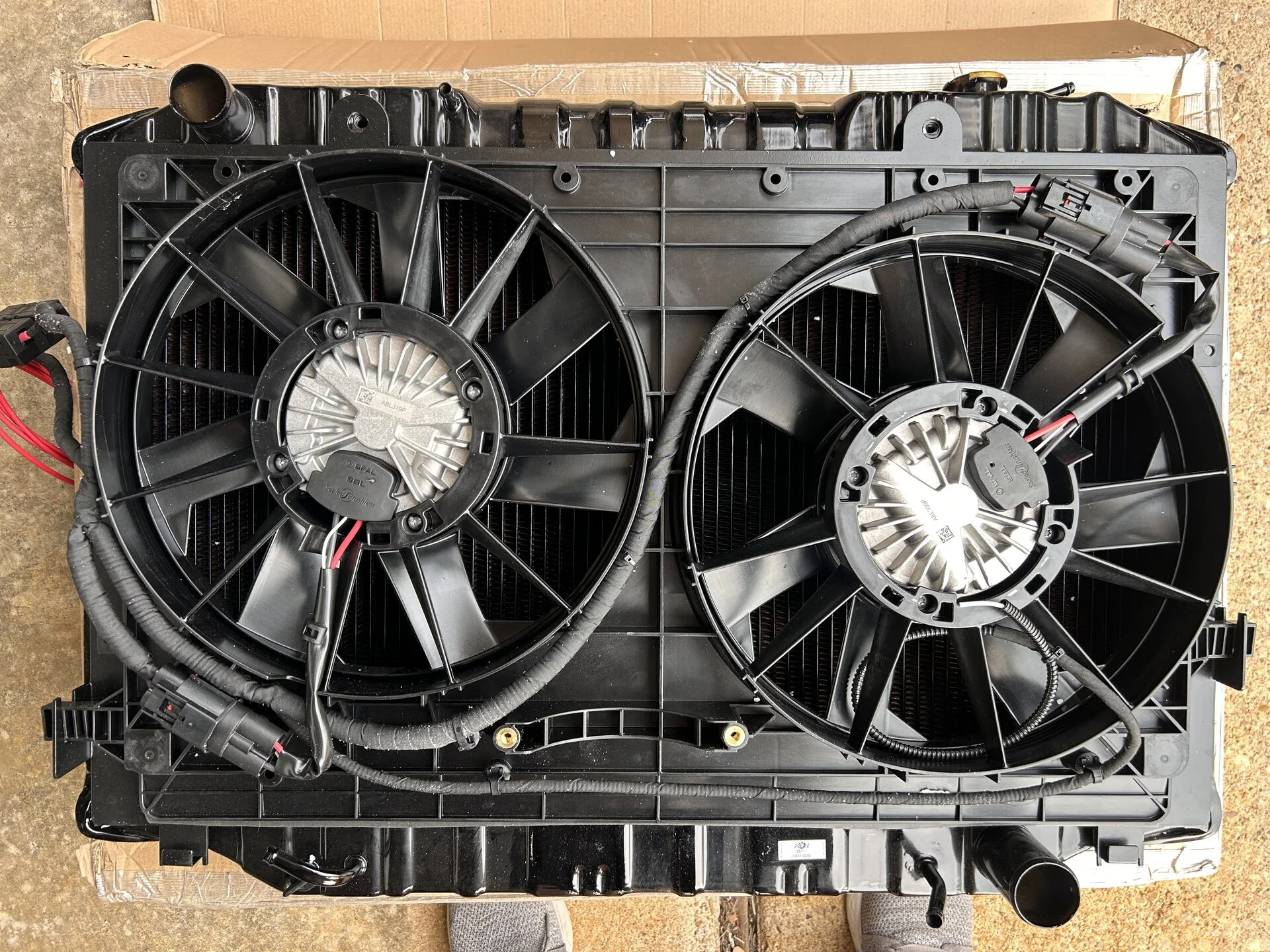

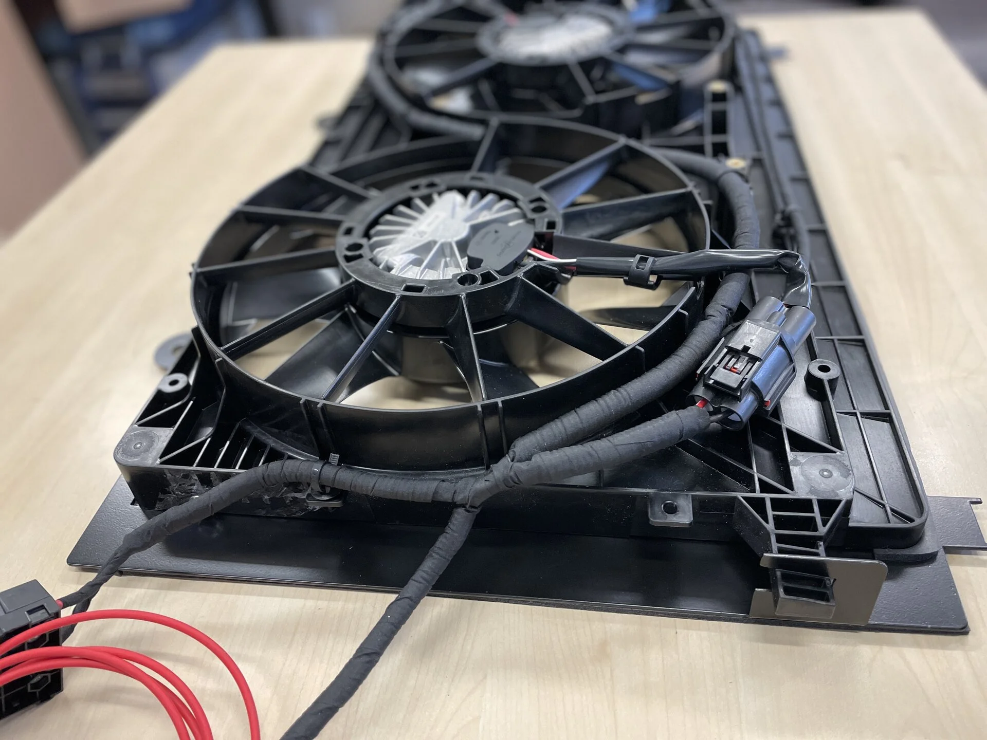

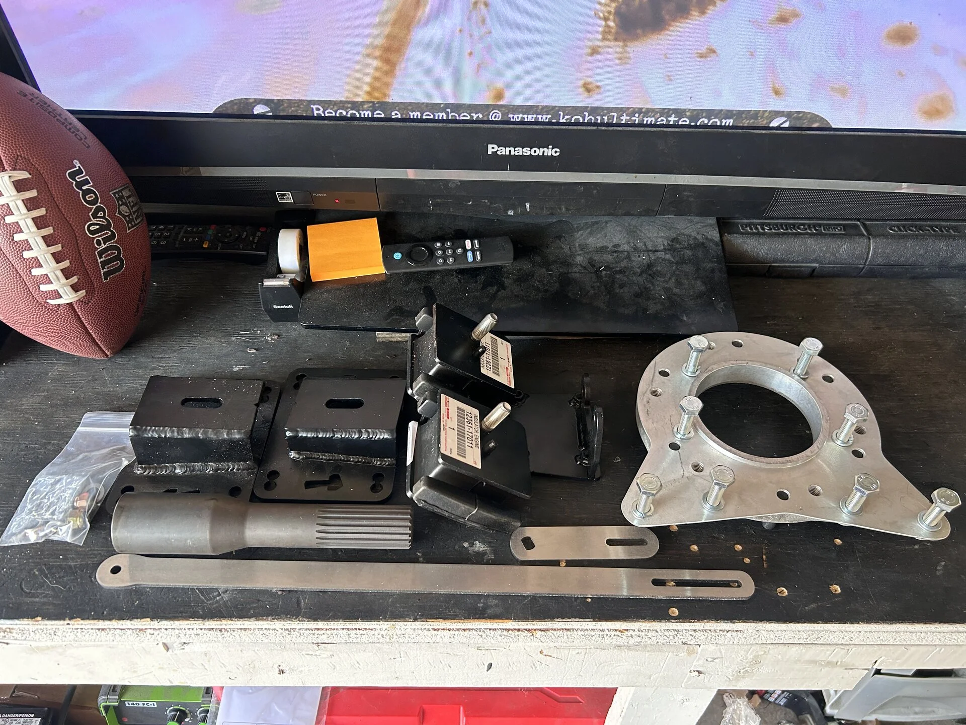

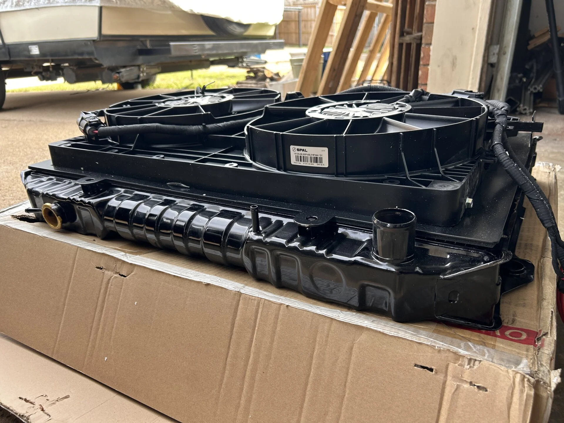

Well, a whole lot changed once I discovered Torfab's 80 Series Gen V LT Kit. I cant speak highly enough of him. He answered tons of questions and was so fast to respond. So I made a pivot and switched the plan to a 6.2 LT and 10L80. His kit offers 100% bolt in application. You start with a 6.2 or 5.3 with a 4x4 10L80 or 8L90 and use his adapter to mate it with the LC80 Transfercase. You are able to utilize the factory oil pan and truck style manifolds. His kit also places the transfercase where the factory driveshafts can be used. Tor is also building me custom fan shroud and mounting kit which will house factory style PWM fans that will be controlled by the Gen V ECM. I know Ill have great support once I begin the install.

Got my Torfab kit in today. Very well made!

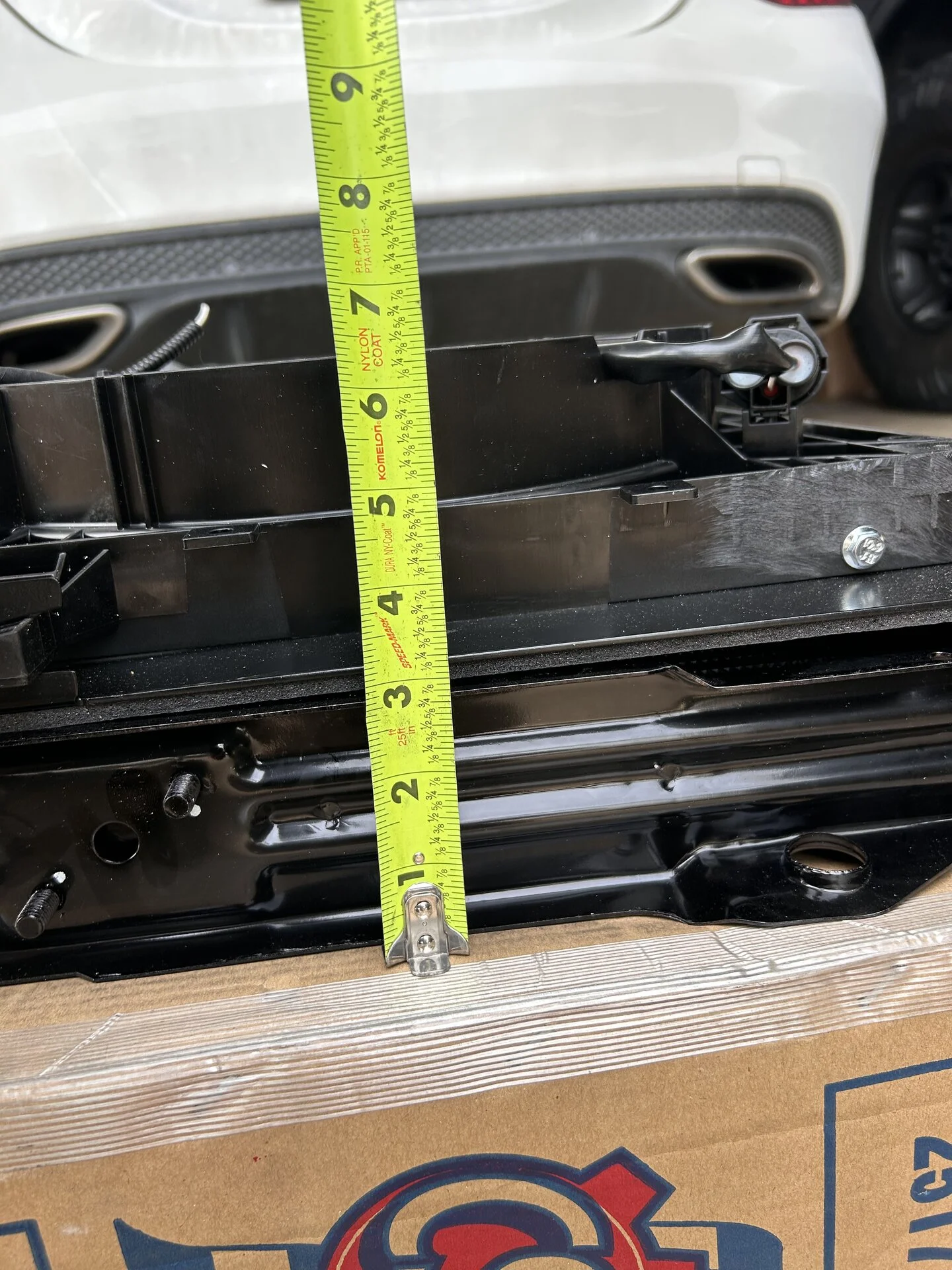

Do you mind measuring your engine+trans combo length?
My driveline was moved rearward in my frame 6-7” when converting my body to the Ute … and the body as well- the frame rails that hold my winch are normal 80 dimensions.
My stock 1993 motor and tranny are still connecting to a stock transfer case. And it’s a pretty tight fit between my radiator and the front of my engine.
Things already different on my truck to make that work: two new shorter driveshafts, front anti-swaybar removed, motor mounts.
