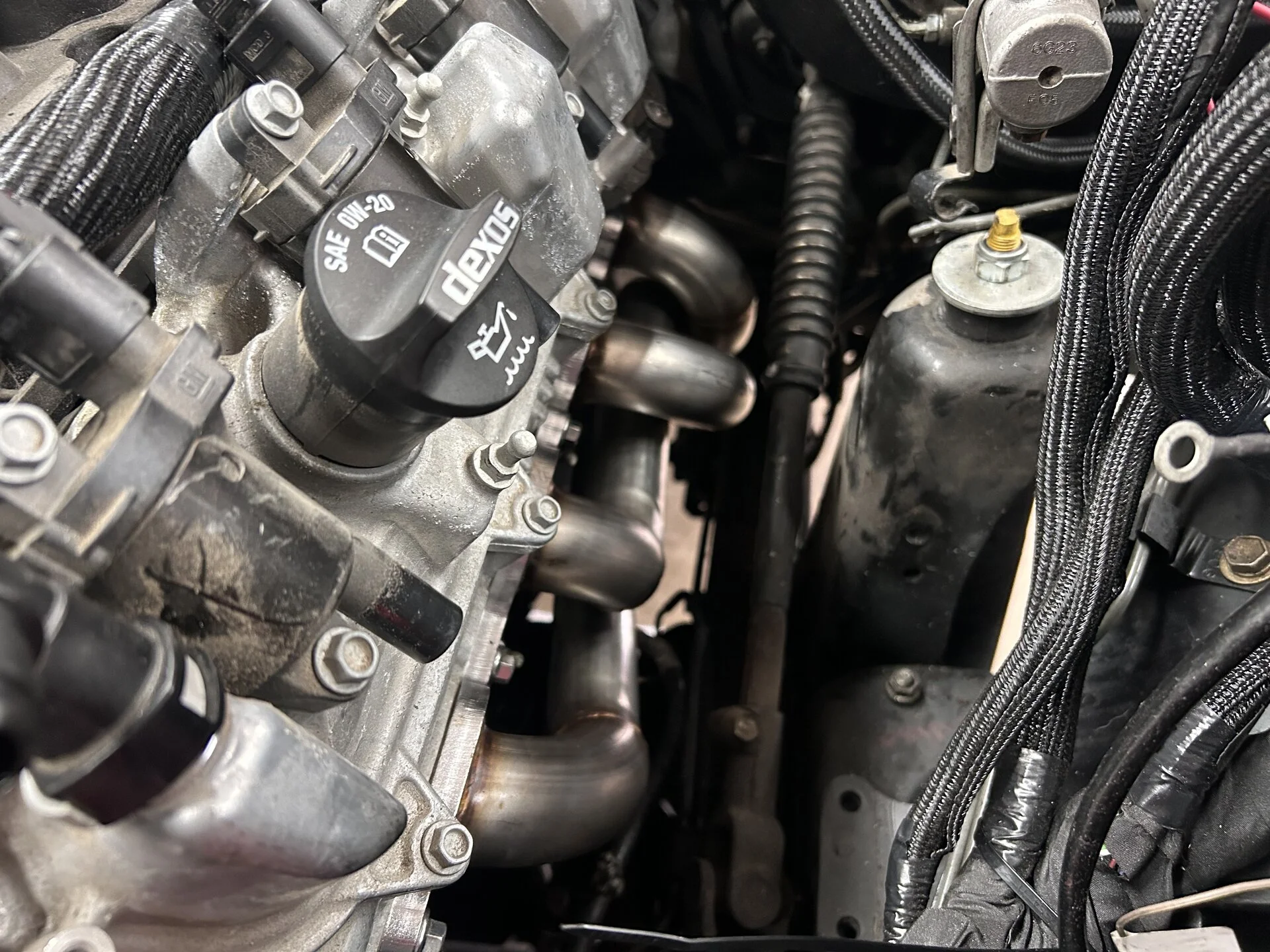

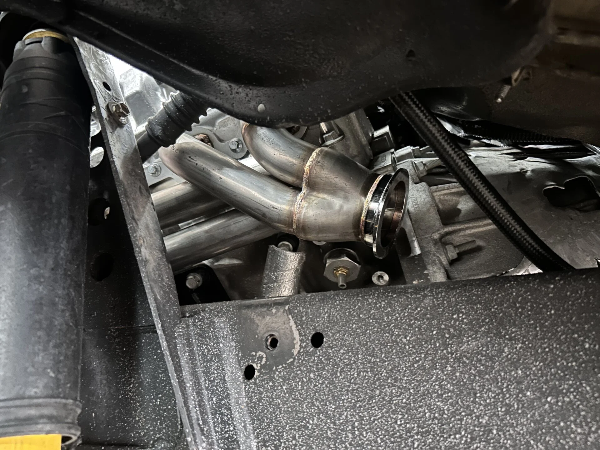

Did you talk to Torfab about the fitment issue, or you’re just on to headers as the fix? Headers will increase under hood temps too won’t they?
I’m going to heat wrap them and yes I’m in talks with Tor, he’s looking into my exact combo and fitment at the moment. It’s still a very new kit and some growing pains are to be expected. If a $300 set of headers is the answer to shoving a giant V8 into an i6 frame than I’d say that’s a win.

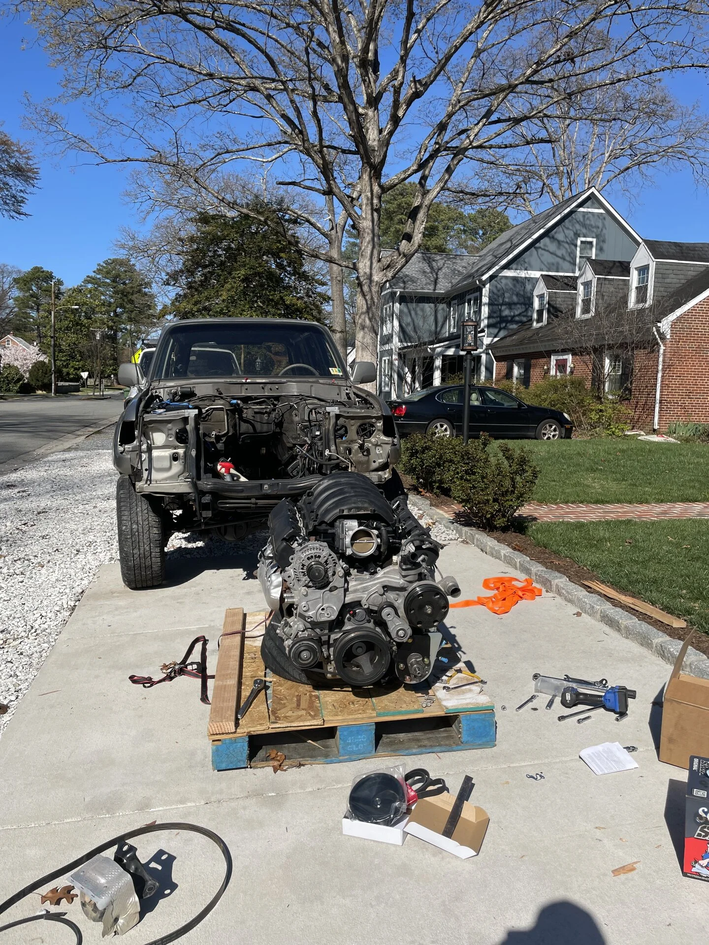

First start! Still a ways to go but she’s alive and sounds healthy
Man! You’re cruising right along! Very exciting and it sounds awesome!
With the SwapTime kit and some expert help from @Major Tom it wasn’t bad at all. I’ll do a quick video.
lol. That was far from expert help. I had a ton of help from others with my swap, so I’m happy to help. I’m glad you got it running.
