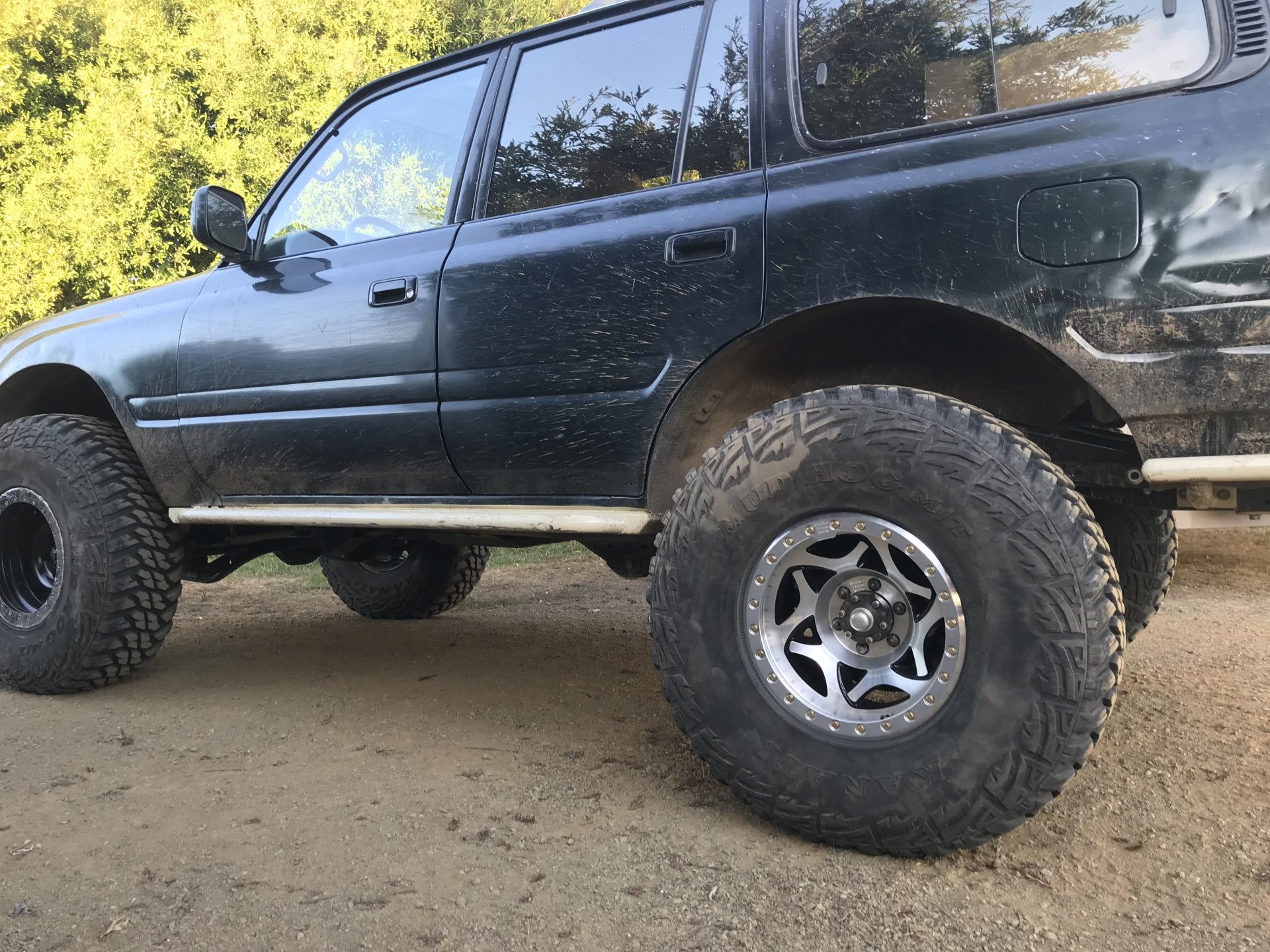

So I got a set Walker Evens racing bead locks 17 -8.5 with 3.75 back spacing with my 39 x 12.50 17 mud hogs.
I recently moved from 17x9 -25 wheels to -38s running the same 37x12.5 tires.
Now I’m rubbing in the rear mud flap area driver side at near full lock left turn.
If it’s an easy and clean job to bend that body metal an extra centimeter or so that I need, I will keep the -38s, else fall back to the -25s.
Any guidance here to spare?
Credit to @Feldrian for the pic.
Many thanks.
I trimmed the support and bent my inner fender back. Pretty easy job - took maybe 45 min a side, inclusive of paint.
When you say trimmed you actually cut the backside of the contact area where it’s rubbing? Any cutting is a hard stop for me.
Yup, you'll ether have to cut or hit it with a mallet and bend it. Cutting seemed like the more elegant option.

Move your front axle forward. Either with aftermarket radius arms or with relocation plates. I went the relocation plates route. Opened up a lot more room for 37’s. Mine were rubbing badly in the same area until I moved the axle. You only need to move it an inch or so. I moved mine 1.25”

Suggest that you switch back to your ET-25mm wheels, you will be a bout 1/2" better off for this type of rubbing.
But - enough better? Hard to guess.
ET-38mm = 1.50" which is how much that wheel moves the entire tire outboard i.e. the outside tread edge outward (relative to the hub mounting surface, and relative to the OEM landcruiser wheels, which are ET0mm).
Does that explain your rubbing the outside edge of drivers side front wheel (you meant that right?) when at full lock left? yes?
Likewise, ET-25mm=1.0" outward.
If I had chosen to go to 37s, I would have selected 8" or 8.5" wide wheels and offset either ET0mm or, at most, ET-10mm, which moves the tire 0.4" outward - maybe just enough to reduce inside fender rubbing some, but without threatening to causing the opposite problem like you have.
Although - the wheel width should have no influence on the tread edge position, only partial influence (about 1/2 x) on the actual section width at the widest part of the bulge). Still I see no benefit at all - of a wider wheel than the minimum allowed by most tire manufacturers, which is usually 8".
Wider just pushes the rim out closer to rock damage, right? - with less tire bulge to shield it.
Right now, with this situation, the tread edge is very likely to catch the bottom edge of the fender, bend it up, and slice off tread, too.
You had better re-work that bottom edge, bend it under, away from the tire, and secure it very firmly - that square hole can hold a round-head screw into a sheet metal clip-on nut, something like this, on the sheet metal behind what you see.
I think a sturdy pair of flat-nose pliers, or even a channel-lock plier - bend back a spot, just a little, move over, repeat - a little at a time, until it looks good to you.

I have a little less room on driver side than pass side which explains the rubbing. Half a centimeter?

That area that it’s rubbing can be bent easily. I don’t think it would even be noticeable. No need to cut like @Feldrian mentioned since it’s not going to be wheeled.
If I remember right, it was a slight rub on one side more than the other here as well so may be common. Keep in mind even if not going off-road every dip, bump, curb and so on will likely still rub so make sure to consider that. These heavy 37's move around on the road more than you may realize. I'm running big fat 13.5's so it may be a bit worse but, what convinced me to just make the move.
