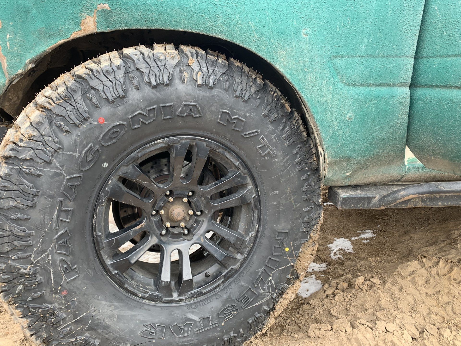

I'm digging the Patagonias as well (got them on 2 vehicles so far)
Third this, the patagonias are awesome! I had the 37x12.50r17 installed about a month and a half ago. 5k miles in and they ride well, are quiet, and are very good in the mud. The price helps too. They also stuff nicely as Nay stated.

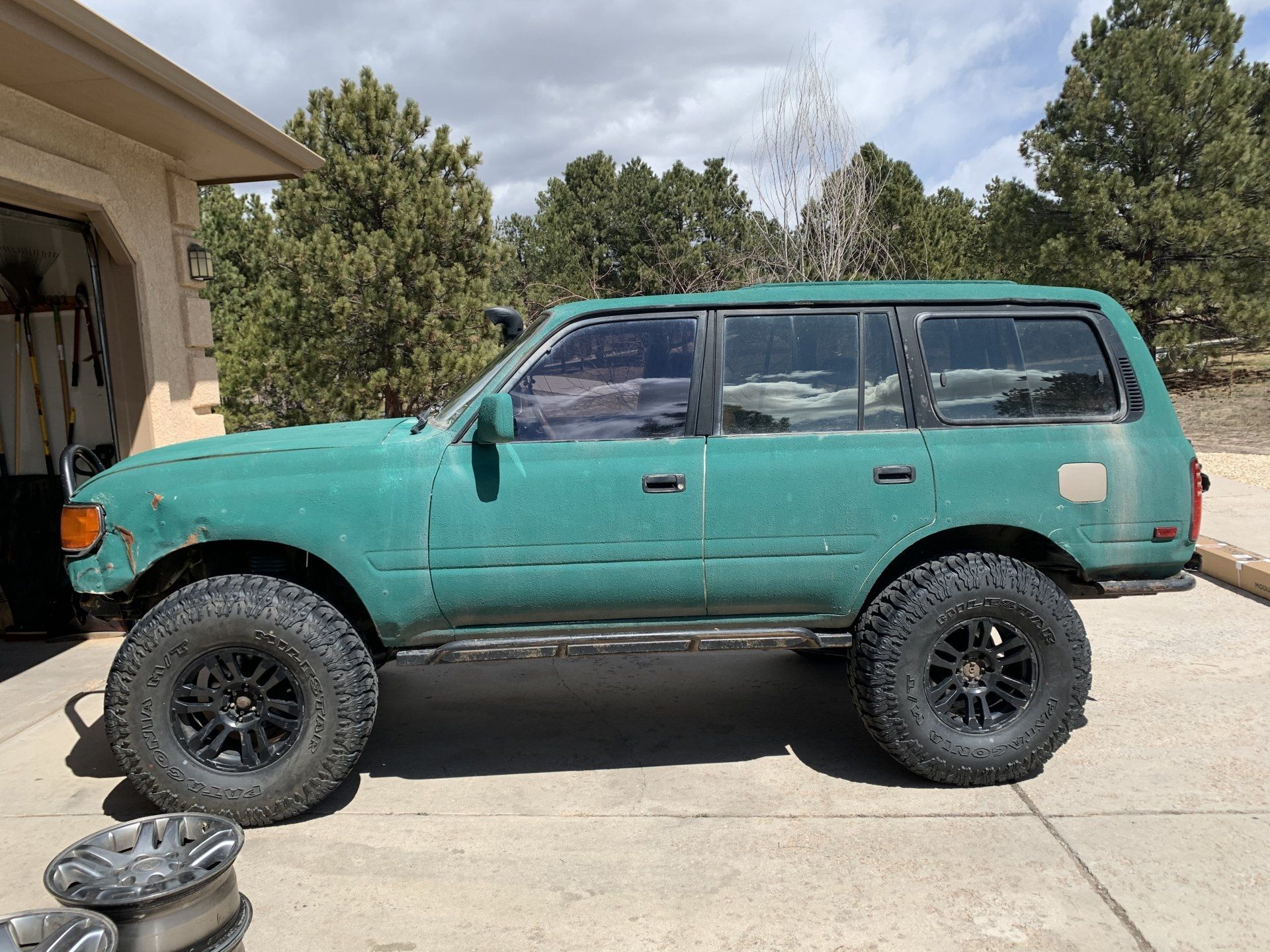

nothing special but here is my dirt cheap build:
37x12.5r17 yokohama geolander M/t's steel 17x9's
2" homemade metal spacers, stock coil springs
cheap procomp 9000 shocks to allow more droop
2" lowered bumps front and rear.
well cut fenders. still needs more trimming in the rear. probably need less bump stop drop in the front.
stole the tires/rims from my other project, shocks at 50 bucks each and spacers made from scrap i had laying around.

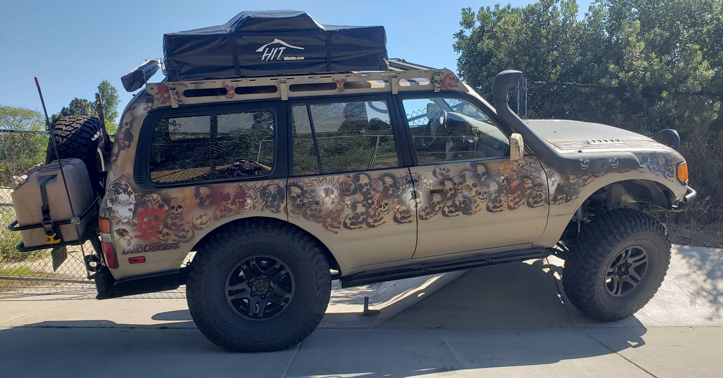

39x13.50r17km3 mounted on 17x7.5 sequoia wheels with 1.25 wheel spacers. 2inch OME heavies and 30mm poly spacers. 1.25 bump stop spacers all around. Fabbed up 40 inch wheel tubs in the rear.

right on! that base color and tubbed rear is exactly the direction i was thinking of going. do you have more pictures of the fenderwell work anywhere? did you lengthen the rear control arms at all to keep the 39 out of the door? as you can tell i really dont have much exterior finish to protect on mine so i might as well hack it up to keep it low.
