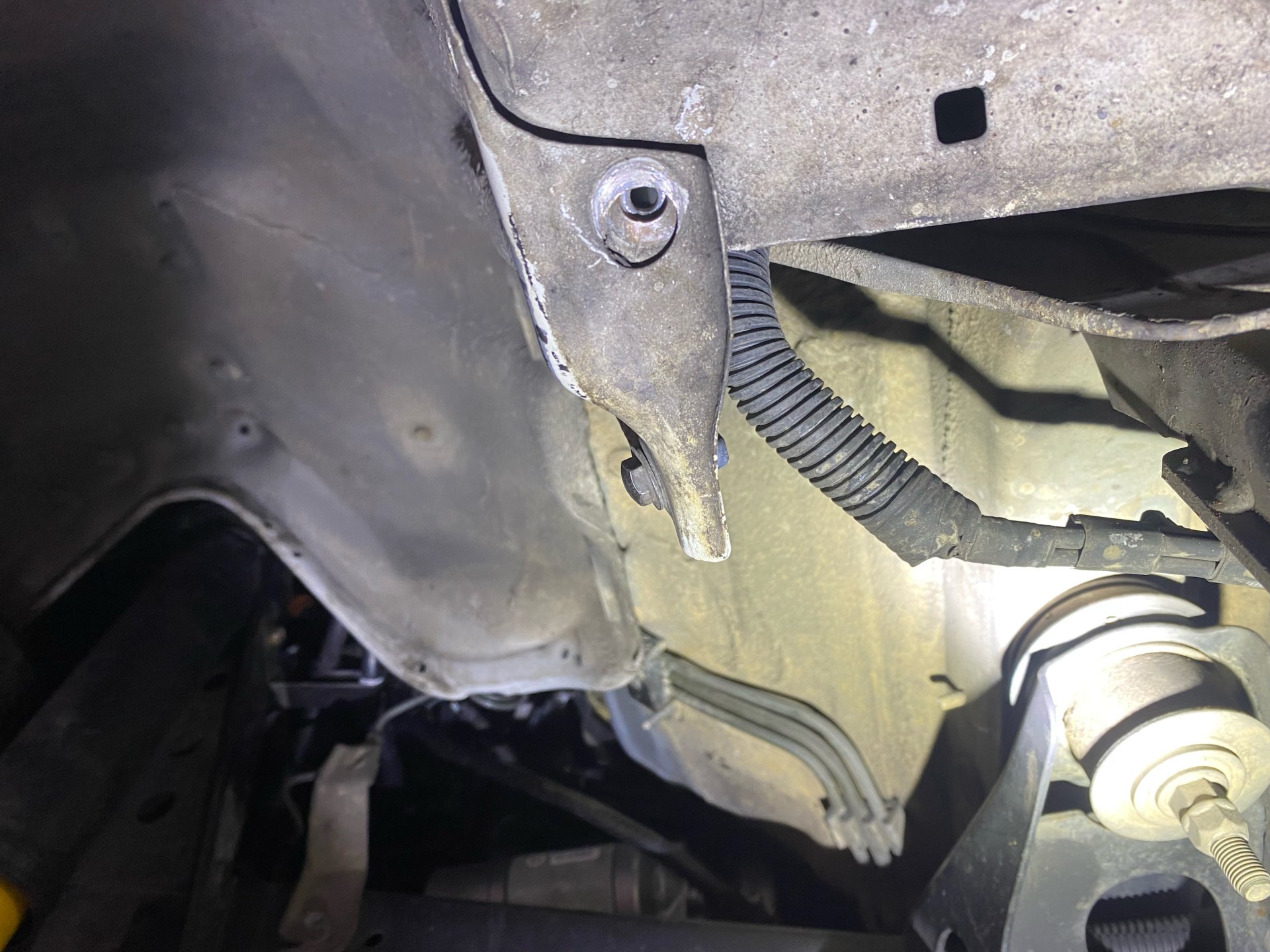

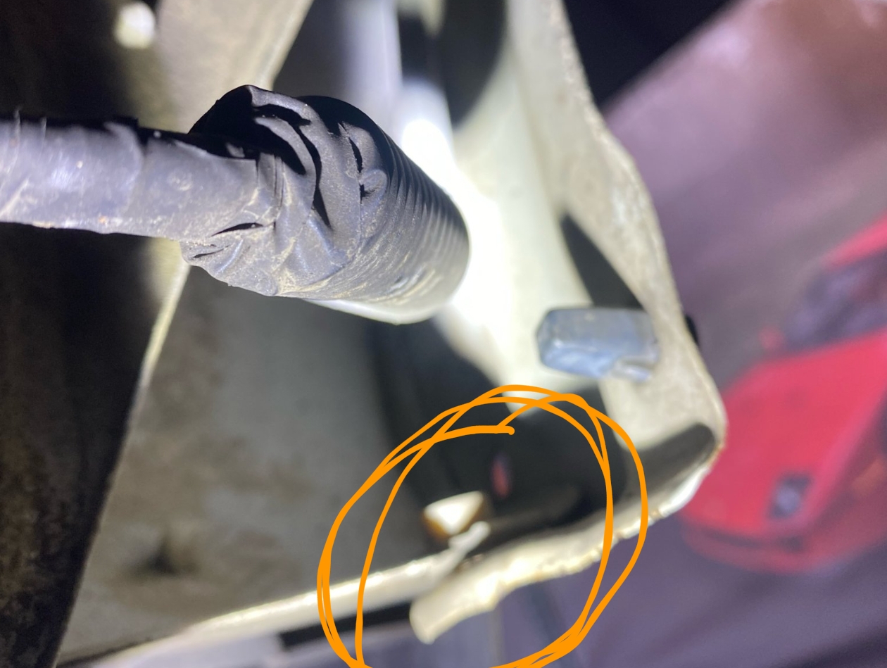

I conferred with my trusted body shop contacts and we took some pics just in case it helps others in similar shoes as I which is pretty niche for the prototypical ih8 37s crowd.

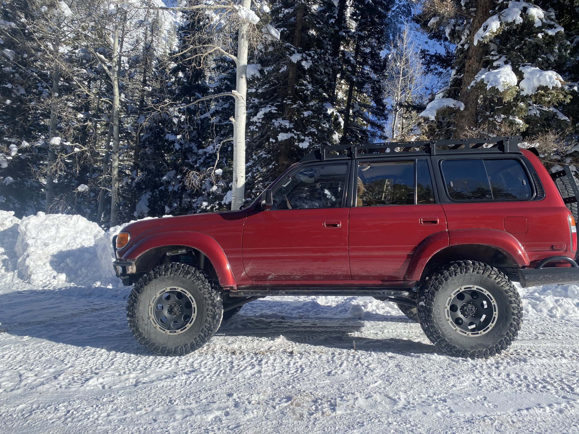

Modest lift. 37x12.5 AT tires. Delta 4 regular arms. Caster at positive 4. 17x9 -38 offset. Errand runner with side trips into the woods no rock crawling.
Thankfully for those who may want to mod the body, there is no cutting you have to do if you need a centimeter or two to clear as I do.

I didnt read any of the post but if you loosen that bottom bolt, you can tap the fender back about .25" if its just barly rubbing.
So there you go... just saved you a bunch of money...
