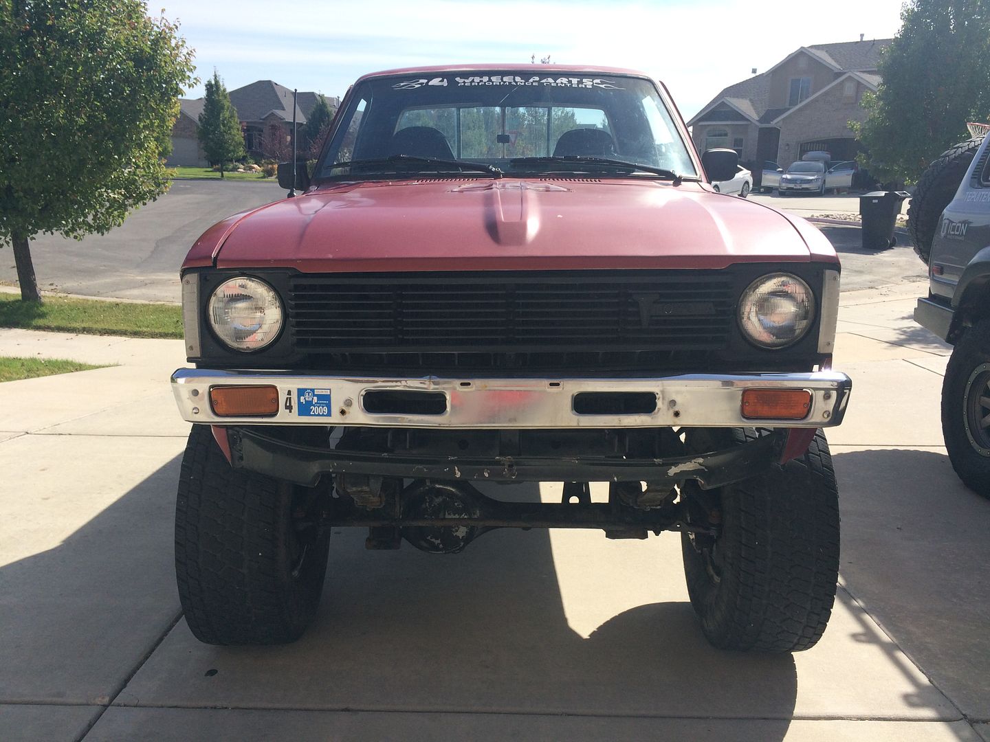

Current Pic as of March 2024
Untitled by Adam Tolman, on Flickr

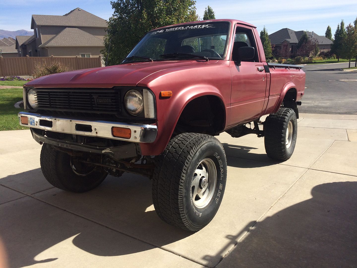

I will say right up front that this will likely be a much slower build than any of my previous ones. Mainly because this truck is for my son and he's playing a major role in the work including the money side of the mods. All that said, I'm excited for it. I've always loved the 1st gen Hilux and I have a soft spot for them since my first car was a '79 2WD Hilux. We've got some good plans for this one but it needs a lot of work.
Plans include:
Suspension Overhaul (probably coming down an inch or two)
Steering Overhaul (powersteering with High steer)
Full rebuild of both axles
Replace hubs with Aisin units
New tires (315/75R16 on FZJ80 factory wheels)
Repaint body
Build bumpers
Build Bedrack
Build sliders
Crawler gears.

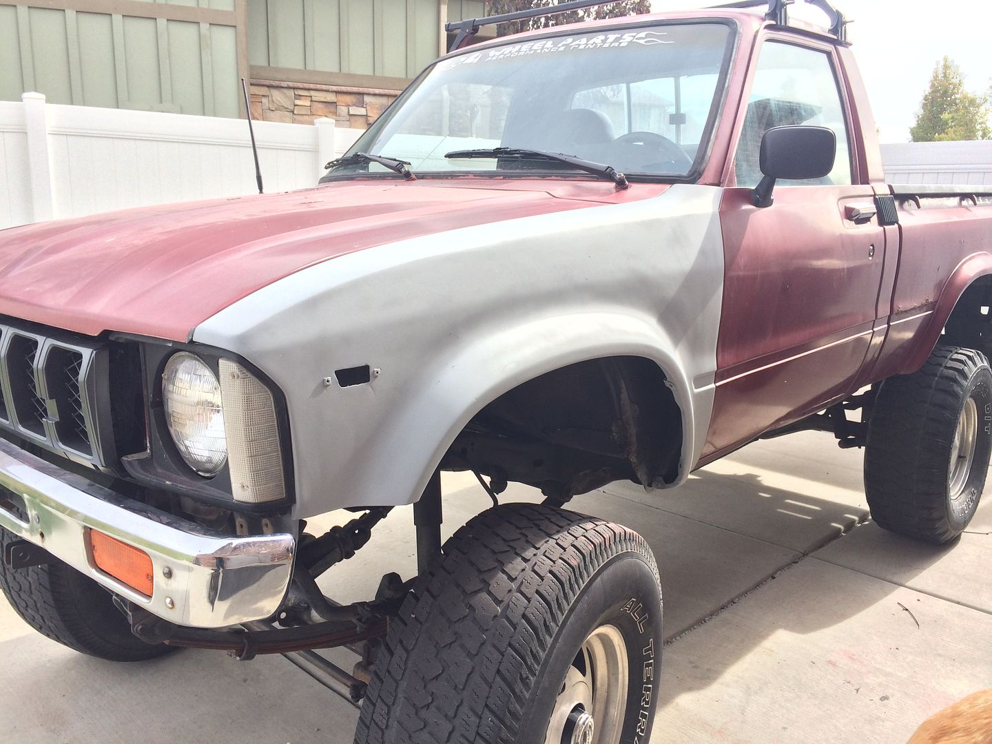

Some small progress over the weekend. My boys are working on getting the body sanded in preparation for new paint. Gonna be a DIY paintjob but I'm feeling good about getting a good finish out of it. The truck is just not in condition worthy of a high quality paintjob so we'll handle it ourselves and it will look LOTS better than it currently does.
Currently just one front fender got sanded and hit with primer. This was the "instruction" for the boys. Now they'll handle the rest of the truck.

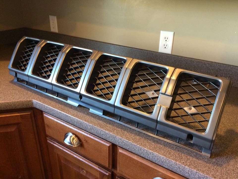

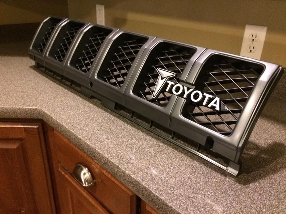

We also wanted to update the grill from the ugly 1979 2wd grill that was on it. I got a replacement grill from a 1983 SR5 that is gonna look awesome. It's worth noting that these grills are slightly narrower and were used with the square headlights rather than the round headlights like we have. There is a similar grill to this one that works with the round headlights be we didn't like it as much, so there was a little custom work that went into making this one fit well and look correct with the round headlights but we solved it yesterday and it looks great! I'll post pics of that later. We're leaving the grill off for now until we get paint on the truck.
"restored" the factory emblem

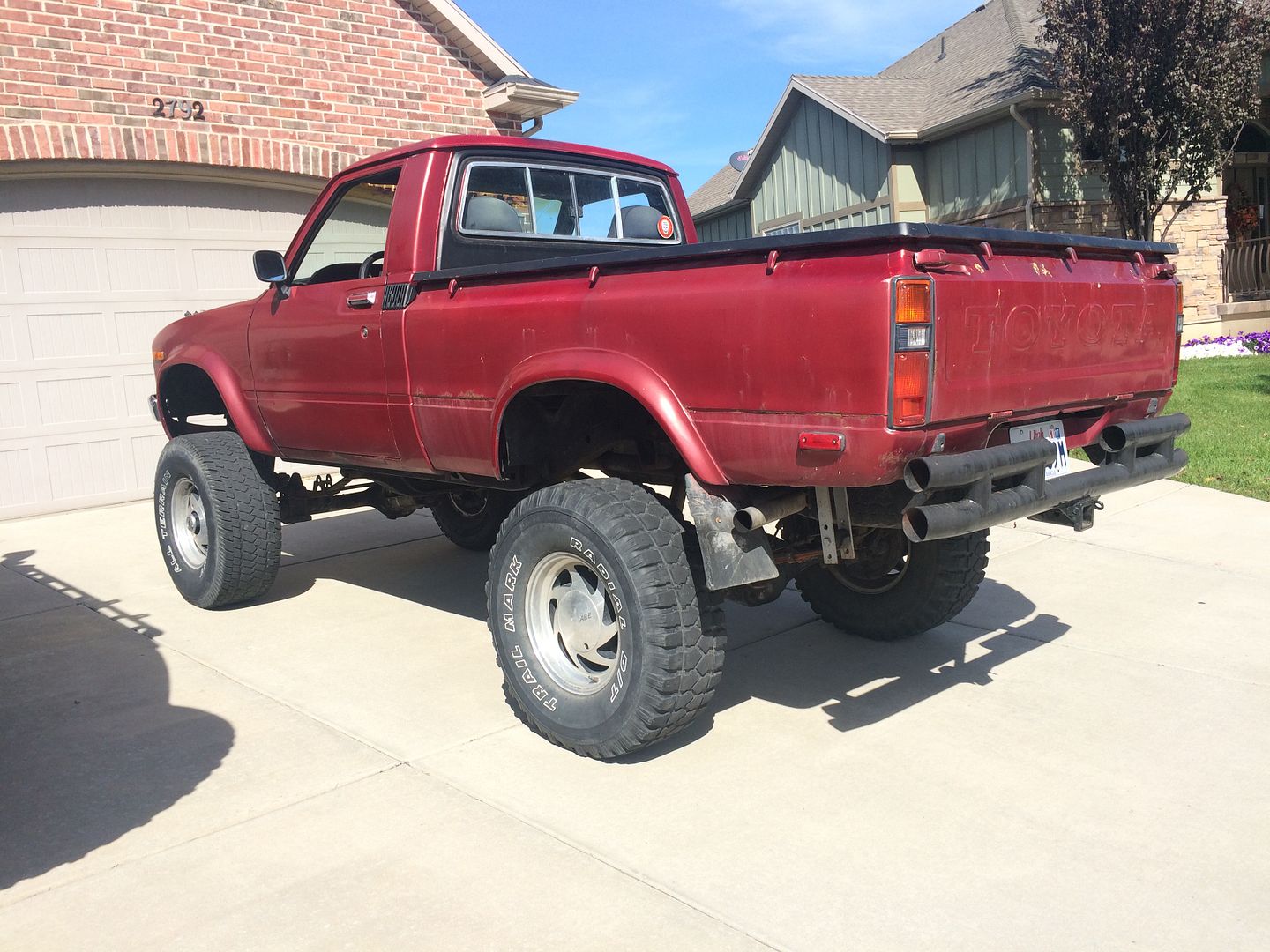

Lastly, we picked up a set of 63" Chevy springs for the rear. Looking forward to trying these out. I've always swapped in new suspension on all my trucks so this is the first time I'm trying something used and not specifically designed for the truck. But the reputation is a great ride and lots of flex from these so we're giving it a shot. Planning to pull a leaf out of the fronts to soften them up and hopefully get the truck an inch or two lower.
Gotta find a deal on some 315/75R16 tires. We're going to use the stock 80 series wheels from my Cruiser with the 315's. The combination of getting the ride height a bit lower and stepping up to 35's to replace the garbage 33's that are on it should improve how this thing drives but also look much better.

yeah we considered doing the whole swap but we wanted to keep the round headlights but use the later grill. The later grill is slightly narrower and is used with the square headlights.

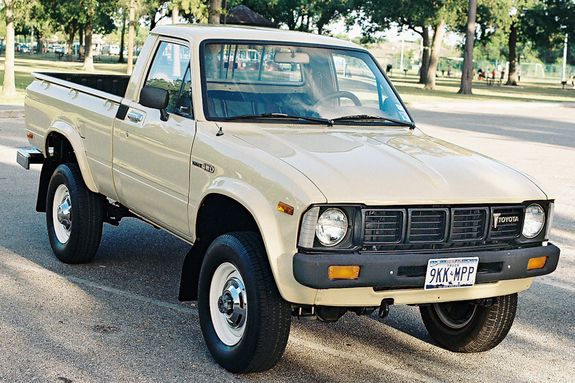

versus the slightly earlier version that went with the round lights. We didn't like the look of this one as much.
The grill we started with was like this one from the 2wd versions
We ended up with a combination of keeping the round lights, the later grill shape with the crosshatch pattern and a clever way of accounting for the width difference. When we get the grill back on the truck I'll post some photos. We have it off while we try to get paint on the body.
