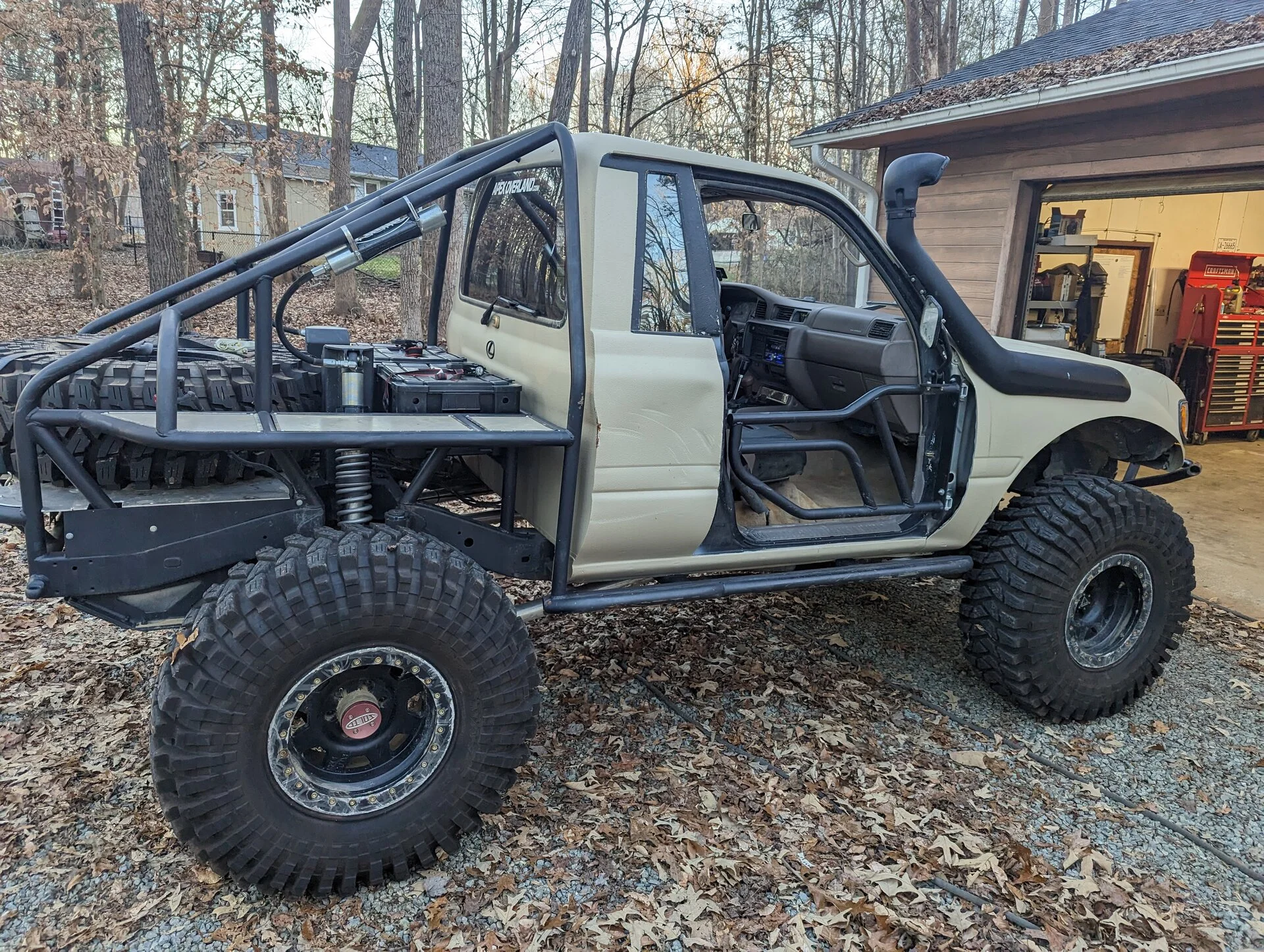

After beating my current 80 like a red-headed step child I decided to take some of my own advice and instead of putting links and heavy running gear under a truck that's intended to have good highway manners, I bought something wild that someone else had already built, tested and proven. Huge shout out to @NCTrey133 and his amazing build. Looking forward to continued adventures. Original build thread here: Builds - Sweet Brown 80 & Sweet Brown Buggy - Dual Build Thread - https://forum.ih8mud.com/threads/sweet-brown-80-sweet-brown-buggy-dual-build-thread.1056041/
Sweet Brown will be on the way to Bentonville, AR in mid January and then heading to it's permanent home in Seattle once I organize a tow rig and trailer (likely April). Will likely stop in the SW for some wheeling on the way back.
Original build list:
Engine: Stock 4.5L Inline 6, when I got the 80 I had Asheboro Toyota go through it and revamp anything that looked old & cracked.
  • Did fresh intake
  • PHH Replaced
  • Fresh Radiator & hoses from Lexus
Headgasket blew around 200k miles and we did an engine out rebuild from Auto Machine Shop (decked & bored 20 over with fresh everything) and an EGR delete to keep the heat away from cylinder 6.
Threw fresh motor mounts on it when we did the re-install! Nice touch!
Transfer Case:
  • Marlin 3.12 reduction gears
  • Sumo spool in the Tcase
  • Northwest Fab 2.7:1 doubler installed and functioning! (you’ll be one of, if not the first person with this in the 80 drivetrain in North America)
  • Custom tcase mount & skid + trans skid from Apex Overland that keeps it all happy
Driveshafts:
  • Carrier bearing (needed for the new doubler which pushed everything back 7”) from Scott Trimarco at Scotts Custom Offroad
  • New driveshafts from Olivers driveshaft (Coming!) with double cardans front & rear at the Tcase
Links
  • 3 link front (designed & expertly welded by MarsFab Offroad)
  • 4 link rear (designed & expertly welded by MarsFab Offroad)
  • All aluminum links from Wide Open Design
  • All FK Heims 1.25” (if you know you know)
Front Axle
  • Diamond Axle Fabbed housing 9.5” center section with ARB Air Locker
  • Diamond Chromoly Flanges
  • Branik Chromoly shafts getting sent out for it
  • RCV & Longfield (OG Bobby Longs) chromoly birfs & stub shafts
  • Hellfire Knuckles with High Steer
  • Hydro Assist kit from PSC installed by piedmont performance with fresh hydraulic lines last season
Rear Axle
  • Diamond Axle Fabbed housing 609
  • Curry nodular 35spline center section
  • 35 spline spool
  • Solid Dana60 outer hubs with 35 spline slugs
  • Chromoly RCV 35 spline axle shafts
  • 5th gen 4runner disc brakes (slip on, nothing crazy)
Suspension
  • 14” Radflo Dual Rate Coilovers w/ Remote Resi 2.5” up front
  • 16” Radflo Dual Rate Coilovers w/ Remote Resi 2.5” in rear
  • 2” Radflo Bumpstops 2.5” up front
  • 2” Carbon Bumpstops 2.5” in rear
  • Limit straps front & rear keeping shocks happy
Gas Tank
  • Custom 19 Gallon Stainless fuel cell welded & design by MarsFab Offroad
  • Includes full skid plate
Additional Items:
  • ARB dual compressor on board
  • Red Head Steering Box Ported for Hydro Assist
  • Corbeau suspension seats
  • Snorkel dorkel upgrade
  • Metaltech sliders (have been welded onto the frame and tied into back half)
  • Trailgear front bumper with 10k Superwinch
Tires & Wheels:
  • Battleborn Aluminum 17x9 3.5” BS Beadlocks Qty 5
  • Maxxis 40” Trepadors (DOT) with only 1 season on them, very very little road miles
  • Spare is brand new (Qty 5)
Back Half / Body Chop / Ute Conversion
  • Performed by Apex Overland tieing in the rear of the 80 into the new 2 seater body
  • Still has functioning rear window wiper!!!
  • Body is tied together with 1.75” DOM tubing interior headache bar
  • Rear tube work performed by Apex Overland & 12th State Offroad
  • All 1.75” DOM tubing creating the back half structure
  • Aluminum bed for spare tire

Continued Build:
  • Replaced core support, body mounts and rad mounts
  • Deleted AC compressor and piping which I'm sure I'll regret at some point
  • Reinstalled a washer bottle and fan spray nozzles because I'm bougie like that
  • Moroso breather bottle for NWF Black Box
  • Cage mounted 5lb fire extinguisher with NHRA rated mount
  • Switch Pro and rewired all existing aux circuits
  • Baja Designs light bar on modified mount
  • Factor 55 flatlink and fairlead replacement
  • Milwaukee Packout cooler and gear box
  • Custom ARB twin compressor mount with integrated manifold holder
  • EBC slotted rotors and Blue Stuff pads, front and rear
  • New OEM front wheel hubs w/ ARP studs
  • DC Power Engineering 270A Alternator and Odyssey Performance Series AGM battery
  • OG Bobby longs replaced with Branik CrMo inners and RCV outers.
  • Delta shifter console and center console
  • Twin sticks mounted for more compact black box and TCase shifting
  • JB Custom Fab shift knobs
  • Factory alarm removed and body harness expertly thinned and weather proofed by Vitally
  • Heater core rebuilt, control valve replaced and hoses rerouted
  • New power steering cooler mounted in front of the rad (frame mount was catching rocks)
  • Cab sealed. No more leaks!
  • Factory carpet pulled and replaced with vinyl kit over Heatwave Pro underlayment
  • OEM engine harness
  • New exhaust system - with Borla Y pipe and a muffler for my sanity
  • OEM fuel filter, mounted back in stock location
  • OEM oil level sender
  • Airbags removed
  • Witt's End shifter release
  • DEPO headlights
  • Land Cruiser grills grill w/ LEXUS logo
  • Gearworks LP 10" 3rd member w/ ISF finished 5.29 gears, forged 1350 yoke and seal guard welded on
  • Competition ARB RD99CE air locker
  • New Pinion guard and 3rd member skids
  • OEM distributor
