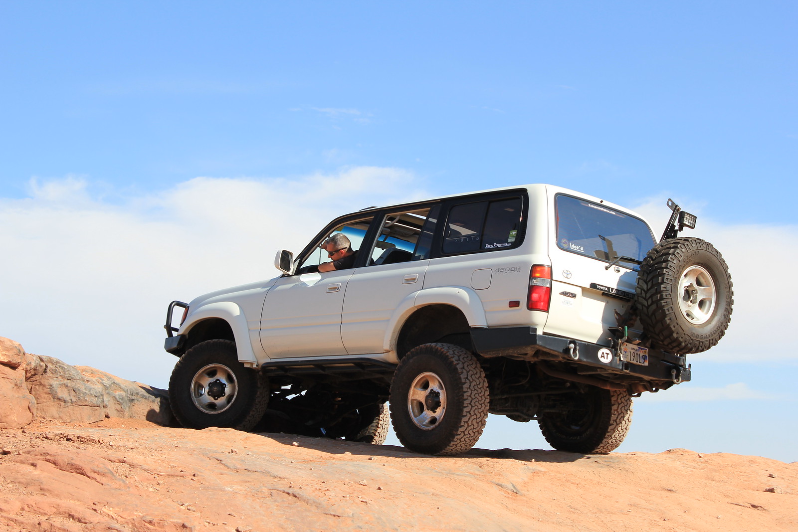

Here's my old 80 to give you an idea what stuff will come off of it.
IMG_1546 by Adam Tolman, on Flickr
Little background on this. My 1993 has over 300K miles on it. It has been parked for the last 2+ years because of some electrical issues that I haven't had time to sort out. As we got looking into fixing the '93 the electrical issues are probably easily addressed, but the motor still has over 300K miles on it and I would have it rebuilt to get it to be as reliable as I need it to be. So as we considered that cost it was more economical to find a "new" 80 with reasonable miles that I could swap my mods over to. That is what led us to this decision. Also, I will either sell off the '93 as is once the items are swapped over or part it out and will recoup some of the purchase cost of the new truck. So it should be a pretty cheap way for me to get back into a built and fully functional 80 series. I'm extremely excited about it.

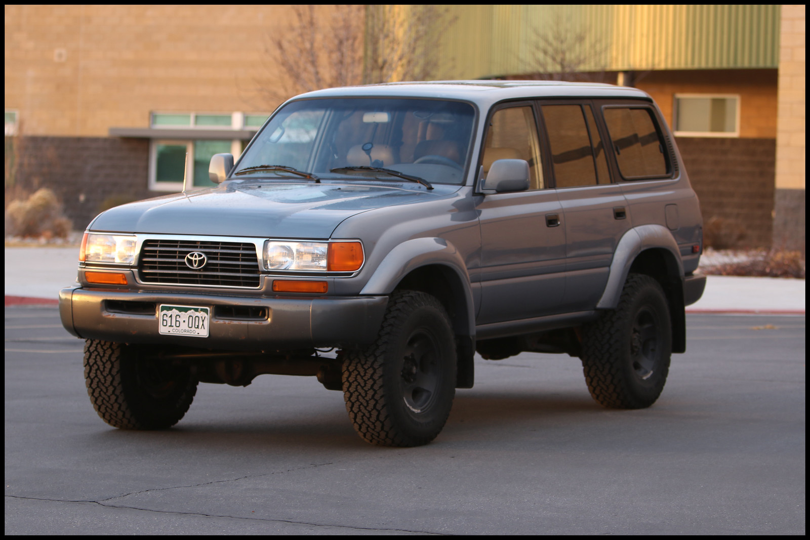

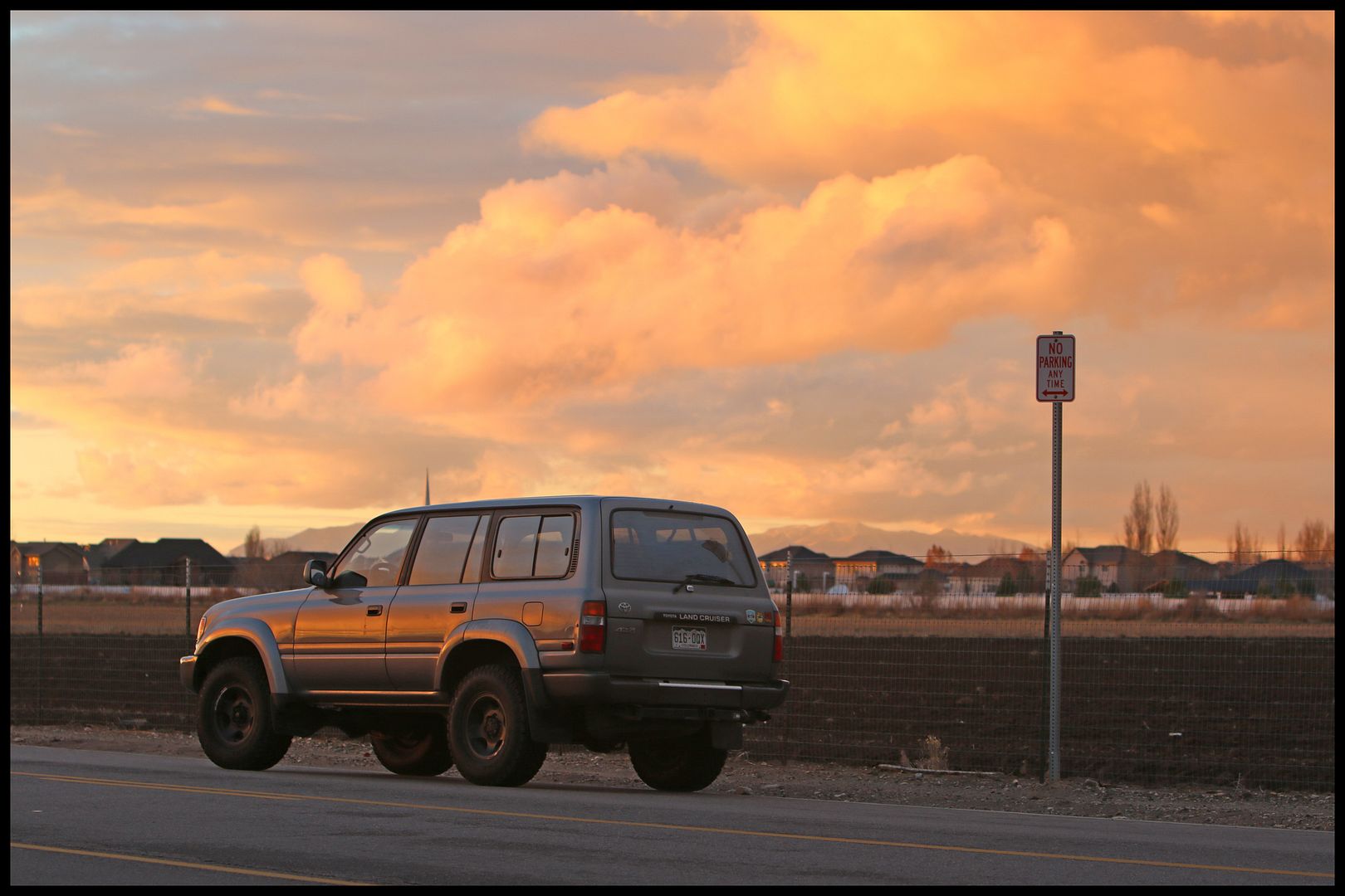

Got the new 80 home last night.

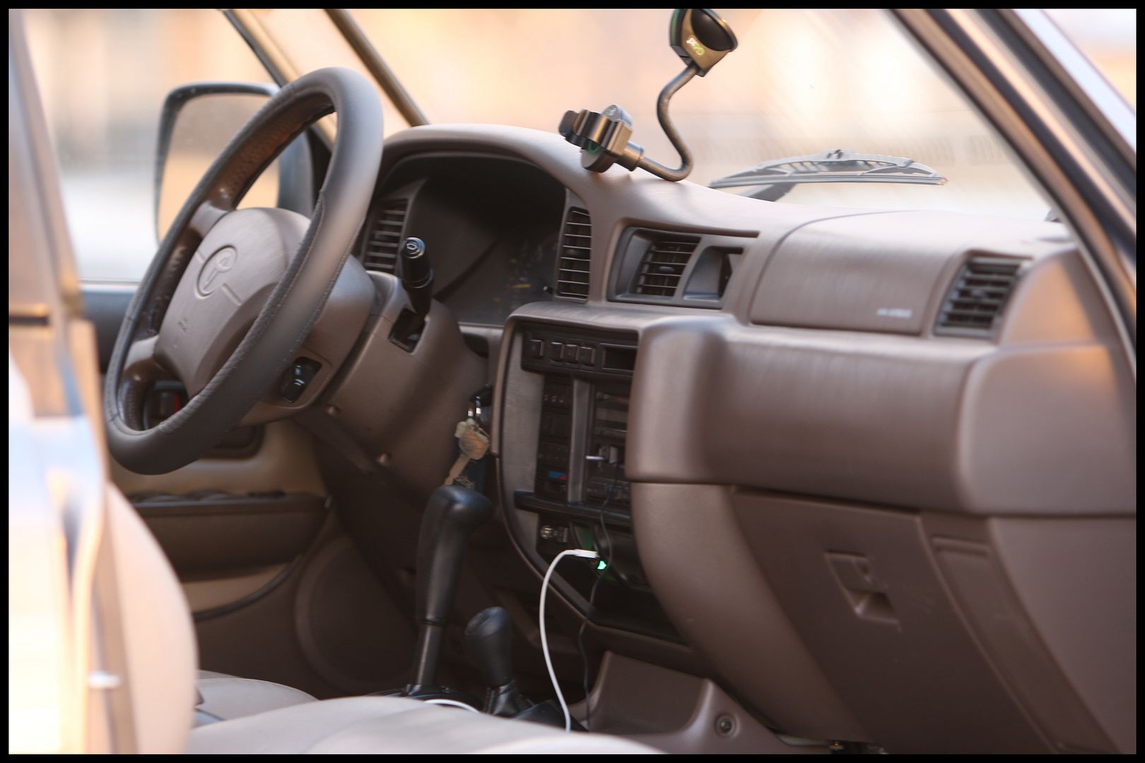

There are a few dings etc consistent with what you'd expect from a 20 year old car. Like a lot of 80s the front seats were trashed, split leather and bad foam. Before going to get the truck I got a lead on a pair of front seats in decent condition that were at a shop there in GJ. I arranged to go take a look at them after I bought the truck. It worked out great. It was a shop I'd never heard of called Metric Offroad that specializes in Cruisers. They had 20-30 trucks in the yard at the shop and the owner said he had another lot with another 40 trucks. A whole range of trucks from 40's to 80s and some 4runners and minitrucks too. Really cool guy and the seats he had were pretty dry but the leather was fully intact. We worked out a good deal on them with my new bad seats as partial trade. So the worst thing on the truck was fixed before I even got it home.
The rest of the issues with the truck are mostly cosmetic. The clearcoat is peeling on the hood, roof and flares. The front axle needs to be serviced and a couple other minor things looked at but it runs great and everything works. Even has lockers. The drive home was nice and it felt soooooo good to be back in an 80. The plan is to swap everything from my '93 over to it in the next few weeks. I'll use my OME J spring suspension, bumpers and sliders. I've ordered a set of 345/75R16's to go on the OEM wheels. So it should be ready to rock within the next month. My old 80 will get the suspension from this truck and keep the 315's that are on it and get the stock bumpers and then get sold cheap.

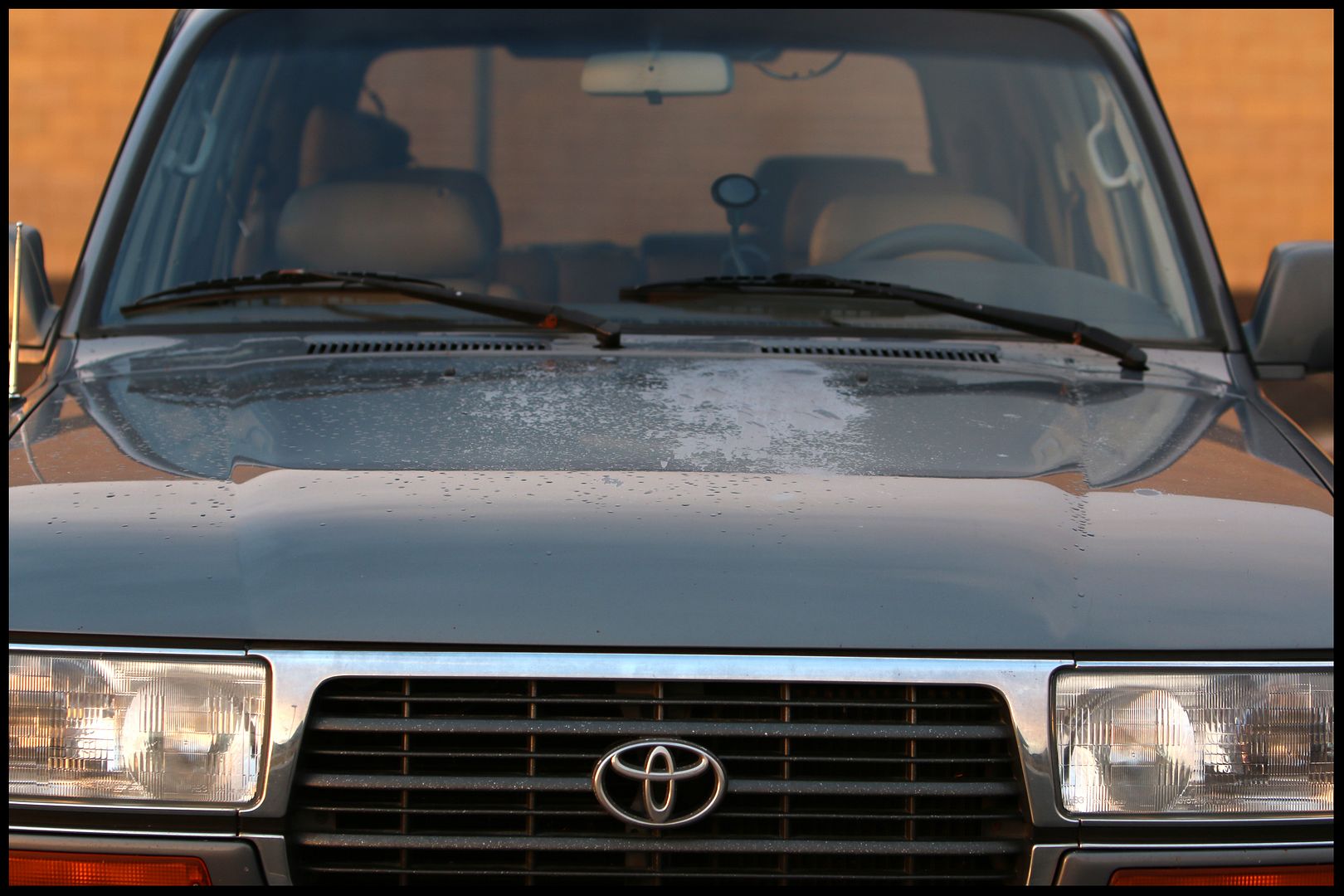

I already started cleaning up a few things. I painted the handles and the flares black and it is looking much better. I didn't get pics with the flares done yet so all you get is the handles.

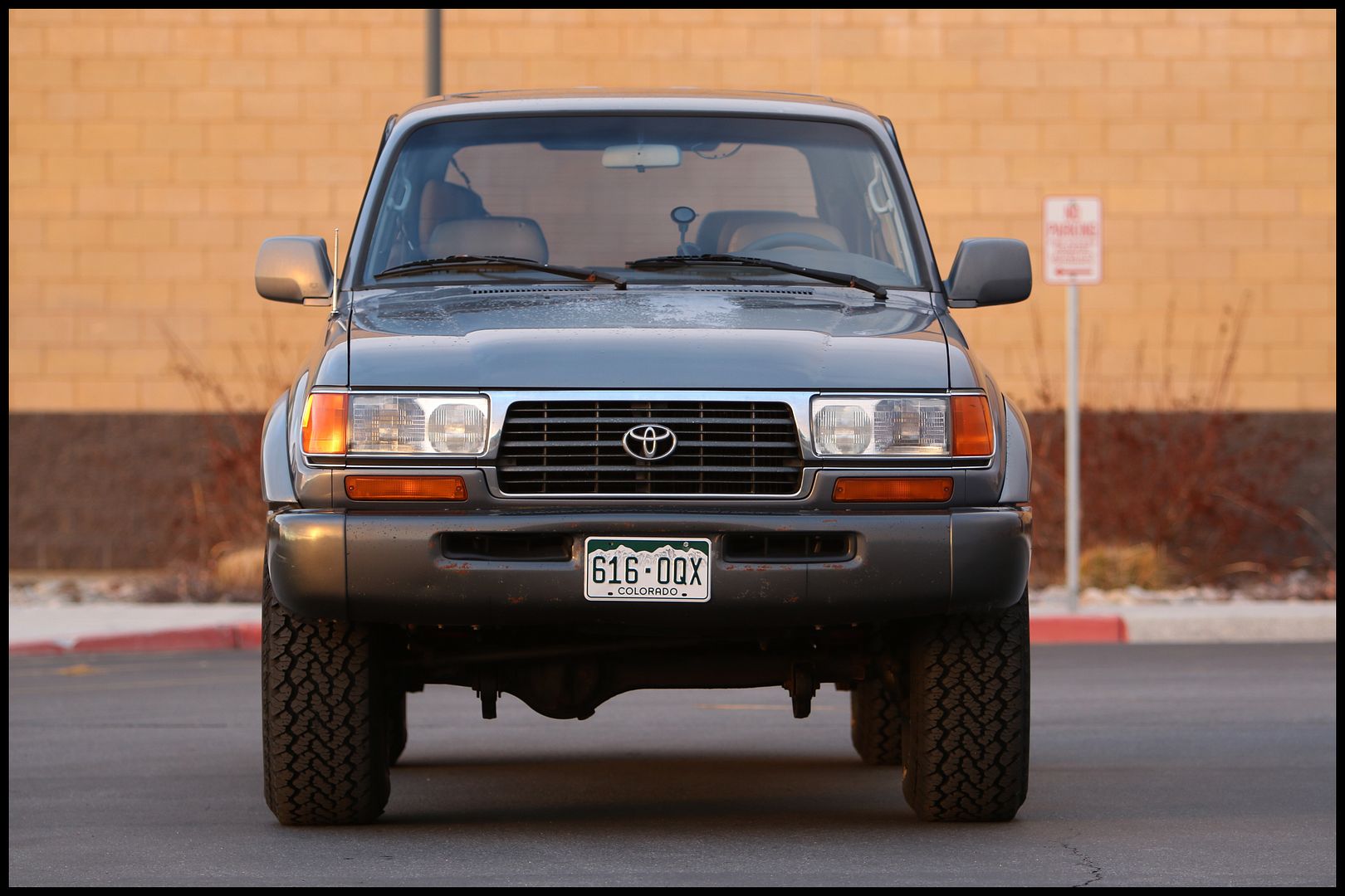

Here's some pics from tonight.
blacked out handles
peeling flares
peeling hood
