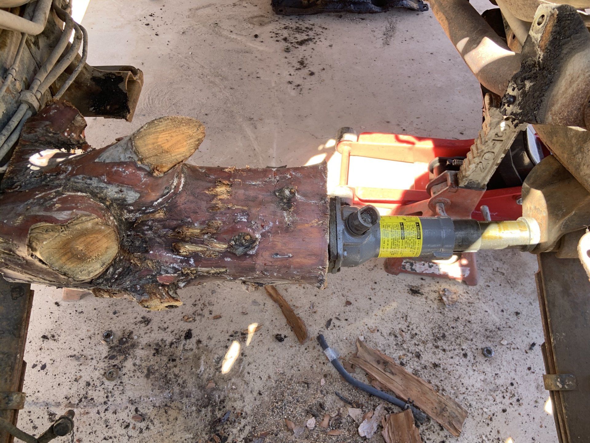

Dropped the welder off today and then went over to my Mom’s where the parts 60 is and got busy. Got the engine/trans/x-case removed. Got the front axle out.
Had to use the ol’, block of firewood and a bottle jack to press the spring hanger bolt out far enough to get a bite on it with an old crow-bar and pry those rusted b*tches out the rest of the way.
Manhandled the axle with springs and tires into the trailer and headed to the house.
