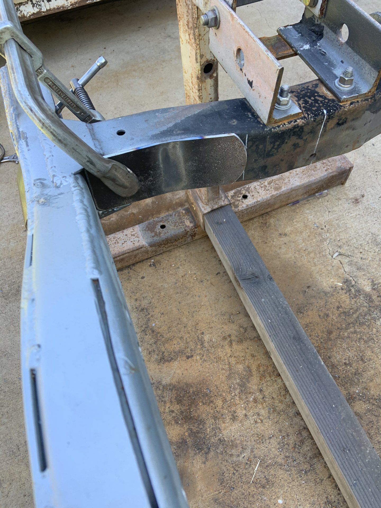

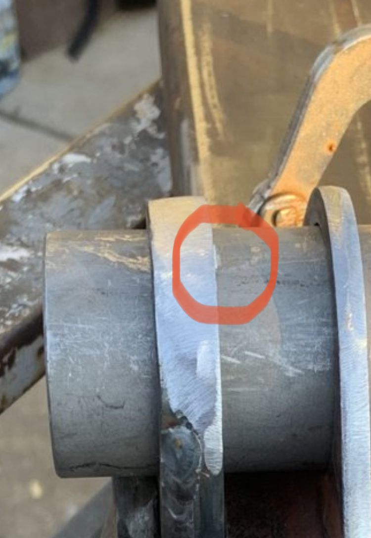

So looking at your bench built shackle mounts, you just marked center of the sleeve and lined that up with the outside of the first layer of 3/16”?

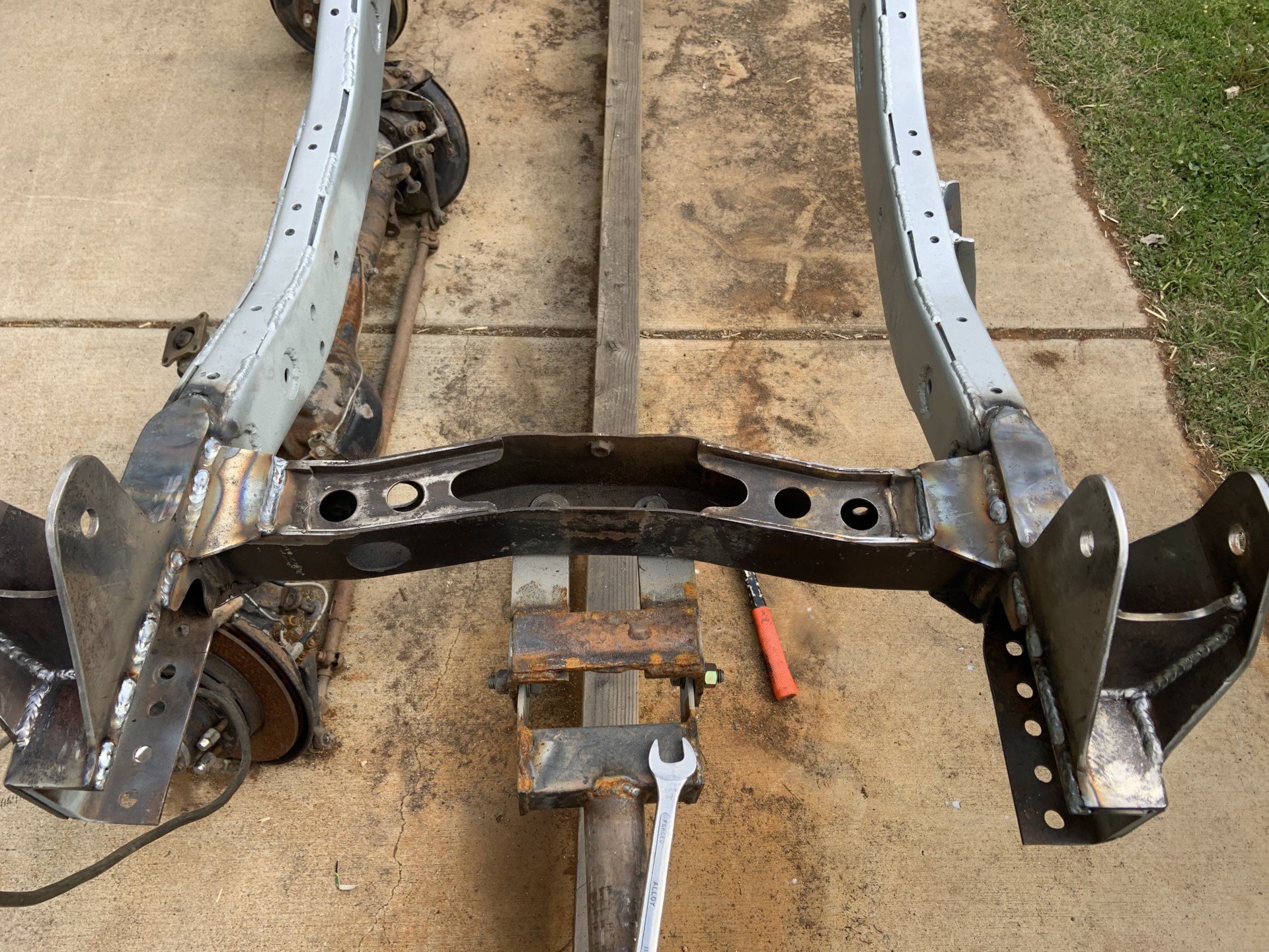

Every hanger is now fully welded. At one point I’d thought about just leaving them tacked until I got the new springs, and then adjusting the hangers to fit the springs. But since the new springs will be custom, the springs will be adjusted to fit the hangers.
I recently discovered a custom spring manufacturer in Phoenix called “Valley Spring Service” that I think I’m gonna go with because of the proximity. Based on their website, it looks as though they’ve been around the block a few times.

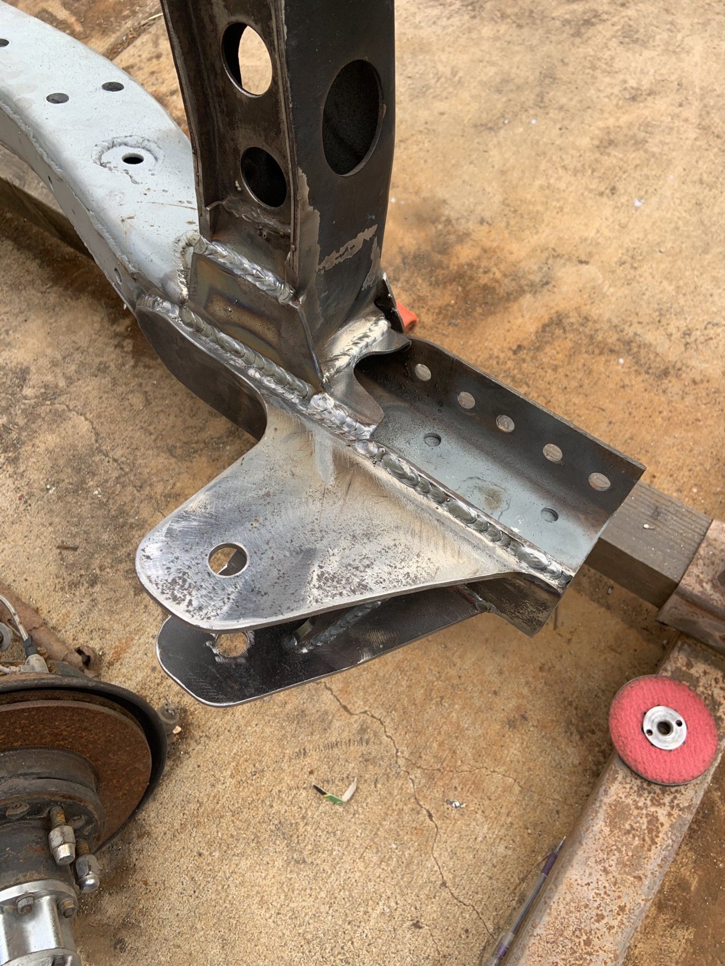

Today I added the front crossmember bottom tie-ins which have been more or less cut loose since I cut my stock front shackle hanger off years ago.
Since I have this welder for only a couple more days, I went ahead and took care of several of Ryu’s shoddy weld beads. It was his first day welding after all 😕

Nice work! I need a welding lesson from you... I get by but my beads don't compare to yours.
I cherry-pick the best stuff for pics. Been welding for 20 years and still try to find ways to improve, especially when seeing the work some of the high-end fab shops produce.
Ballistic Fabrication and Ruff Stuff both have some guys that do phenomenal work.
I looked up a couple videos awhile back about how to make MIG look like TIG. The basic jist is that you run it like you would 6011, one step forward, half step back. Some guys recommended turning your settings down a little cooler. Several times I also used a larger circular, curly-Q pattern if I needed the puddle to spread over a larger area.
