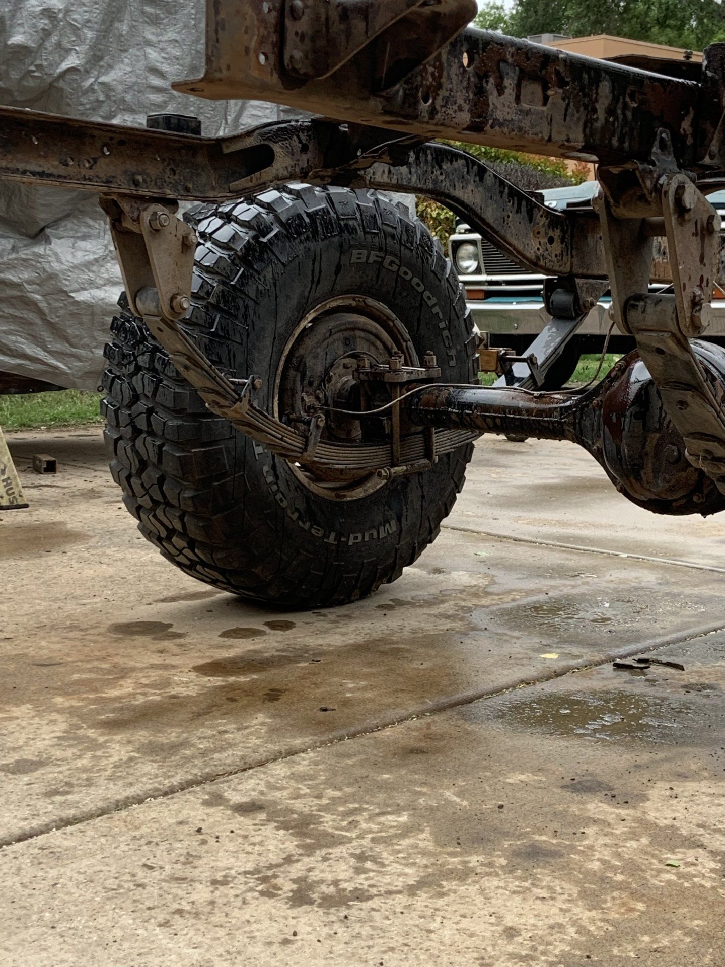

I took this pic so you could see why I’ve been entertaining SOA so much. These are the Alcans I bought in ‘08. The PN# FJ55R5002
Can’t remember if they’re supposed to be 6” lift springs or 5” in conjunction with 2” over stock shackles to achieve 6” overall. Either way, by looking at this pic you can see how easy a stock height spring with shorter shackle could fit on top of there, right? Well, not gonna happen anyways, but you can see it right there. The issue is that it always seems the ass end could use just a little more height, cause I just like it that way🤭😆
When swapping in the 60 rear, was thinking about outboarding the hangers, but since there’s so much room to move perches, I’m thinking about going that route, and then just reducing the perch to axle clearance by 1/2” or better to increase ride height. Also want to do away with those gawdy triangulated shackles and go to the “H” type with greasable pins.
The anti inversion shackles were recommended to me, so I have them on the floor with my new springs :meh:
The “H” style are also anti-inversion. Yours are probably stock length though, right? Not as gawdy.
I have to look, but yeah, they might be stock length 🤔 ...been awhile!

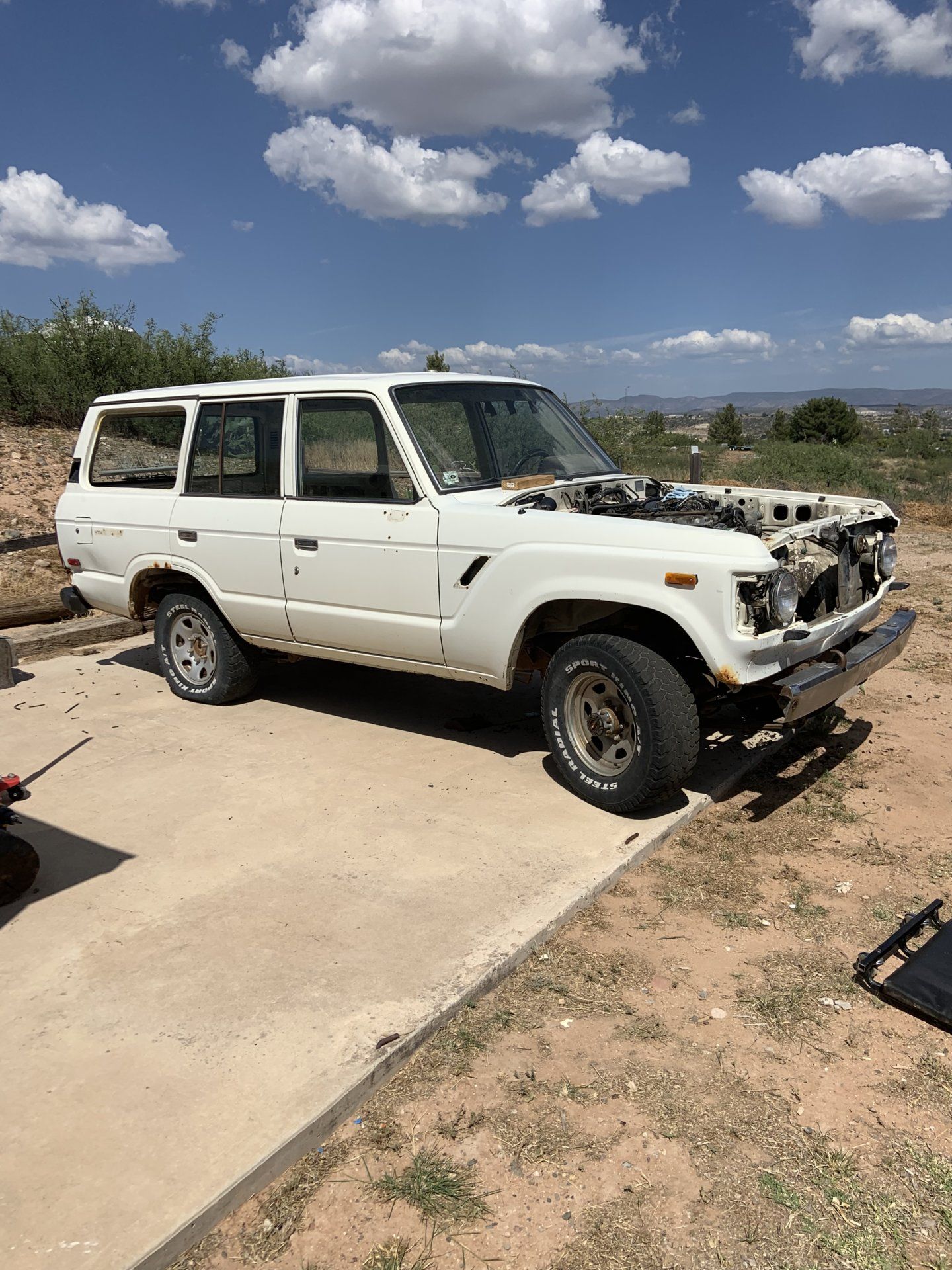

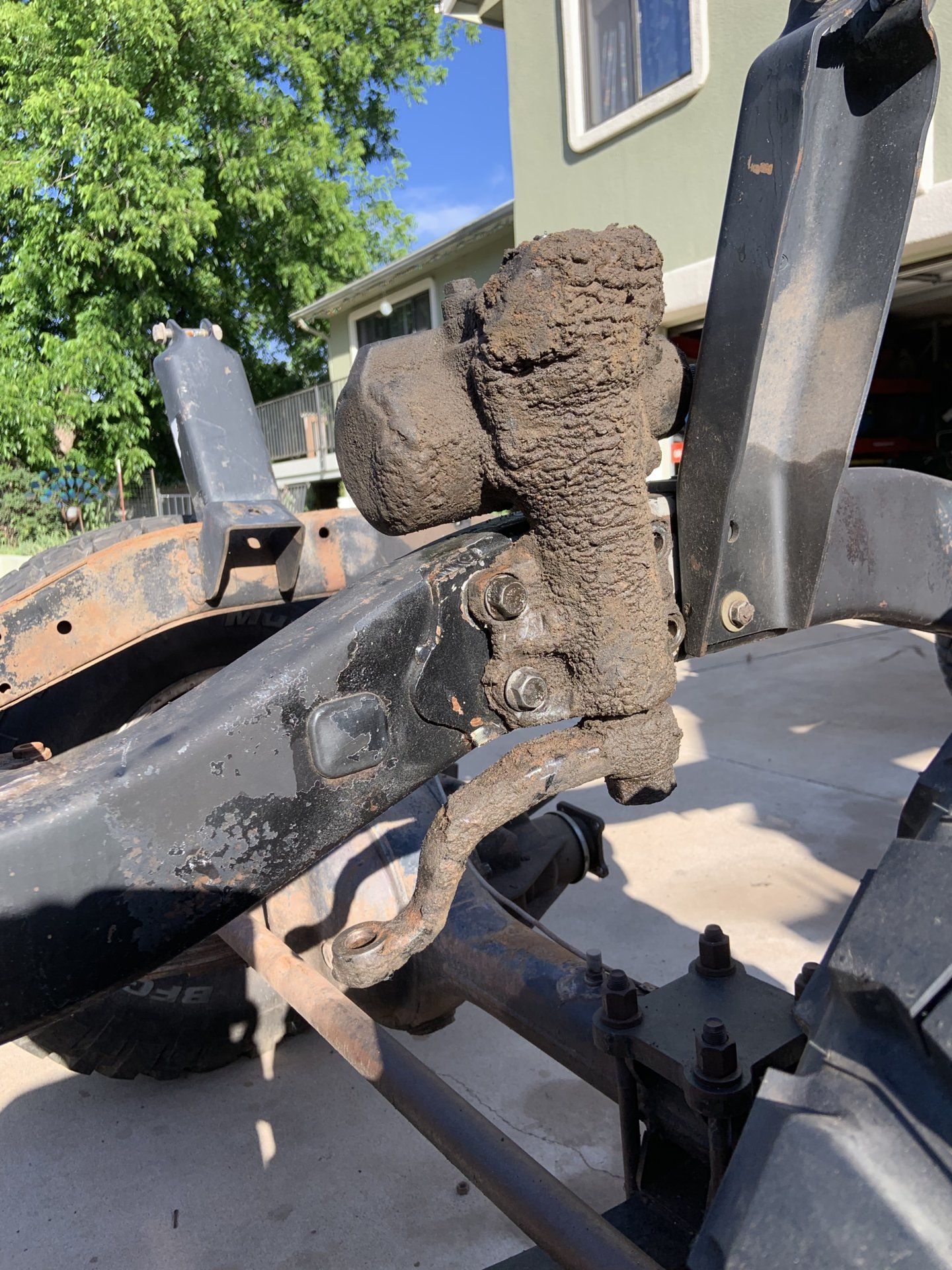

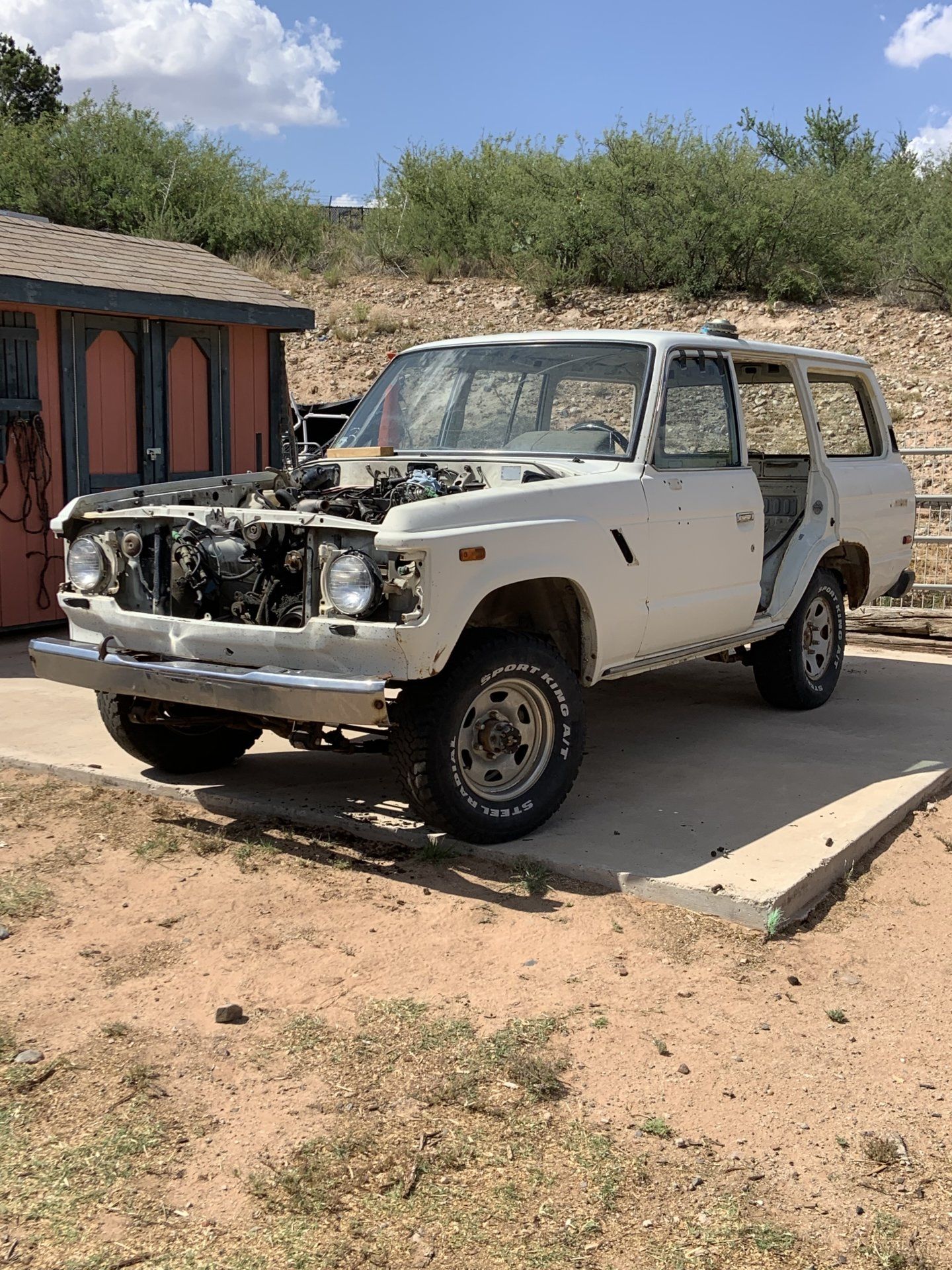

Went and spent some time dismantling the parts FJ60. The only part I got today that I’ll actually be using on my build is the steering box, and that’s iffy, considering what it looks like. Might end up being a good core.

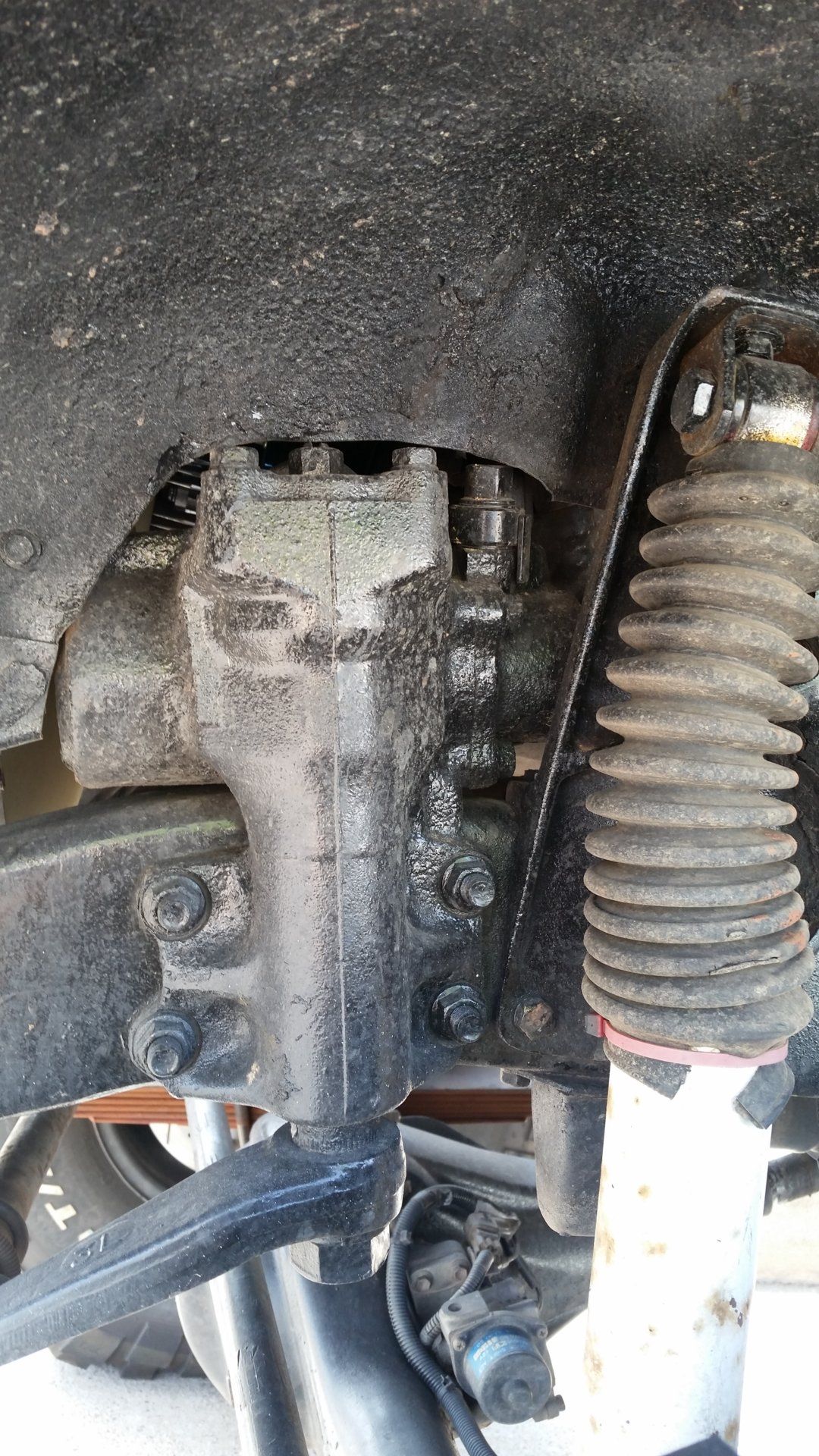

The front holes match up pretty good with the Scout box bolt pattern. Unfortunately, they’ll need to be filled and new holes cut and sleeved. Not sure yet if the Ford shock towers will be usable. Could possibly notch it. May go with shock hoops. Don’t know yet.
Somehow the pitman arm, even being dropped compared to the straight Jeep Cherokee pitman, sits further forward than the Scout, requiring the box to be moved back towards the cab. Not much, but just enough that nothing already in place will work.
Well it looks like your going to be doing exactly one of my tasks soon, looking fw to seeing your progress on the shock mounts & steering box. (Man that thing is ugly, mind you my 62 box is a mass of rust)
