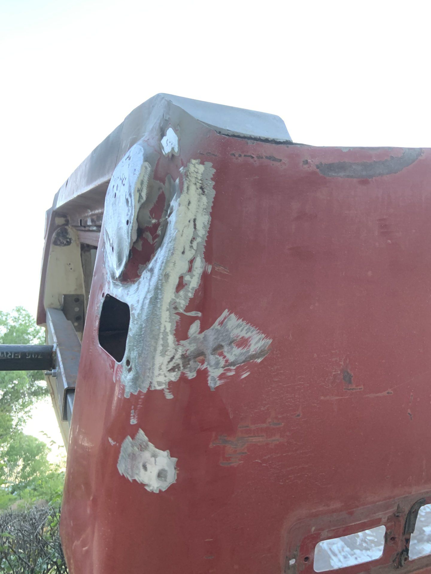

Doing some body work on the crunched drivers side back-up Light/reflector area. This was some PO damage before my time. Want to at least make my best effort at repairing it and the few other areas that need straightened out. Once I get this done, then I can cap the quarter panel.
Did quite a bit of the work using this little tool I made. Weld 1/4” bolts to the sheetmetal and then use a slide hammer to pull it out. Worked OK. Popped out a plug of metal if I got too aggressive too soon. Worked better if I welded two sides of the bolt head. Tried cutting off the heads and welding just to the shank, but had a higher frequency of pull-throughs. Got most of it out. Still a little more to do before committing the rest to bondo or solder.
