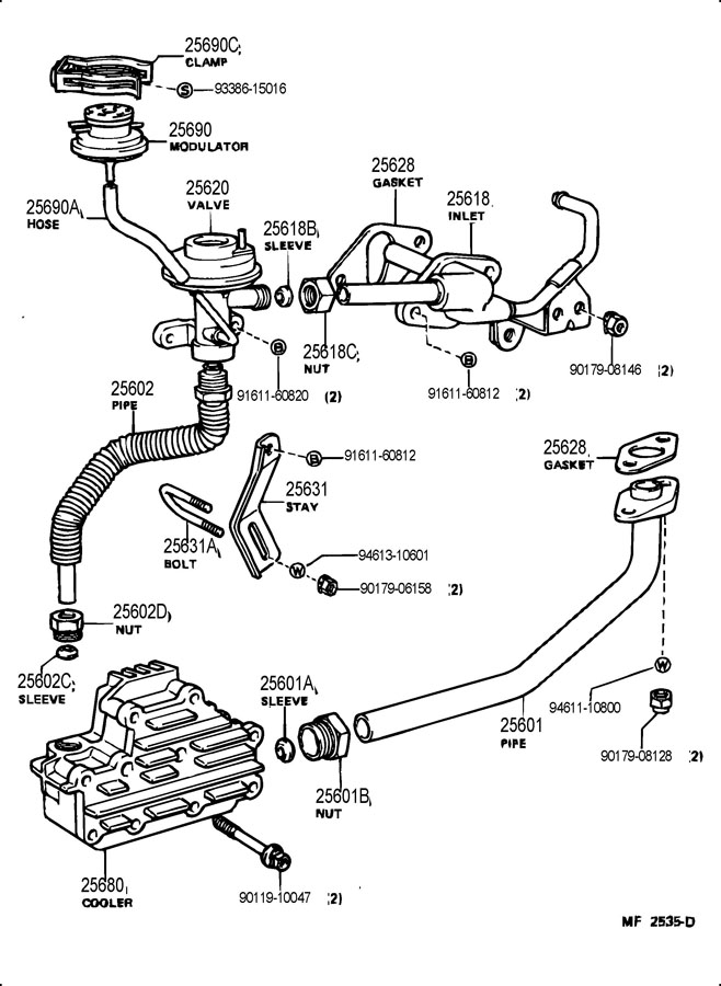

Can anyone let me know what goes here? Side of where the carb goes. By the time we get to work on it again, crudZ will have the replacement anyway, but I'd like to know ahead of time.

That was where part of the EGR system went, it went to the EGR valve as well as to the PCV. I capped the left (JimC part) and still use the PCV side, someone else can chime in by I'd imagine you can still utilize the vent from the manifold, perhaps a "Y" at the vacuum port for the brake booster.
Part 25618
