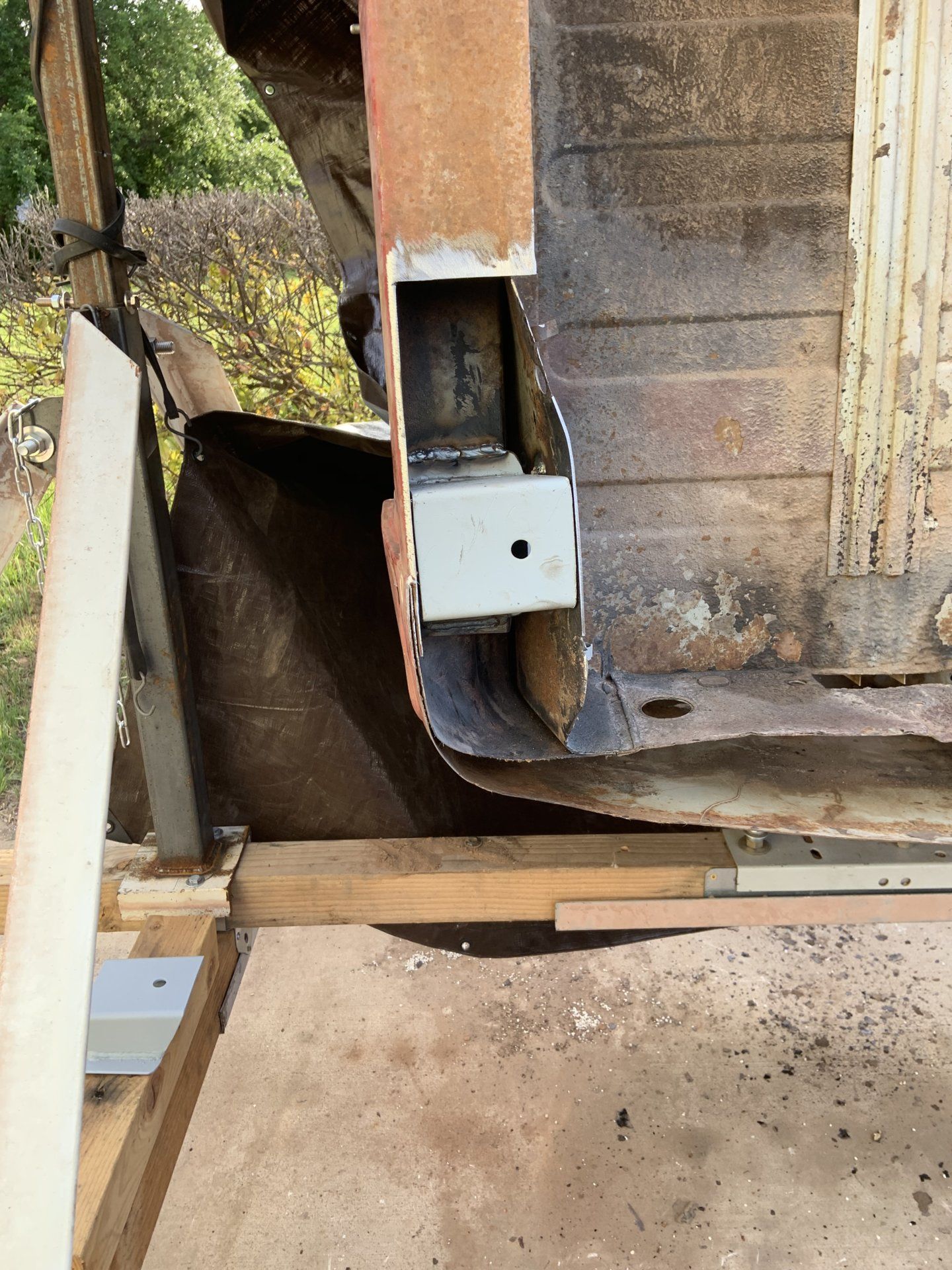

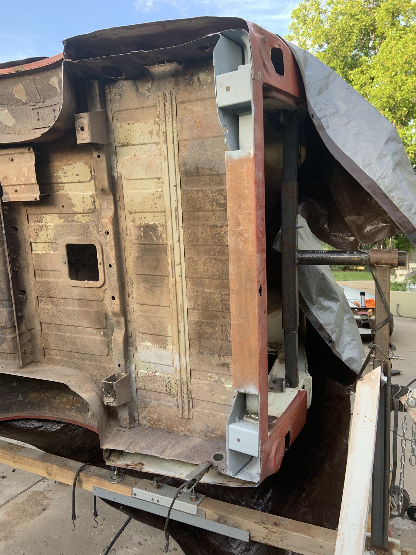

More #tubfun today with a little more #progress

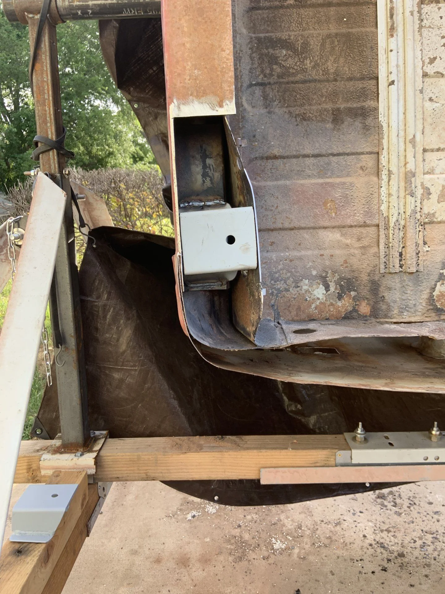

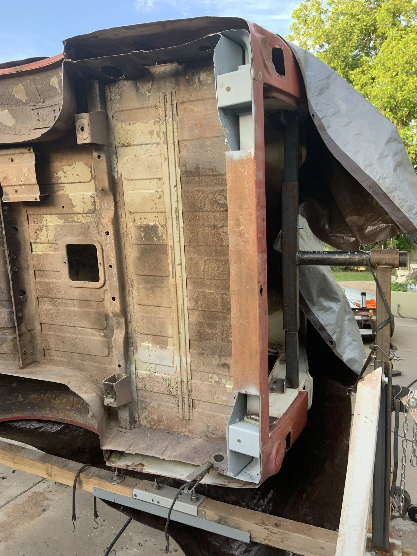

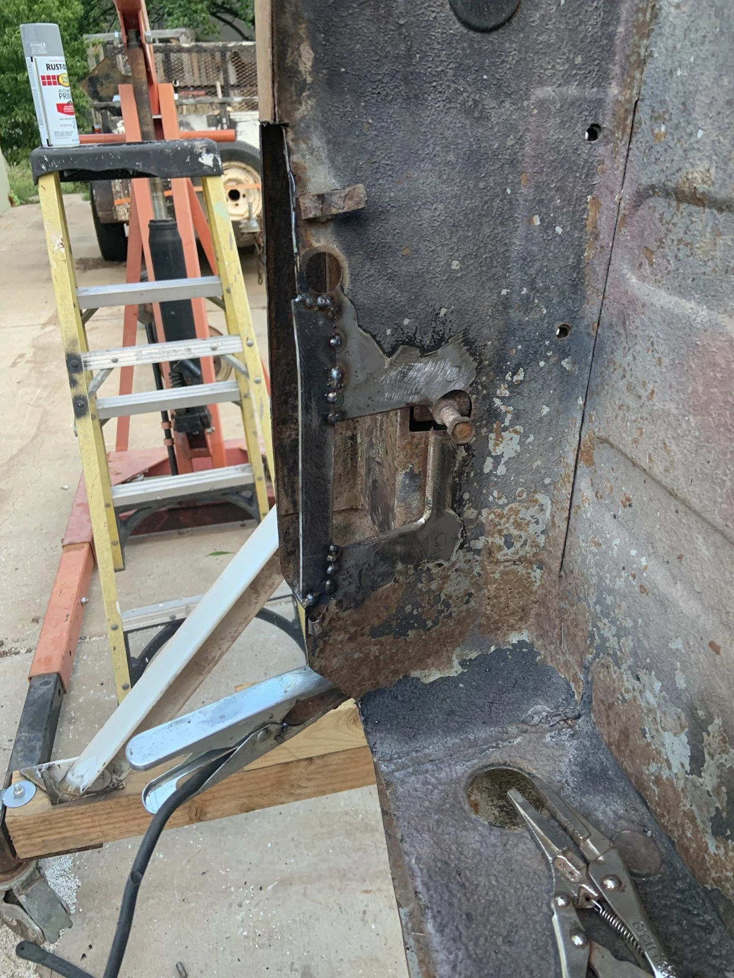

Been a constant battle with porosity in the welds due to MIG welding outside in the open air, not to mention the constant wind and threat of rain. Came up with the ingenious idea of draping a tarp over myself and the area I’m welding. The welds came out great and I didn’t asphyxiate - win/win💥🎉💥

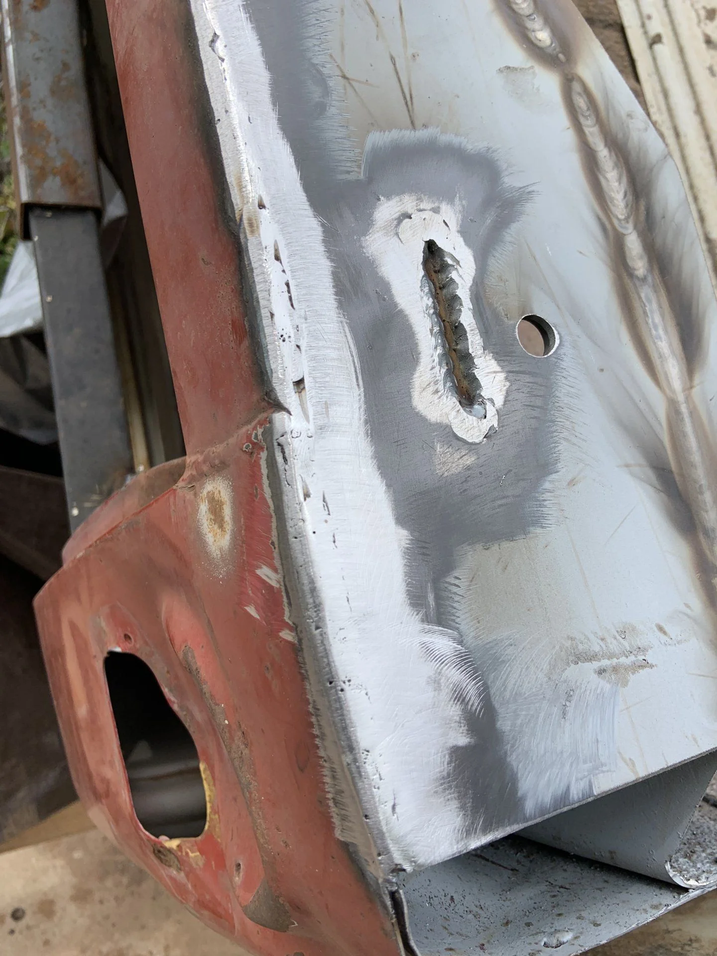

So here you can see the porosity in the metal. I ended up digging out each area with a burr bit and refilling the spot under cover out of the wind. Turned out good.

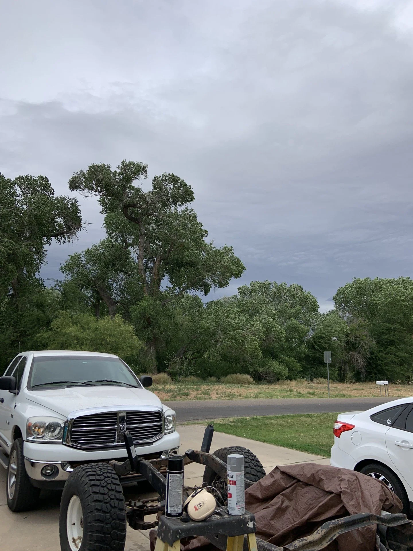

Here’s what I’m dealing with - looming storm with 10 - 15 mph wind bursts and I’m just too determined to give in.

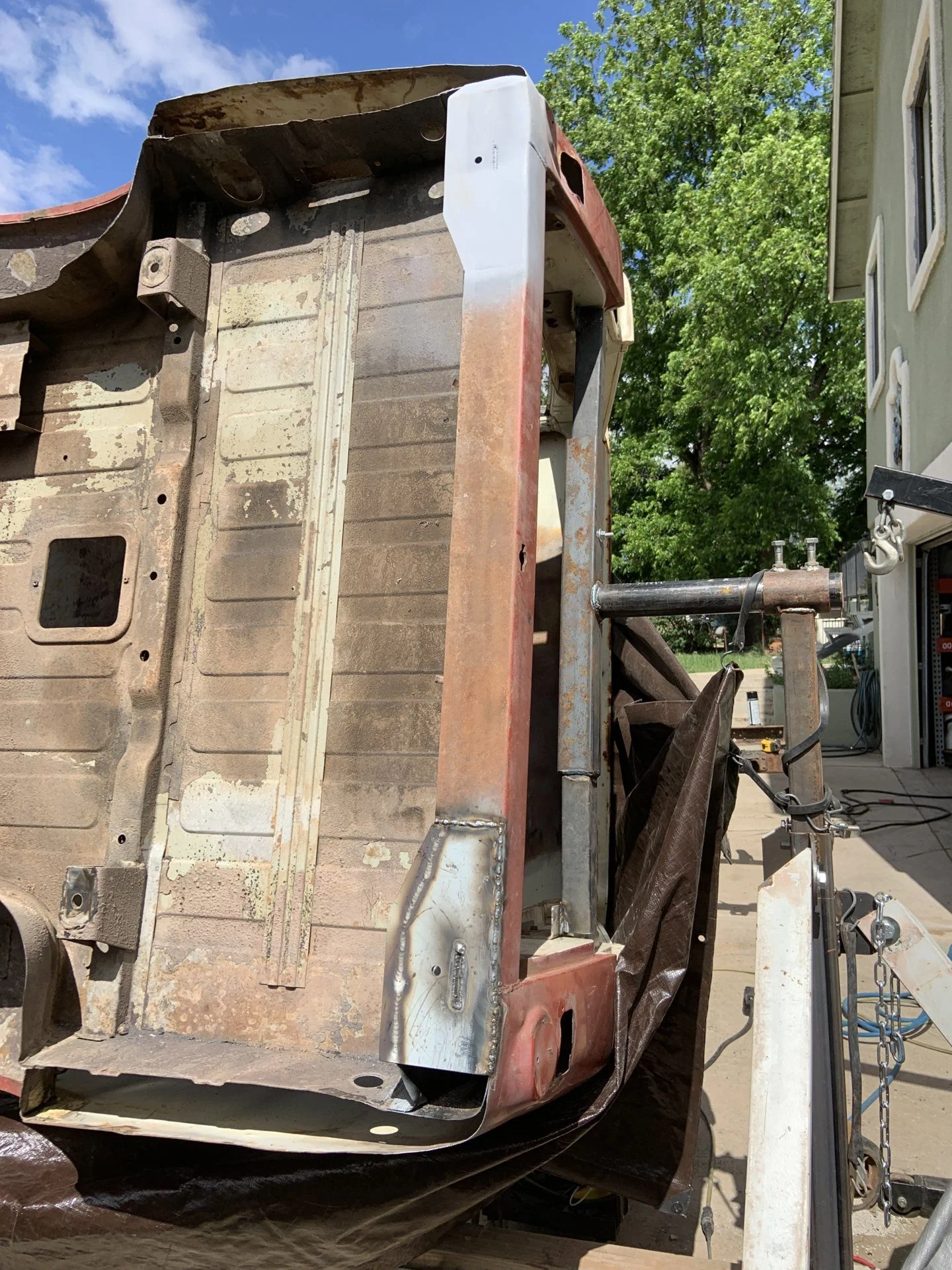

Driver side done and onto the passenger.
