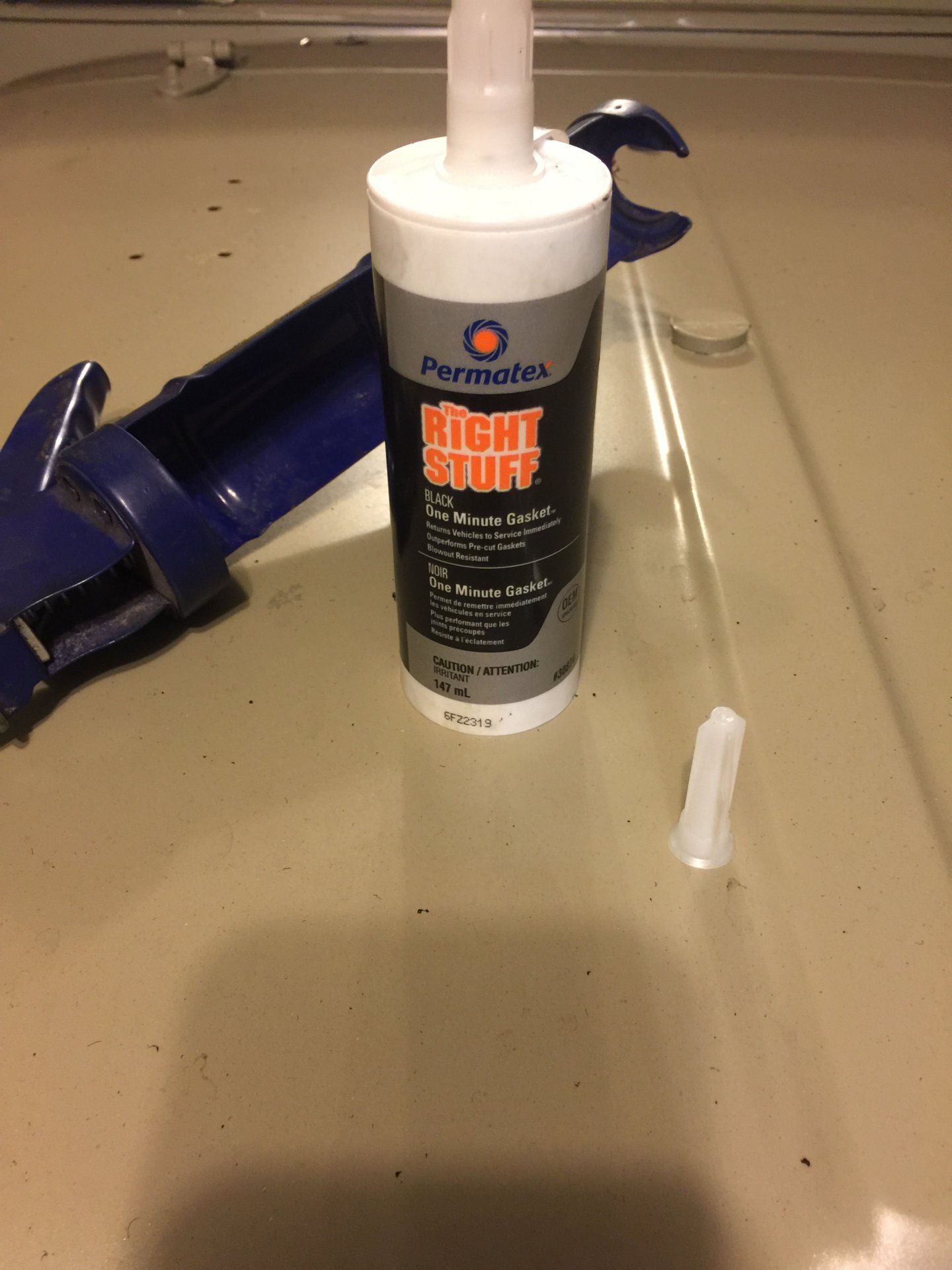

I’ve used the Grey Right Stuff almost exclusively for awhile now. Diff/housing, all the cork gaskets on the motor, works great for that. The Ultra Grey does as well.
I used the black Right stuff at my old work on a bunch of axle housings and it worked for me as well.
On that transmission it’s just Permatex Hightemp Red
They’re probably all the same honestly.
One important thing to note is when using it on motors is to be careful not to use too much, on this last motor I had a bit of oil starvation on my mains from a chunk of RTV getting caught in one of the journals.

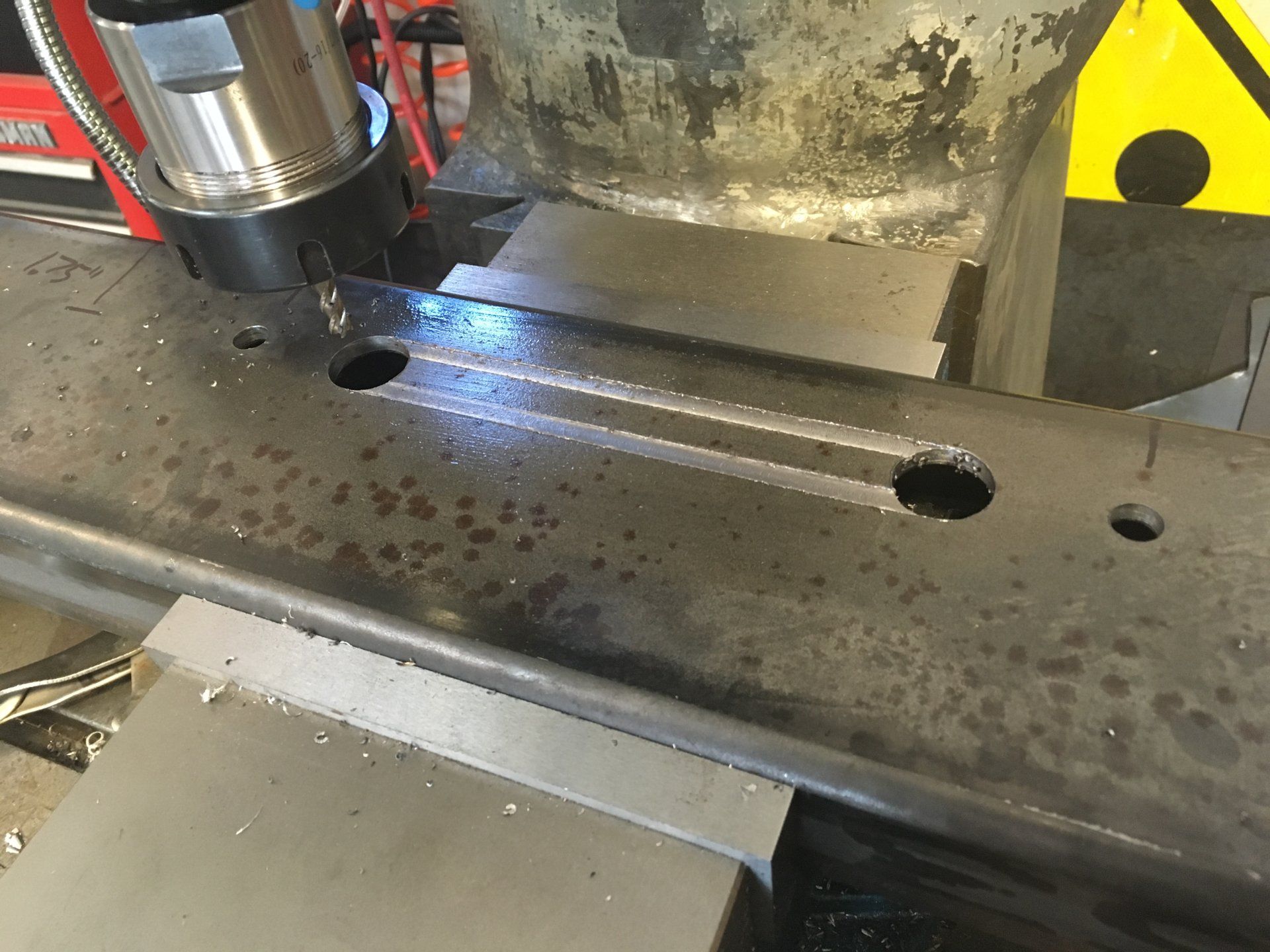

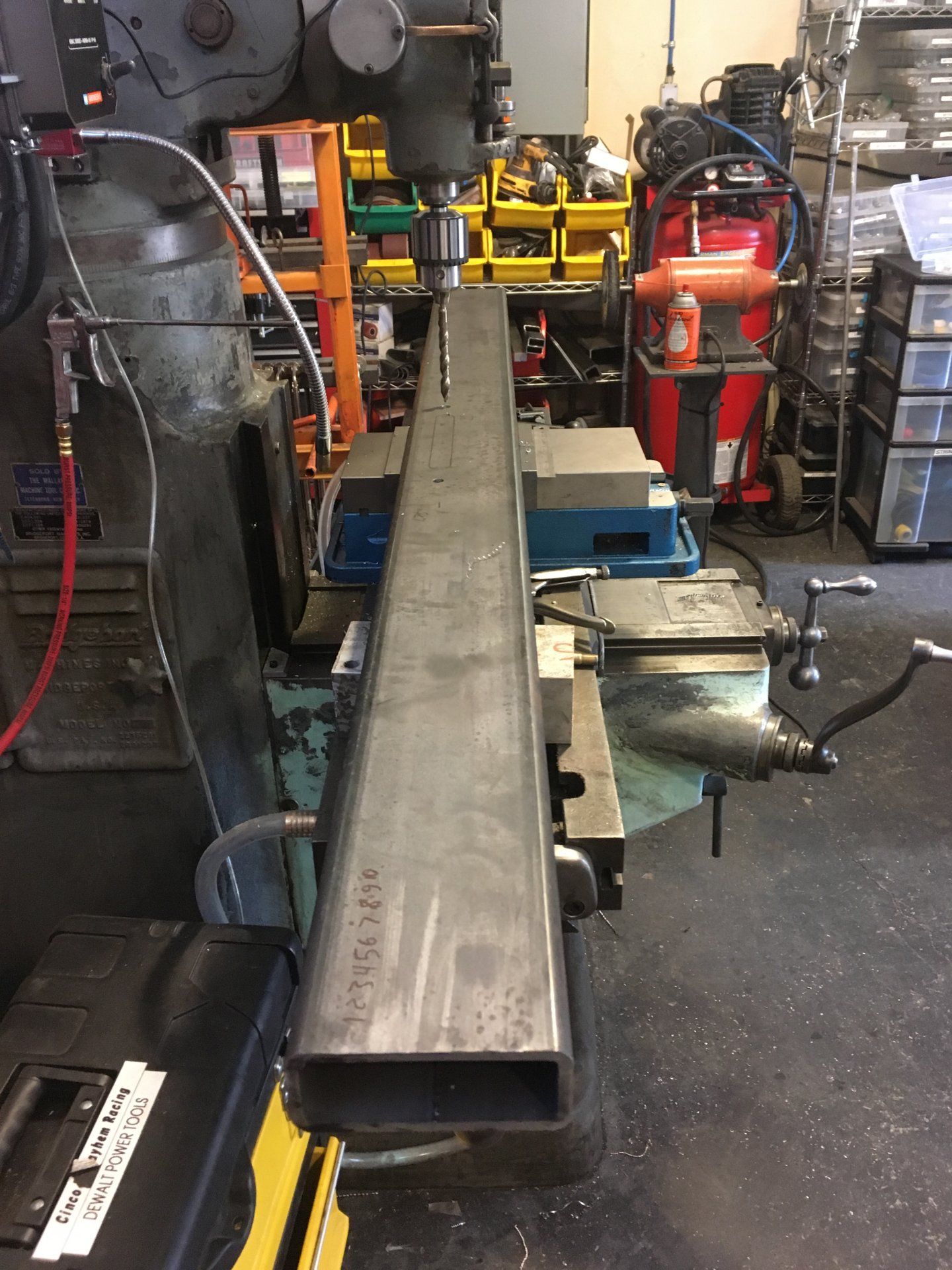

Start with a couple feet of 2”x5”x1/4”.
Drill and mill some holes and slots into it

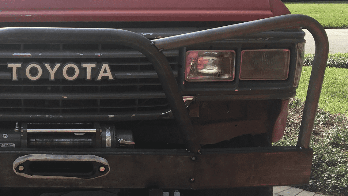

Still need to make mounts and cut the rectangle tube so it tapers towards the ends so it looks less farmtruck hokey. Waiting on plasma cutter to be done at repair shop.
I wanted to copy the Rockware bumper for Land Rover Defenders, I made mine look a little bit meaner though by angleing the headlight surrounds, I may change it for the more classic look though.
Either way just something quick and simple, I was going to go crazy with CAD and waterjet and tube but couldn’t really decide exactly what I wanted.
Either way it’s bolt-on (for me) and only $150 of steel so if I can always make a new one if I want.

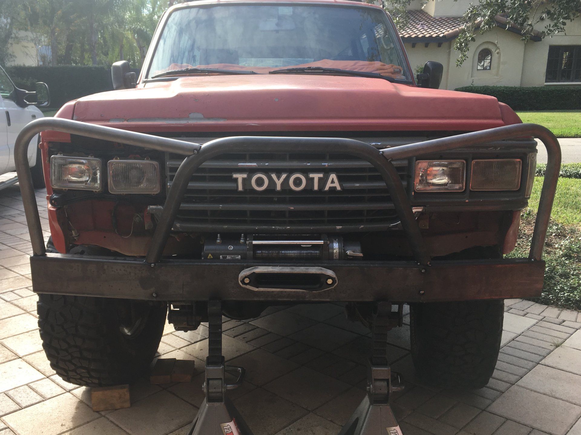

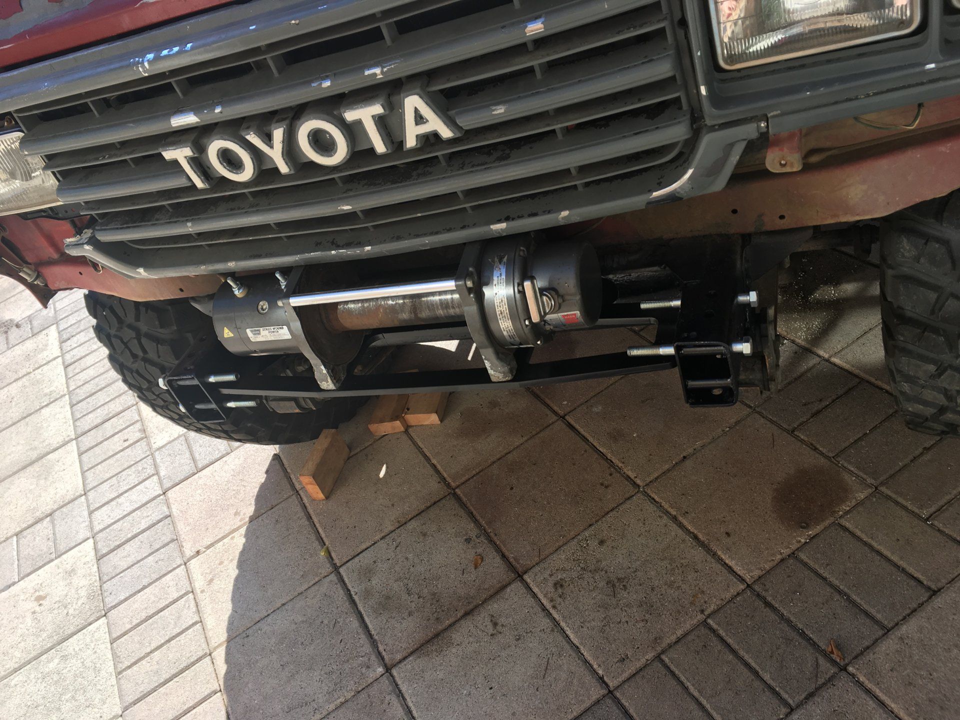

Here it is with paint and the winch bolted down, I actually don’t have a line for it, I tossed my steel line with the old winch to force myself to buy a synthetic line.
I also need to put the lower valence panel(s) back on, I need to trim them little more.
That bumper needs a spring over.

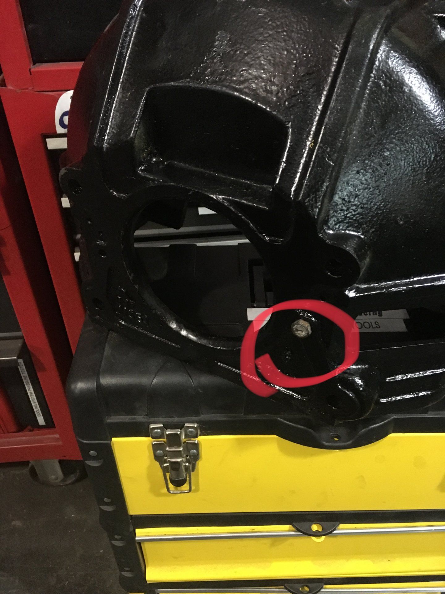

I don’t know if I ever posted about this but when I put this drivetrain combo in the truck last summer I forgot to put the clutch fork pivot pin back in the bellhousing. The issue is the adapter plate on the back of the bellhousing isn’t reliefed for the bolt head of the pivot pin because it isn’t designed for my bellhousing.
What I did at the time instead of pulling everything back out, I made a stud and just JB welded it in place. It didn’t hold but the combination of the clutch slave, input shaft and pressure plate kept it functioning. Pretty Hack.
So, with this knowledge now I milled a pocket in the adapter plate.

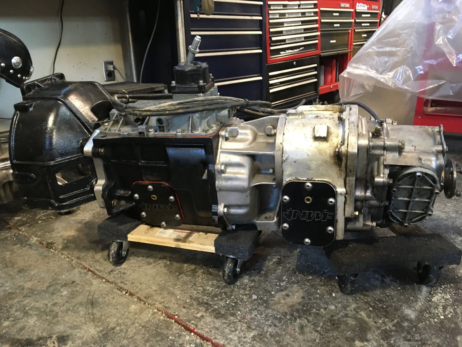

Got all the grime cleaned off the 203/splitcase, and put in a missing spacer for the splitcase Hi-low linkage (other wise it drops about an 1/8” into the case and you can’t shift it). I lost/discarded whatever the original washer/spacer was supposed to go there but a Porsche headbolt washer works perfectly.
I know I said I was going to put 4:1 gears in but I got thinking again, if I go up in tire size (to 37’s) then the hi-range reduction from the t-case gears won’t be enough and I’ll have to do diff gears anyways. And I own a pair of locked 4:88:1 third members which would be right for 37’s... although I bought the diffs for something else they might find their way here. Need to decide.
I also had a couple of the big bolts holding the splitcase to the adapter come loose a few times while I was driving this setup so I
put a bunch of red threadlocker and torqued em down right again.
If it is still an issue I’ll helicoil the threads.
Then I bolted that whole deal to the Nv4500. And then put the whole thing into the truck. Nice to have the whole thing just bolt up, shifters, driveshafts, etc.

Jesus that's a long drive train! DS must be getting short.
Yeah its hefty alright... long enough I nearly tipped my engine hoist trying to put it in attached to the motor last summer ( engine hoist fully extended).
Rear driveshaft is only about 6-7" shorter then an FJ62 automatic rear driveshaft so it's not too bad. I've run it up to about 100mph with no vibrations.
