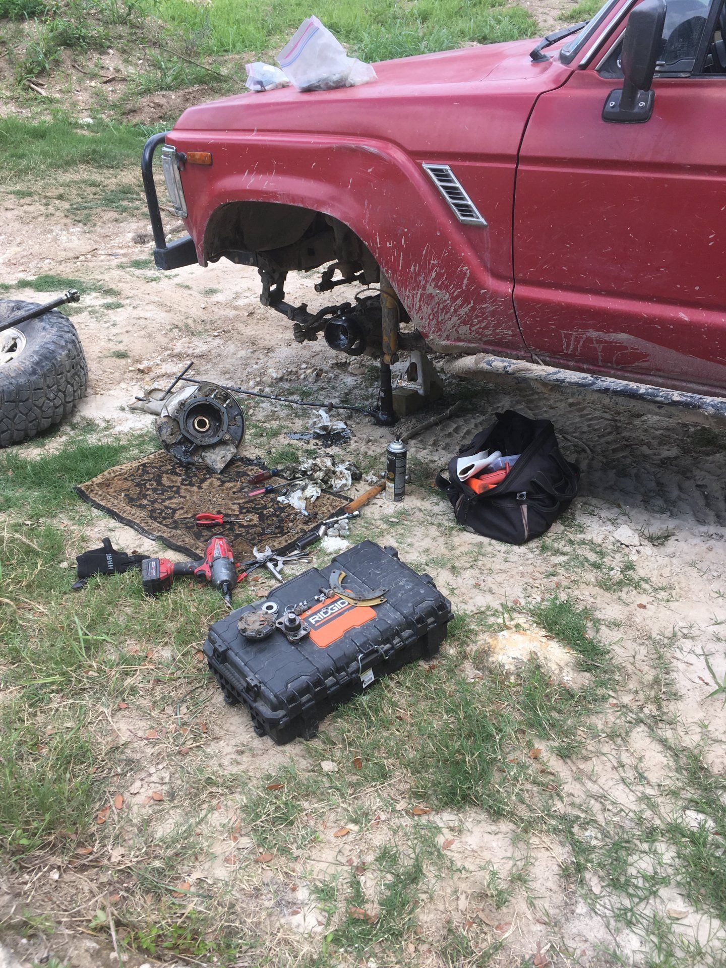

Ended up being the distributor was 180 out, which happens to me EVERY TIME! :rolleyes:

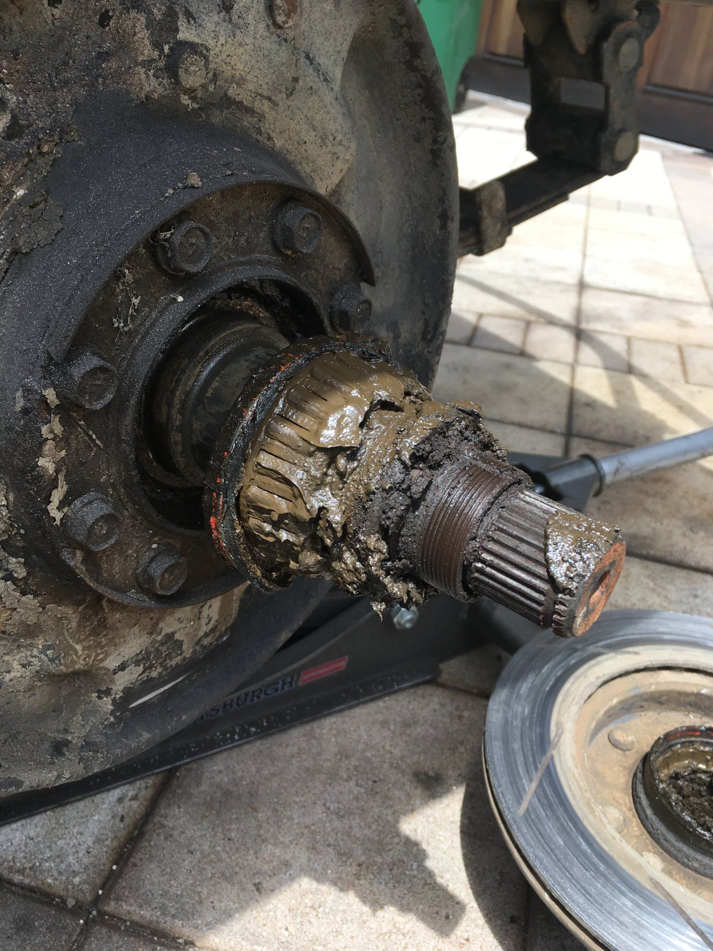

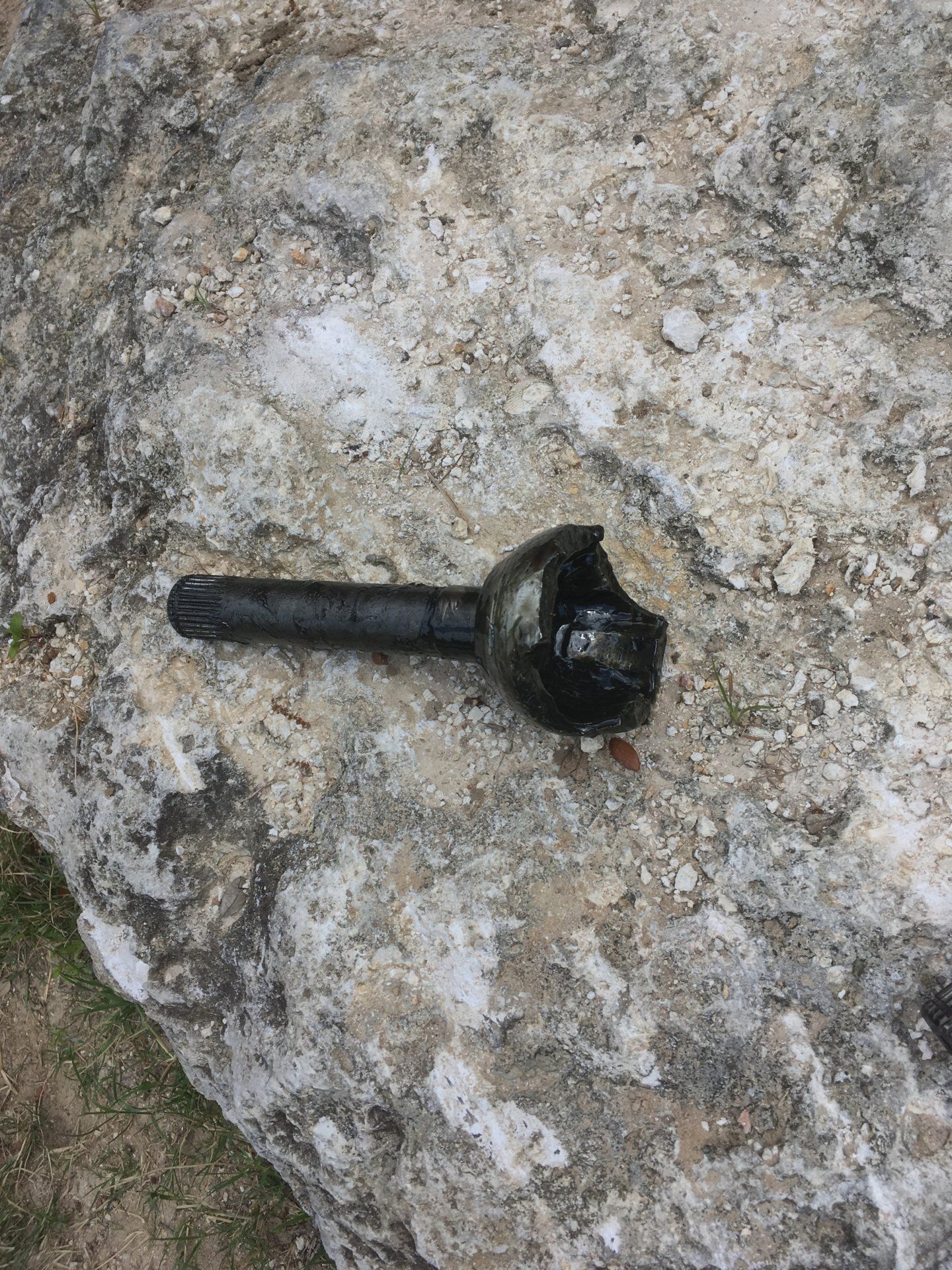

Anyways, got it running and proceeded to beat the s*** out of it off-road breaking another longside birf on and destroying some wheel bearings and a spindle on the other side.

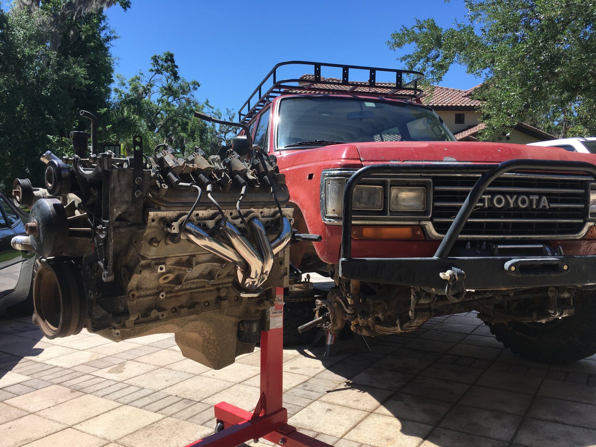

Sweet! V8s belong in 60 series rigs in my opinion. I do ok with my 2f in my 40, but I don't know how people can handle f series power in a 60 or 62 series. Is it a 4.8 or 5.3 or bigger? Do you have emissions where you are? Got any pics of the longfield carnage?
It’s an L33, so 5.3, all-aluminum with the LS6 799 heads. Also a better cam then the normal truck cam. Known as a “5.3 H.O.”
It’s out of a 2006 1500 Extra-cab 4wd.
I actually broke another stock birf.. I said after this one I’ll put RCV’s in but I still have one more set of stock spares, and I’m picking up an FJ60 front axle next weekend for something else... so I’ll have more stock spares to keep breaking! I think this is #5 or #6.
Matt why don’t you simplify things and reduce your labor (future) by upgrading your axles? Will eliminate any frustrating downtime on the trail as well. Look forward to seeing the V-8 build.
You’re right, however stock axles seem to keep falling in my lap??

On a side note, I’ve gotten very fast at swapping them out, less then an hour easily. I did one at GSMTR in a half-hour.

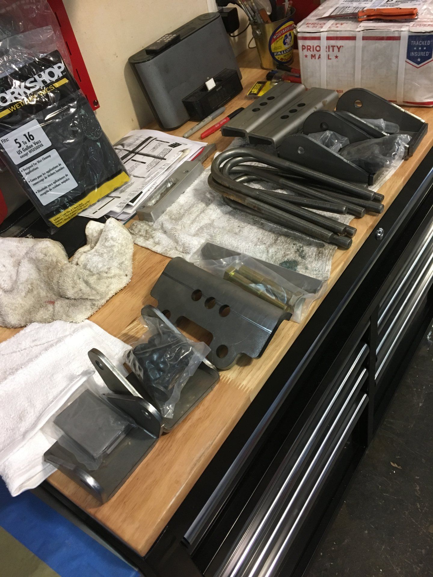

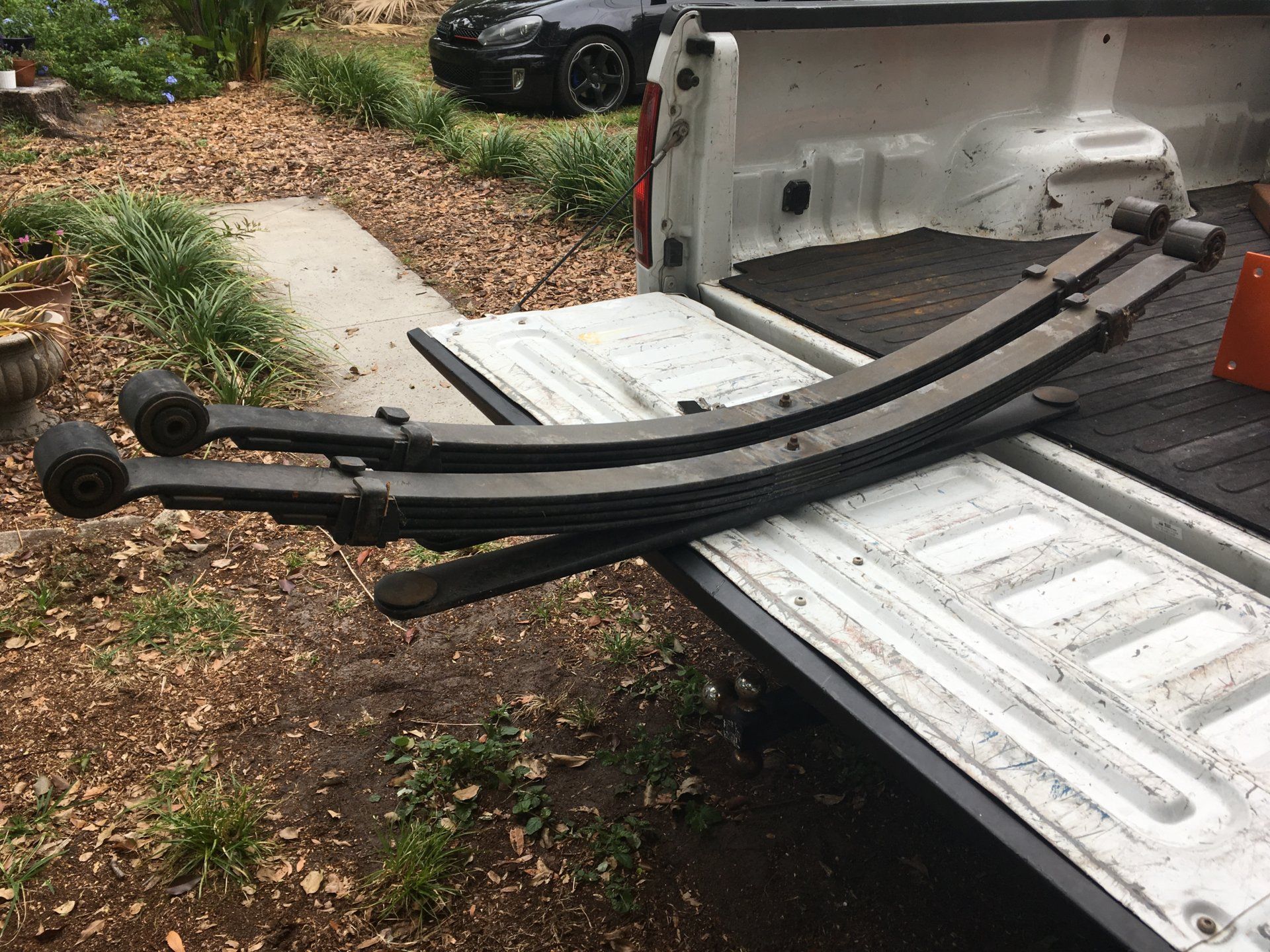

Looks like some replacement spring hangers in there. Are they designed to go with stock springs/location?
I put together my own custom kit, I’m going to 63” Chevy 3/4 ton springs in the rear, and my current front 2.5” lift springs will be staying. They are getting old so they are probably the equivalent to stock springs with an A-A-L. However I will be doing a shackle reversal and moving the front axle forwards an inch or two.
But upper shackle bolts front and rear will be frenched through the frame.

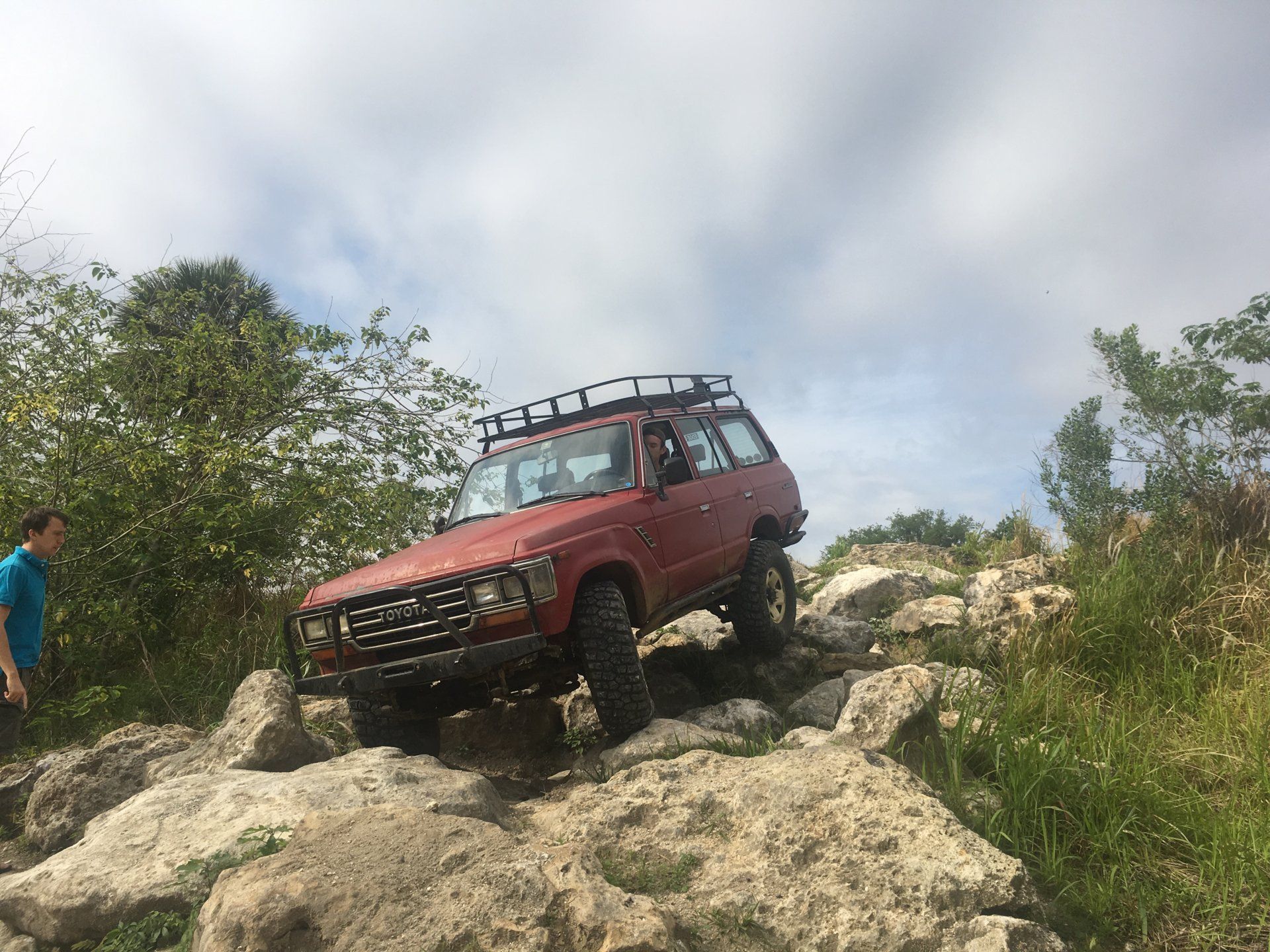

You had some nice articulation
Great crawl. I love seeing the difference in rock from area to area. Truck looks awesome. Agreed w/ the articulation... that rear tire was totally stuffed.
