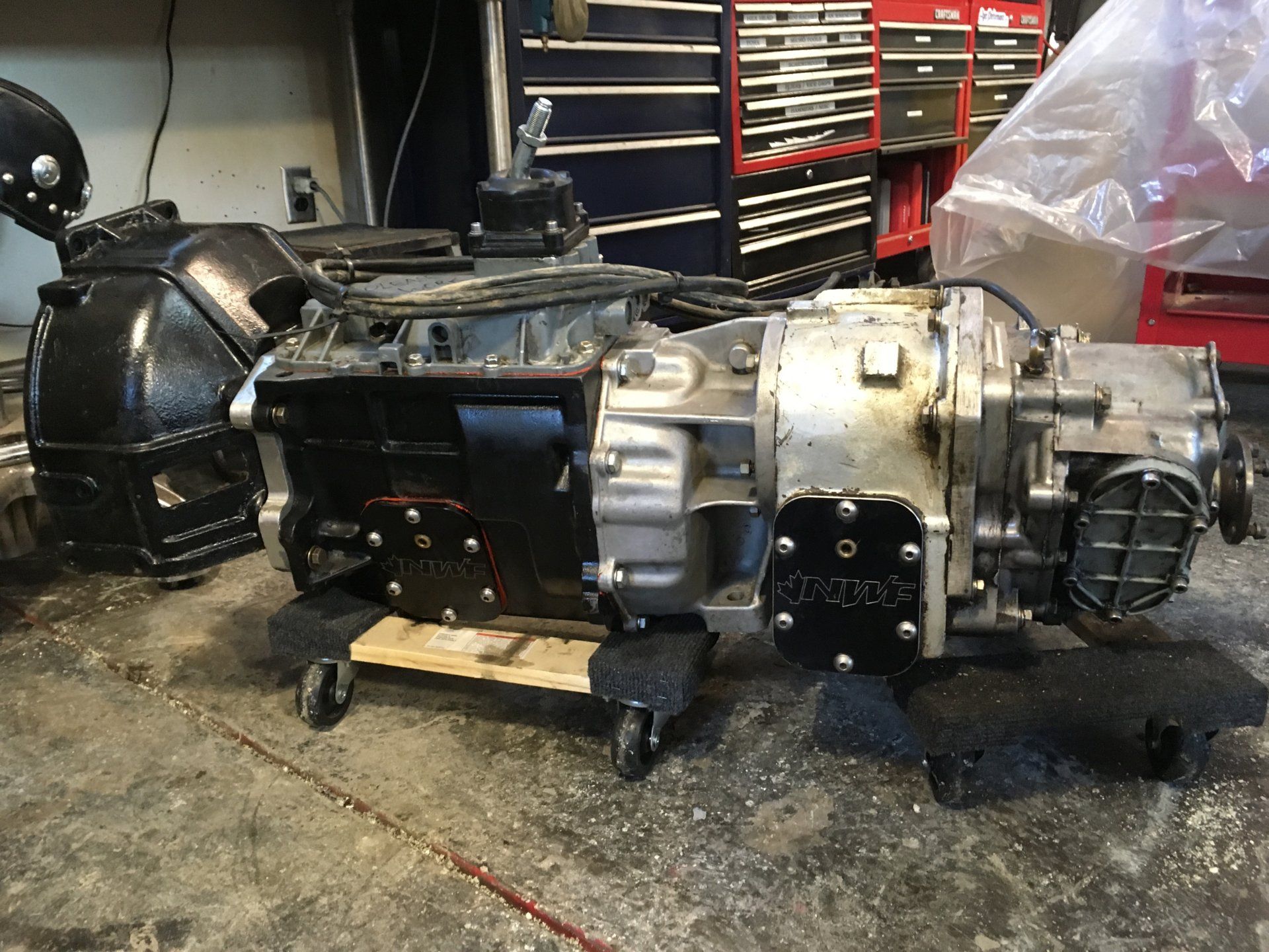

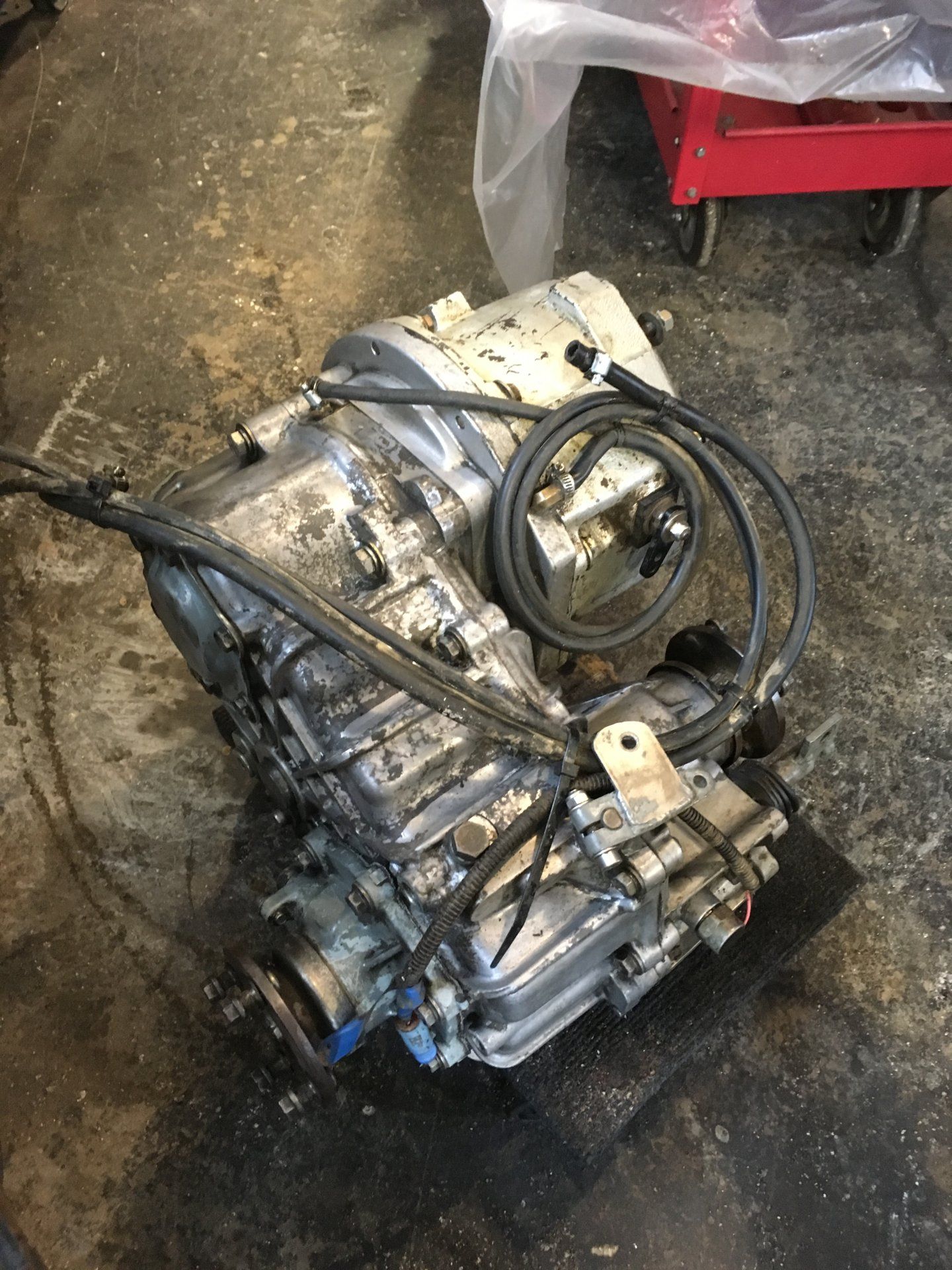

Got all the grime cleaned off the 203/splitcase, and put in a missing spacer for the splitcase Hi-low linkage (other wise it drops about an 1/8” into the case and you can’t shift it). I lost/discarded whatever the original washer/spacer was supposed to go there but a Porsche headbolt washer works perfectly.
I know I said I was going to put 4:1 gears in but I got thinking again, if I go up in tire size (to 37’s) then the hi-range reduction from the t-case gears won’t be enough and I’ll have to do diff gears anyways. And I own a pair of locked 4:88:1 third members which would be right for 37’s... although I bought the diffs for something else they might find their way here. Need to decide.
I also had a couple of the big bolts holding the splitcase to the adapter come loose a few times while I was driving this setup so I
put a bunch of red threadlocker and torqued em down right again.
If it is still an issue I’ll helicoil the threads.
Then I bolted that whole deal to the Nv4500. And then put the whole thing into the truck. Nice to have the whole thing just bolt up, shifters, driveshafts, etc.

Nice job Matt, nice job indeed. I hope you are installing a good quality clutch that thing looks like a pain just to get in.:cheers:
$40 disc from Napa if I remember correctly... it’s a 10.5” for a Chevy 3/4-ton.
Did you check if there is a Centerforce Dual Friction for it?
Is that NV4500 have the 6.** granny low or the 5.**?

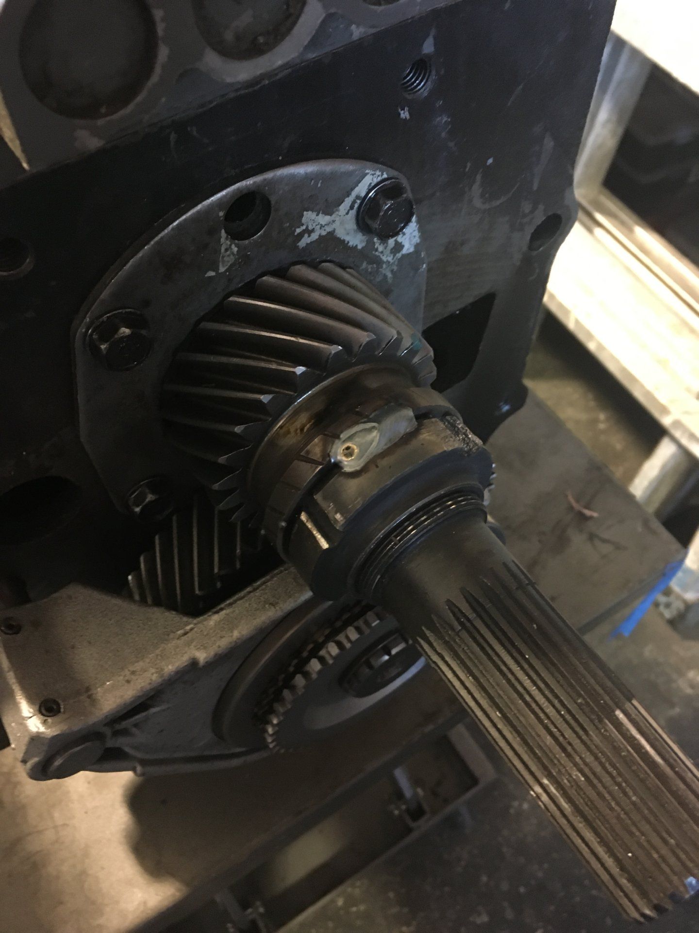

I'm sure you have secured that 5th gear, correct?
Nope on the dual friction. Don’t need it though, this one works fine.
5.61 first gear.
And yes, the 5th gear is very secured.

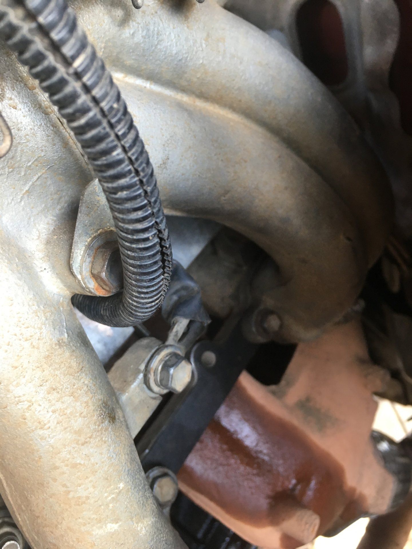

After some ACTUAL INVESTIGATION using the FSM schematics, I was actually blowing the fusible link for the alternator, not the EFI (I just assumed EFI as it was dark and I was tired and I wasn’t smelling fuel).
So I went out to the truck and (after pulling the big connector) I found what I was actually supposed to hook the power wire to. I had it attached the alternator case bolt circled in red, where it’s actually supposed to be hooked up to the big pole circled in blue. The OEM alternators are much more obvious about this... I blame the harness adapter and putting this together on only several hours of sleep for three or four days in a row.
Either way, assembled properly, hooked the battery up with my last spare fusible link and nothing smoked! Amazing what happens when it’s actually put together correctly.
I also found that this want hooked this up and I’m now getting a strong fuel smell (good thing), I’m pretty sure this is the ground for the injectors.

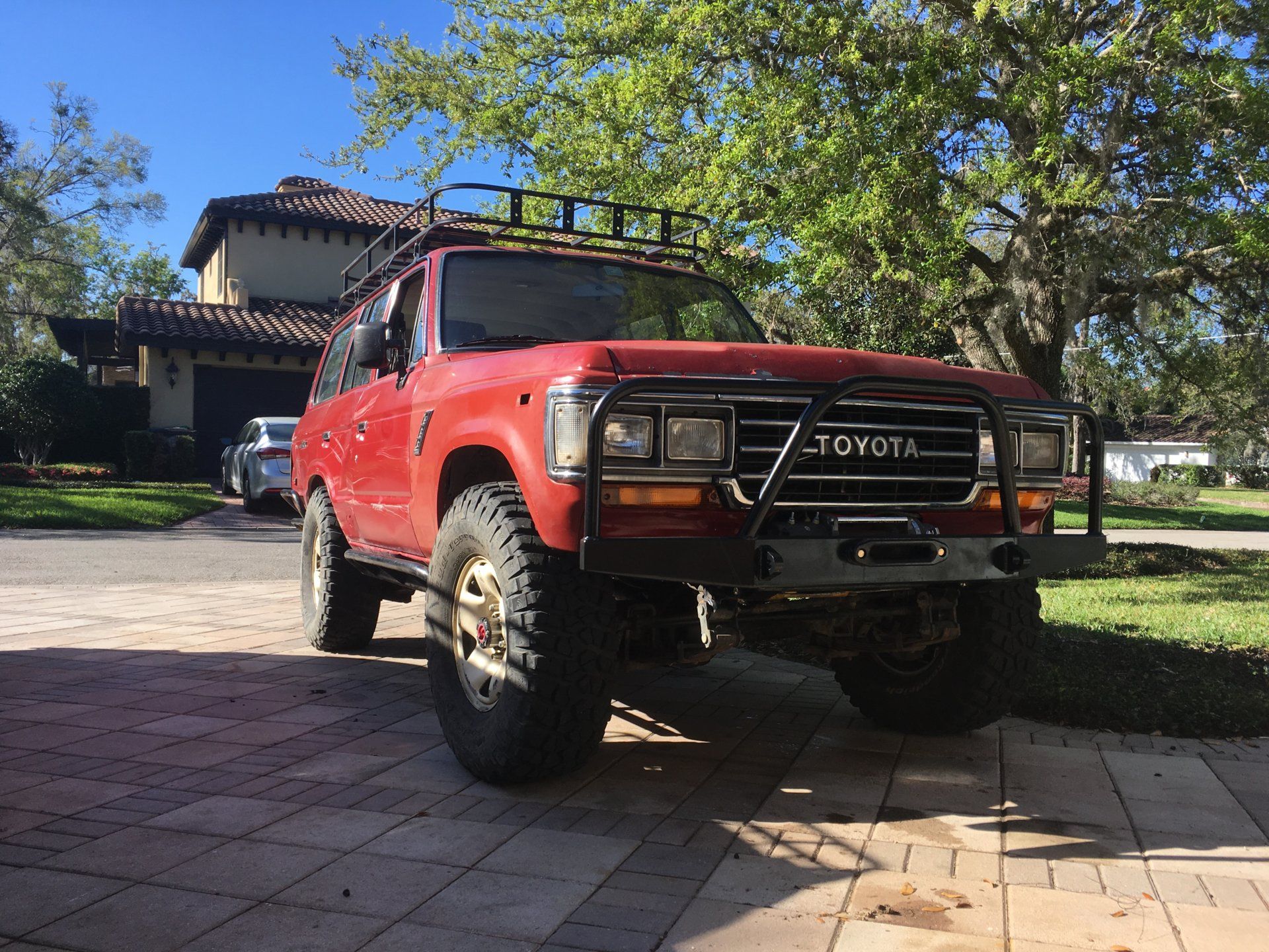

I’m really digging the look of my my new bumper and fresh (used) grille/headlight surrounds. I need a winch line. And I need to figure out how to wire my M8000 my existing solenoid.
I also installed the LED interior lights and under-hood lights from Odd-Iron Off-road. Nice products. Now I want wheel-well and under-frame LEDs for night wheeling and wrenching :)
