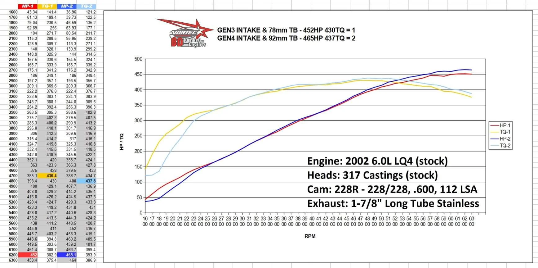

Been doing some reading about the gen4 truck intake or trailblazer intake. Maybe others will find this helpful. Supposedly it is a good upgrade. Right now I have the gen 3 truck intake. So I did some research online to find a dyno comparison. This is what I found:
The gen 4 makes more peak hp and torque. However torque below 2500 rpm significantly favors the gen 3 truck intake. At 1800 rpm their is almost a 100ftlbs more torque. This is with 317 heads that give 9.4:1 compression so maybe at higher compression things are different. I think I'm going to stick with the gen 3 truck intake.
