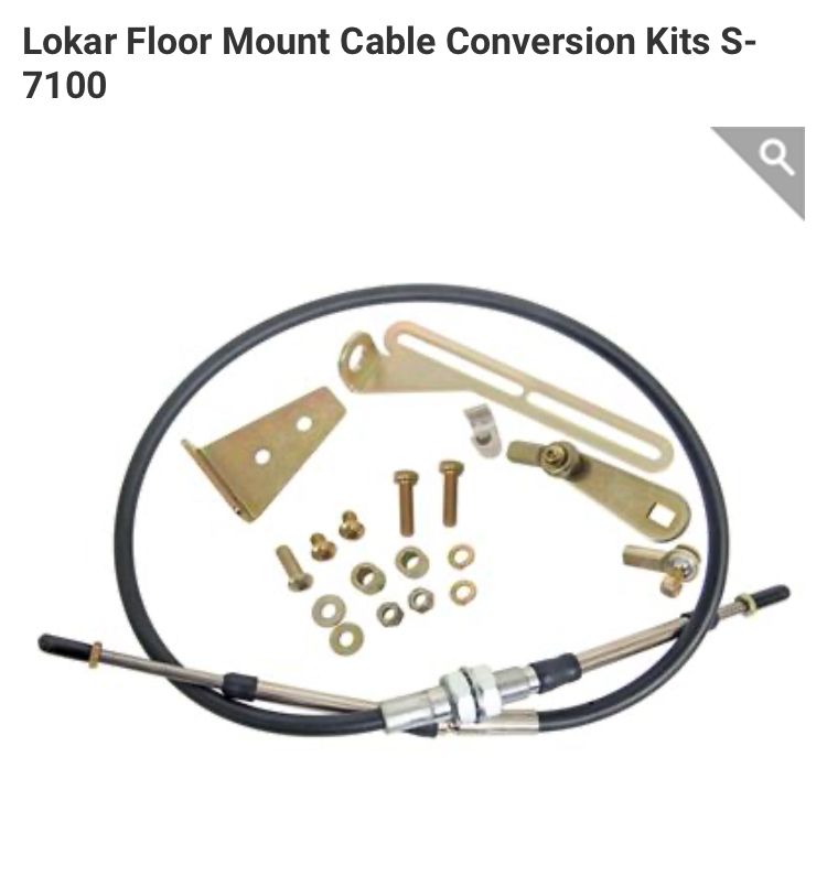

I used a long Lokar cable (5'?). It was pretty straightforward and came with the needed brackets.
Do you remember what kit by chance? Part number maybe?

I bought this (4’) model first, but had to go back for the 68189 5’ cable, which doesn’t appear to have the brackets.

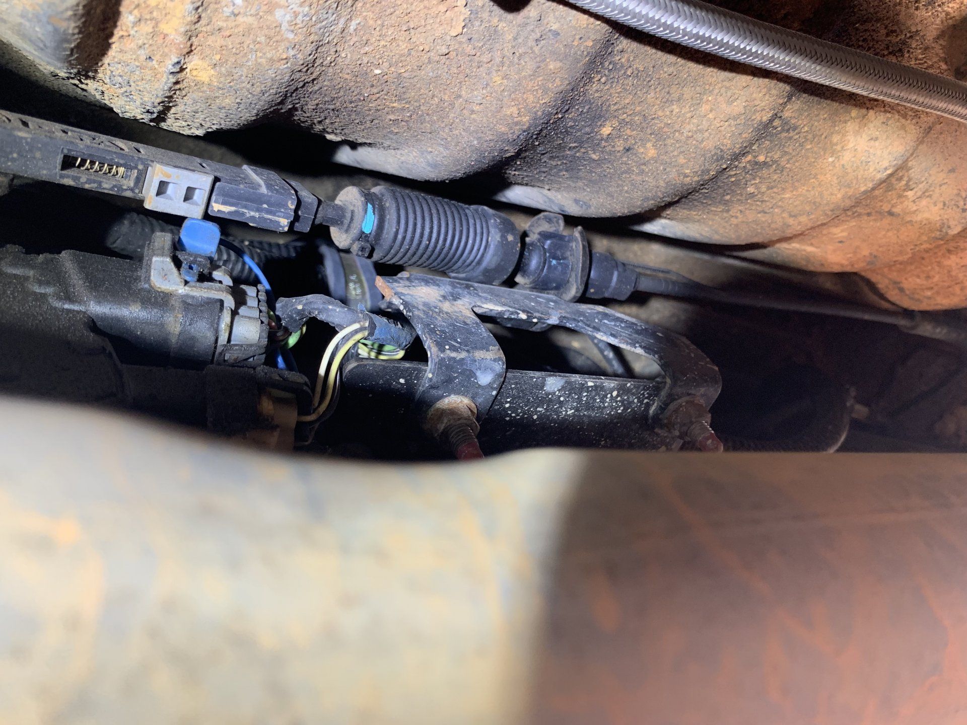

No, but I just snapped some pictures. They aren’t the greatest, but it’s pretty simple.
Flip the lever on the trans to the top so the push/pull interface between the shifter is correct. A simple mount in the trans tunnel on the passenger side to hold that cable will need to be fab’d up. Shifter works perfectly like stock after playing with adjustment a bit.
Stock GM cable bracket on side of trans (flipped to the top of course):

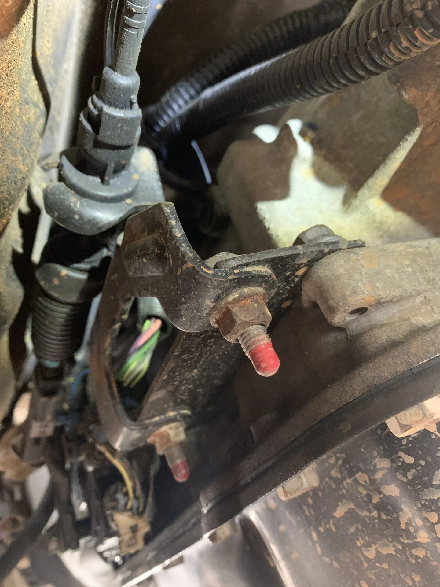

Factory GM lever flipped to the top:

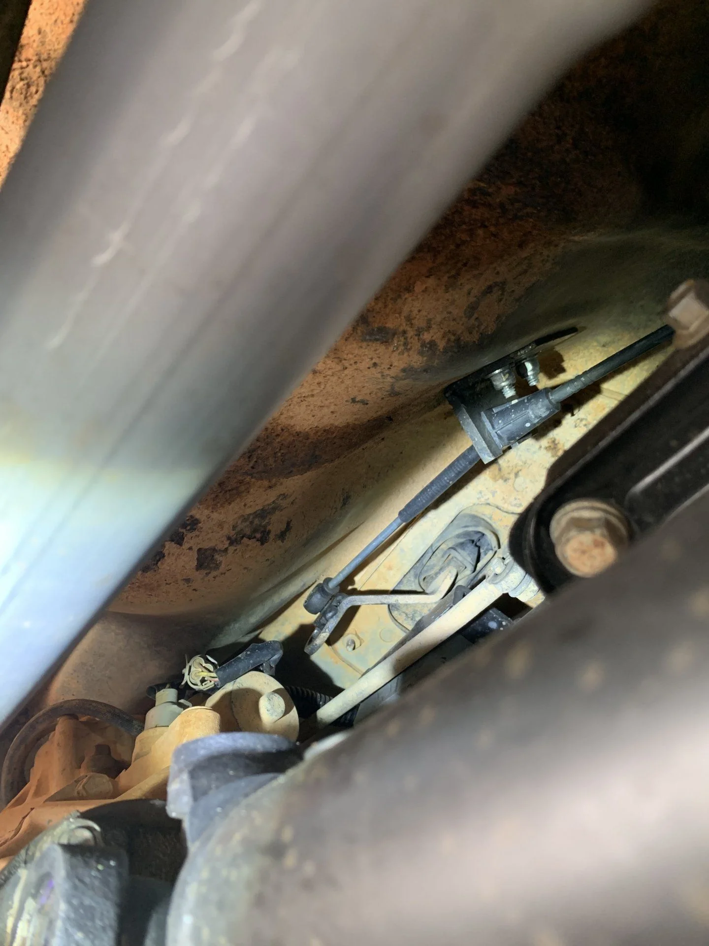

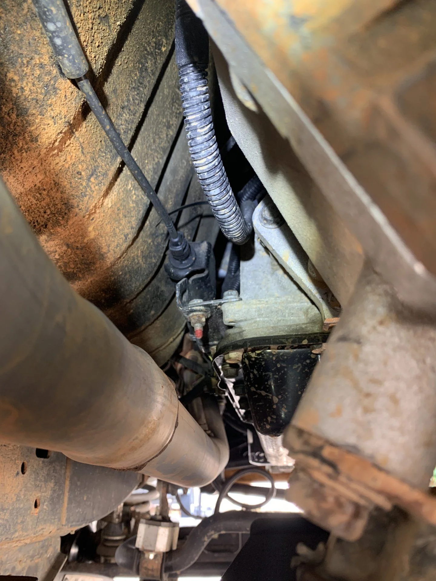

Here is the simple mount that is bolted to the passenger side of the trans tunnel to hold the cable on that end:
Hope this helps. It has worked perfectly for 3yrs 30k+ miles.
