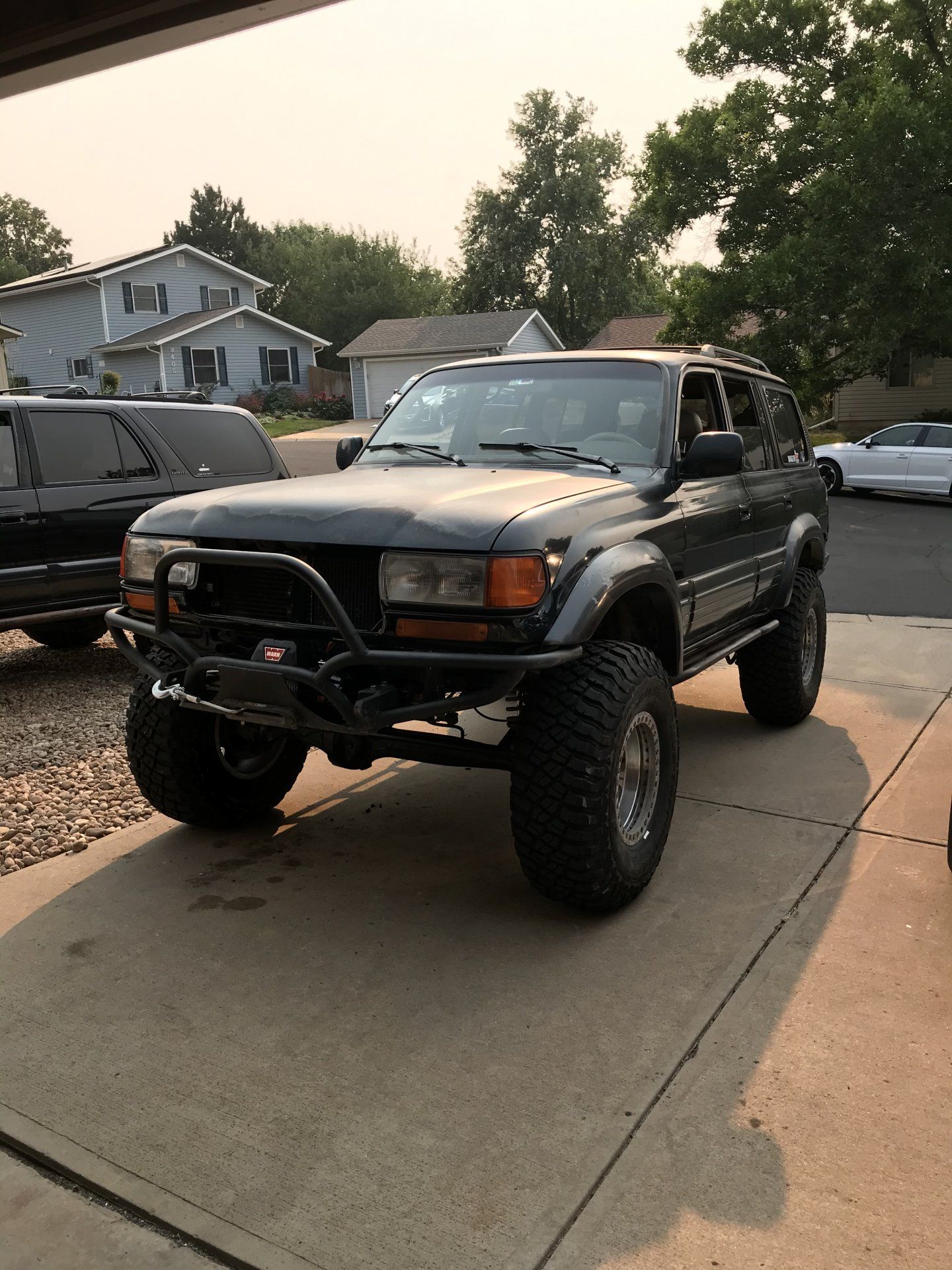

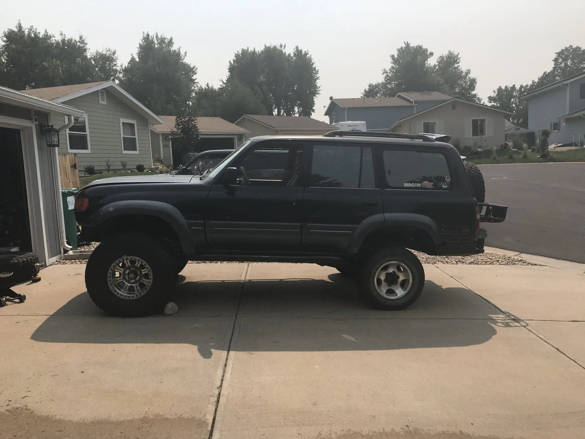

Things are going back together. Need to figure out why my heat/ac won’t blow, and why my speedometer isn’t working.
a year ago yesterday the 1FZ-FE s*** the bed on me. Didn’t start the swap till mid March. Drove around, ran some errands, etc w/ it yesterday.
a year ago yesterday the 1FZ-FE s*** the bed on me. Didn’t start the swap till mid March. Drove around, ran some errands, etc w/ it yesterday. View attachment 2429768View attachment 2429769View attachment 2429770
When I got mine all back together the speedometer wasn’t working because I accidentally deleted the power wire to the sensor on the t-case.
I was thinking it might be something like this, that or maybe the ground....

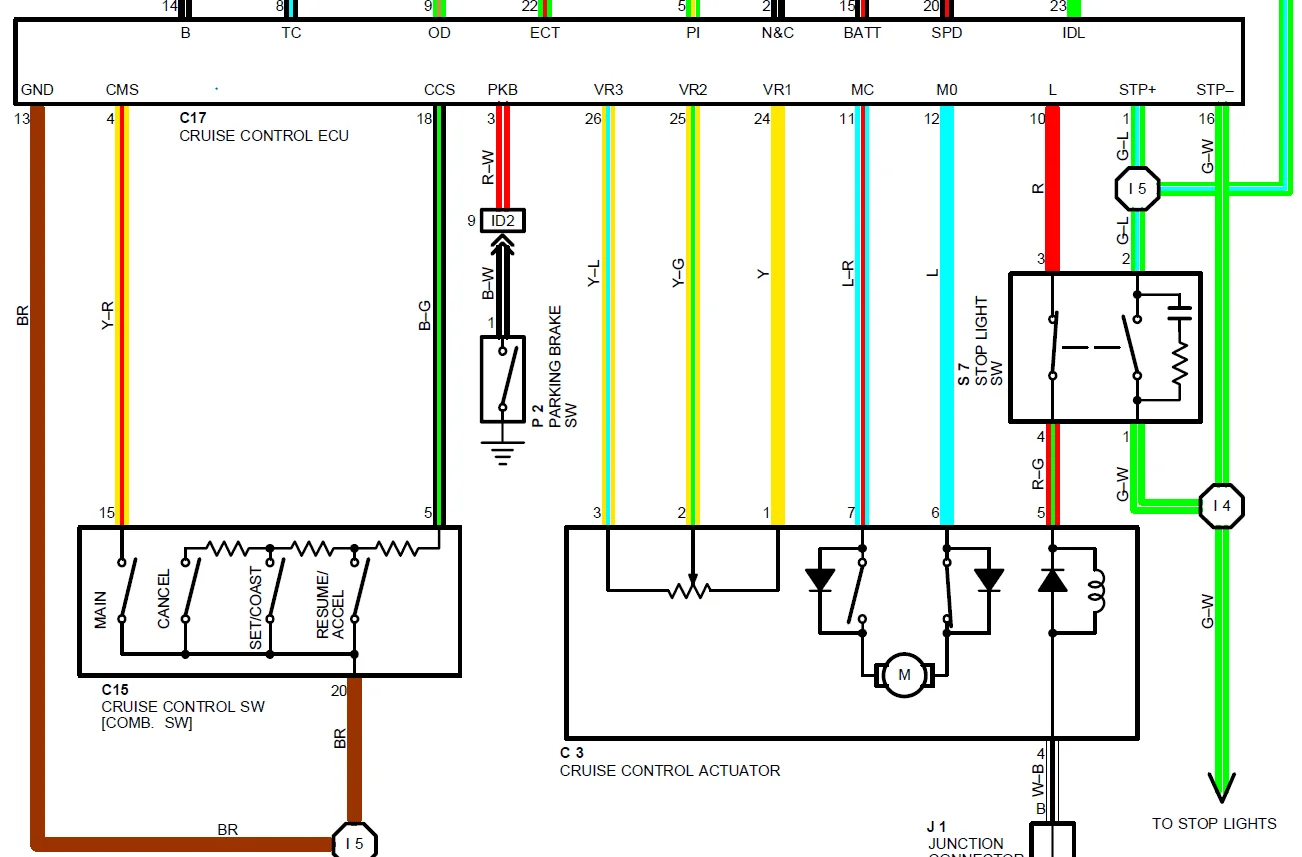

Thought I'd make a post on how I'm doing my ECU brake signals.
The PSI Conversions harness I'm using calls for:
12V Brakes Applied - Yellow wire
12V Brakes NOT Applied - Purple wire
The first is the typical brake light/ torque converter unlock signal. You could get the second output from that with a relay.
But the Land Cruiser has a double pole stop light switch. Turns out the cruise control system need a connection to ground when the brakes are NOT applied, which opens when the brakes are applied. From the CC wiring diagram:
The Green-Light Blue (G-L) wire into the top right of the stop switch is 12V straight from the fuse.
So if I join that to the Red wire at the top left of the stop switch, I should get what I need out of the Red-Green and Green-White wires at the bottom of the stop switch.
The Red and Green-Light Blue wires are accessible at the plug for the Cruise Control ECU under the DS dash.
The Green-White wire comes out at pin 8 of the IH1 connector at the PS firewall. Connect to the Yellow wire for the GM ECU
The Red-Green wire is accessible at the Cruise Control Actuator plug at the PS fender. Connect to the Purple wire for the GM ECU
If anyone sees anything wrong with this, light me up!
Here is bloc more elegantly explaining what you have acutely discovered. 2 posts later in post #264 is a picture of the wires I used to get my truck running.
Technically you only need the R-G wire for GM's purposes, not sure what PSI needs the voltage for when brakes are applied?? Maybe a cruise control or some sort of ignition safety feature. AFAIK, GM uses +12v when brakes not applied for TCC control. But I'm unsure what engine you're installing and I only know gen3 vortecs. And by "know", I mean what I did on my truck which I have no idea if it is correct...but it drives and runs without wiring issues. Reference from LT1swap.com
Pin 33 - Purple - TCC Brake Switch - This wire tells the PCM when you hit the brakes. It needs 12v+ all the time, and the brake switch should "open" this circuit when you hit the brakes.
