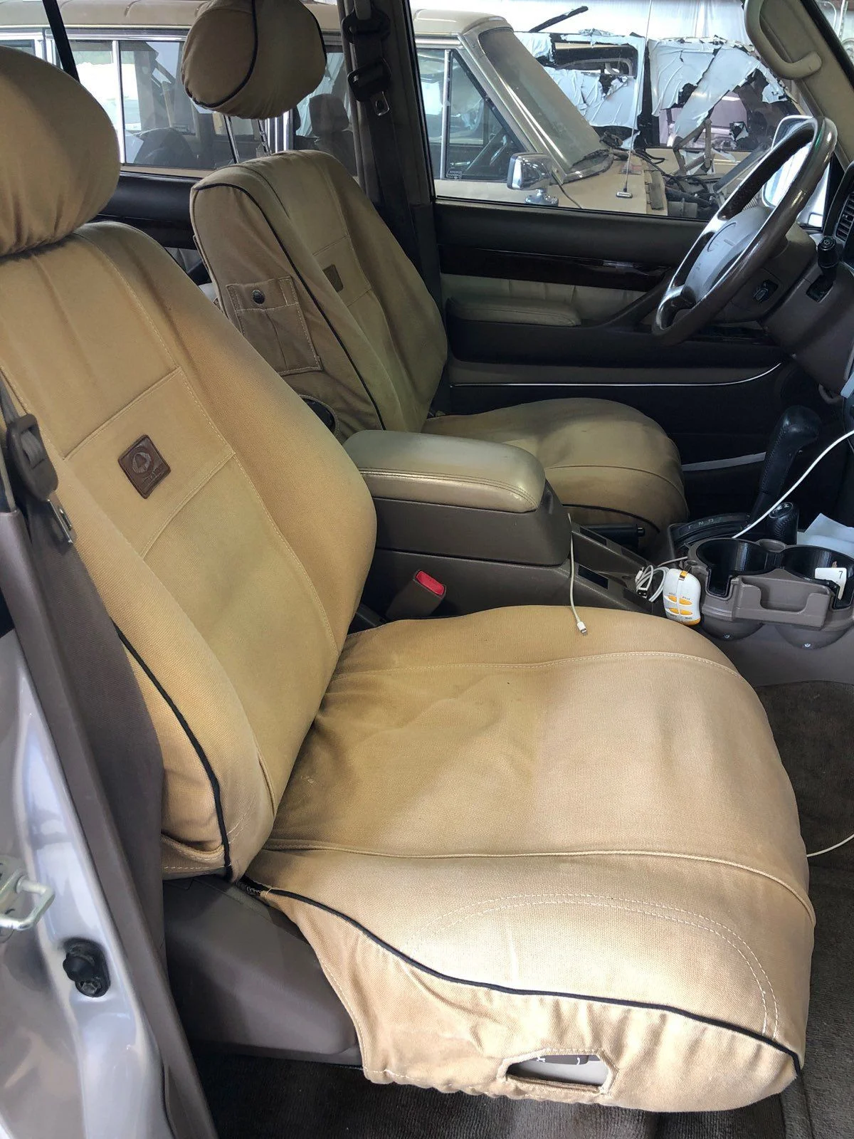

1997 Lexus LX450, 233k miles, Champagne Pearl 1B1, tan interior, clean history, Texas truck

- Melvill and Moon Seat Covers
