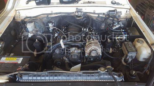

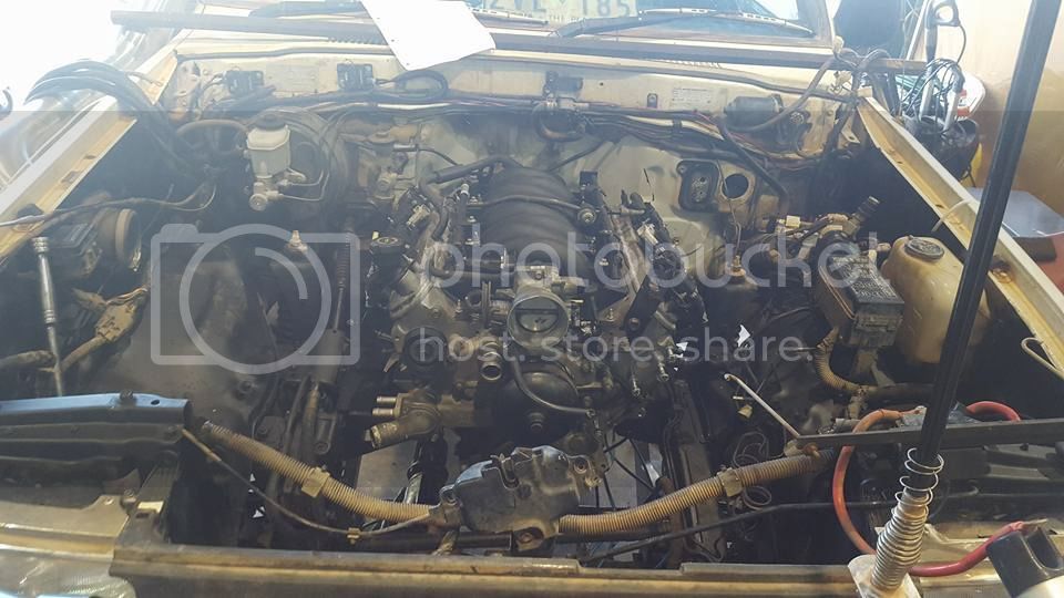

Its currently pulled apart as im cleaning the engine bay and the wiring...
I converted my HZJ80 to 5.7L LS1, im in OZ so parts were easier but also harder then the you guys in the states
I retained the 5speed manual
Rear hump sump from summit racing with 3 in coils clears fine, using some hooker block huggers into a twin 2.5 to single 3in exhuast
I did my own wiring.
Marks adaptors here in australia supplied all the adaptors
Any more questions, just ask :)

Toyota 5 speed manual? H150F? H151F? What adaptor did you use? Mark's?
