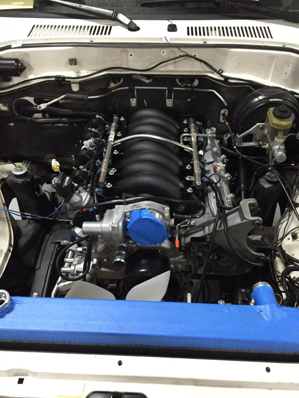

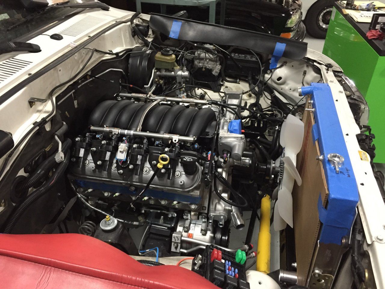

1995 80 Series with brand new GM LS3 6.2 EROD crate motor with a nearly new 2 mile 6L80E transmission from a GMC 2500 4x4.
-Cruise Control - Check
-Manual tap +/- shifting - Check
-Sport mode - Check
-Tow Haul mode - Check
-GM A/C-Check
-GM Power Steering-Check
-PRNDM mode in shifter with PRN123456 digital read out- Check
-No money Left - Check
Just getting ready to start for the first time next week. Will have a complete build thread and will be glad to try and answer any questions that are at my pay grade. Other questions will need to go to the shop that is doing my build. Lot's of little challenges but anything you desire is possible with these builds if you have time and money to do it. Even with a GM LS drive-by-wire engine the factory cruise control lever can operate the cruise control as it did stock. You can have manual tap shifting and tow haul and sport mode if you desire. I admit I desired all of it. Did I mention time and money? More details and info soon.

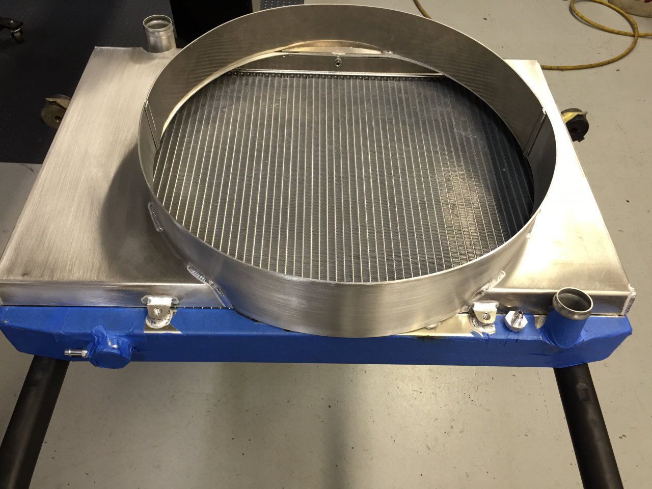

Looking for some general feedback here. I’ve got almost 1000 miles of drive time in my swap and still learning the new setup, but curious for feedback based on what others have experienced.
My setup is 6.2l, 6l80, 4.88 gears, 37’s, 3:1 crawler gears. New OEM factory radiator, derale fan shroud and dual electric 13” fans.
My coolant temps have a pretty broad operating range. Doesn’t seem like a problem, just a new experience for me.
Example:
1. highway cruising at 70mph, 55* degrees outside my temps are 170-185.
2. Similar drive with random highway acceleration from 70 to 80mph, 80* degrees outside, I’ve seen temps operate 200-205, but jump to 212 when downshifting and accelerating. Quickly comes back down when I let off.
3. 4LOW, first gear and going uphill at 2500-3000rpm’s and temps are 200-213*.
The shop owner that did the work felt that anything under 220 was fine for the motor but still curious what other are seeing. These temps seem normal based on reading from Chevy forums but just getting use to seeing 170-215* operating temps
(Yes, I searched but didn’t seem to find much that was definitive)
standard operating temps for that combo is 210 deg F. What thermostat do you have in it? Are the fans controlled by the computer? You can change the on/off of them with programming. I have that engine tranny combo in my race car. It is a lot of fun. Talk to Zero Gravity performance on tuning your trans.
Thanks for the quick feedback. I believe t-stat is 180*. Fans are computer controlled and kick on at 204* I believe. Shop that did install did tune trans and shift point during the final motor tune and so far the shifting seems great. You aren’t too far away from me so would love to let you check it out and see what you think of the final setup.
