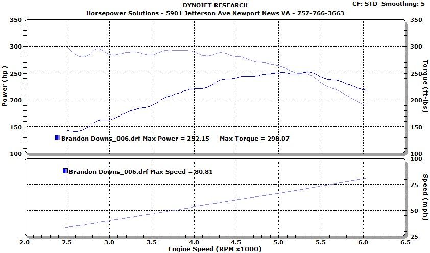

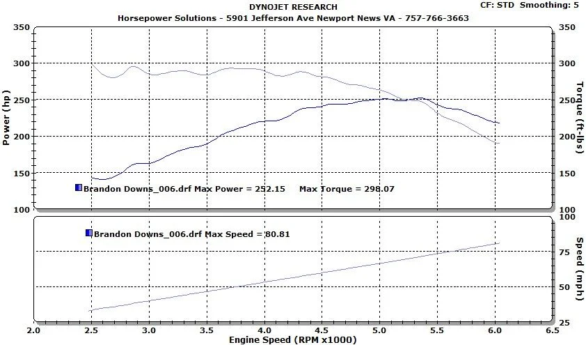

Figured I'd cross post my dyno printout I finally got from the shop. This is a 6.2L
