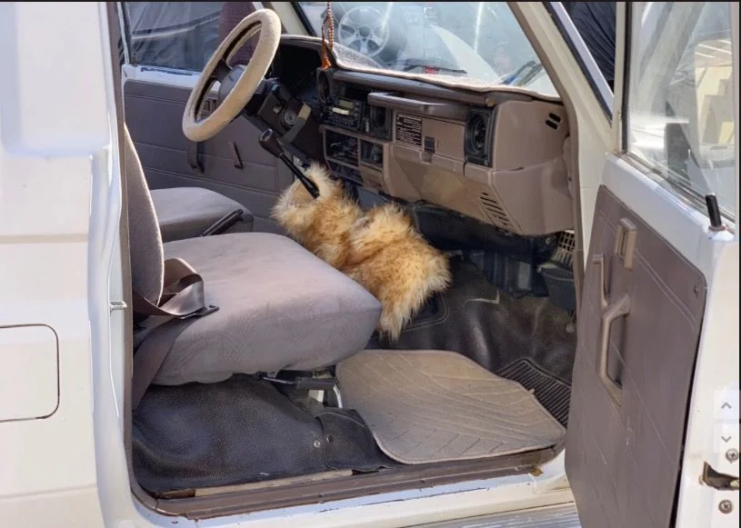

View attachment 1876396 Sorry to ask but my redneck curiosity is overwhelming and I need to know what kind of critter is hanging around the gear shift?
Hahaha! My son said it looked like a dead cat. It's kinda normal to find these in trucks in the region... a stitched boot that covers both the gear shift and transfer case knob. My FJ40 had one when it came in from Saudi. It was dirty and not to my taste... it's been retired.
