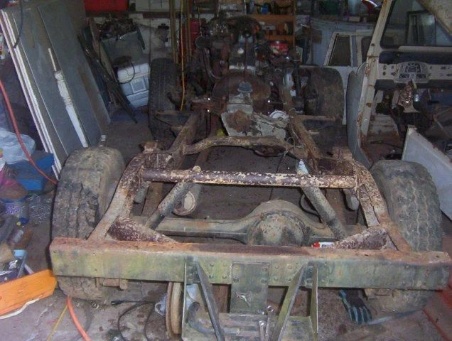

About 4 years ago I purchased my first FJ40, a 1969. I tore it down to the frame and started working on the small stuff.
In the middle of all that, I purchased a 76 that was in much better condition and restored her first. After she was restored, I used the $$ from that sale, to fund the build on the 69.

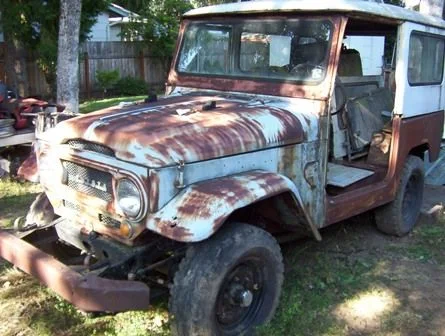

Part of the proceeds went to buy a 76 FJ55 as a parts rig for the 69. I really prefer the 76+ Drivetrain and this Iron Pig had it where it counts. It had a completely rebuilt engine with less than 12k on her, also complete rebuilds on all four corners, wheel bearings etc. A great driving rig that fell on her side during a 4 wheeling trip up in the mountain snow. It was sitting in the guys fathers yard, so that guys dad sold it to me for a song! And with all paperwork documenting the rebuild. Suffice it to say I was happy…
This build was put on hold for several reasons; mainly I didn’t have a place to work on her. Fast forward a bit and into our new home. The wife was ok with me taking over the garage because she saw the success of the other rigs sale and is exited to see this one built.
The original tub on the 69 was shot so I found a donor tub from a 71. It has some rear end rot, and a bit in the middle floor board area. Two places I need to replace.
So I started on the chassis…

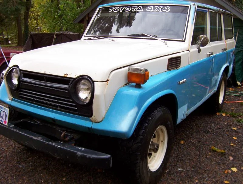

Pictures are of
  1. when I started
  2. Frame before blast, (note Donor tub on right)
  3. Donor FJ55

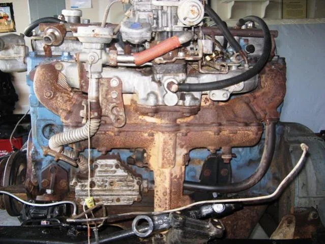

Engine gets transplanted...

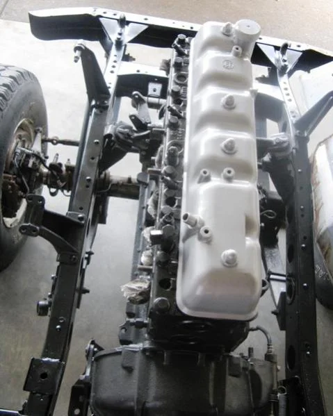

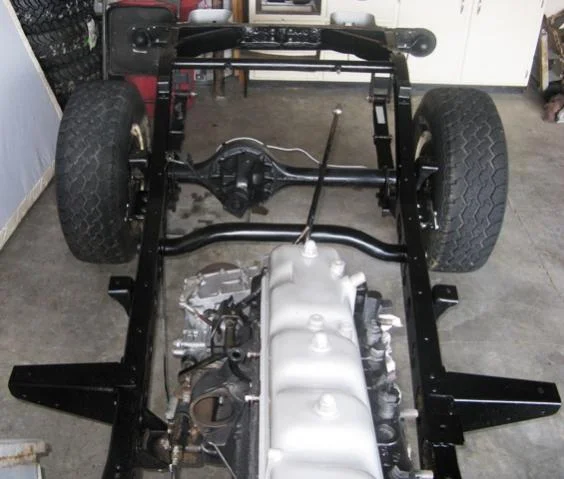

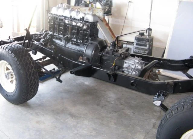

I had the frame sandblasted, then I gave it the POR treatment.
Installed Skyjacker 2.5" soft rides, and extendo shackles. Transfered the front and rear axles from the donor 55 onto the 40. then installed the engine.

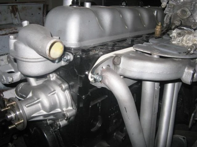

Gave the engine a cosmetic teardown, and replaced the exhaust manifold with a set of headers, new waterpump, alternator, fuel pump.
Pictures above show some shots of the engine / tranny all cleaned up.
To clean the engine I towed her to a car wash and power washed all the grime off. First with a treatment of Superclean, then power wash, then super clean then powerwash. I repeated this process about 6 times. It was the easiest way to get rid of all the crud.
Then I treated the engine with metal ready and turned the rustys into black iron oxide.
Then I gave her a once more over, then sanding (minor) then paint work with engine enamels. I decided to go with the cast look on the valve cover and intake. The cast paint matches very well with the other aluminum parts as seen here in the pic... The WP is not painted, the other Items are.. The headers are only temporarily attached. I could not believe how clean the INSIDE of this engine was.

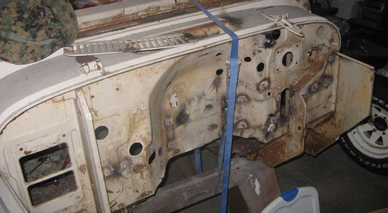

The first couple shots show the tub...
As you can see I needed heat to remove almost all the fasteners in the firewall. what a PITA!!!:mad:
Thats going to the blasters in early Jan.

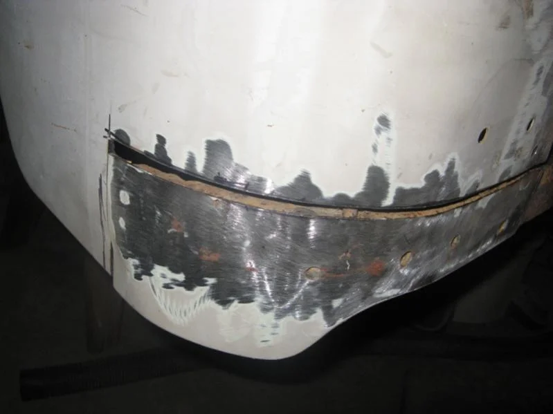

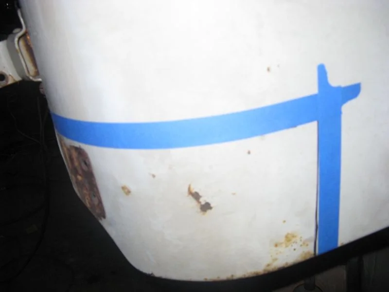

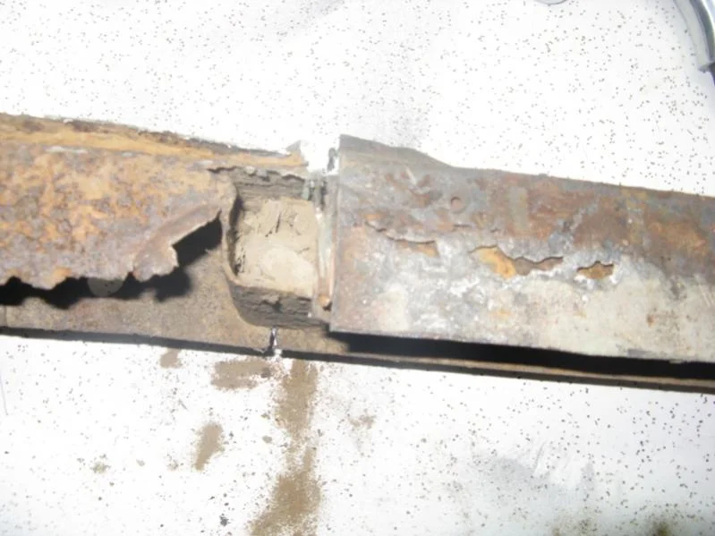

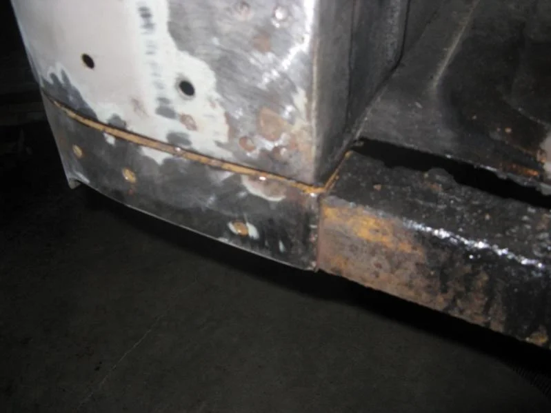

Rear Sill removed
Went to work on the rear sill. I was thinking of drilling out the spot welds and leaving the original skin, but after looking it over, the cancer was already started so I think it's better to just cut it out and weld in new.
So a hacking I went!
The roto zip makes quick work of the sheetmetal. 3 cut off wheels were needed to make all the cuts.
Sill removed
As you can see, once pulled, it indeed needed to be replaced.
I will be building my own rear sill from 14 guage.

Since this was originally a 69, and I prefer the 76+ running gear, I installed the OEM Disc brake front axle from the 55 donor, and the rebuilt 2f with 4 speed tranny and transfer. Also moved the rear axle over.
