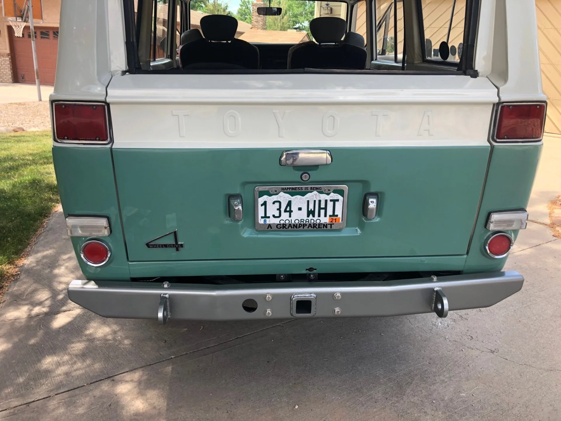

Bolted the new rear bumper up today. Wiring the plug in may wait until after PP 2021. I think I like it...ought to be a good rear quarter panel saver too.

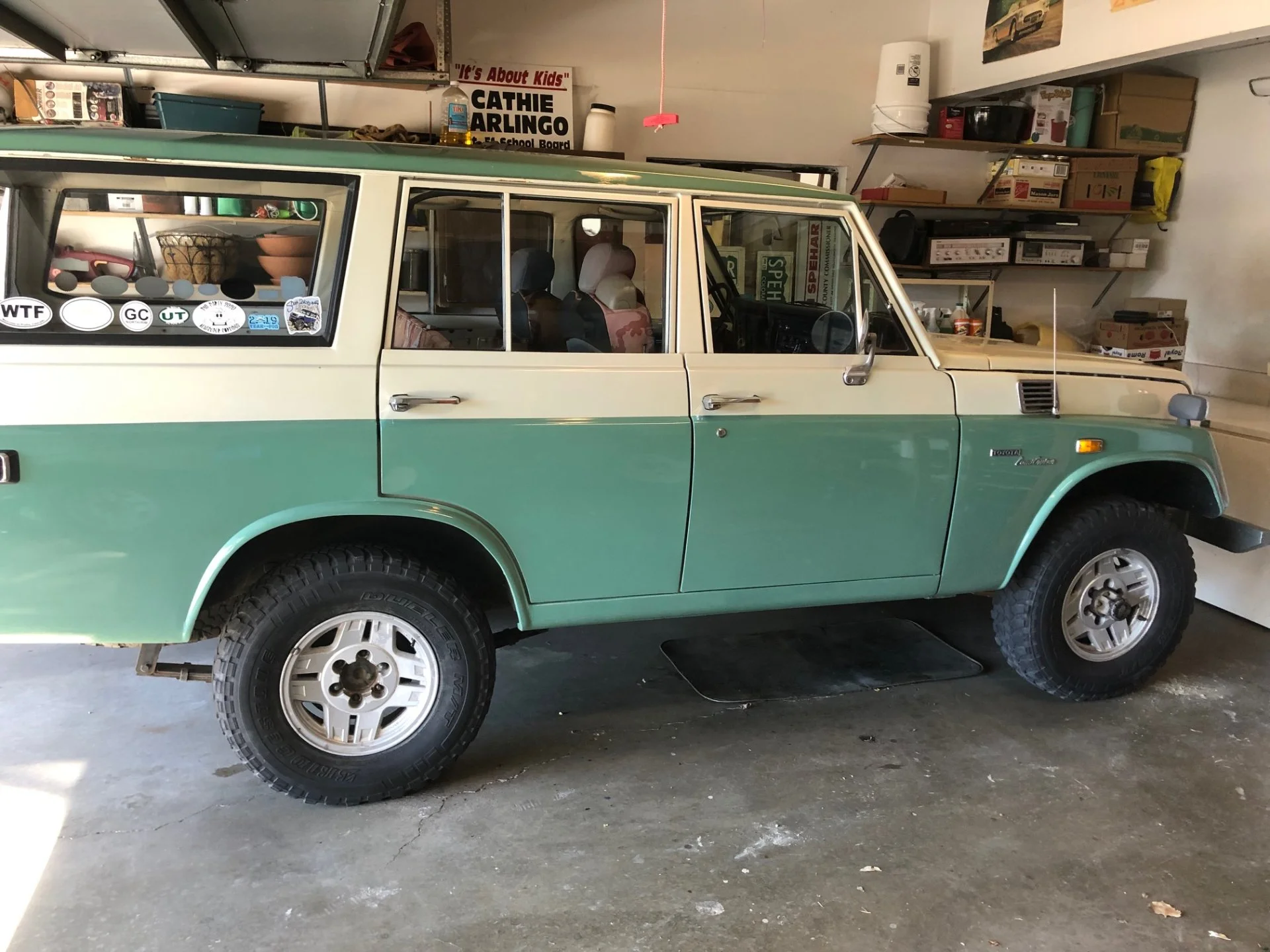

So I've been looking for some of these wheels for awhile, hoping to be able to fit tall skinny 16s when I do my next tire swap in order to have a better tire selection. They're extremely hard to find in the 16" version...usually came on Prados and some other 70 series. Proving it's better to be lucky than smart, five of these showed up right here in town on a Troopy that's being re-outfitted in a serious fashion. Also managed to snag another 4 last year and was only looking for a spare when I found the latest batch. Pics show the 6x16 wheels with 35 year old 235x85x16s. Wonder what everyone thinks (though I suspect @J Mack, @fj55-100, @Megadoomer and @fj55tlc will not approve). Would probably blast 'em and powdercoat or paint in the Ash Grey Metallic to match my bumpers. Also need to find at least the rear center caps. Would also consider going up to 255s. It's amazing how much lighter these wheels and tires are compared to my existing Toyota 15" white spokes and 33s.
I have no sense of style, so I'm sure they're fine. I'm wondering about the width of the rim and moving up to a 255/85. I'm probably wrong, but I think they need a 7" wide wheel. Something to check at the least.
I'm sure you're right, Ron, since the 235s spec to a 6.5" wheel. But I'm running 15" 33s on a 6" Toyota FJ60 wheel with no issues, Probably getting some minor crowning but usually run a softer tire pressure to compensate. Tread depth measurements today show the ATs are wearing evenly.
