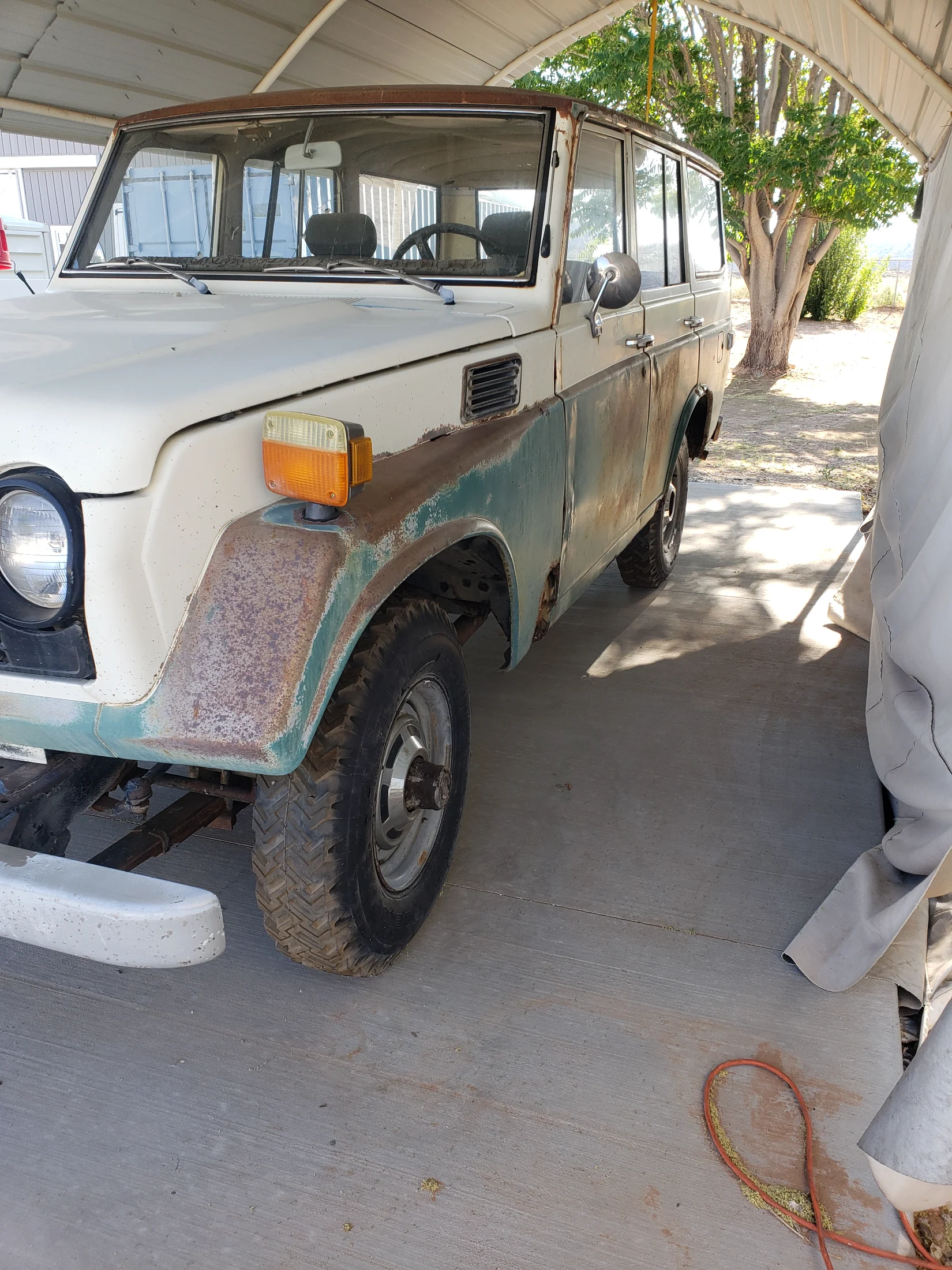

period correct h78 , . bias ply , flatspotted bad if sitting for to long , rode rough .

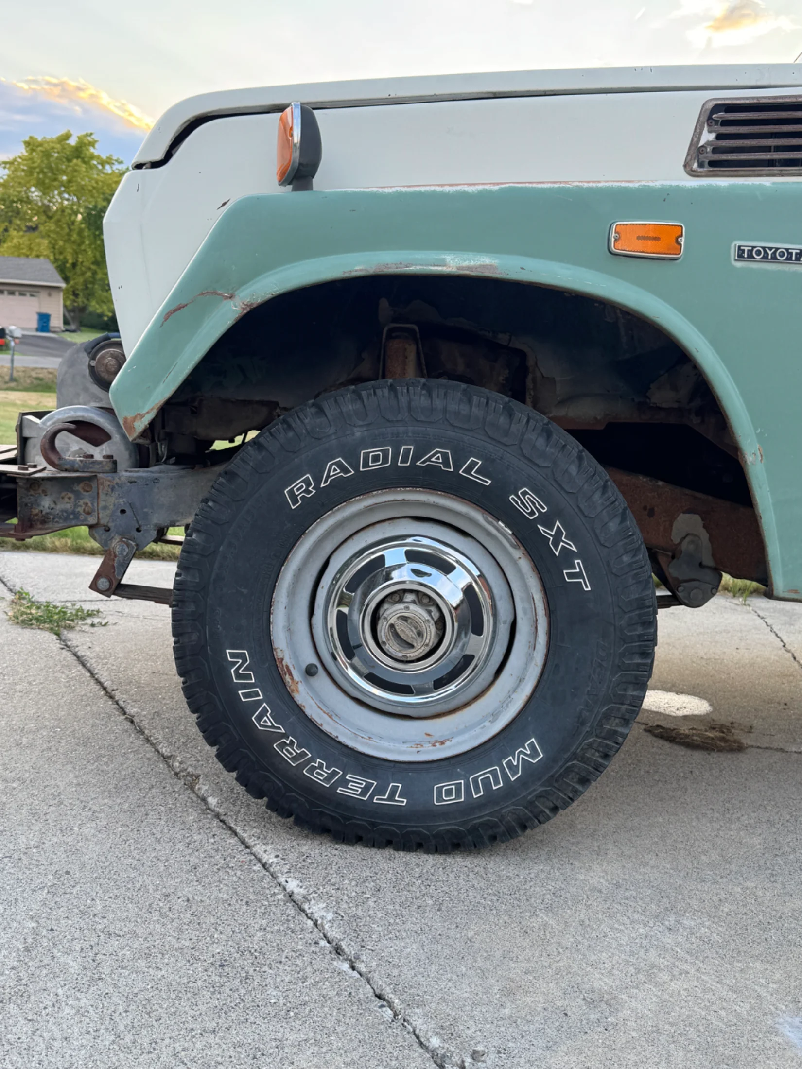

Robert,

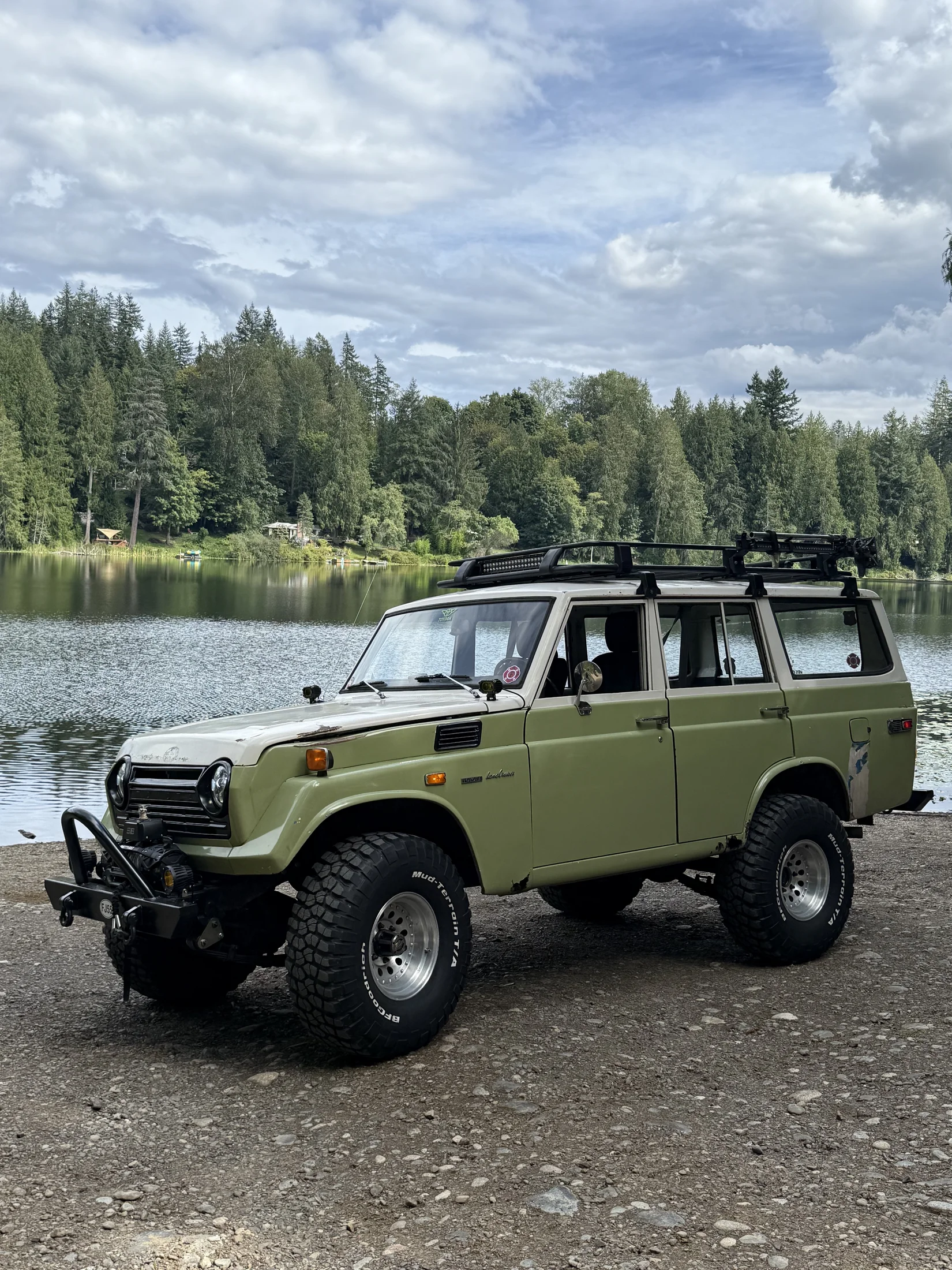

I'm trying to figure out tires also. Stuck some 235/85R16s on Saturday just to take a look. Expecting this 2" lift to settle a bit. And I've got adjustments on the front that will bring that up about an inch to lessen the stink bug stance.

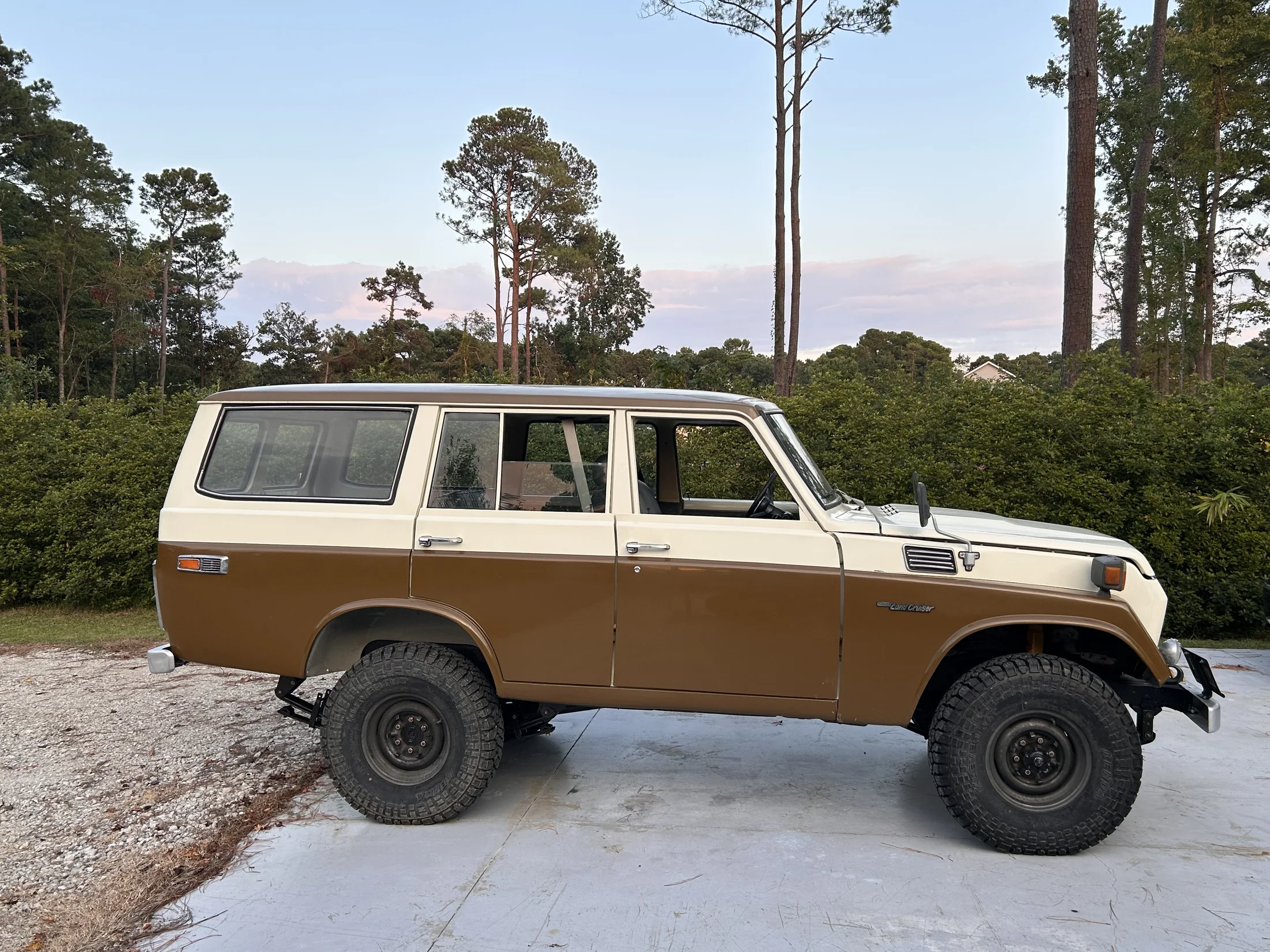

Not currently mounted but these are my original 55 rims that I just got powder coated and those are Kenda Klever 33x9.50 RT tires. I have the "common" 70 series OME lift on my 55 that @gonzopancho referenced which gives you about a 2" lift. FWIW, I removed BFG 33x10.50 ATs from those rims. These Kendas are getting pretty good reviews but I don't think they look period correct. You would pretty much have to go with a bias ply tire like the ones you are considering to get that look.

No lift, no rub. Stock 15" Steelies, 33x10.5's Kenda Klever R/T

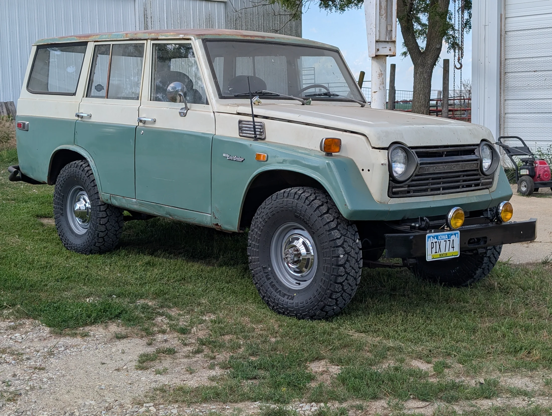

Factory suspension, springs are dead flat. Tires are OEM steelies with hubcaps. Tires are 30x9.5-15

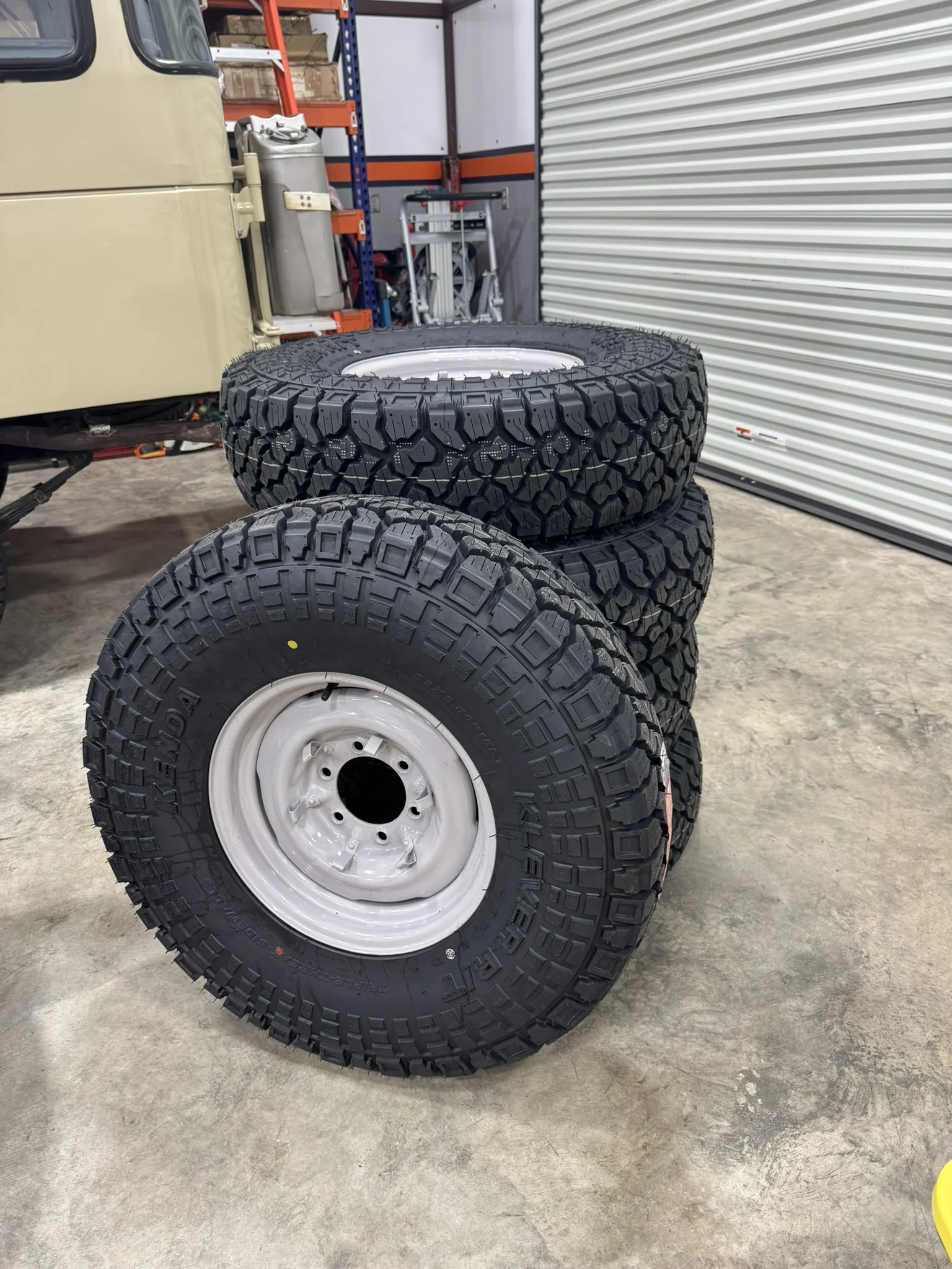

Robert, I put the Saltwagon wheels and tires on to check sizing. 33/9.5R15 Kenda’s. Wish I could just keep them on but the fronts don’t rotate. Looks like front calipers don’t clear the early 40 wheels.
Dang they look good under there. I guess the rivits on the early wheels are causing clearance issues?
