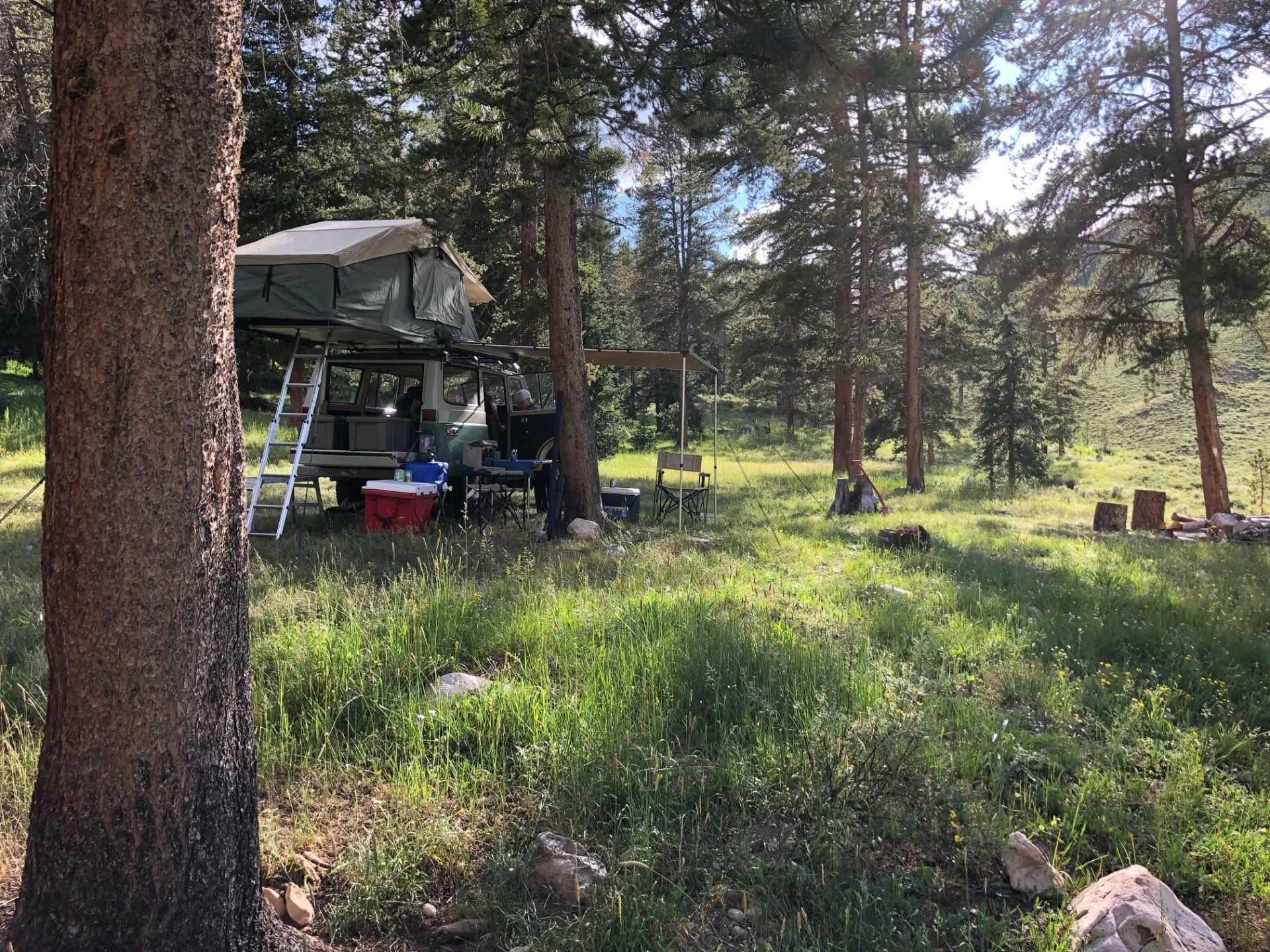

Attached pic is from last summer.
Running 33X10.50R15 All Terrains on white painted late model 40 wheels. Found a set of five at a local auction. Will use the old painted chrome 60 wheels when I get some similar size Mud Terrains.
Rooftop tent is great...we call it penthouse camping. Best $500 I've spent when we bought it lightly used. Also have the annex for underneath and the enclosure and floor for the awning, also found used locally. If pressed, we'd have a three-bedroom Pig for much less than most ask for their used rooftop tents. Only issue with the tent is putting it up and down daily but I figure it takes about the same amount of time as breaking down our old tent camp. We've got it down to about 15 minutes up, maybe a few more minutes down.

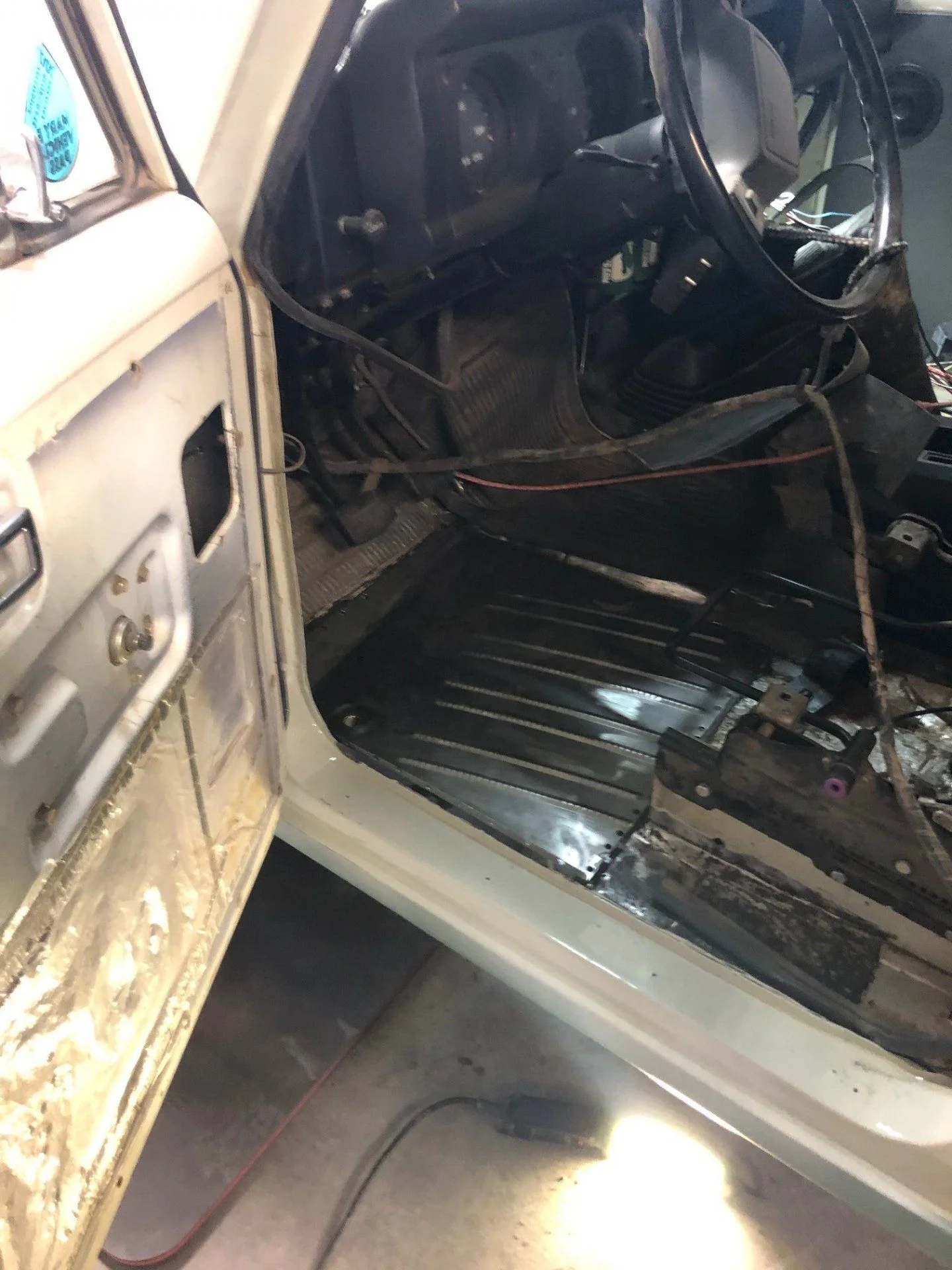

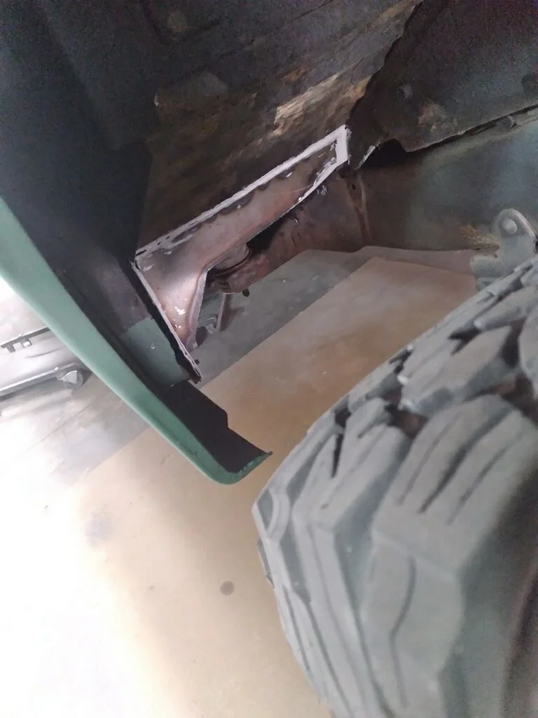

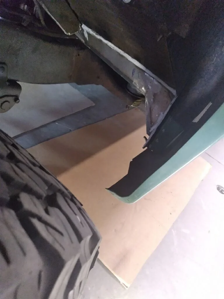

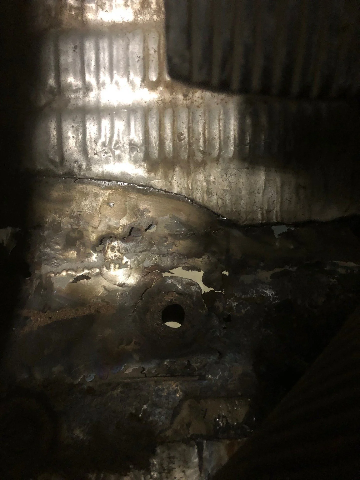

Short story is keep those body mounts cleaned out, boys, especially up front. About a coffee can full of packed dirt on both sides leads to this. Once again, thanks bobm. He's a savior for sure.
Once floors and mounts are in, final green repaint will be done. Hopefully pick it up and start getting ready for South Dakota when we return from a week or two in NM and AZ. Leaving Monday see our son in Albuquerque for the first time in a year now that we're both vaccinated and restrictions have eased. Maybe extend the road trip to visit some longtime friends in Queen Creek.

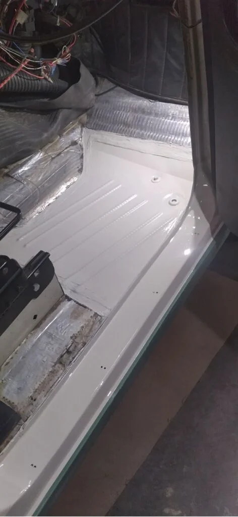

Per Bob, we opened up the lowest point against the rocker to make it easy to hose out and keep clean.

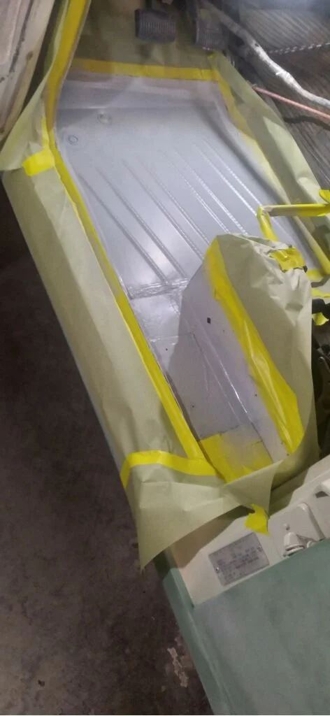

Back in town after 10 days in NM, AZ and UT. Front floor and body mount surgery completed while I was gone. Insides of mounts coated. Undersides will also be coated. Re-greening should be done this week. Maybe home by the weekend.
