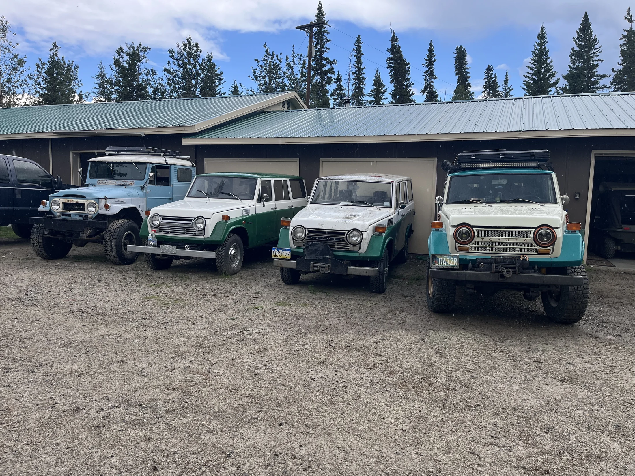

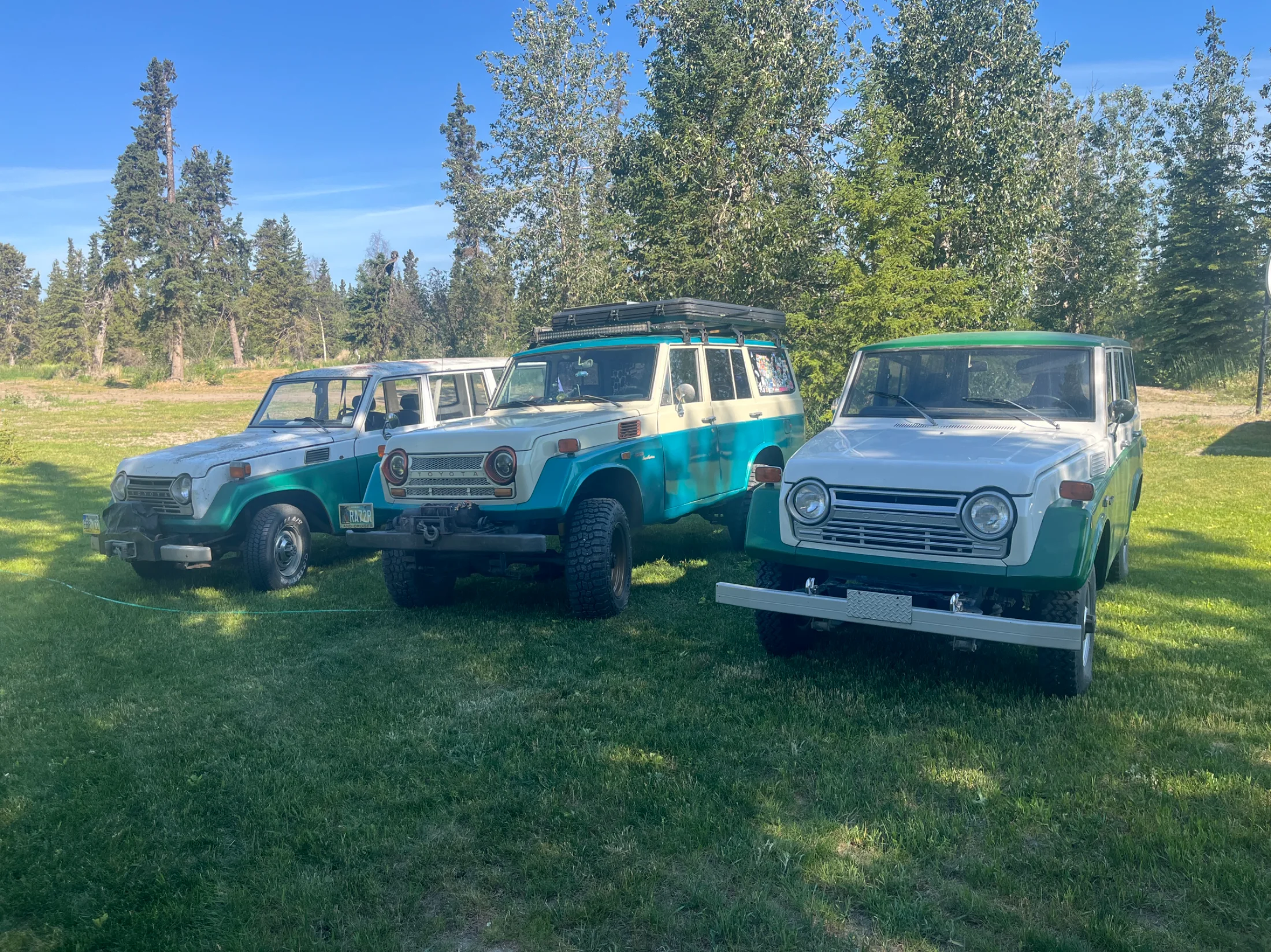

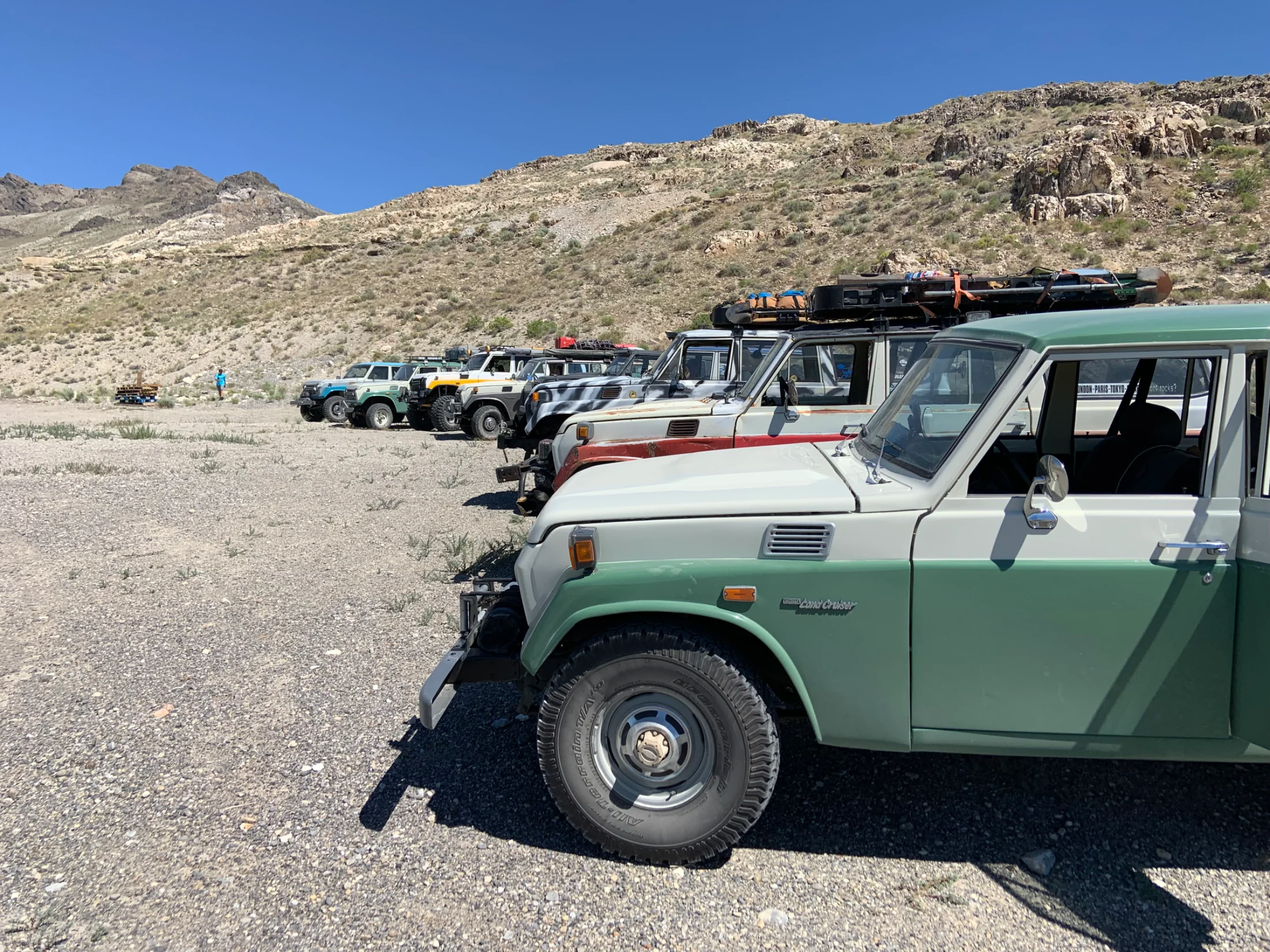

I know not a great picture but the pig on the left i have 7/15 on the middle is 30/9.5 and then right is 255/75/17
Second picture its one on the right that has 7.00/15
Also if you have this years pig calendar this month the main picture is the green pig with 7.00/15
Teal pig I have 60 series 2.5” springs under.

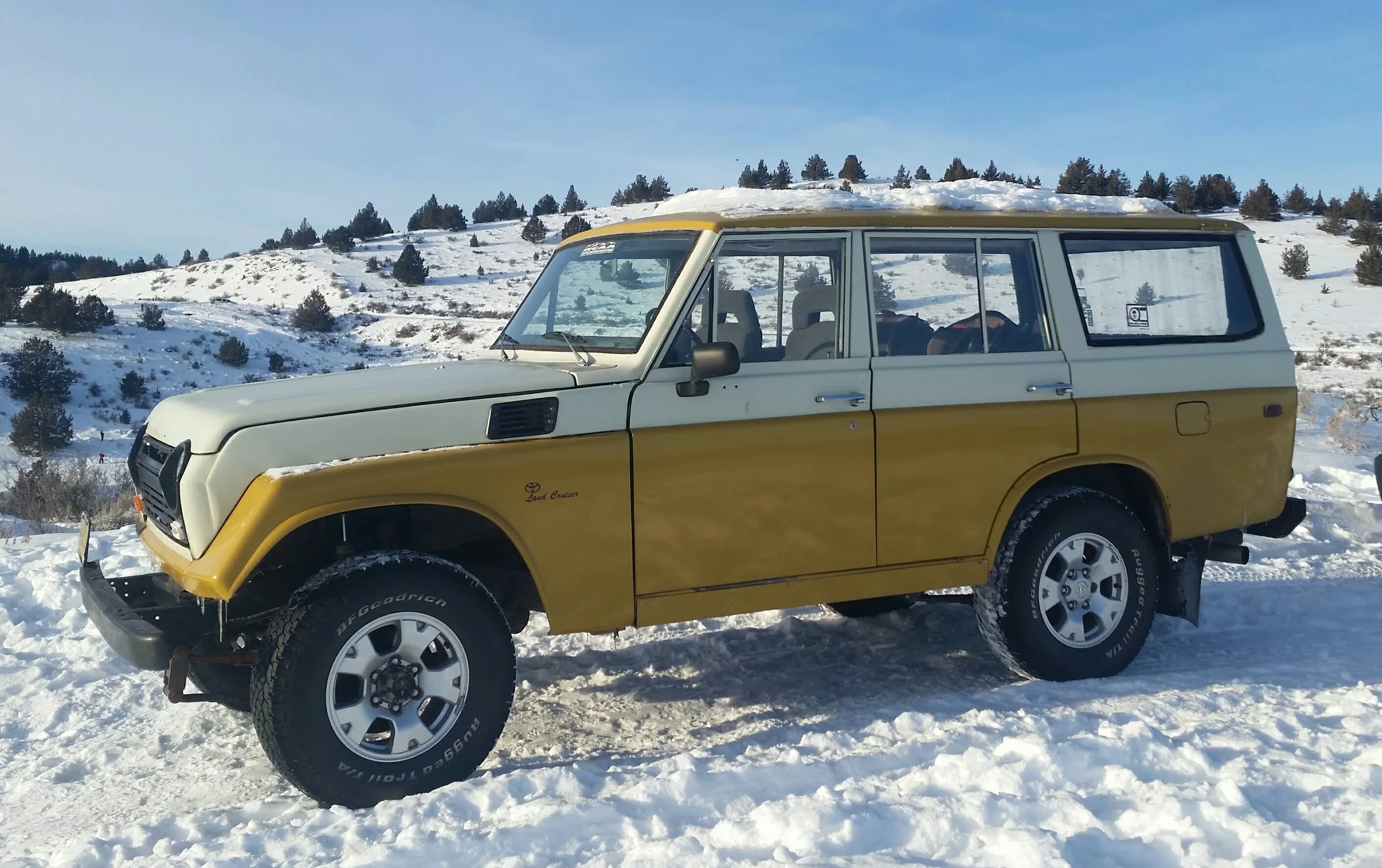

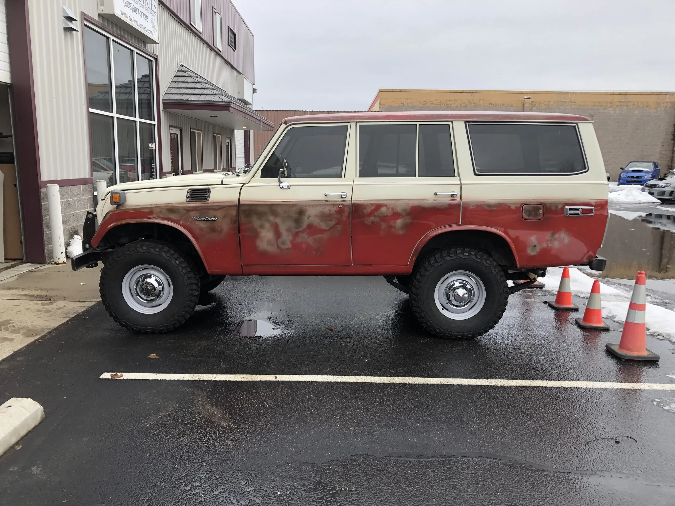

16” City Racer rims, 235 / 85-16 BFGs, stock suspension, 1” body lift.

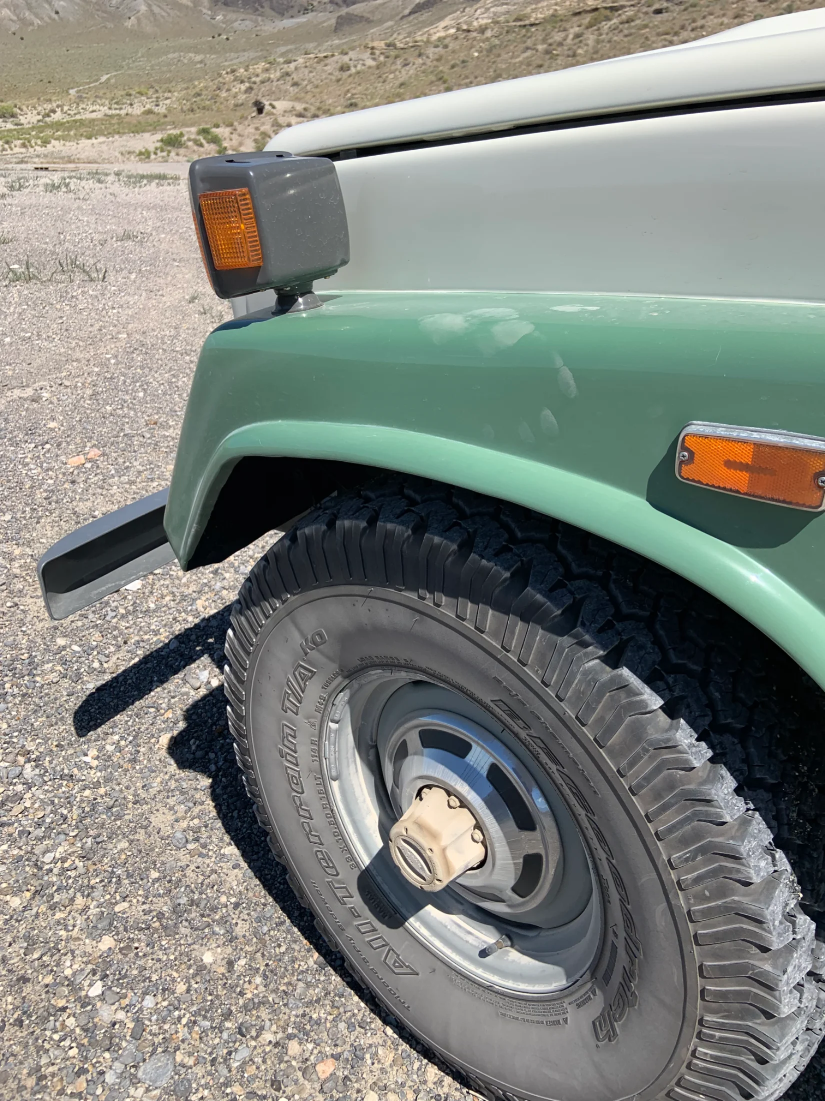

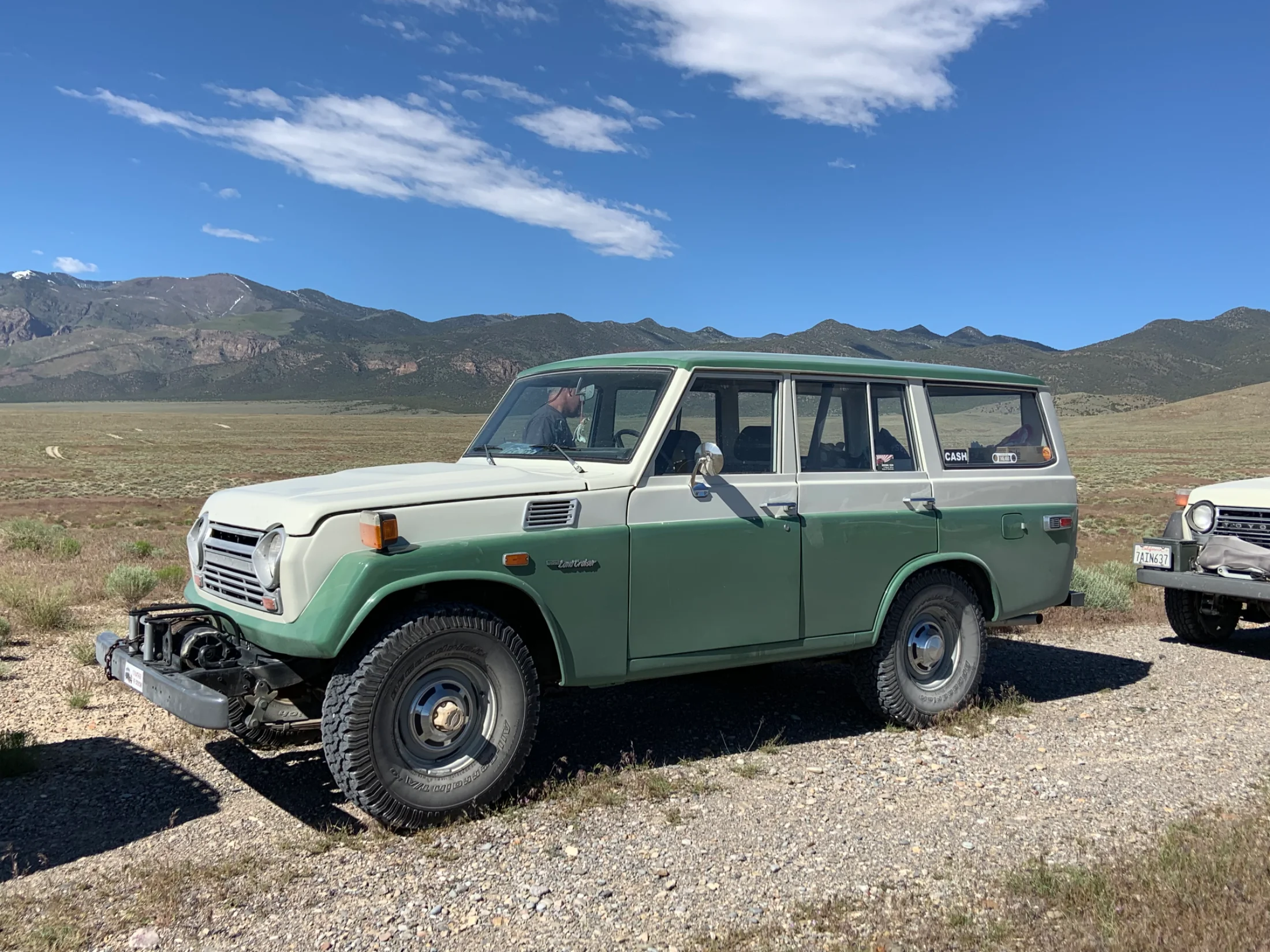

I know you said “no lift” but I send a pic to cityracer of those exact rims/tires on the other fj55 I have. It’s sitting on the common OME lift (70 springs in rear, minor relocation of rear hangars required).

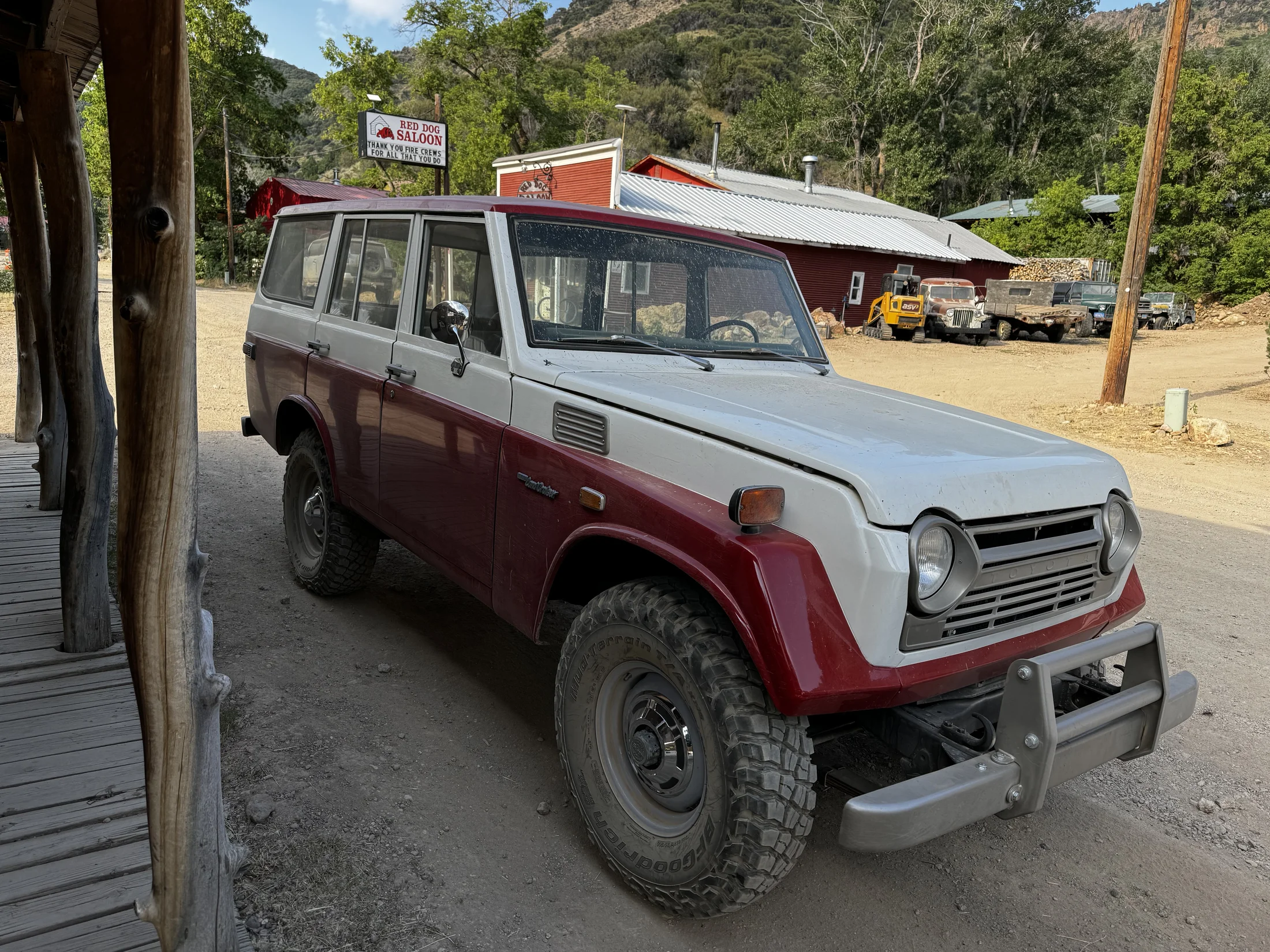

Not currently mounted but these are my original 55 rims that I just got powder coated and those are Kenda Klever 33x9.50 RT tires. I have the "common" 70 series OME lift on my 55 that @gonzopancho referenced which gives you about a 2" lift. FWIW, I removed BFG 33x10.50 ATs from those rims. These Kendas are getting pretty good reviews but I don't think they look period correct. You would pretty much have to go with a bias ply tire like the ones you are considering to get that look.

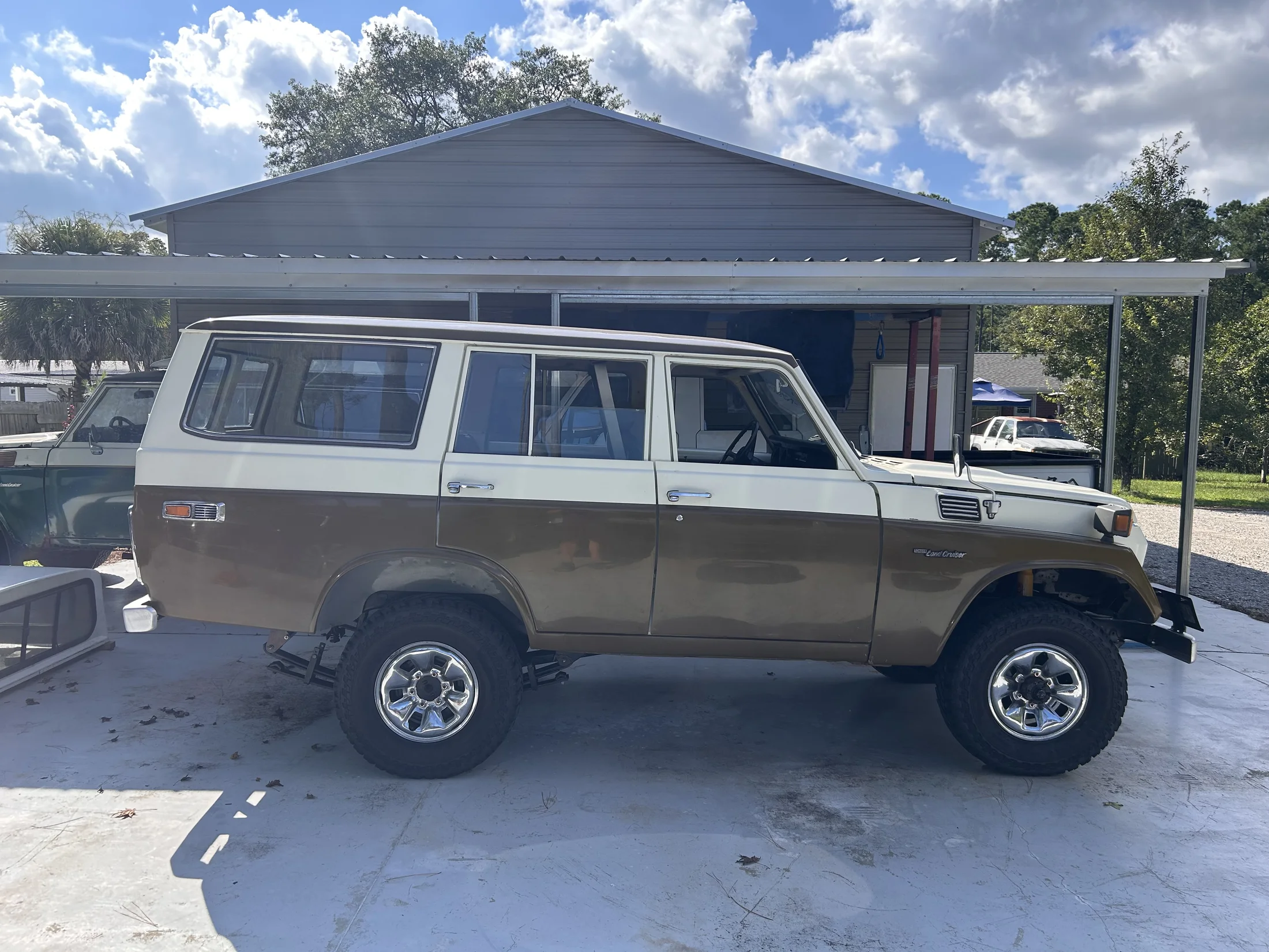

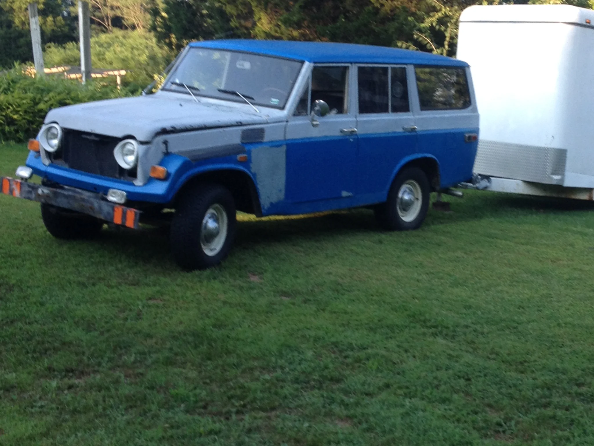

I have Dunlop 7.50R16 tires on my '83 Troopy and my '94 FZJ75 pickup on 16" retaining ring rims. They can be a little bouncy until you get the flat spots smoothed out if you haven't driven them in a few days but otherwise they ride okay.
