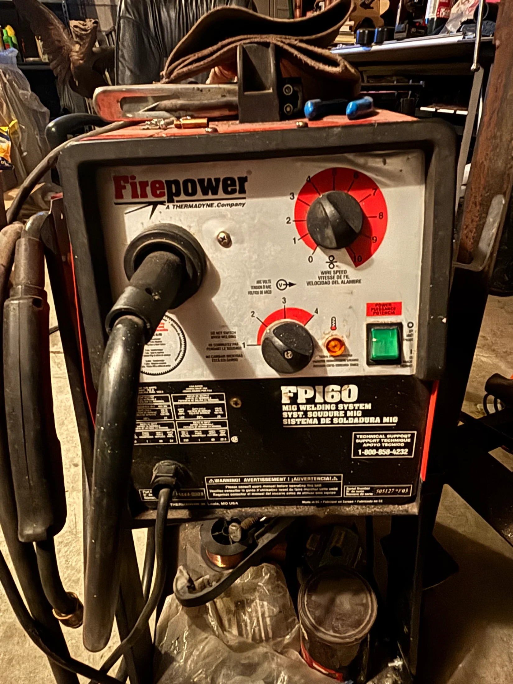

So MIG welding..
What size wire and what are you settings for Pig Steel?
So MIG welding..
I’ve gotten my best results using .023”/.025” wire on a lower amp setting (80?) and a medium-slow wire speed.
Used to use a cheap hardware store brand called Forney, but later switched to Lincoln wire which can be picked up at Home Depot (no welding supplier in my town).
The sheetmetal duty welder is a 160AMP POS that was given to me long ago. It’s burned through countless spools of wire throughout the Fly By Night saga. Took awhile to work out its issues (or maybe my issues), but does what I need it to do.
The settings in the pic are what I ran with on the latest Pig body jobs.
