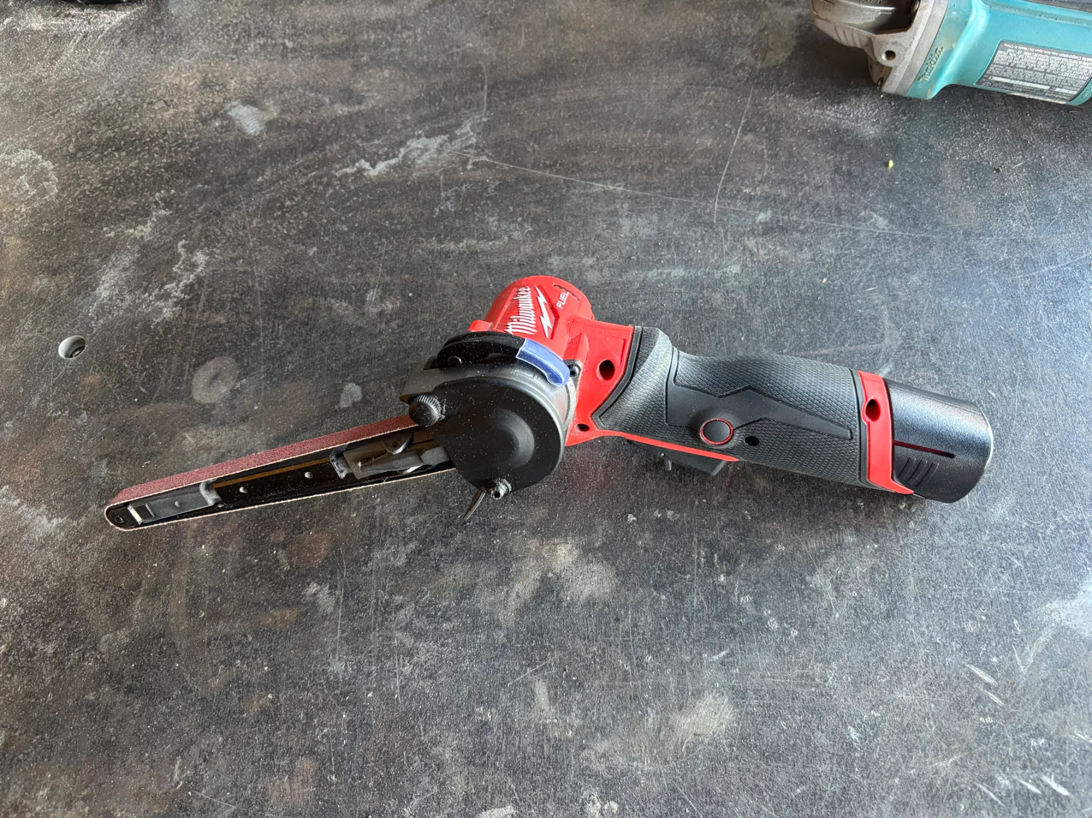

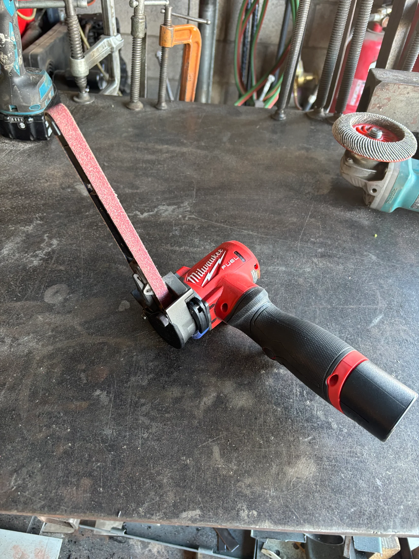

Usually I hit spotwelds with cutters. I’ve seen them done with the belt sanders. The belt sanders are supposed to be a lot faster getting things apart, but don’t know how well that method works when putting the same pieces back together. It seems like you’d end up with a larger area to weld back together with thinner material on the periphery, as opposed to a cleaner circle to plug weld

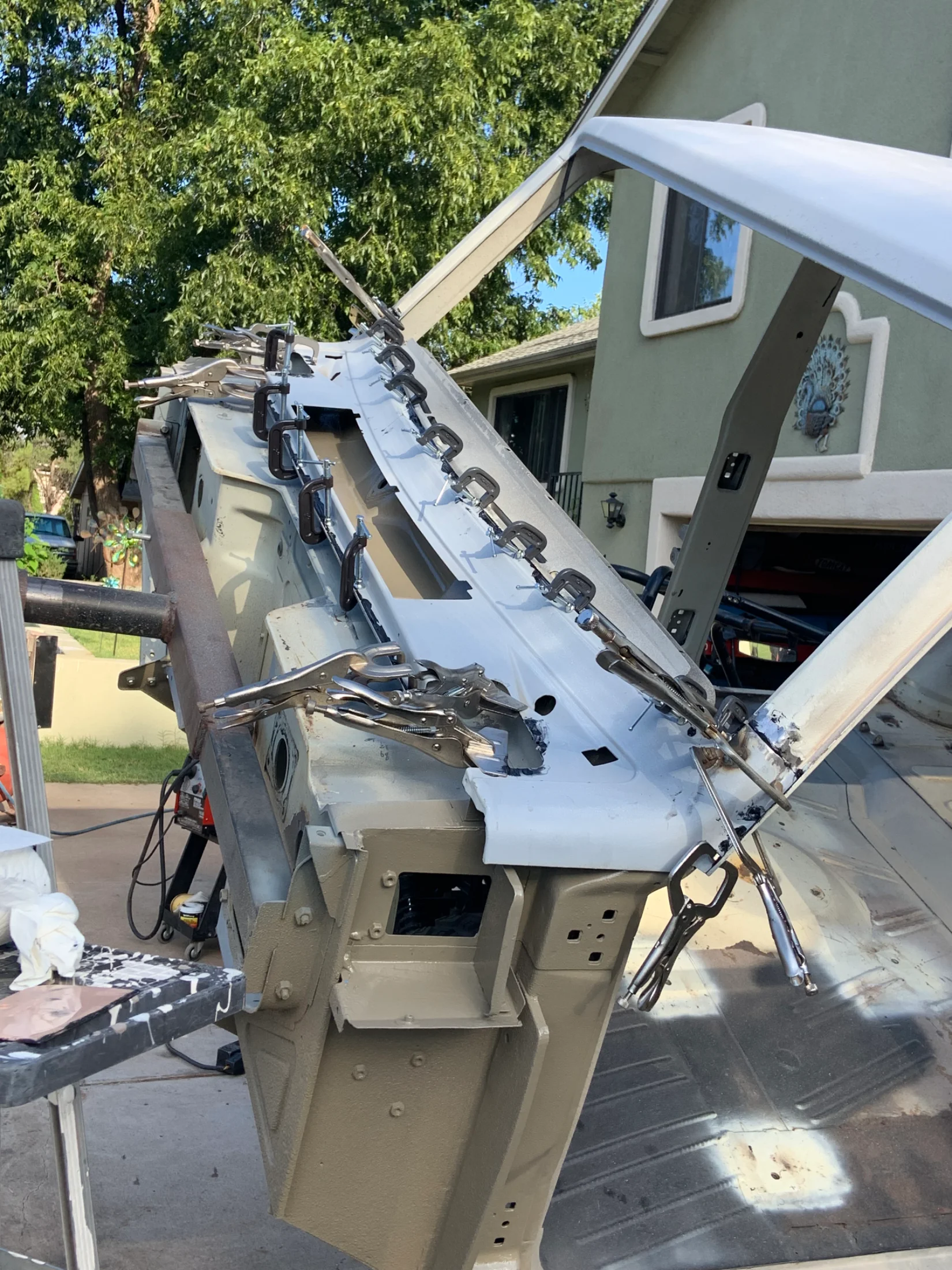

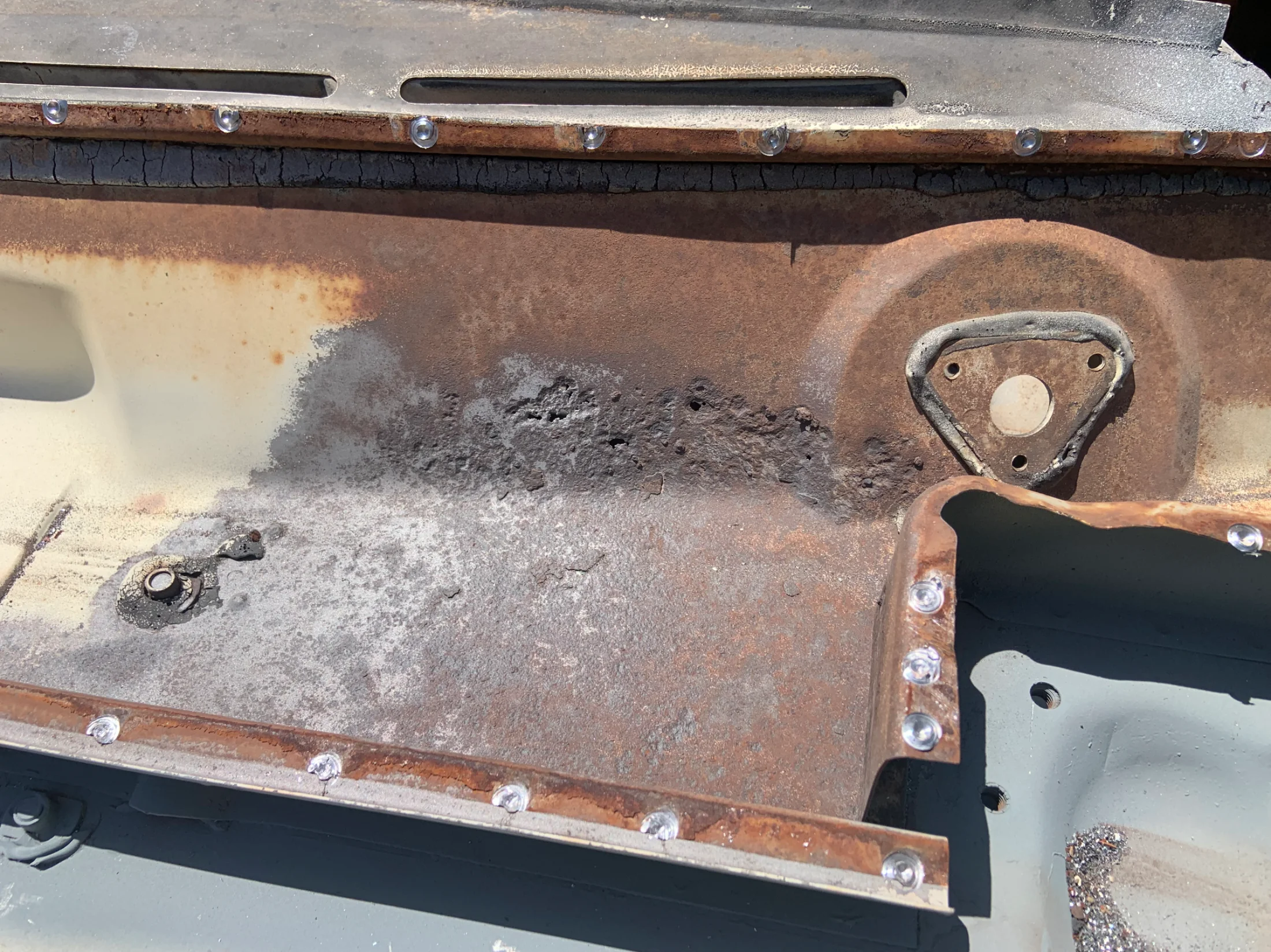

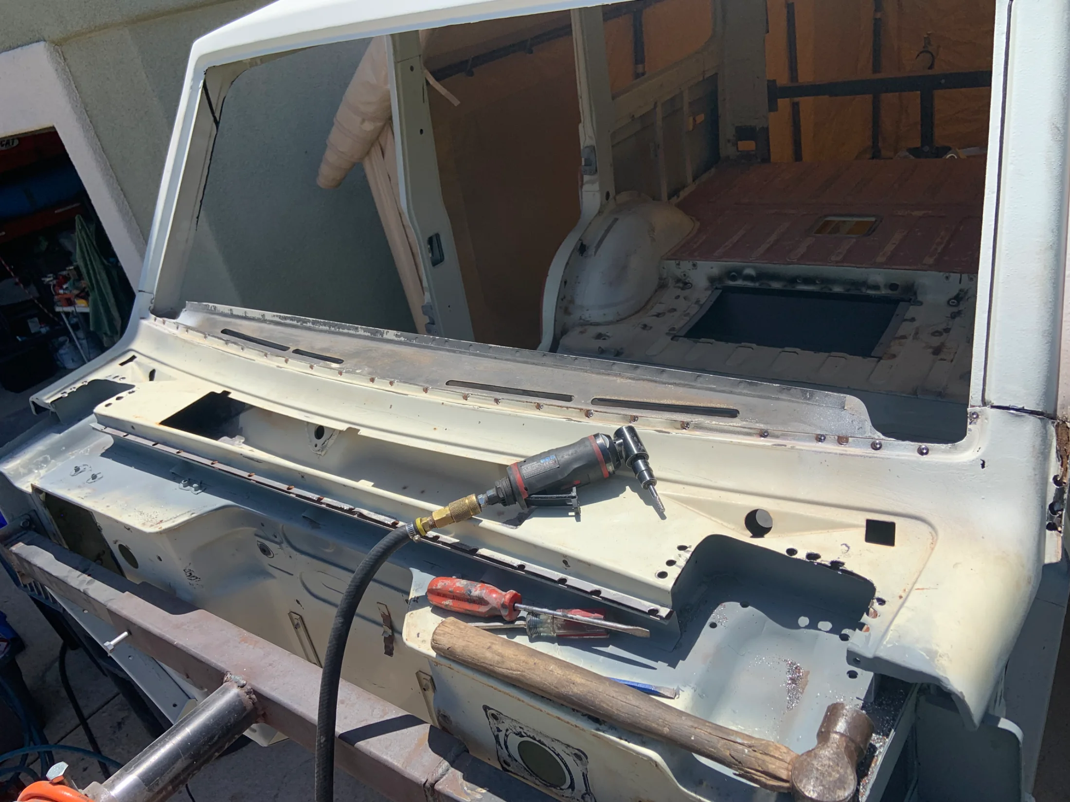

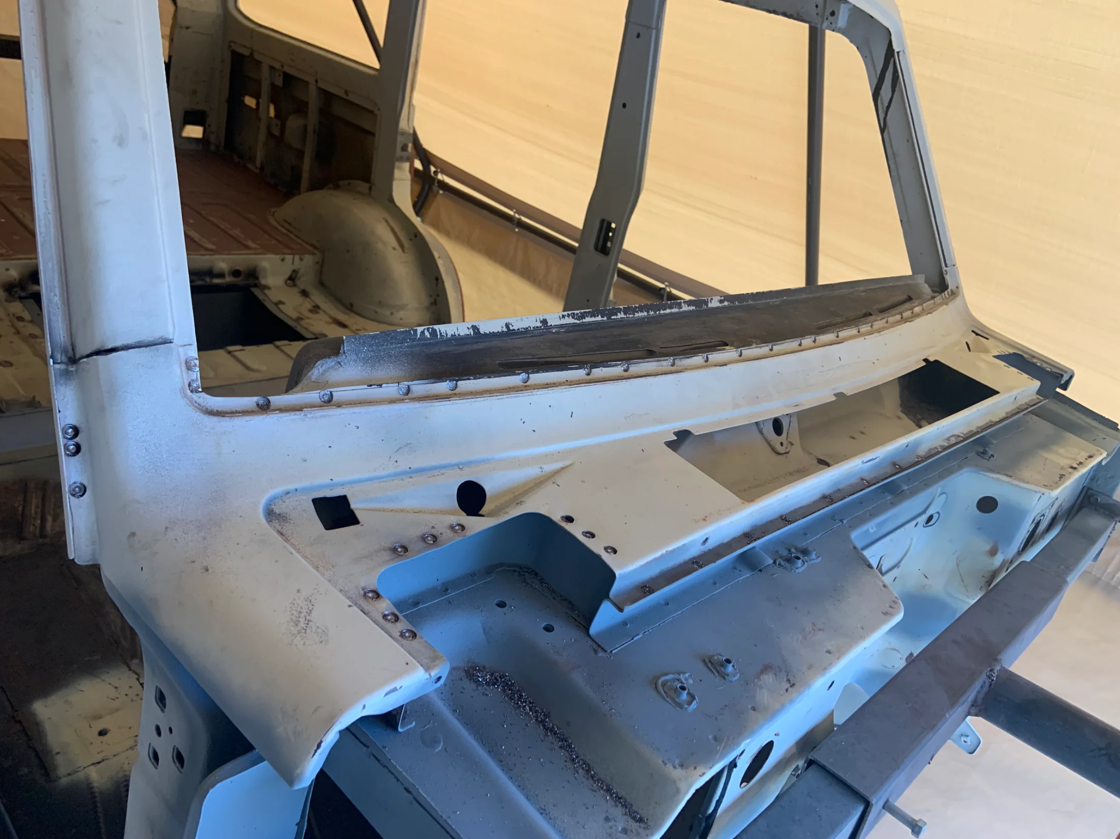

You did a fantastic job removing and reinstalling that panel but I addressed those same areas without removing it.
You are correct there will be times that drilling is a better option than grinding but as a rule I don't remove welded body panels unless the damage is beyond what can be repaired with it left intact ( large rust holes / smashed ).
Interior surface rust can all be addressed through small existing or drilled holes, the tools and supplies used to be very specialized and expensive for this but with sites like Amazon selling all of China's tool catalog this stuff is cheap now.

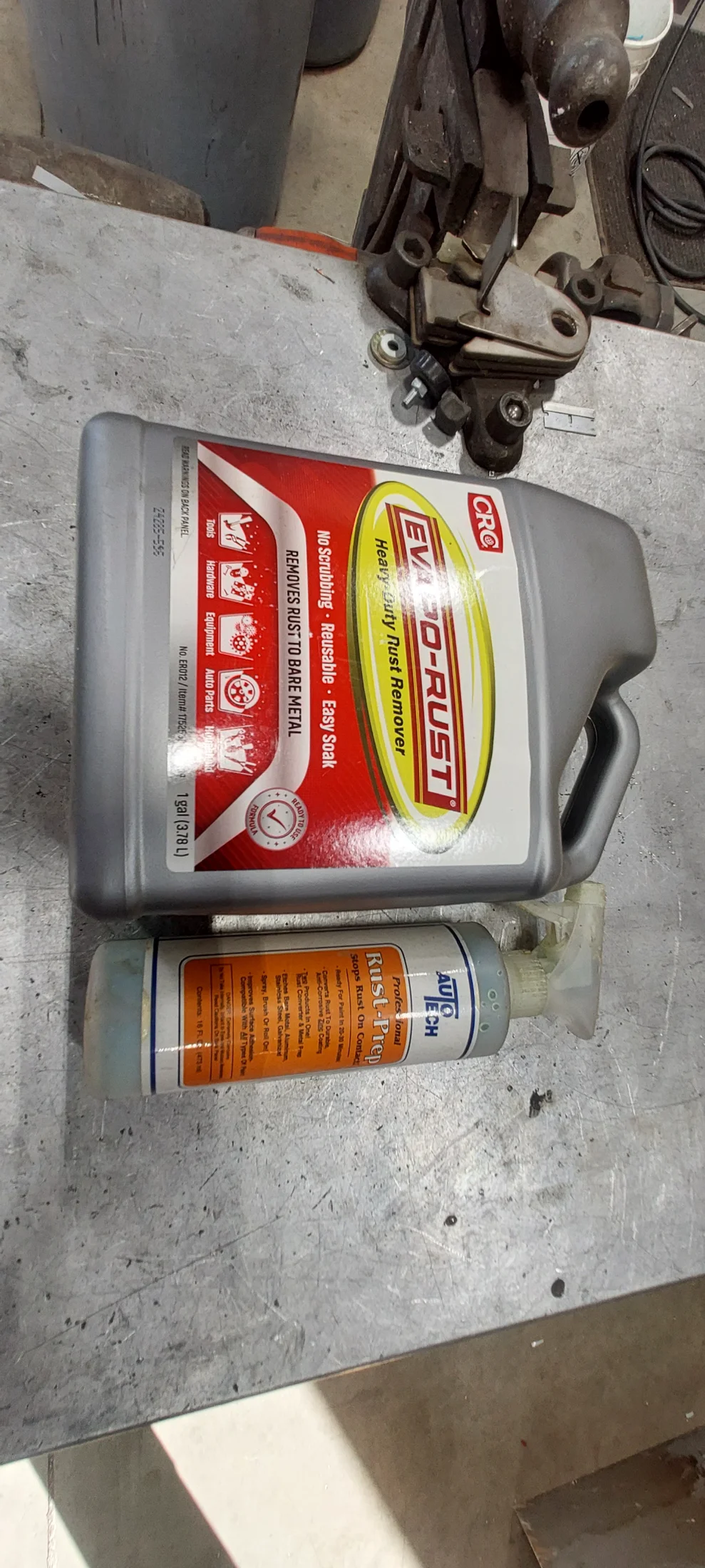

Some of the stuff I've used recently.
I'll spray something on the rust first..

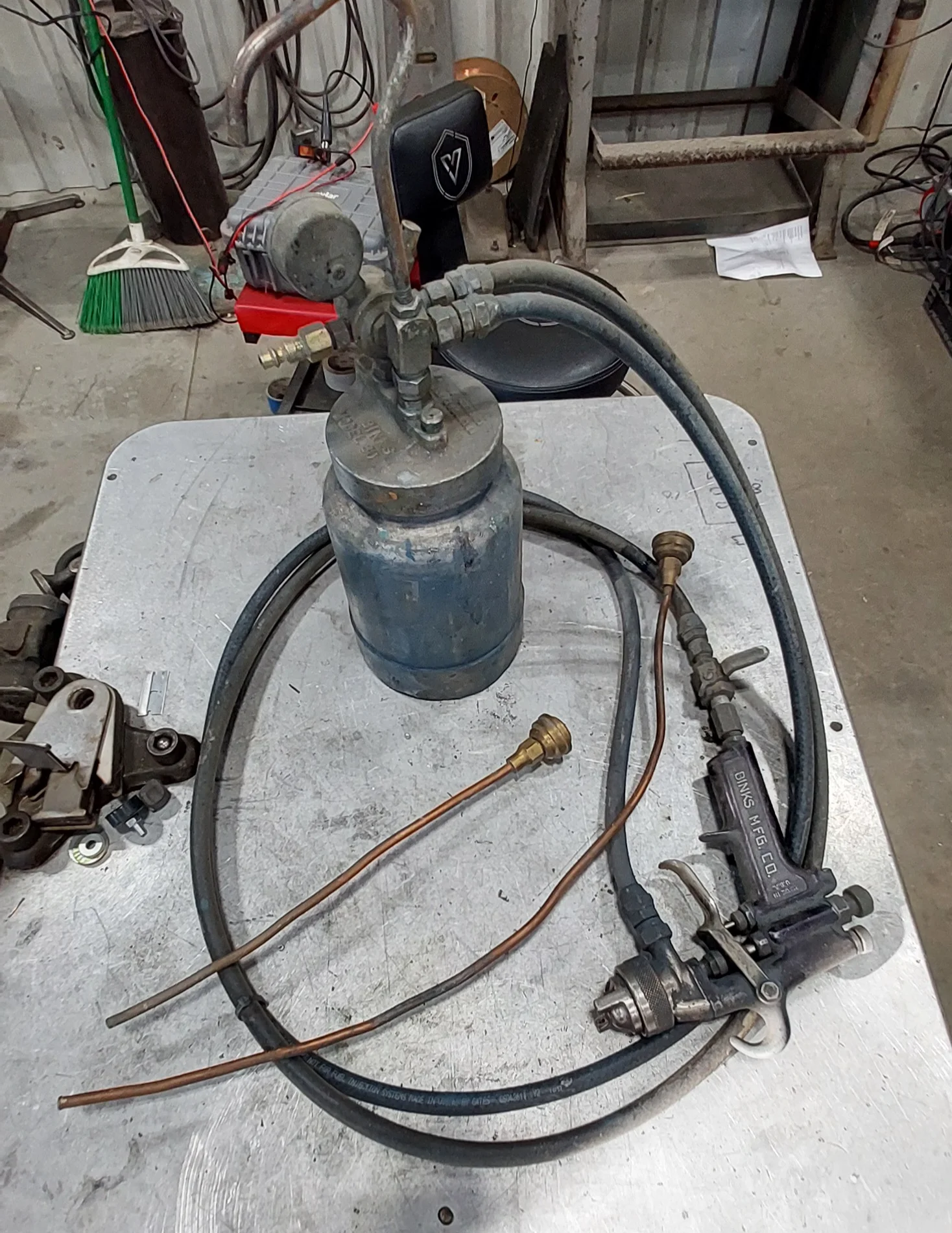

Then I'll spray a coating like POR-15 or any of the rust converting/directly on rust type coatings or a two part epoxy marine type primer with a pressure pot and an extension tip on my spray gun.

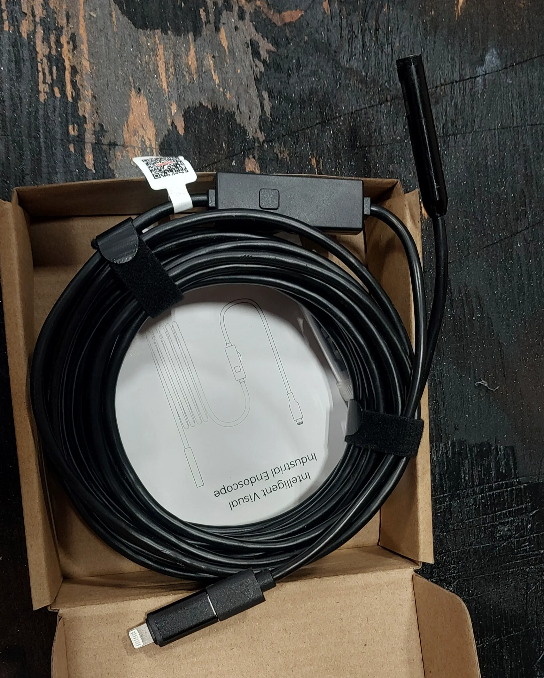

I'll use one of those endoscope cell phone cameras if mirrors and flashlights don't work to see what I missed.

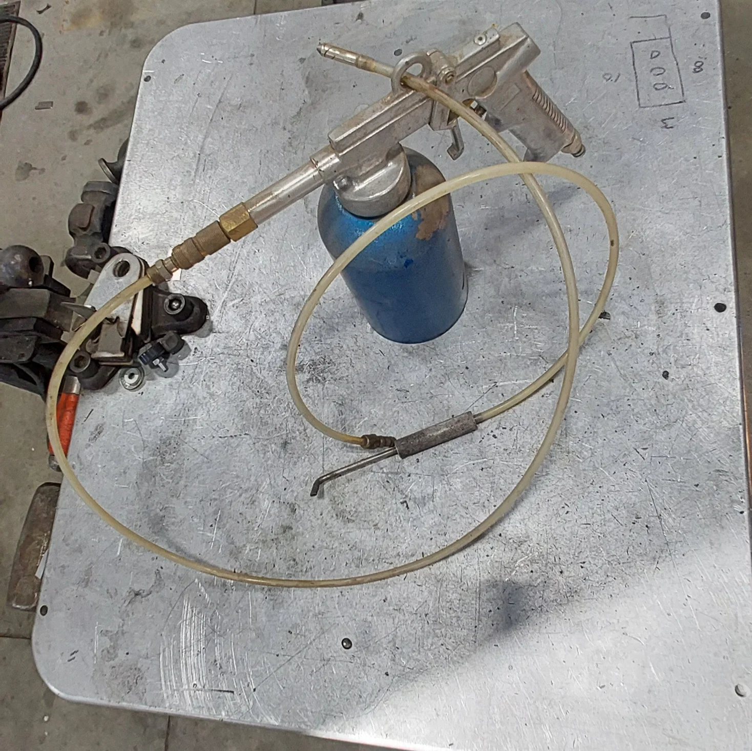

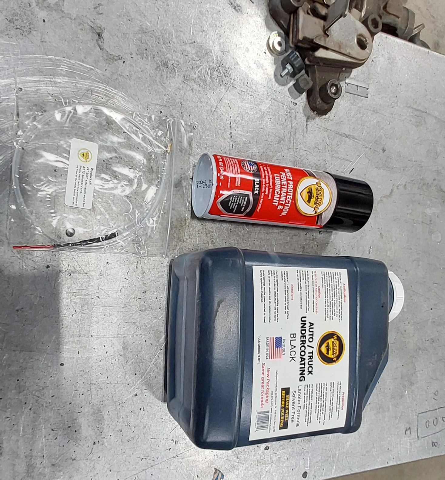

If everything looks good with the paint I like to use a lanolin base coating as a top coat and literally hose it everywhere as thick as I can. Up in every pillar, down in every seam, up in the roof sections that are prone to rust and let it drip out the bottom if needed..
I have a gun just for this but I also buy it in a spray cans and they come with an extension nozzle that will help you get into some areas.
The gun nozzle will spray straight or in a 360 pattern.
I found a similar version to this on the Amazon for $11..
