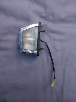

Dang that looks close
that is the old version. He needs the later model that is 2 lights on the side of the plate.
