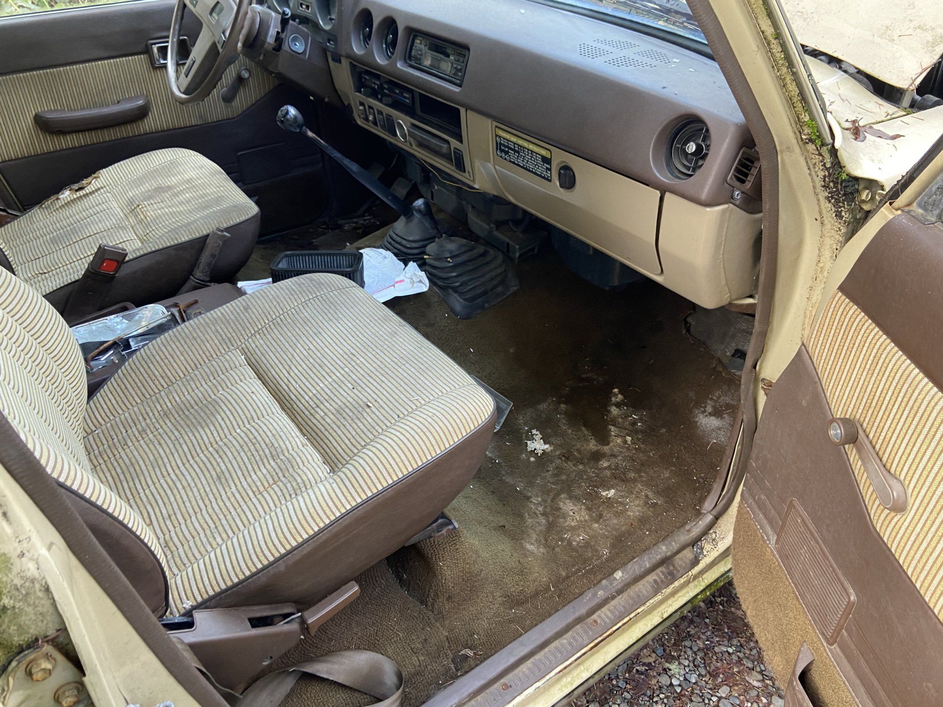

Hey all, I've caught the bug for a 60 series and may have stumbled on a good deal but I'm curious to know what y'all think. I've been offered a beige 1985 FJ60 with 292,000 miles on the original 2F for $3,000. I would not need this to be a reliable driver at first but I would hope to be able to fix it up by summertime. Eventually an engine rebuild or replacement would be in order. I am not an experienced mechanic but I'm excited to learn and totally prepared to take advantage of having Torfab nearby.
Pros:
* Low price of $3,000
* Weber carb
* De-smogged
* Best color
* Newer radiator
* Newer exhaust manifold
* Original wheels
* Body in good condition (very minimal rust on rear wheel wells, straight original bumpers with caps)
Cons:
* High mileage
* Some rust on tailgate
* Sat under a tree for three years
* Very dirty interior but seems superficial (no cracks in dash)
* Loose valve on second cylinder (noticeable tapping in lower gears)
* Factory tach doesn't seem to work
* Factory gas gauge doesn't seem to work (waterlogged from sitting unused with fuel in the tank?)
* Rear hatch latch only works some of the time
* Needs a new exhaust pipe
Would you go for it?

It deserves a good bath. I added a few more photos, thanks for your feedback!
I would move to the con side: Weber carb and desmogged
by most accounts Weber is not better than Aisin, either OEMor the non-USA version you can get if desmogged
unless you know what was done for the desmog you will probably be pulling your hair out trying to figure out why it won’t run right.
It looks like you will need a new tailgate too.
since you are not an “experienced mechanic” that suggests you have some disposable income. You might think about waiting for something nicer to come along.
but if this is the one, forget about everything I said and jump in with both feet and enjoy! It’s all about the joy.
Desmogged but still has the air rail? You should get it anyway and build it like you want it. If you needed it to commute then no.
That surface rust on all the engine parts tells me you are gonna break some bolts on disassembly. You will likely have to refresh everything and have a new truck in a few years. It's only $3K now but it's gonna cost a helluva lot more. But it will be worth it (excepting if the frame and body rust isn't too bad).
I would probably snatch that up for $2500. I would not pay $3k. That's if no other major issues show up. You can probably find a tailgate in a part out on here pretty easily. I don't know what a good clean one goes for but I would guess $500--$600.
If there are other smog parts still hanging on it like the above mentioned air rail, you could help out a California cruiser owner with some parts and recoup a little of the purchsse price.

In this price range, it can also mean 'needs significant engine work'. May not, but be prepared for it.
The rust scares me, but if I had the time and the space, I would love to have a $2,500 - $3,000 FJ60 and $7,000 to spend on it. Its amazing how quickly the money will go, but I've learned (through slow, expensive and painful lessons) that Time+This Forum + Want to = the ability to do almost anything as it relates to working on and fixing an FJ60.
Need to see some more of the frame.....but $2500 would probably be the number where I'd start to feel comfortable with a purchase. $3000 just feels like a stretch.
I'd buy it for $2500. that would make a great Winter beater. I love FJ60's in the snow, but my current one goes into Winter storage. ;)
Mine looked a lot like that when I first bought it - for about that price. I ran it as a toy for a few years until I got around to deciding to do the engine transplant and suspension upgrade and a bunch of smaller improvements. If you take that perspective it might be worth it. If it's in running order, play with it for a few years knowing you'll have to sink some more dough into it in the future to make it more than a toy. Or...save up a bit longer and get one that's already built. I think we'd all agree that you can buy a built rig for less than you can build the same rig.

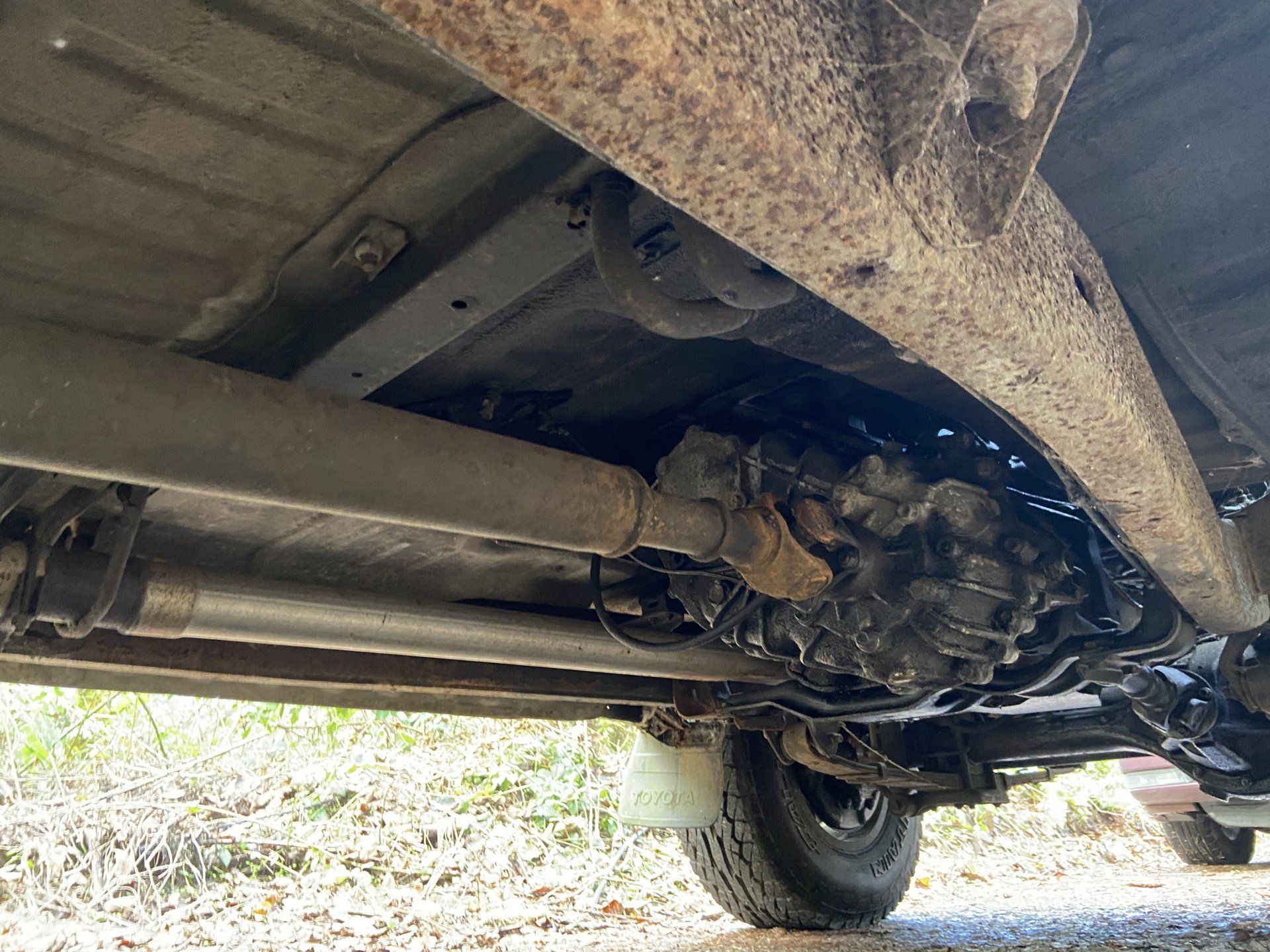

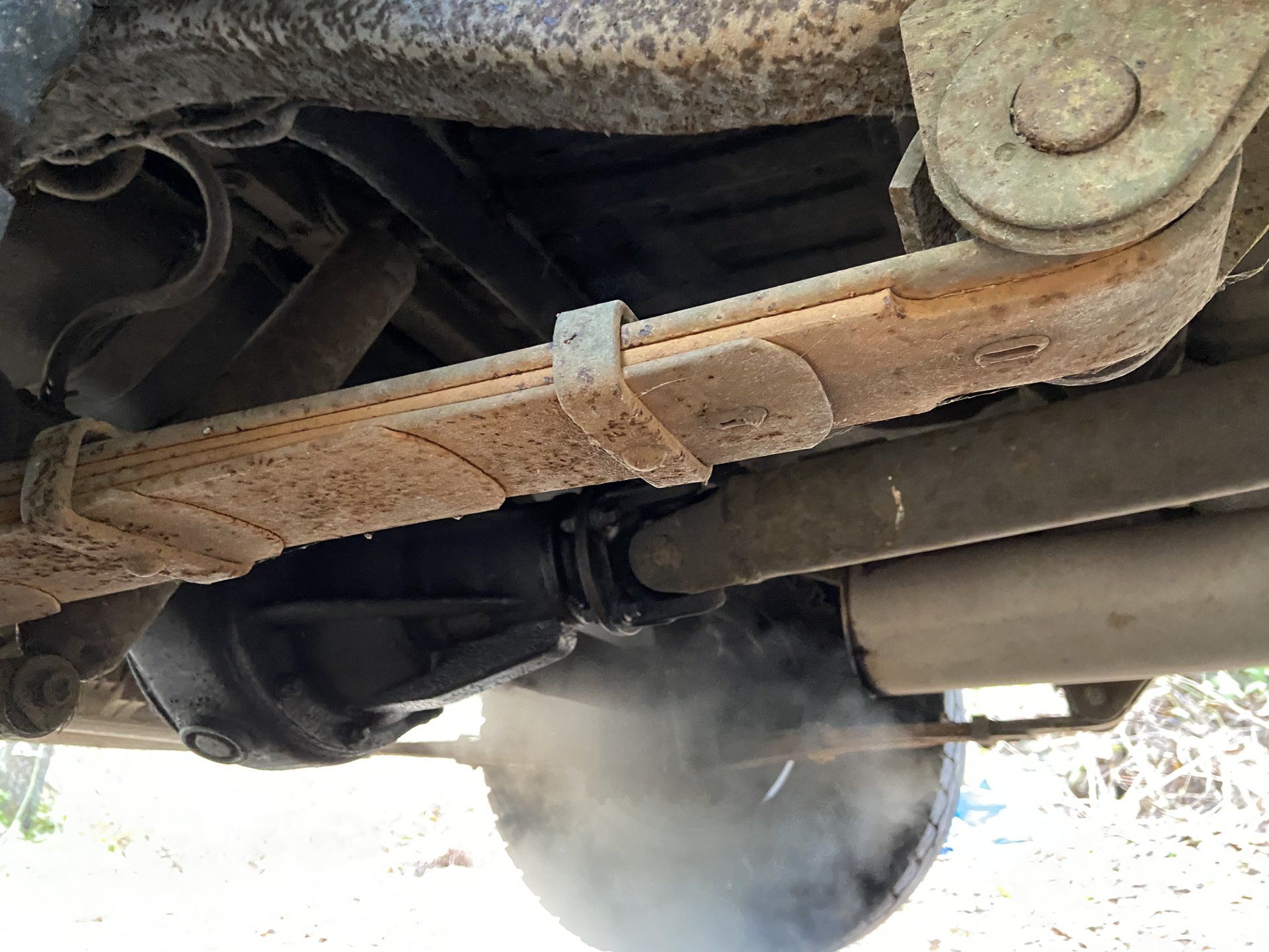

Thanks everybody. Lots of good feedback here. At $3k or lower I’d be ready to pay for a head rebuild at a minimum.
This is the only photo I have showing more of the frame. It seems surface-level to me but I trust your eyes better.
Looks like surface rust in that section. Look at the shock tube and the frame from the forward rear spring perch back. That's where the frame goes Swiss cheese first in my experience.
