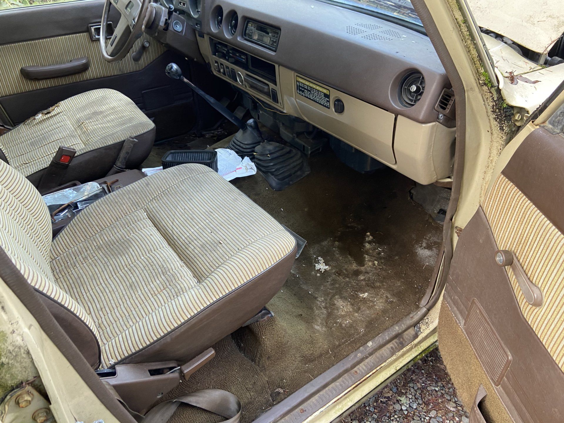

In other news I'm very nearly finished cleaning up the interior. I've washed all of the seat upholstery, cleaned a lot of duct tape gunk off the center console, and shampooed the carpet in the front 2/3rds of the truck (I threw out most of the cargo area). I need to buy a couple more zip ties to finish reassembling the passenger seat (screw hog rings) and am waiting for some Lloyd's mats to arrive before I call it gucci.
I made the mistake of leaving my driver's seat sitting upright on the back patio one night last week and a neighbor made good use of it.

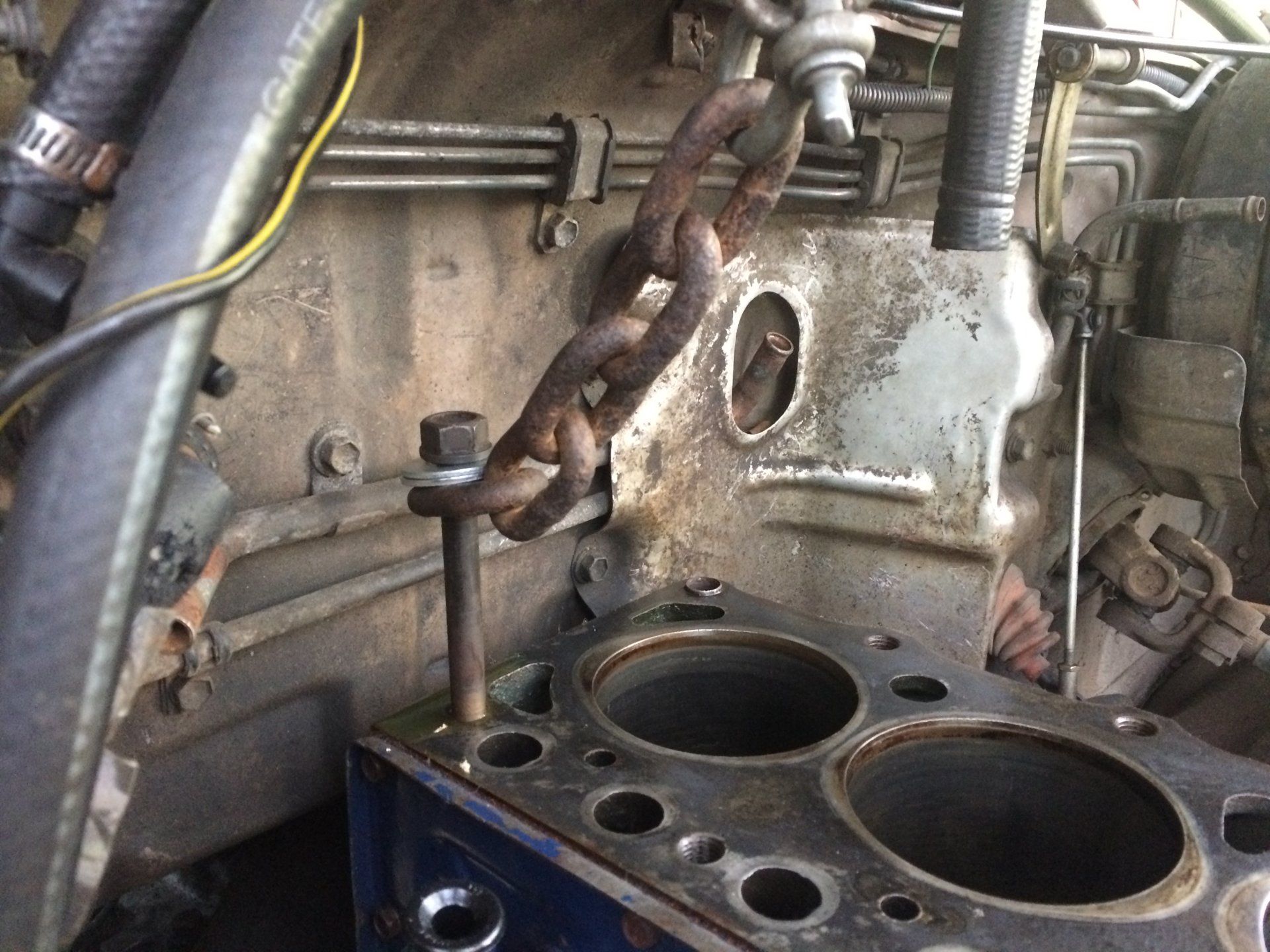

Nice work! I really hope to see a similar sight next weekend. :) Tell me about how you attached the chain to the engine block without the head, it looks like that rear bolt is attached in place of a head bolt? My cylinder head is currently in the back of the truck and I was planning to reattach it in order to remove the block but I'd love to avoid that if I can.

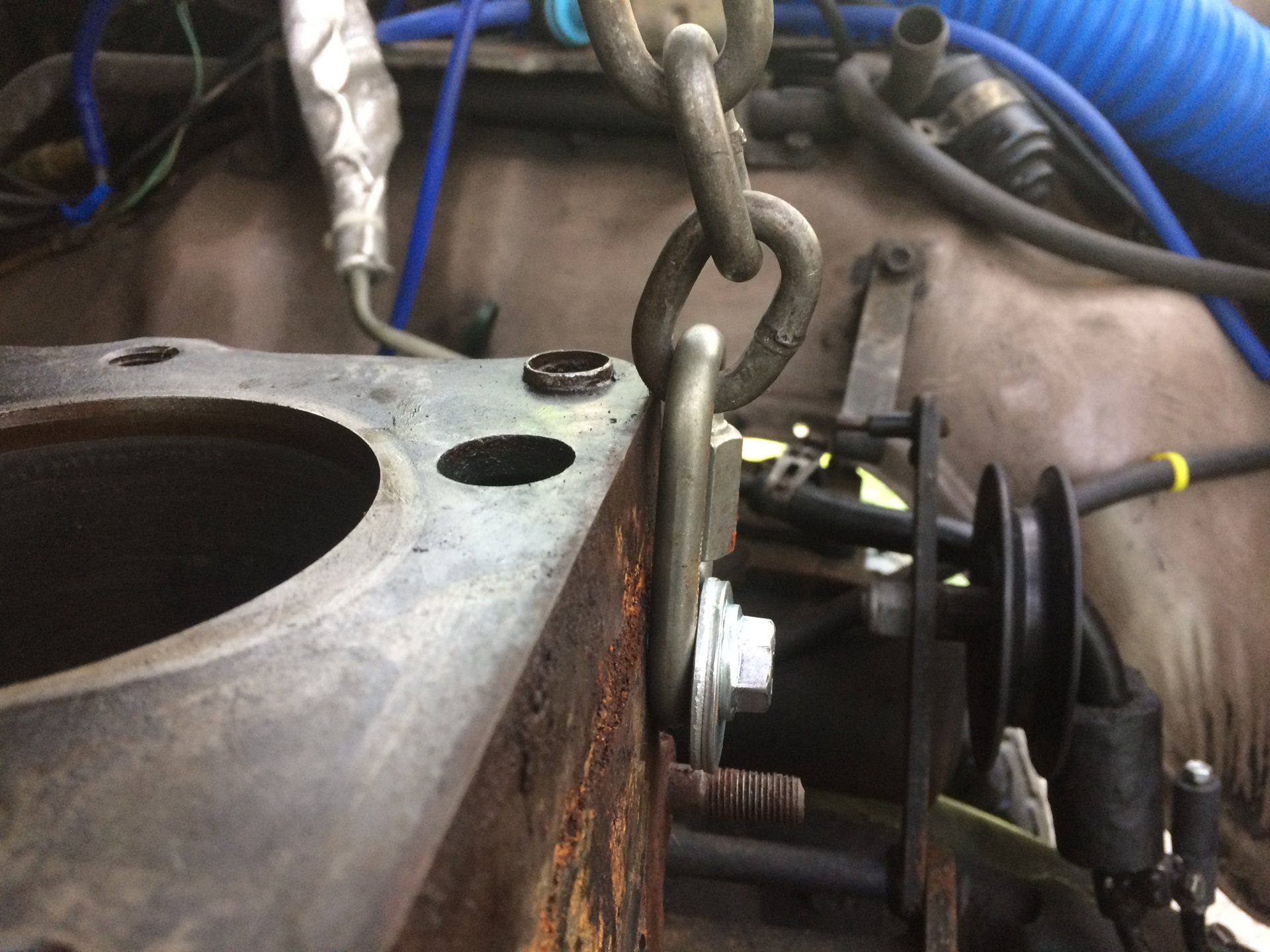

An afterthought thanks to Fred, (not pictured) I cut a stretch of pipe to slip over the shaft of the headbolt and sandwiched it between washers at the rear corner.
At the front I followed Matt’s suggestion and used a waterpump bolt.
Zoom in and you can see the sleeve in this picture.
And in the second picture I bought the locking carabiner from Tractor supply.

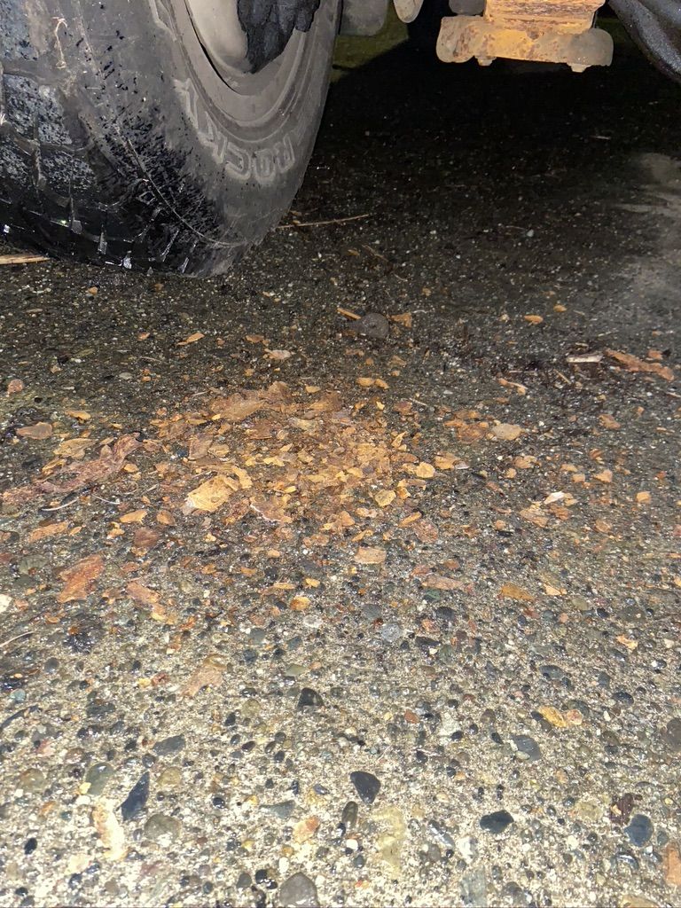

* Had someone get in touch via Craigslist who came out and drained the bad gas (most looked good but there's definitely rust and water in there)

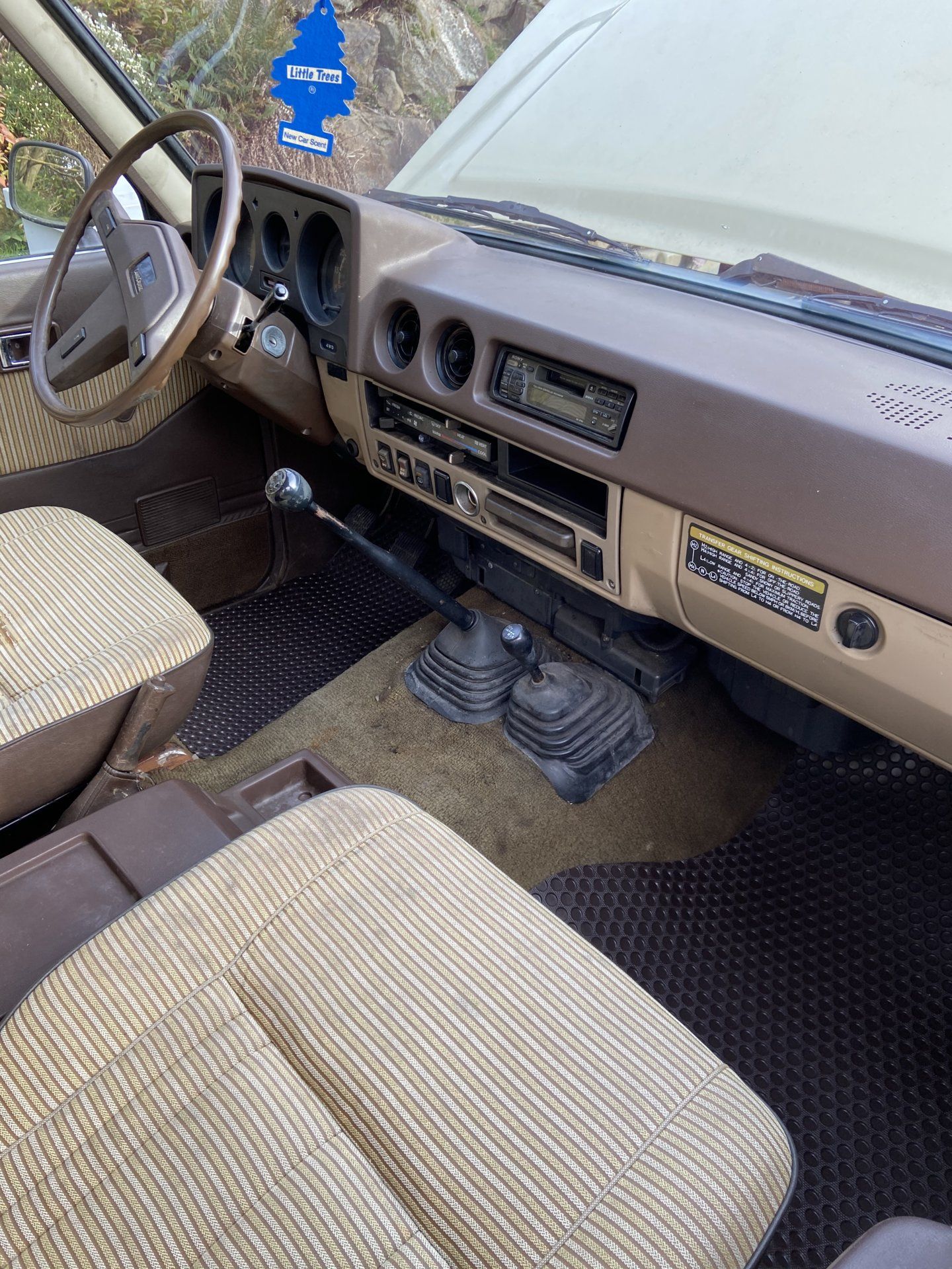

* Installed some brown Lloyd's mats in the passenger area, I think that part of the interior is definitely done for now

* Drop the gas tank and find some way to clean it up (can't find a shop in Seattle to do it... any recommendations?)
