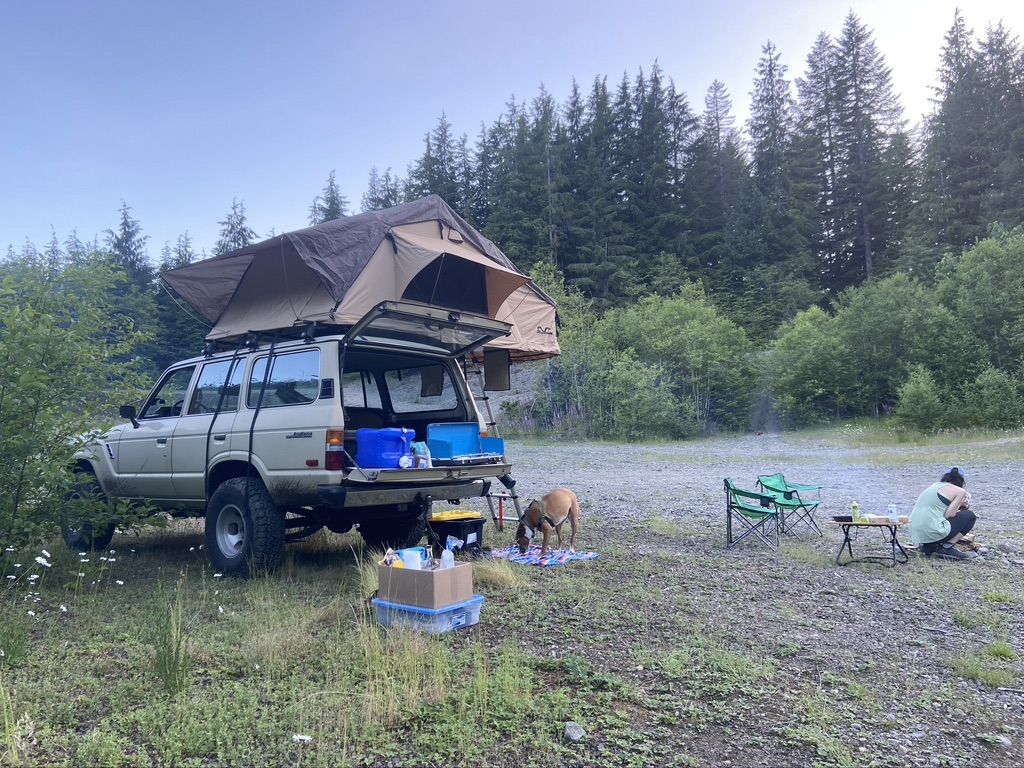

Treebeard took us into the woods for the first time this past week on a two-nighter through the Olympic National Forest. Only a small stretch of our trip required 4x4 but the truck handled it easily! We found a great camping spot off of a forest road with amazing views of the stars.

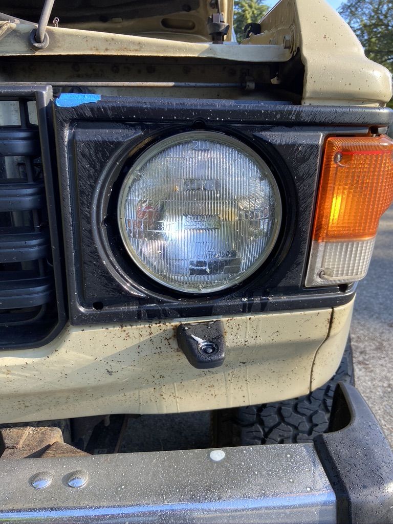

Headlight washers - These also do not work yet but I wired the motor straight to the battery and got sprayed! I haven't looked at a wiring diagram yet but it's possible that this is another bad relay. It is a little suspicious though that I'm having electrical problems with both the carb fan and the headlight washer motor...

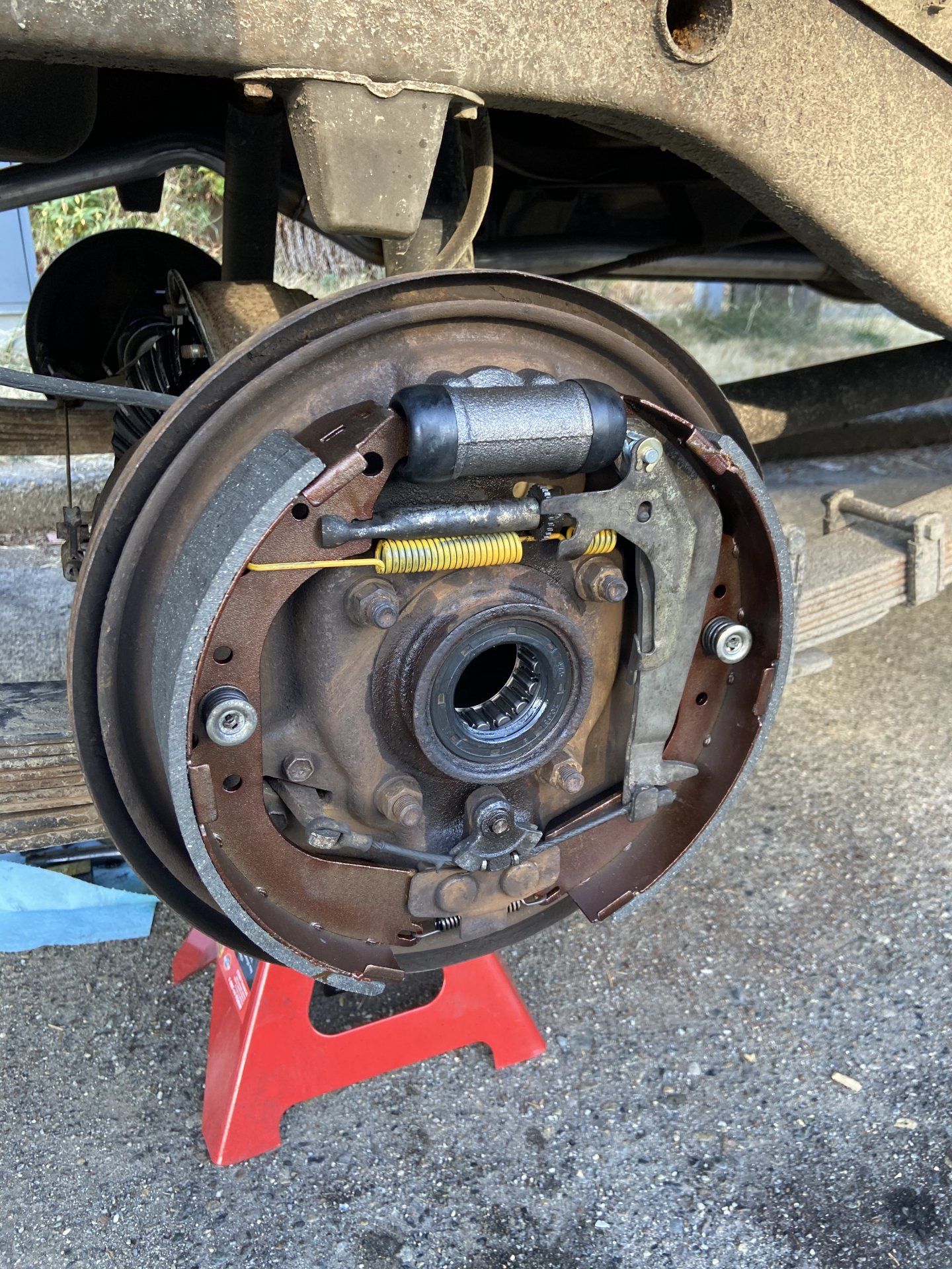

Rear brakes - Pulling my E-brake at 15mph does absolutely nothing. The parking brake holds the car on a mostly-flat surface but I've gotten into the habit of leaving it in gear when I walk away. I had a shop pull open the rear brakes for me and they said one of my axle seals is leaking so... time for a full rear axle rebuild, new shoes, and new hardware. I haven't had a big project to work on in over a month so I'm not overly bothered by it. :)

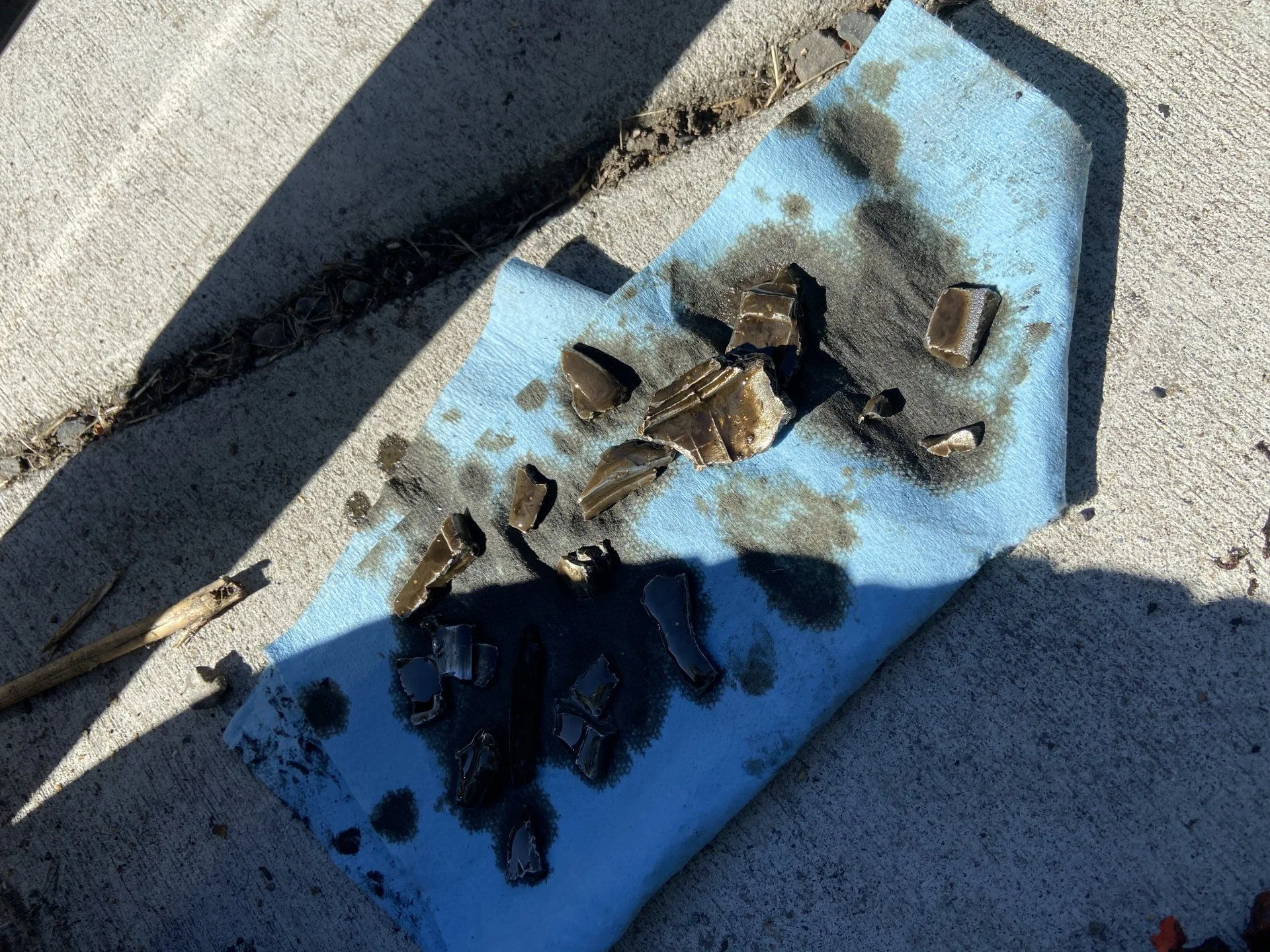

No new progress to report on the truck itself but I have finally started tearing down and scrapping the old engine block. I found this in the oil pan when I dropped it...

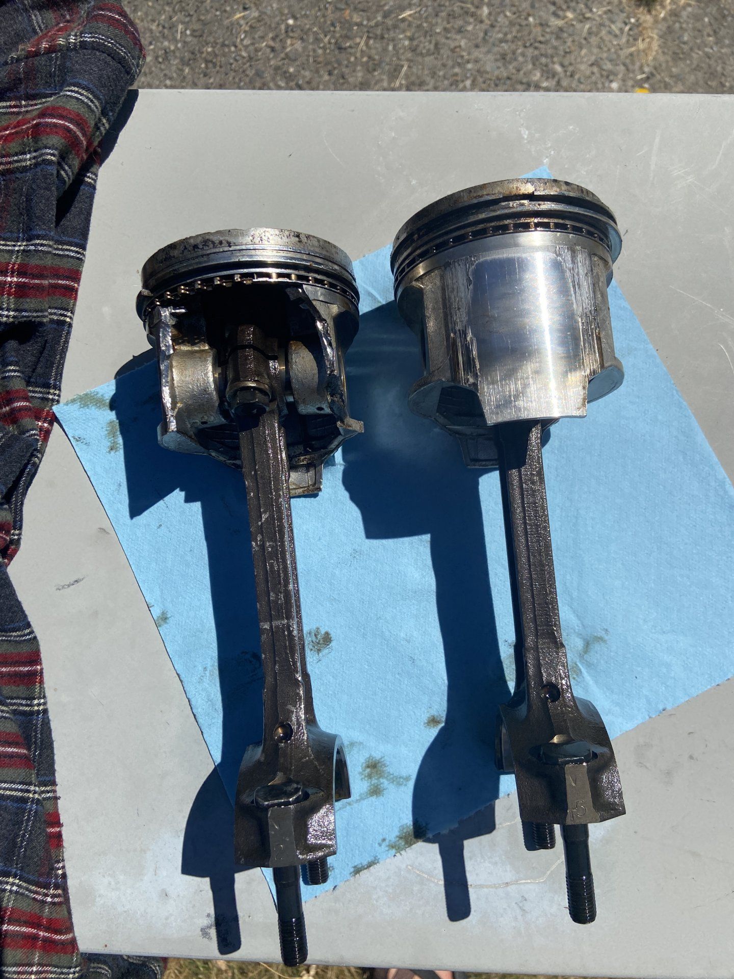

A few days later I pulled the pistons out and sure enough found that one of them wanted to produce more HP.
It feels like a shame to scrap a 2f block, even if there is a crack in one of the cylinder walls. Anyone in the Seattle area want it? I can’t store it so it has to go somehow.

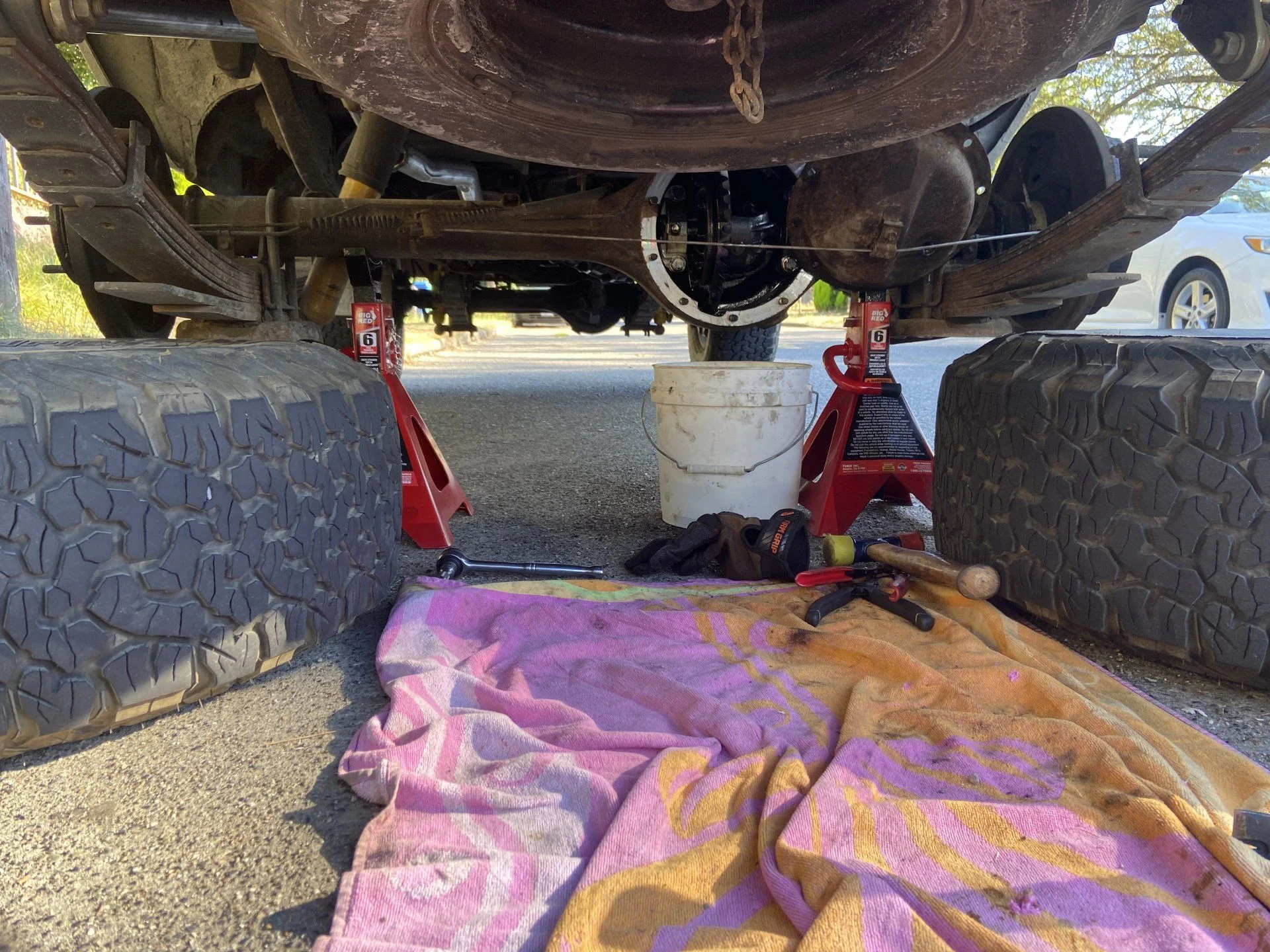

Yesterday and today I did the rear end rebuild. I encountered two hiccups. First, the pins/springs/cups that came with my brake hardware kit did not fit. I pulled the old ones out of the trash and reused them because they’re fine. Second, one of my cylinders started leaking literally as I watched. I had just reinstalled the shoes and was getting ready to put the drums on. Fortunately O’Reilly had some in stock so now I have new cylinders on both sides as well.
Tomorrow I’ll torque the diff cover bolts, fill it with gear oil, get the truck off of stands, and go for a drive. I may have over-adjusted the star nuts in the brakes by pulling on the e-brake cable by hand. 😬 I’ll drive around the block and see how it does. It’s going to be extremely nice to have working rear brakes!
