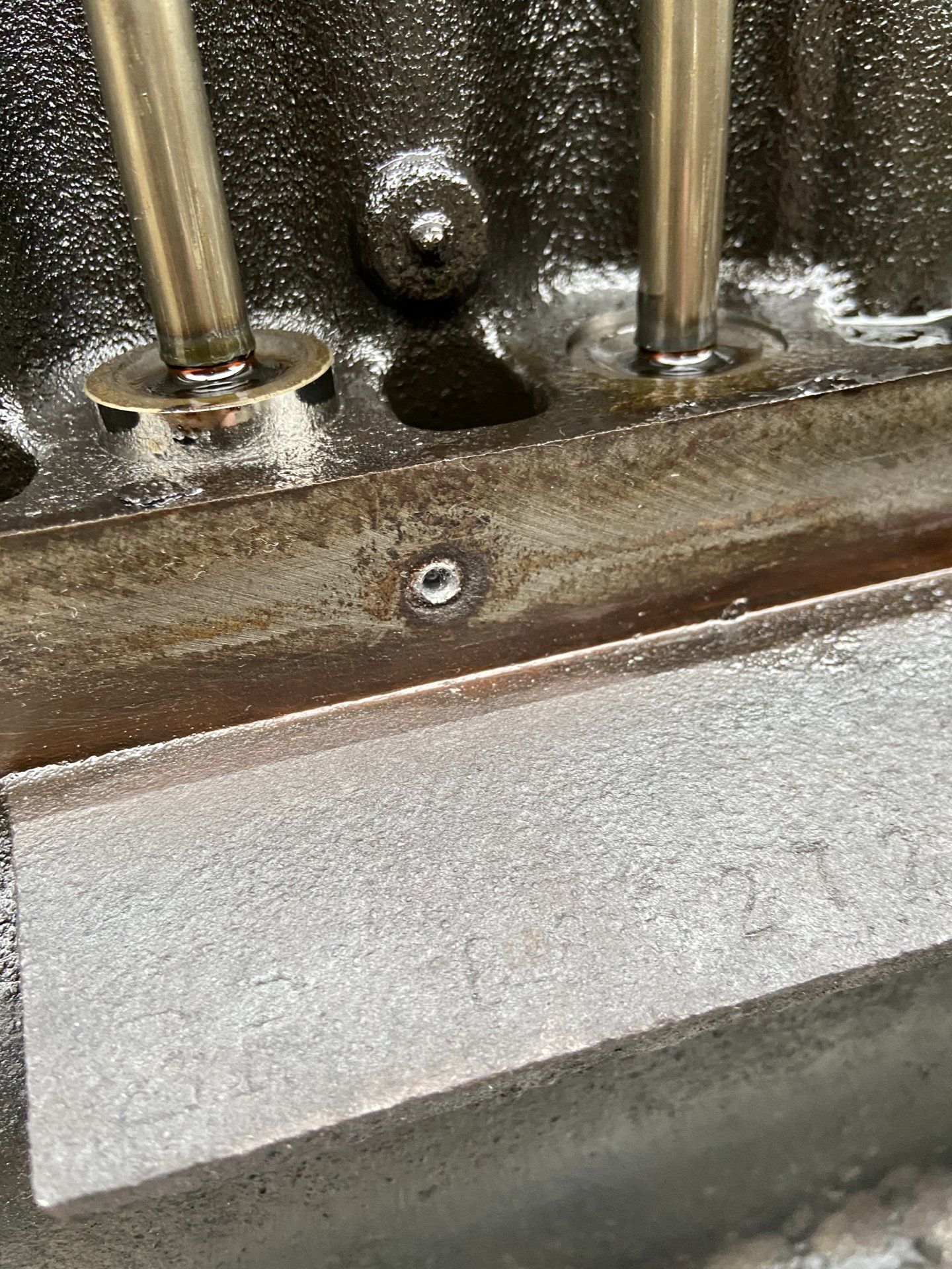

1. I didn’t check before putting it on... is the side gasket directional? Do I need any sealants to go with the gasket?
2. Two of the side cover bolts broke while coming off. They’re in spots that are accessible when the engine is in the truck and they’re not close to each other. Should I try pulling them out myself or drive it to a shop? Don’t want to mess those up...

center punch as close to center on the bolt. Start with small drill bits and move up slowly.
get a torx bit and tap into hole. Reverse out with a ratchet, add heat from a torch if necessary.

Well... no luck removing bolt #1. Very frustrating and discouraging. Started by drilling a hole in the bolt with a cobalt bit then used an extractor set to try to grab it and pull it out. It never did catch and now I’m running out of material to work with. Am tempted to try to find someone to come out and tap it for an m10 bolt and get this over with. I’m not enjoying it. :)
I assume they're m10x1.25 which means you need an 8.9mm drilled hole to retap, it's quite easy to do yourself and you've got the tools for next time something happens

Today: replaced '84/292k fuel lines with '87/165k fuel lines, removed fuel tank, paid a mechanic to remove the broken side cover bolts (clean to 6mm even after breaking a tap in the block), and replaced the side cover.
