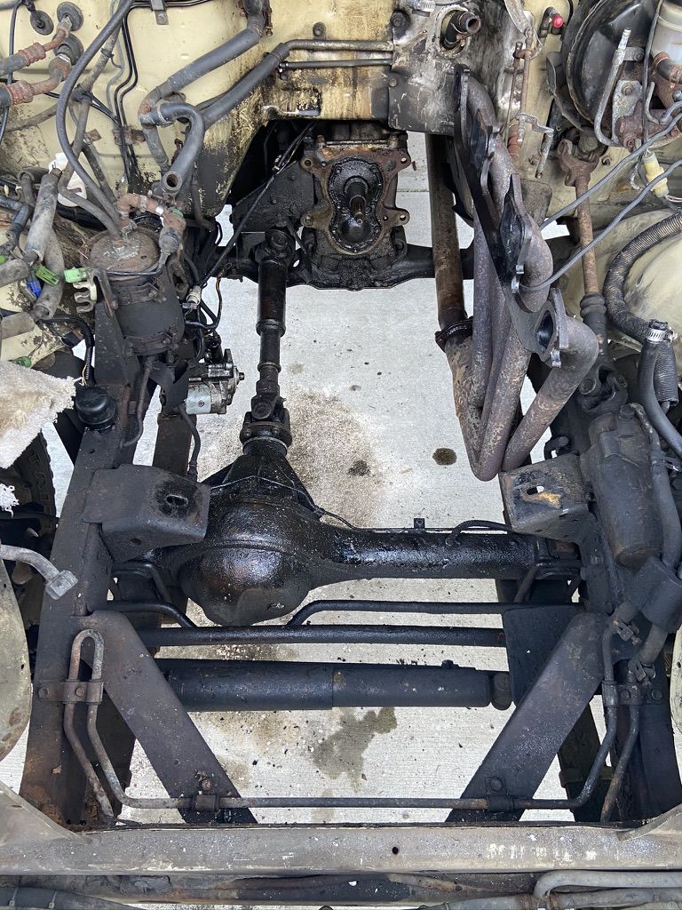

Tonight I finished draining the radiator; removed the power steering pump, smog pump, and alternator; and unbolted the AC compressor. I don’t know whether or not the AC is charged but I suspect I’ll need to get someone to come discharge it for me. I also tried removing the headers but definitely need a different set of wrenches to make that happen.
50/50 mix of acetone and atf works great for releasing rust esp w/ heat. The mix gets sucked right in when you heat up the bolts. And add a length of pipe to the end of your wrench handle. Go slow and they’ll loosen.

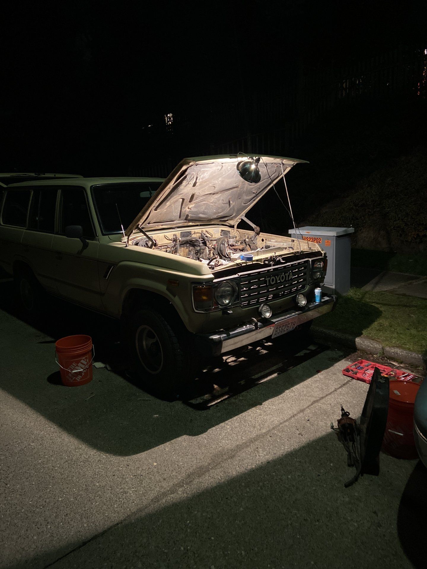

Tonight I removed the fan, fan shroud, distributor, and igniter. I also drained the oil from the engine and the last of the coolant in the oil cooler. My engine bay is absolutely filthy... I’m going to need to spend a couple of hours on there with simple green and a brush before I put the new engine in.

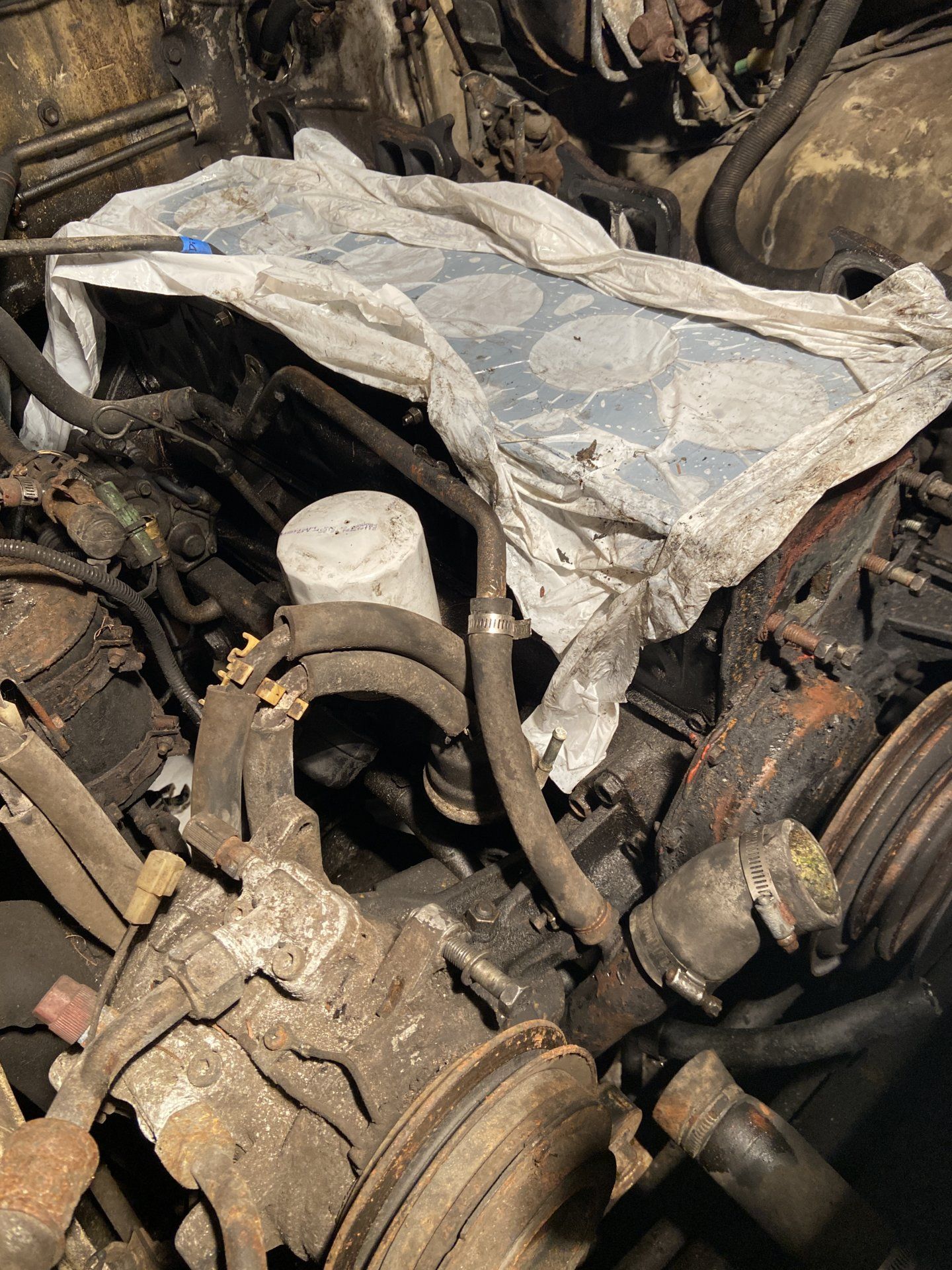

Do I have to remove the AC condenser in order to get the radiator out? Is it safe to remove the AC condenser/dryer/compressor if the system is depressurized?
Yes, just pull it all. The condenser won’t come until you’ve disconnected the compressor lines. Remember to double label all the hardware. A piece of paper in the bag and on the bag. Sometimes I’ll squirt the hardware in the bag too since it’ll be closed up for awhile. Lay it all out in a file box lid.

Yes, just pull it all. Remember to double label all the hardware. A piece of paper in the bag and on the bag.

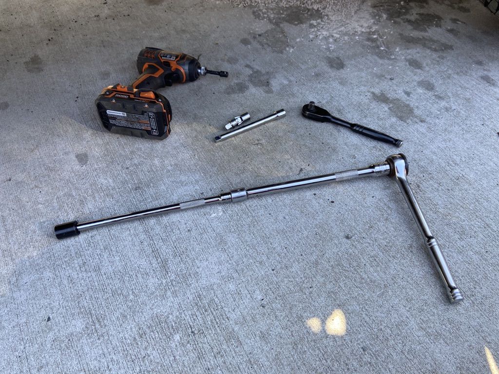

Also, I have a pro tip for anyone trying to unbolt the transmission without removing the front driveshaft or the transfer case. You want a long socket extension and a light! I was able to guide the extension onto the bolt by looking through the gap between the transmission and the front driveshaft. The lower of the two bolts came out relatively easily with an extension and a wobble.
