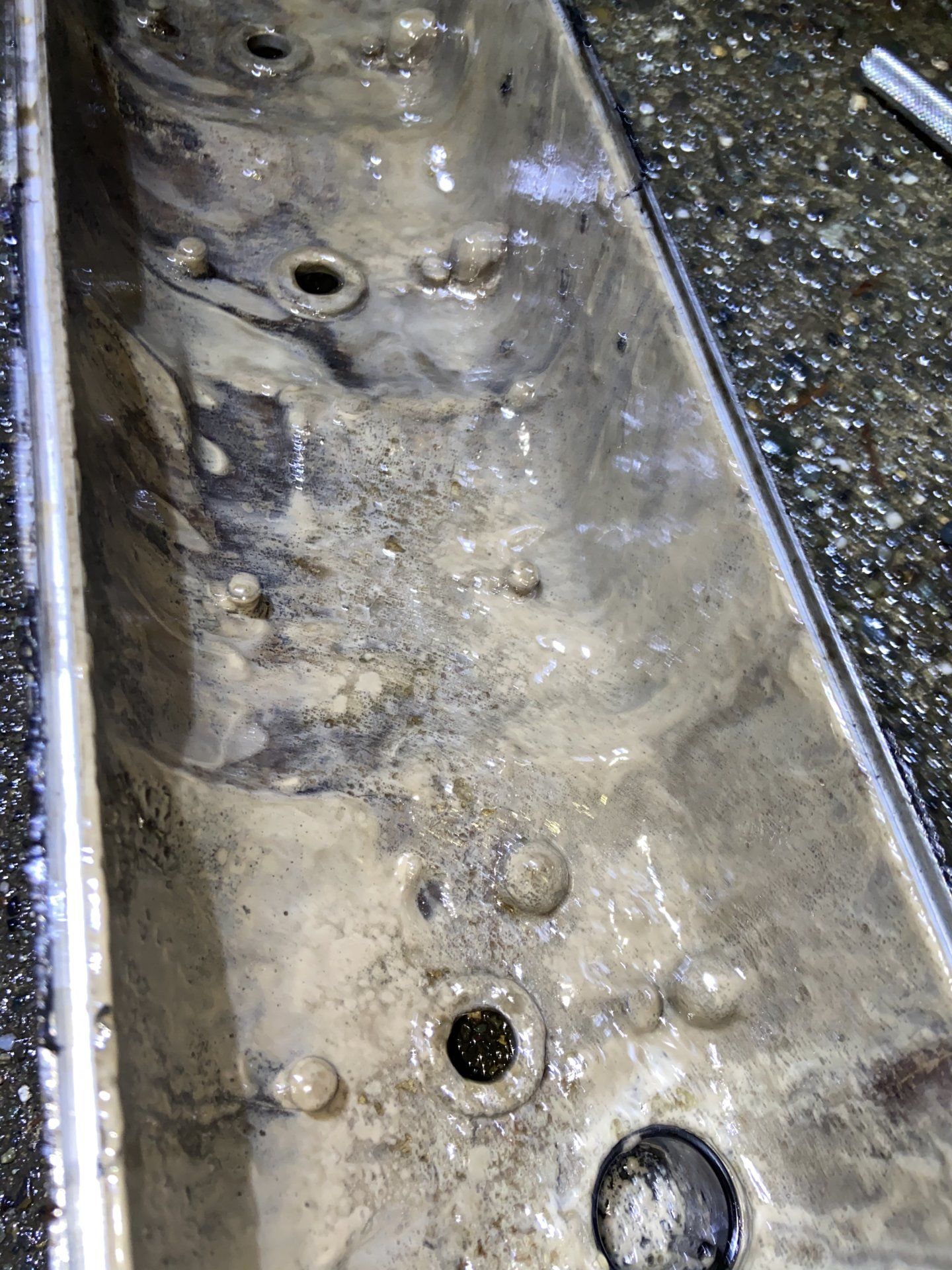

Welp, there’s the head gasket milkshake. Time for a head rebuild at a minimum.

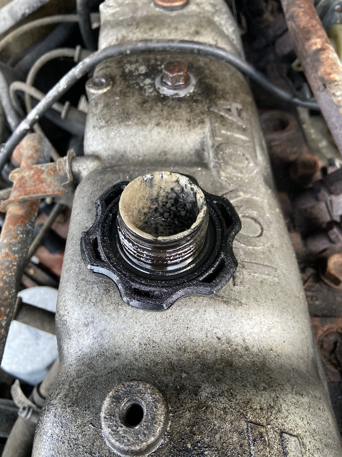

The tow truck left the car in front of a neighbor’s house on Sunday... how bad of an idea is it to start it up to move it 100 feet up the street? It’s bad... I know.

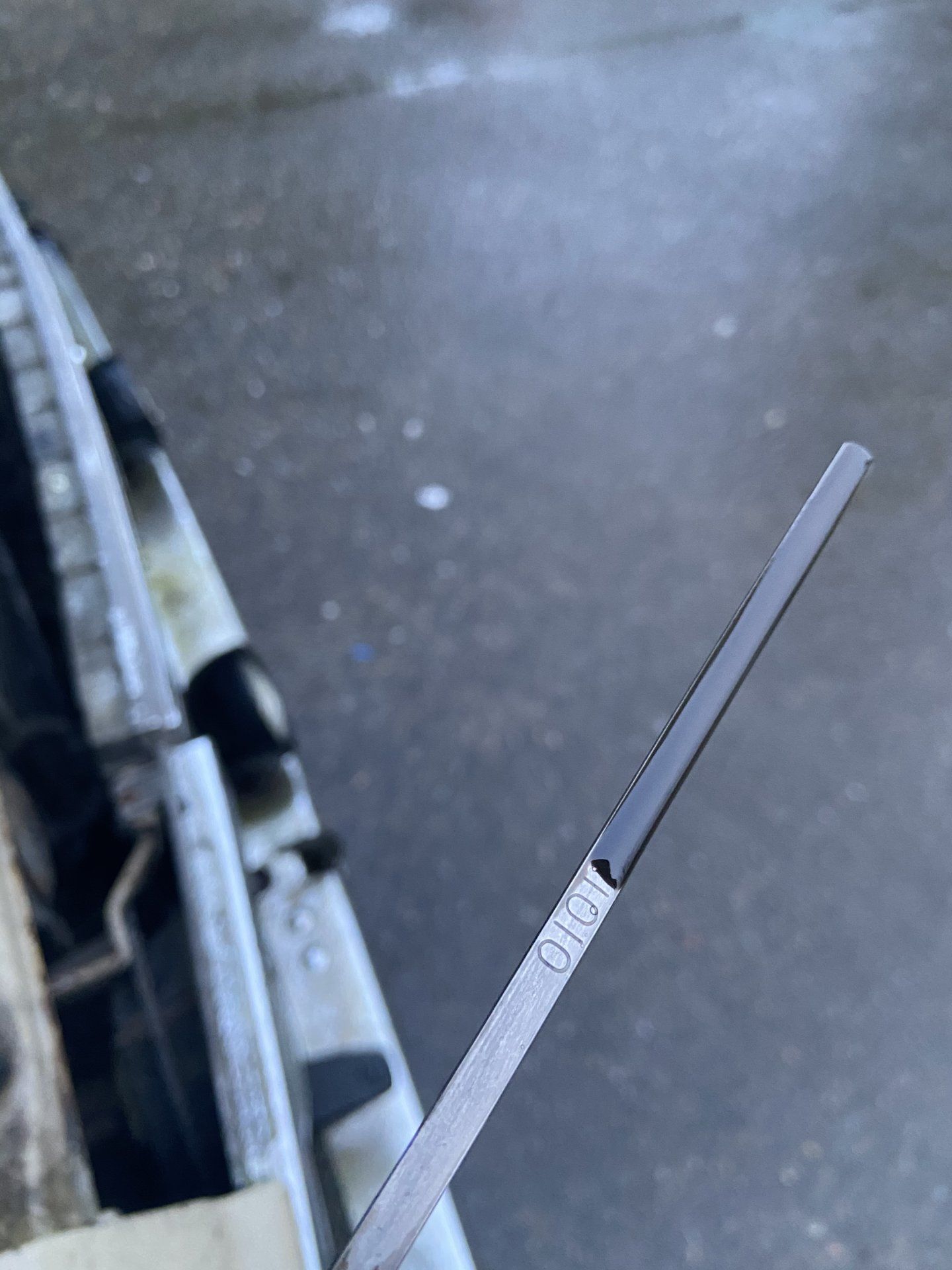

That's likely just condensation, see that a lot of vehicles that make short trips and don't get hot enough to burn it off. Now if the rest of the oil looks like that then that's another story.
So the oil actually looks really clean. I thought I’d try jumping the truck so I could move it down the street but it won’t jump. I think a mallet to the starter might do it but my arms are only so long. All the electronics come on and the engine turns and clicks but no start. Any ideas? I did try pumping the gas with the engine off to try to move fuel into the carb. I picked up a new fuel filter tonight thinking that might help me burn off the old gas without making the engine too unhappy but I haven’t gotten to that yet.

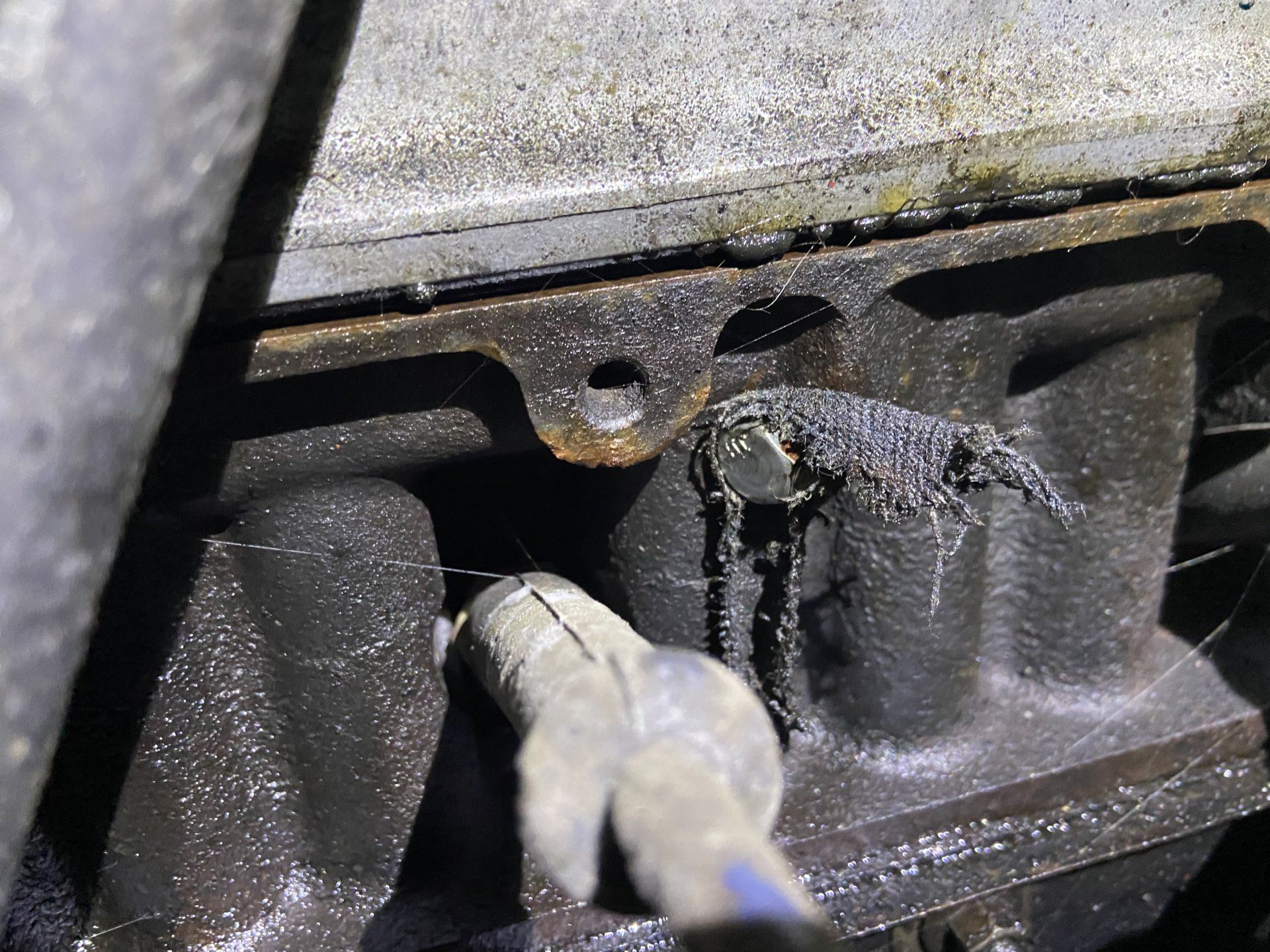

The PO mentioned that the engine may have been rebuilt at some stage. Obviously the HG blowing doesn’t really make that seem likely but... does this look like a fixed galley plug?
No. Not if you use the term "fixed" to mean "properly repaired" or "fixed in place" or "returned to a normal state" or even "properly cooked"
But hey.....on the bright side you need to have head work done anyway. Bring that to the machine shop's attention. First, search "galley plug" in this section and learn what that should look like in an ideal world.
Unfortunately, it is not uncommon to have blown head gaskets in the 2F. The cooling system is a little finicky. If it is drained of coolant and refilled by a mechanic that is unfamiliar with the engine, air can become trapped in the system and the gasket or head can suffer a failure. Usually the gasket goes and the head is fine.
