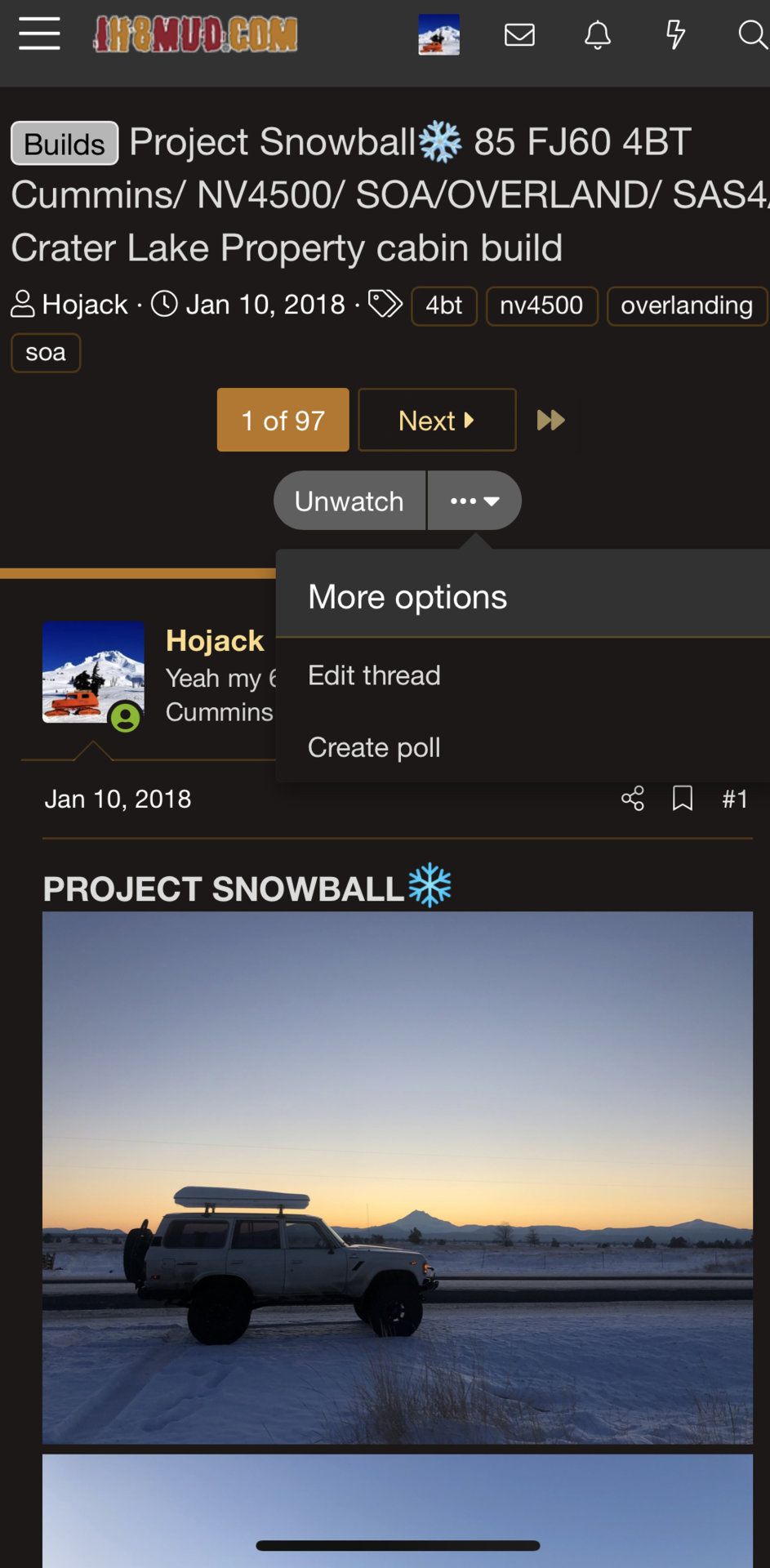

The edit button is no longer there. I see it on my more recent posts but not on the OP for this thread.
i just looked at one of my threads thats a couple years old and I'm still seeing this at the bottom:
Maybe try closing you browser and reloading?

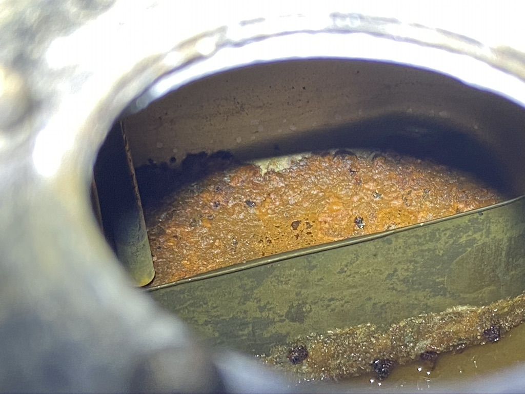

I've known that the gas tank was in rough shape for a while. After draining the gas (the now-famous "How to drain a full tank of gas" thread) I decided I'd remove the tank to evaluate and clean as well as possible. The attached photo is what I found... I called all over Seattle and could only find one shop (Performance Radiator in Tacoma) that would clean an auto gas tank but it would have taken 3-4 weeks. I'm not that patient so I pressure-washed it inside and out, used an 8-hour rust bath to burn some of the crud off, rinsed it with gasoline, and used a magnetic wand to clean up the larger bits that I could see. I'm really happy with how it turned out! The tank is now reinstalled and serving gas to the engine. I may still pick up a fully renewed tank at some point but if my fuel filters are looking good after a couple of months then I'll consider it money saved. I replaced the hard lines from the tank to the engine bay with the lines off @blbuck's truck and replaced the soft lines in the engine bay with freshies from Oreilly.
