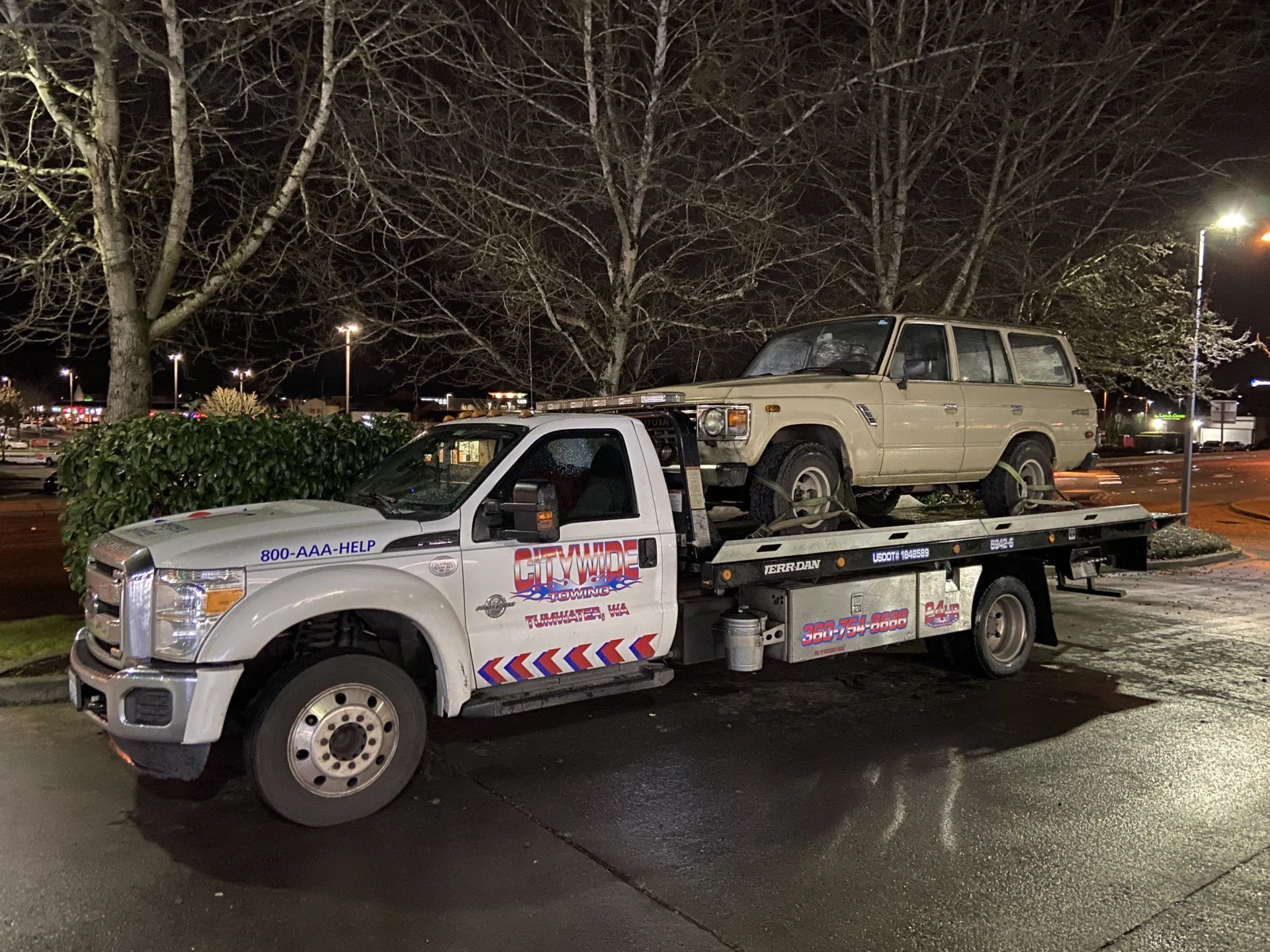

Today was interesting. The PO lives 70 miles south of me and I was ready to do the drive. My friend and I drove down, I signed the paperwork, I handed off the cash, and we turned to the road. The car started up fine but it put out a LOT of white smoke from the (abbreviated) exhaust. I still chalk this up to the bad fuel which I now regret not draining and replacing. I managed to stall it out very early on and… it needed a jump. Then the engine died when coming to a stop… another jump. PO said the battery was fully recharged so I think it’s toast.
The fuel gauge is broken so made our way to the nearest gas station to fill up. We left a lot of white smoke behind us the whole way there. At the gas station the car only took one gallon from the pump. In hindsight, this now means I have 24 gallons of contaminated fuel to drain and discard. We made it a few miles down the road to a red light immediately before the on-ramp to I-5 north. TWIST! This is when the PO pulled up next to me and, after rolling down windows, said “It looks like it’s running hot, I might recommend getting a tow.” The light turned green, I stupidly said something along the lines of “We’ll see!”, and pulled onto the interstate.
We made it 8 miles from the on-ramp. Other than a steering problem (random, hard pulls to the left) the truck was running smoothly at 55mph and 2500rpm. Then I noticed a pretty sudden loss of power. It wasn’t extreme… just enough to make me think I needed to shift down into third to get up the slope. That didn’t really help… then smoke came into the cab. Under the hood the carb was billowing white smoke and fluid was bubbling out of the top of the head cover.
This is getting long so I’ll finish this story quickly. A cop pushed the car to an off ramp, we went in search of a trailer, we gave up and paid for a tow (AAA helped), I rode home in the 60 on top of a flat bed, and finally the truck was dropped in front of a neighbor’s house so I tried to move it but… it needs a jump. That’ll happen tomorrow. Along with a good wash.

Yeah, white smoke and other issues are indicative of a blown head gasket or worse, like a cracked head. You should not drive this any further unless you willing to accept more permanent damage to your engine. Not to mention that its unsafe for you and other drivers around you. You should just factor in the cost of getting the truck back to your house safely back to your house with a tow into the purchase price.

You should not drive this any further unless you willing to accept more permanent damage to your engine. ... You should just factor in the cost of getting the truck back to your house safely back to your house with a tow into the purchase price.
Agreed, and done. It was towed home last night.
