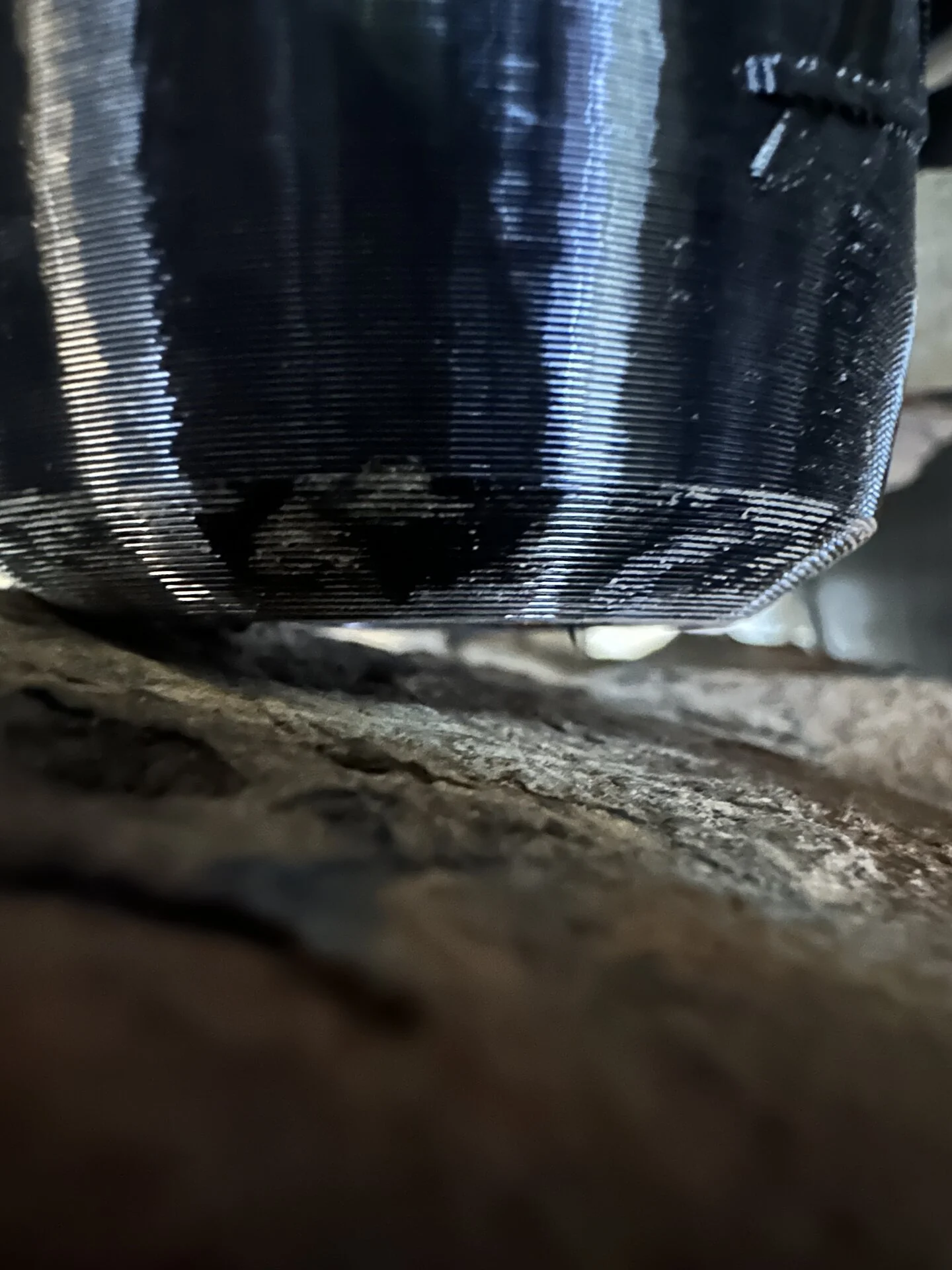

@PerryParts my driveway is sloped so I parked on level ground and cycled to neutral. Is this more or less clearance than expected?
It may have just been my driveway. 200 miles and no signs that they are permanently rubbing.
