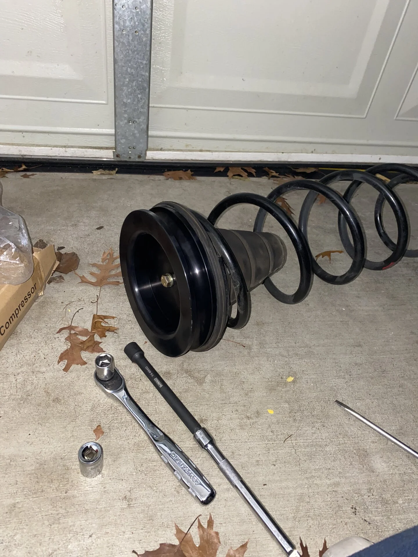

I think I would really enjoy a coil topper for the rear, I currently have the westcott preload spacers back there, and they are taking the place of the rubber cone.
An isolator there would be great since it now metal topper against metal bucket. I just don't have any out to measure...

Yes, photo from my build:
That piece is metal to the coil bucket top. Works and fits great, just not a fan of metal on metal, even if they are mated constantly.
Always wanted to address that. And now we have a nice polymer printer! Forgot to bug yall about this before.

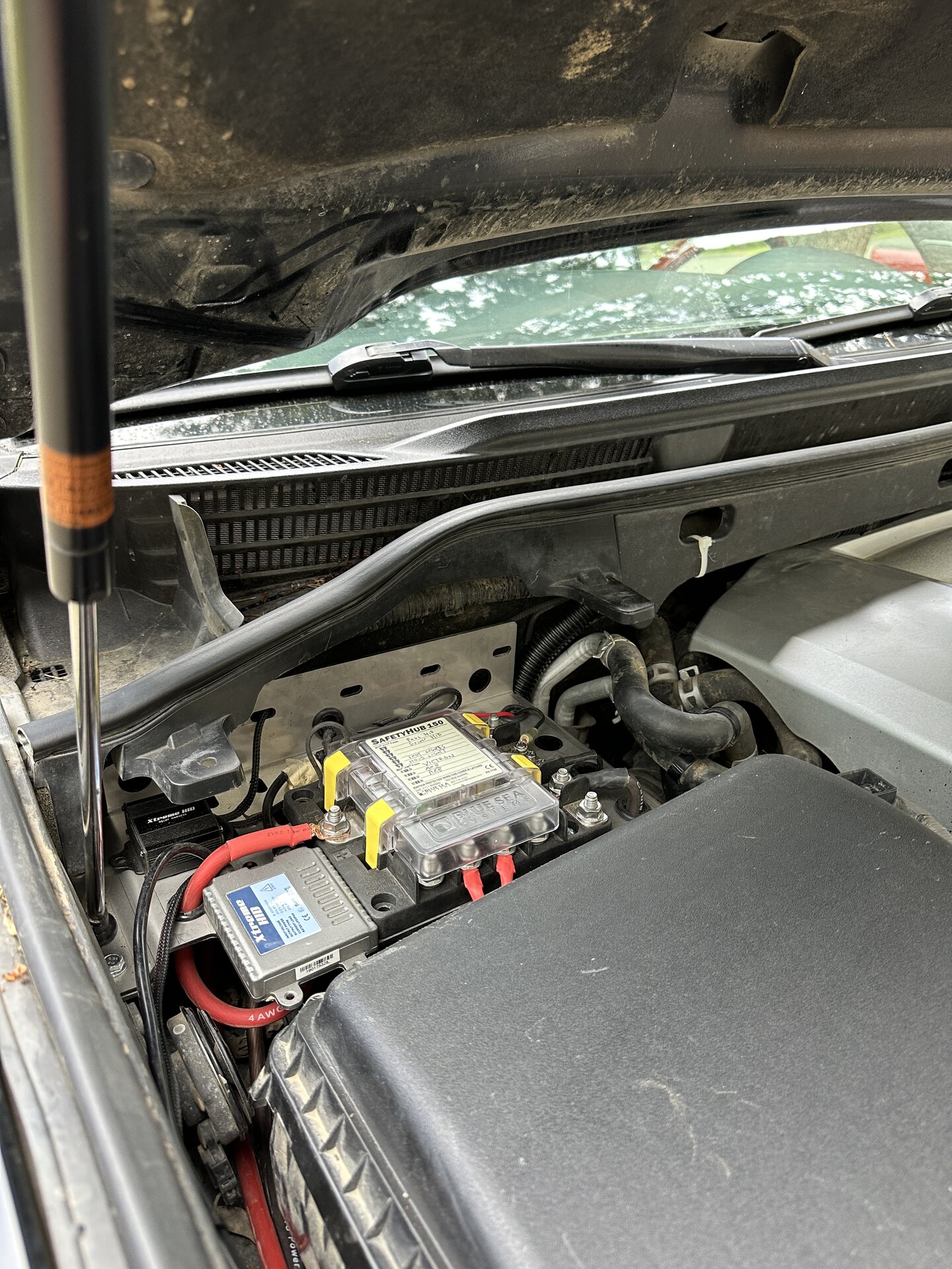

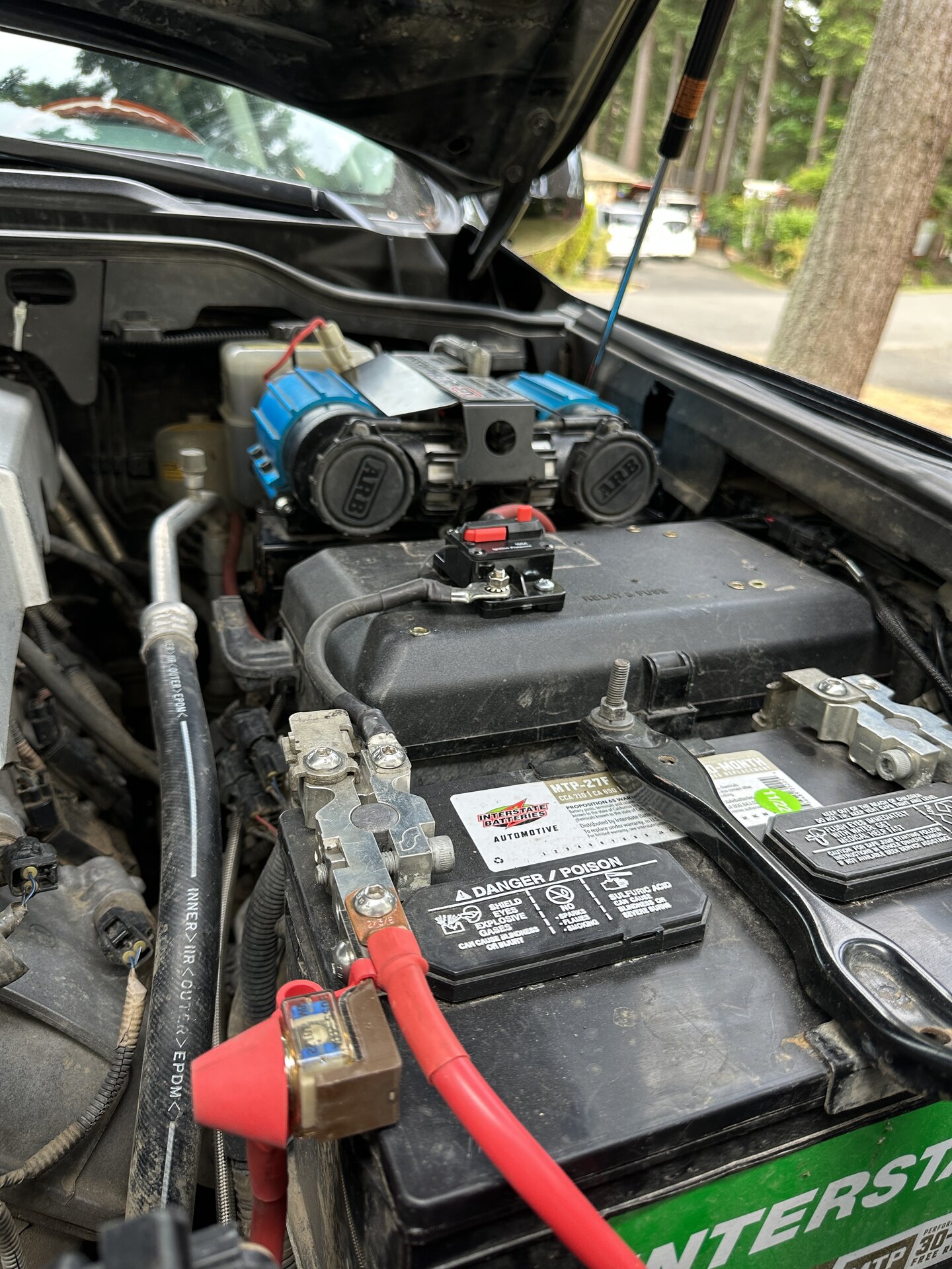

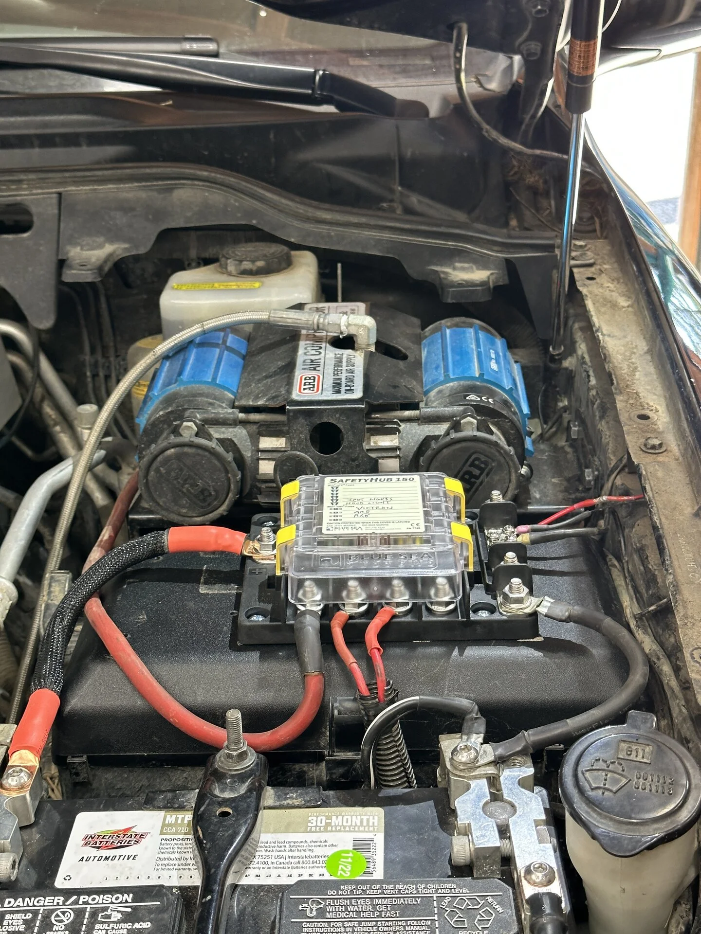

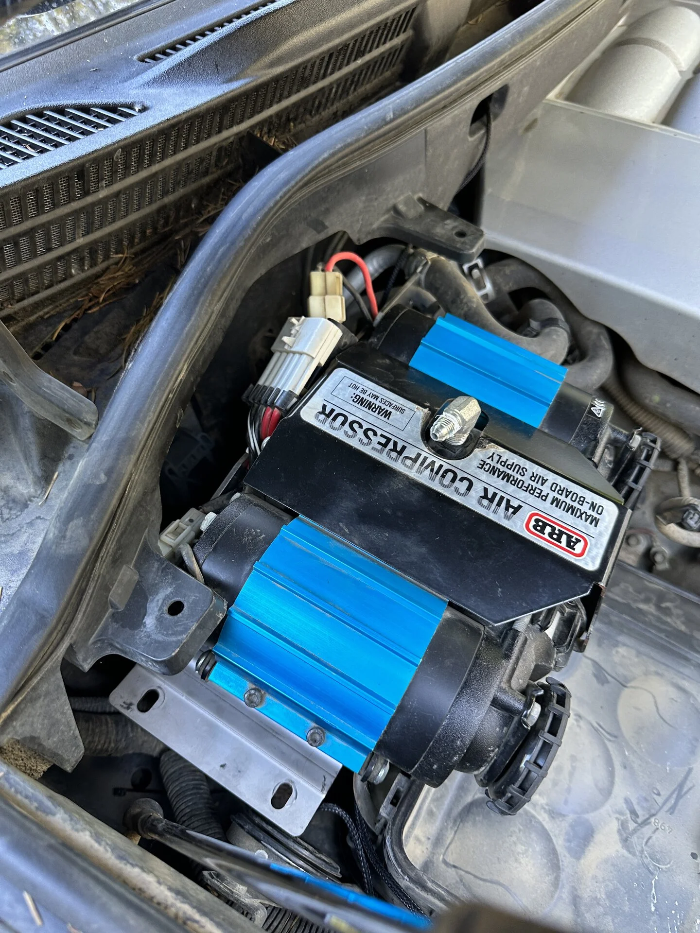

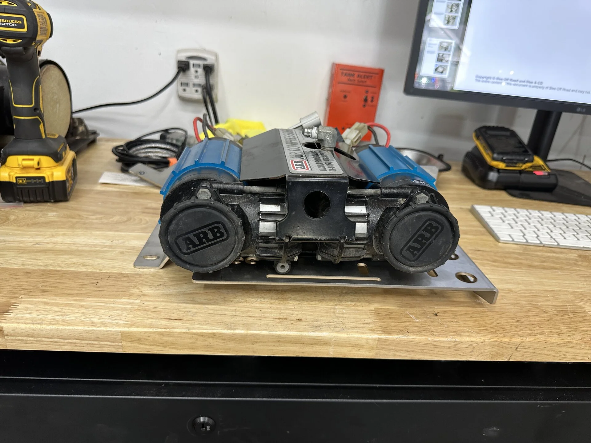

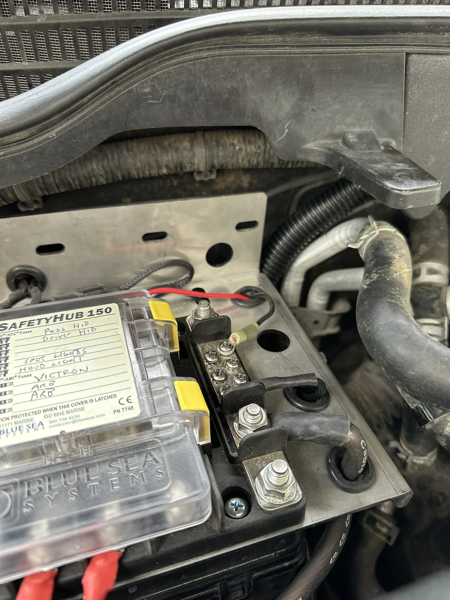

I picked up a passenger side Slee off-road accessory panel from @empty80 s couple if weeks ago and got to work iterating on my “front of house” accessory power.
I actually did a bunch of work here when switching out my SafetyHub 100 for SafetyHub 150:
This configuration works great but my biggest gripe is that it’s just crowded and while it’s never been an issue, I don’t like blocking the fuse panel cover.
One idea I had was to move the compressor to the passenger side to the slee Mount. While I could Mount the ARB to the bracket, I couldn’t make it fit under the hood without some serous modification of the under hood trim.
So instead I took the long route and moved all of my power accessories to passenger side.

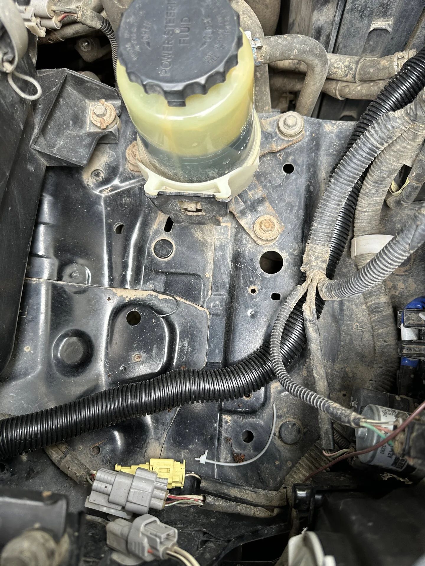

This was pretty straightforward but involved because I cleaned up a lot of prior mistakes along the way.
Another huge win was cleaning up the ARB twin harness. If you’ve seen these you know it’s a spider web because it’s prewired for power and lockers and pressure switch. If you just need a compressor, it’s literally just a purple wire.
I took extra care to loom everything to protect my power cables from abrasion and accidentally arcing against the body. I also made 15/16” grommets for the built in holes in the bracket. The power to the block goes in front of the radiator, the big wires to the compressor go around back.
I also added an Eaton 200 amp terminal fuse ahead of the SafetyHub—again trying to make sure any accidental grounding would get de-energized.
I still have a couple of things to wrap up
  • Replace the fuse panel cover
  • Pull new cable from the back of house for the DC charger. Right now it have it powered through a resettable breaker
  • The switch and or relay for my Ironman lights isn’t working. Rather than troubleshoot I just bought a new switch
View attachment 3344385View attachment 3344386
Looks like you spent a lot of time laying everything out and organizing, great work!

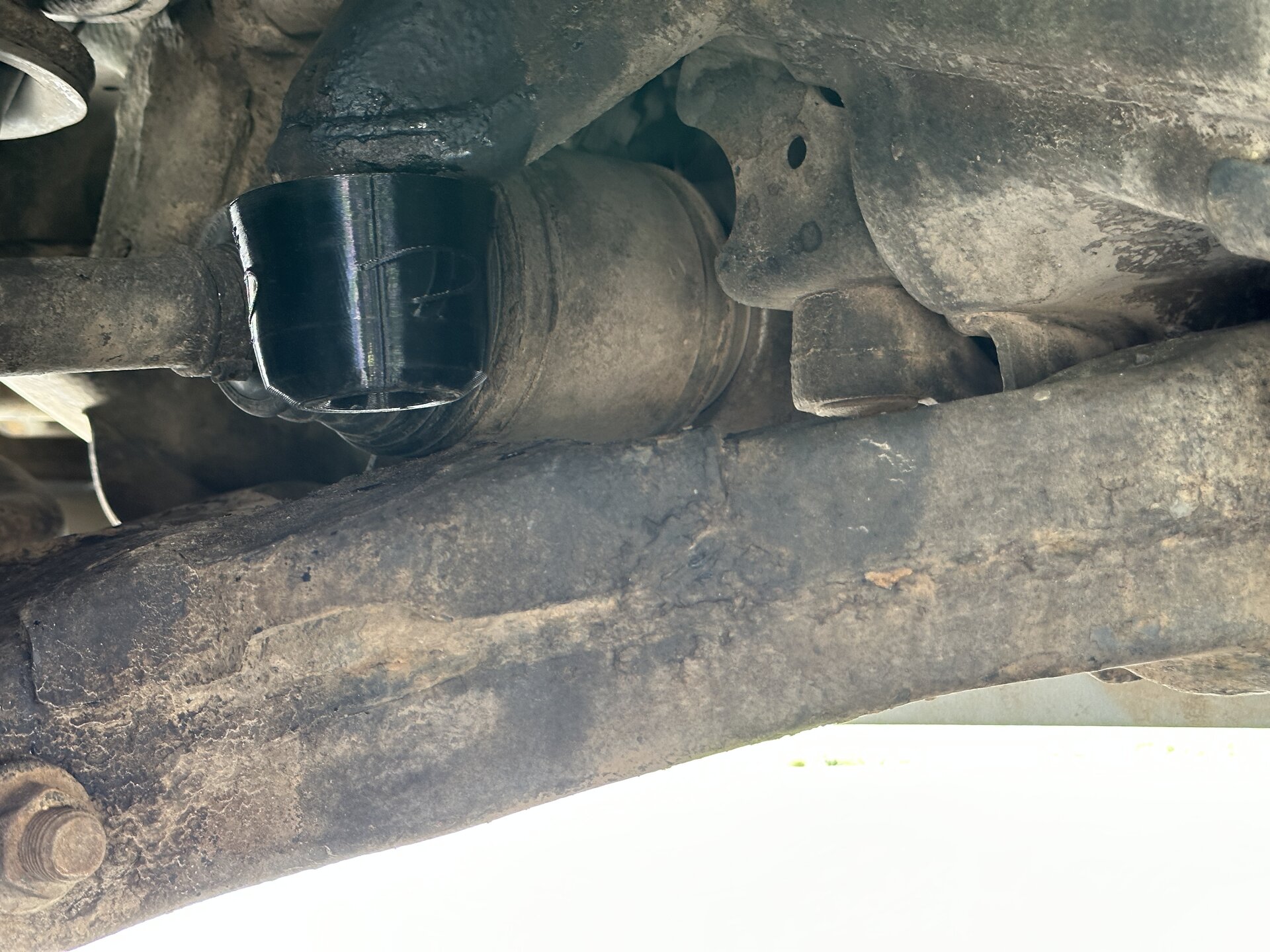

I finally found the issue—I sheared the driver side sway bar link. The thunking was the ball popping out of the link socket and hitting the bar itself
Did you need to strap the sway bar for installation? You think I need to strap my sway bar before i take my presumably broken one out to keep the bar nearby for easy hookup?
I didn’t. I just used a Jack under the skid plate to droop the front a little and it slide in and out.

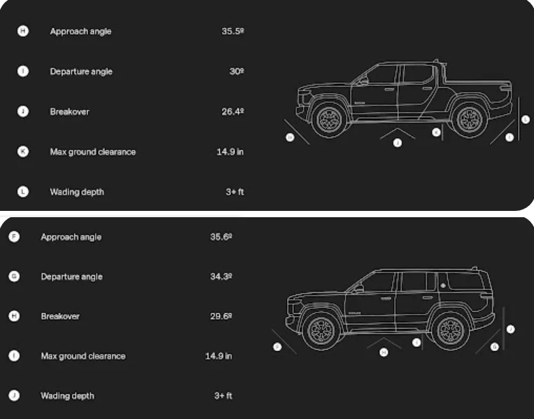

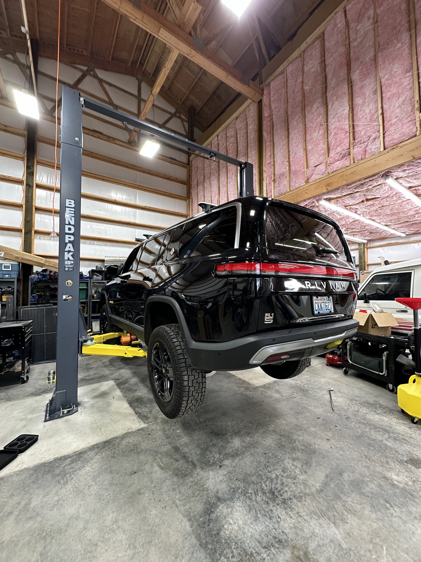

I've been spending lots of off-road time with my friends quad motor R1T. They go about wheeling differently, but these things are no joke. Better width compatible with more tight tracks. With the AT tires, will absolutely outwheel a stock 200-series. Partially because Toyota is too conservative to put real tires on it factory. The R1S should be even more formidable with better breakover and departure than the R1T.
Congrats on the new rig!! Mighty fine choice. It looks like you have the optional Pirelli ATs on her?
Yep it’s the quad motor adventure pack. The pirellis are okay. I’m going to accept the 3-5% range hit and put either KO3s or the new toyo at3 EV spec ATs once they come out.

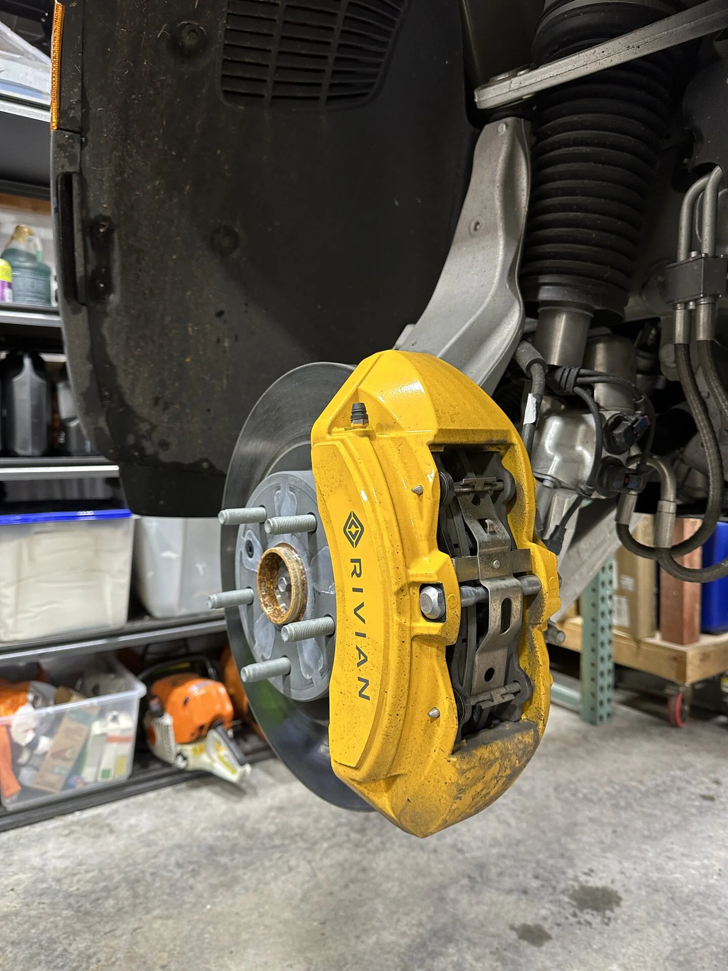

What’s actually bonkers is the droop travel it has. I got a good look at it when rotating the tires on my buddy’s lift.
The rear control arms, while IRS, are almost 50% of the width of the truck.
