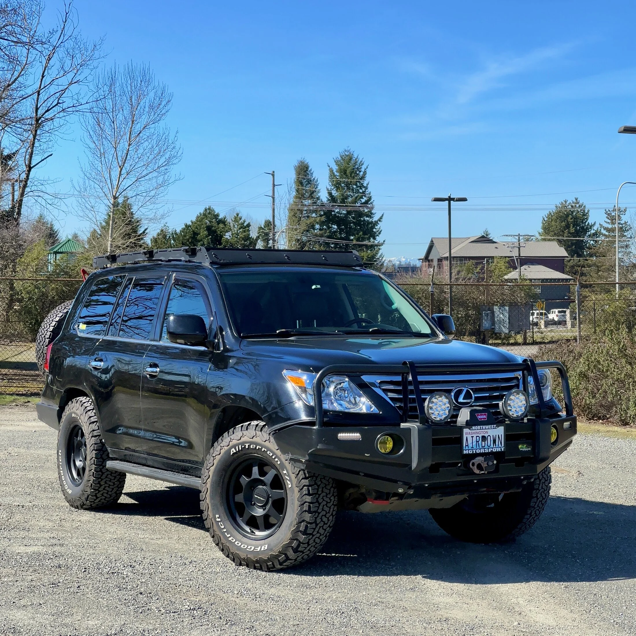

I'm working down my LCDC prep checklist and thought I would catch this thread up on what's gone down in last 6 months or so.
Full fat 35s
I let an alignment issue go for too long (and you know, not rotating tires basically ever) and ruined my front 2 Falken 295/70s so made the leap to full fat. I am an absolute KO2 sh**-talker but I can't deny how timeless they look laces out. So I sold out and went for it. They are honestly great tires so far. I've had a few snow trips and performance was excellent. No appreciable differences going with a tire that was a full 1.25" wider.

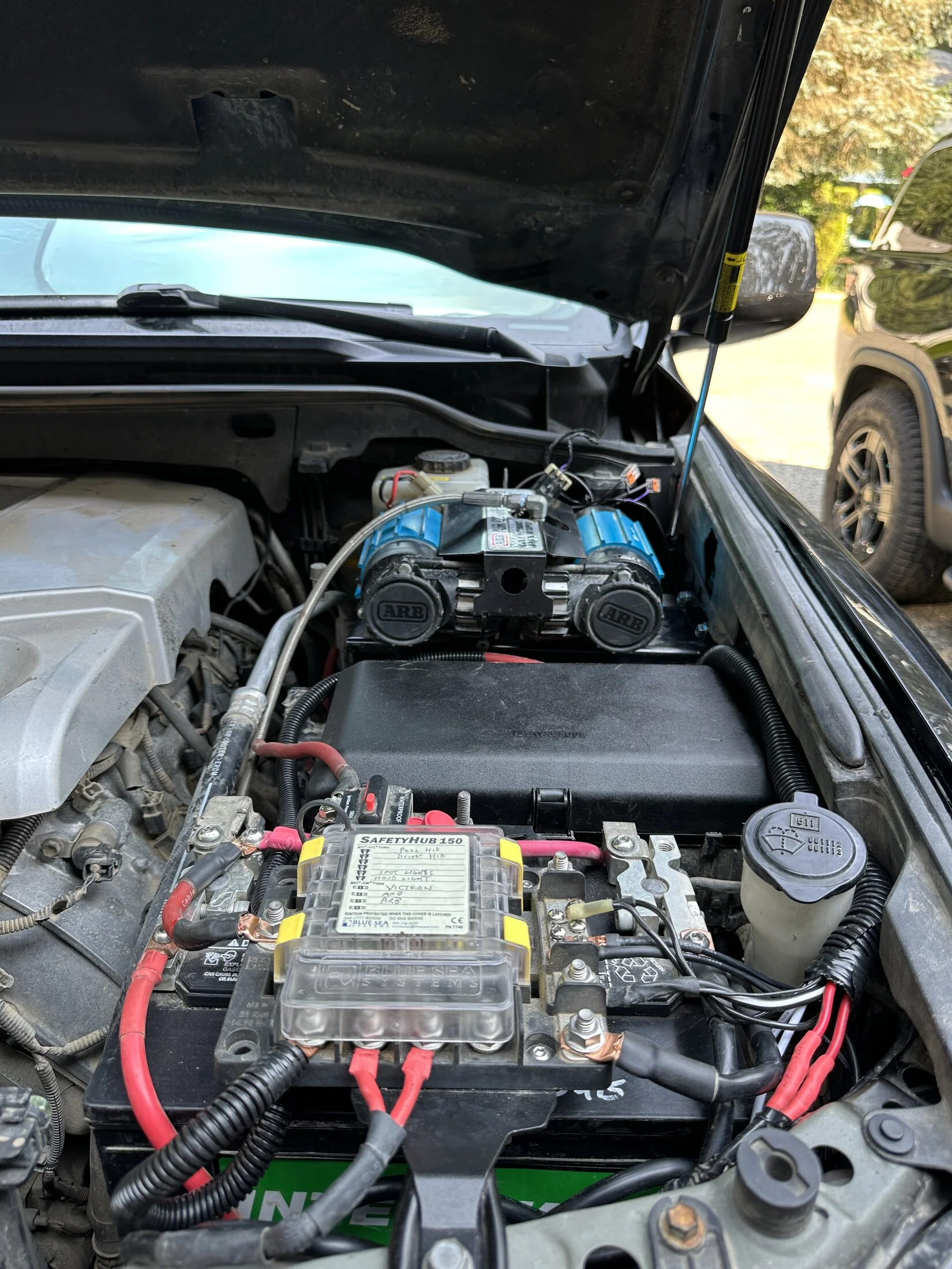

I have most of my electrical accessories running through a BlueSea SafetHub 150 on the passenger side on a Slee mount but do have 1 resettable breaker running to my rear DC/DC charger. I usually just 3M tape it down but wanted something cleaner. KAON makes an amazing solution for this:
Thanks to the careful eyes of this forum, it was noted that I have this installed incorrectly. It slides on top of tie down, not replaces it. I of course tossed my factory tie down so had to eBay a new one. Fully intend on installing it the right way :P

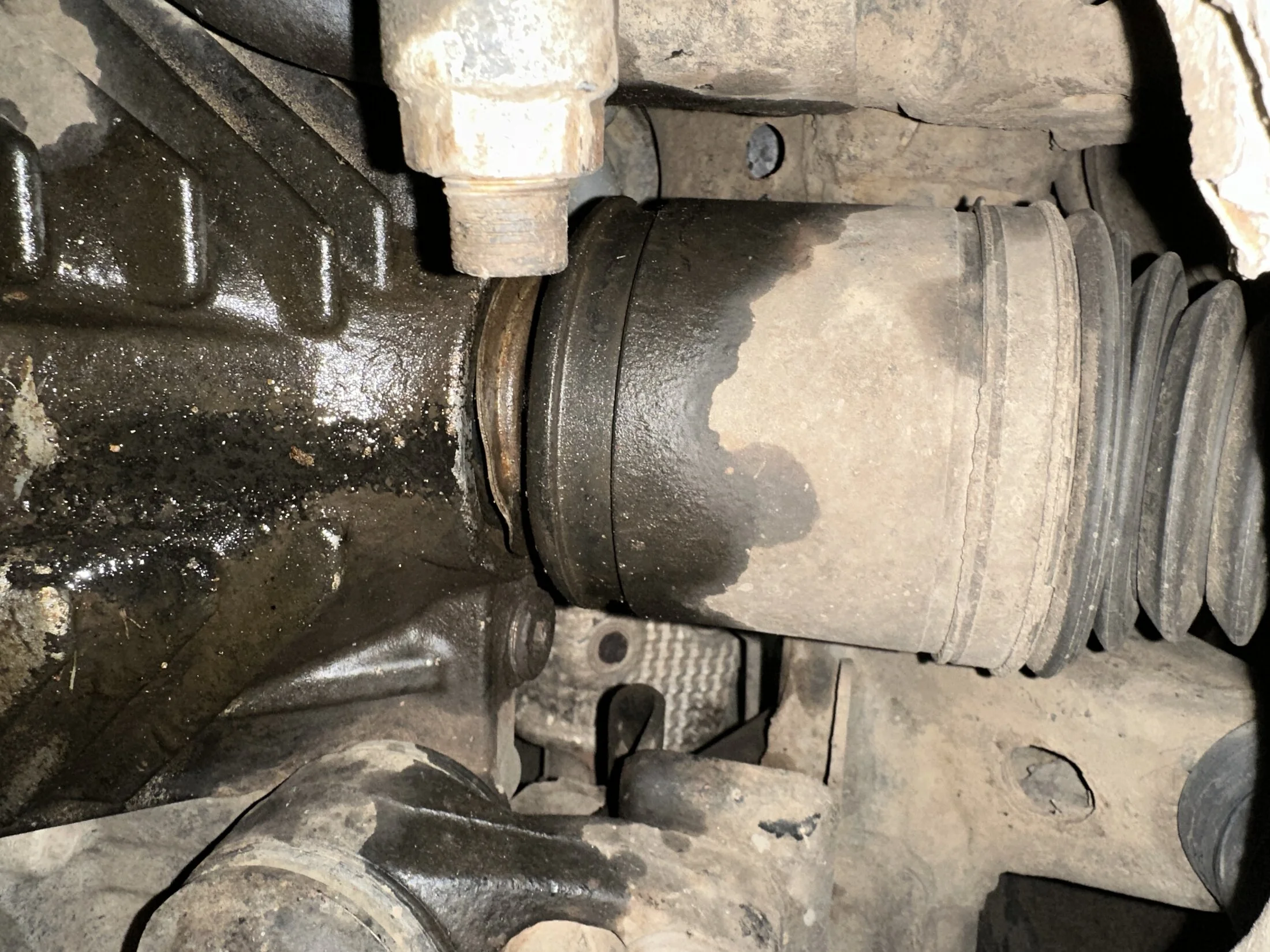

Axle seal issue
The shop I used removed driver side CV to slide the rack out which was fine, but they absolutely mangled the CV dust shield and axle seal in the process. I drove around a few thousand miles until I changed the oil and found gear oil absolutely everywhere. I admittedly panicked about it and sent the truck back. Diff fluid was glitter free and an axle seal did the job. I'm still a little skeptical at this point and carrying a spare axle with me to Ouray.

I had a couple of minor electrical issues in Ouray this month
  • One (and subsequently both) of my Xenon Depot HID ballasts failed
  • My ARB dual compressor was super flakey—only one bank worked most of the trip (ended up being a worn harness)
So I spent a good few hours in the parking lot of my hotel and the auto parts store in Montrose troubleshooting. Ultimately I was able to get sorted but boy was my electrical setup a pain in terms of troubleshooting and just moving stuff out of the way.

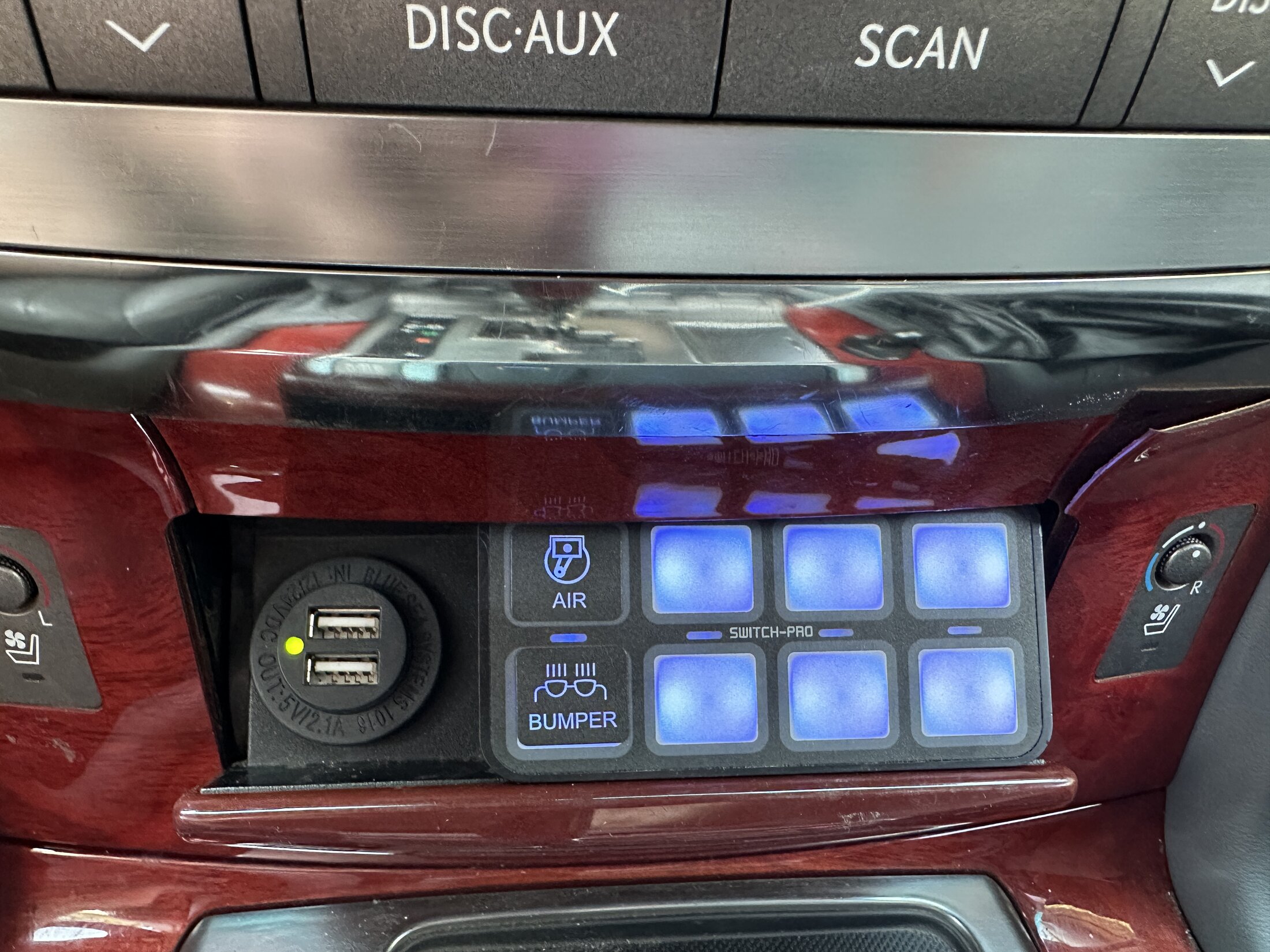

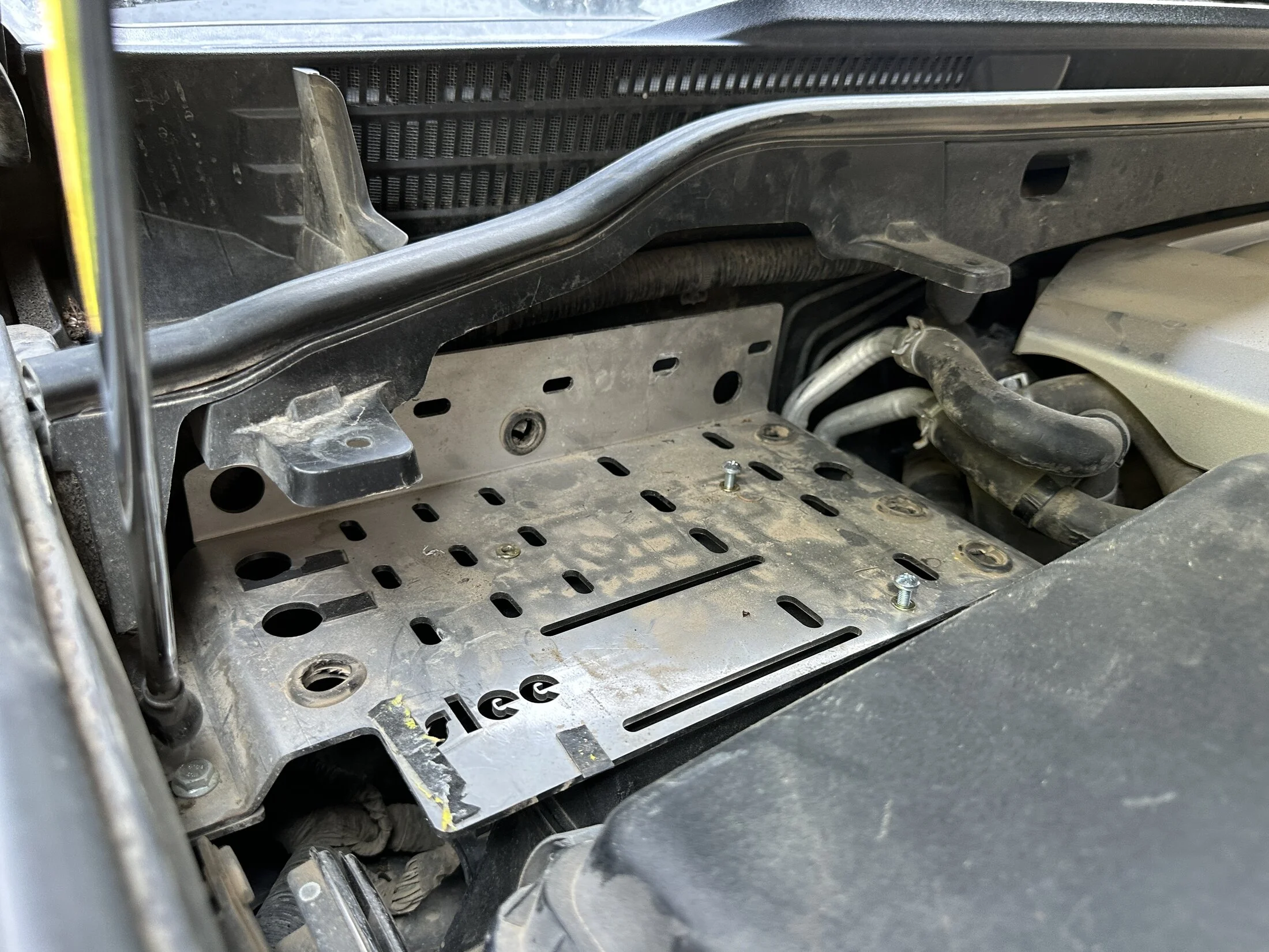

So this week I finally jumped into this century and ordered a Switch-Pro 9100 and a Slee Mount.
Installing the Switch-Pro itself is maybe a 🍌 or 🍌🍌 job but I ran into a couple of setbacks.

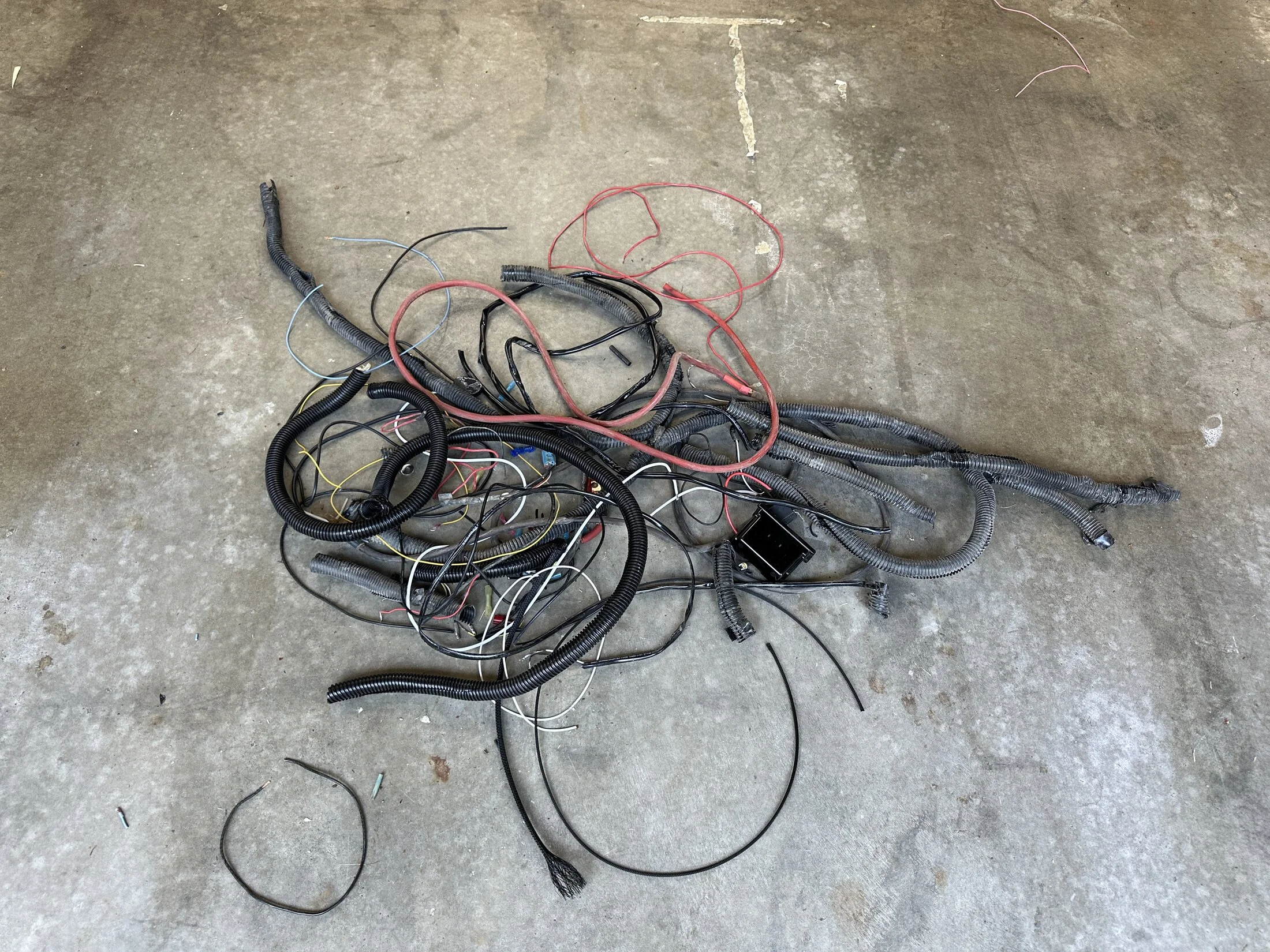

The best part first—look at all of the stuff I got rid of. And I got an empty accessory panel with room for activities:
Once I got everything out of the way I started mocking up how I wanted things including pulling the switch harness through the firewall, lugging new power cables, and moving my BlueSea 150 to my new Kaon battery tray.
When I went to start the truck, the dash lit up like a Christmas tree and throwing codes: P0102, P1613, P1614, C1201.
The truck was running like garbage but I tried to use Carista to reset the codes. No dice. So then I thought maybe it was just a dead battery so I stuck it on the fast charger—still didn’t fix it.
What was weird was that one of the codes was a secondary air injection code so I went down the rabbit hole and found this:
SAI codes after installing the slee first gen ARB compressor mount. Bingo, has to be it. So I slept on it and came back and pulled the connectors for the SAI relays to inspect them for abrasion or a short and the honestly all looked perfect except one of the connectors was a few mm pulled out. I also tried resetting codes, leaving battery disconnected etc.
I was just about to hit purchase on the Hewitt bypass kit when I went and double checked the fuse I was using to trigger ignition on the Switch-Pro and bingo—it was blown. For reference this is the 7.5A fuel injection fuse.
I tried starting the truck and it ran better but when I reset the codes it sputtered and died and they came back. I tried to reset one more time with IGN on but truck off and that did the trick.
So I think my issue was two fold
  • SAI connector was legitimately loose—I likely dislodged it removing the connector
  • And of course the blown 7.5A fuse
That whole process set me back almost a half day. Once resolved I got back to work.

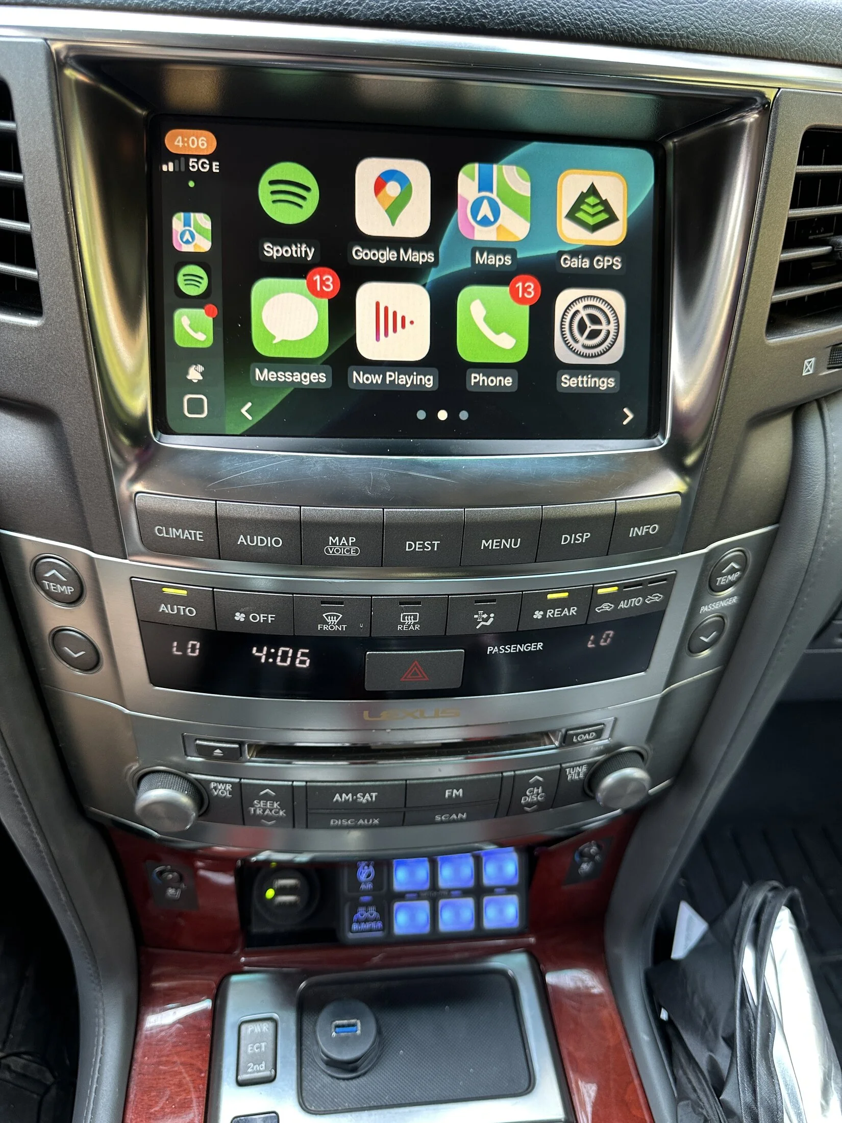

I tucked the controller in the cubby where the ash tray goes. It’s got 4 dabs of gorilla glue to hold it and the harness runs though an opening in back that used to have a light.
I’m only using two switches right now—one for my ARB and another for my 7” bumper lights. The next one I add will be to energize a 500amp solenoid for my winch.

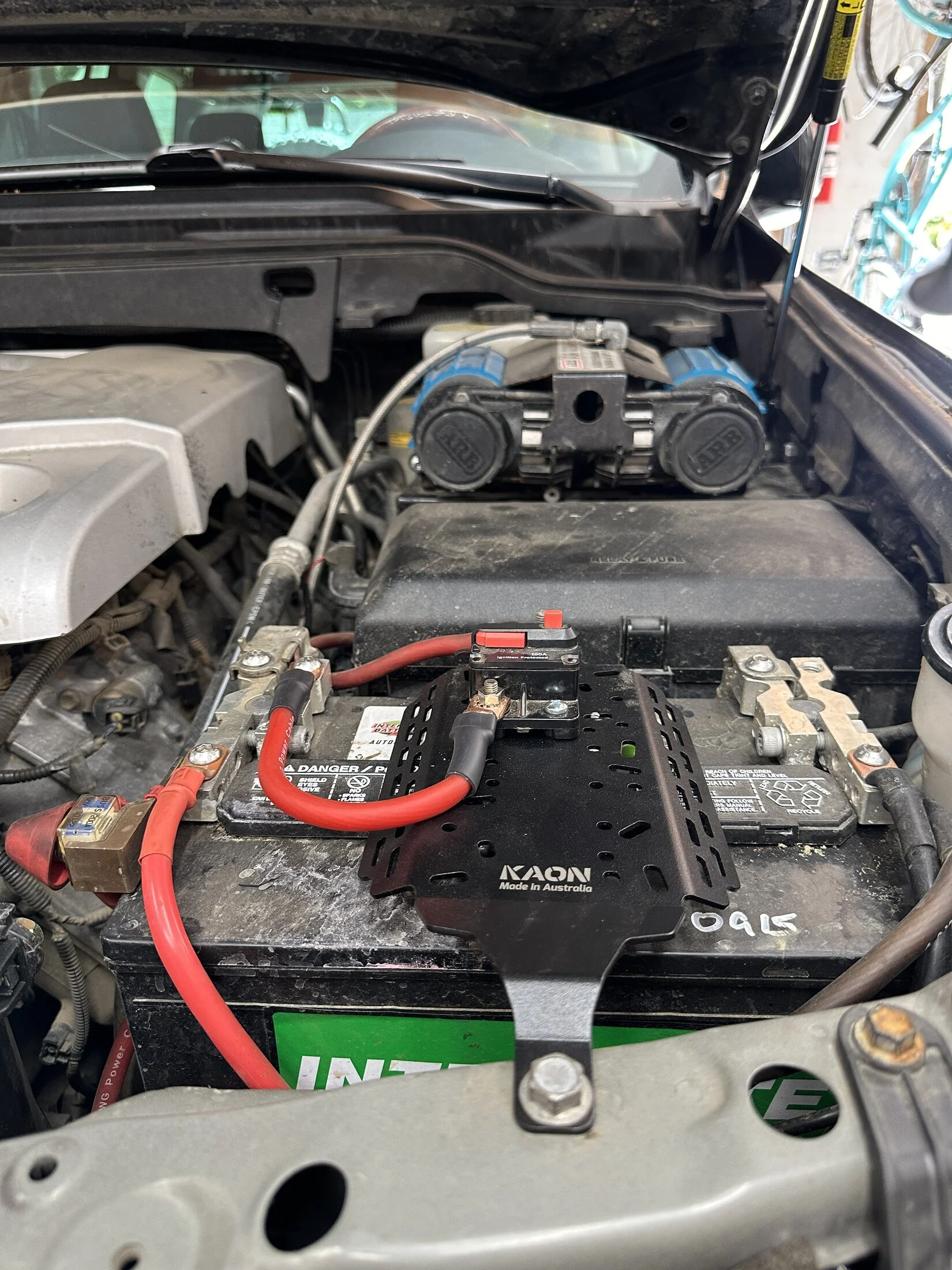

I’m about 90% happy with the setup underhood. I ran out of split loom and lugs and patience so plan to continue to refine once my solenoid comes in.
BTW there isn’t much to see with the Switch-Pro itself. The slee mount shares the bolt holes with the ARB mount so it’s more or less hidden under there.
solid.
nice job fitting the controller into the ash tray!
Nice! Good clean job! 👍🏼

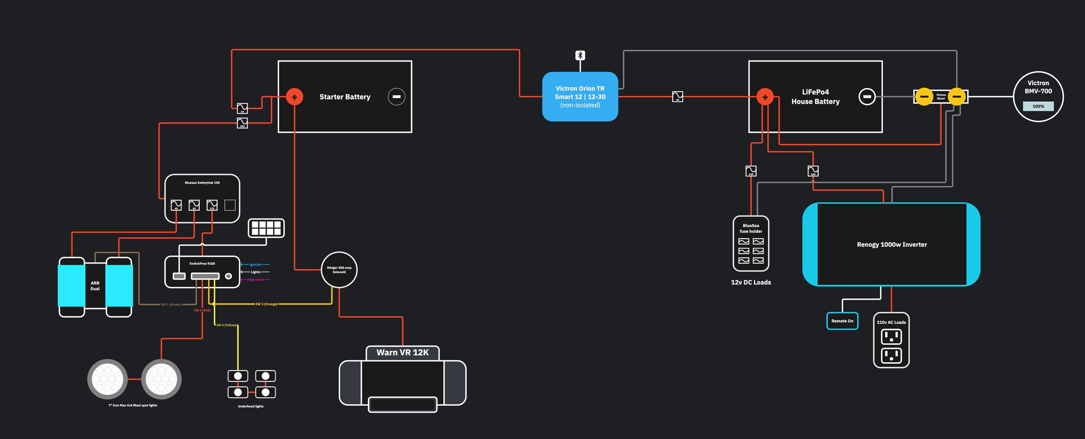

I’m trying to think through my house battery setup and what circuits I’ll put on the house battery and what will remain on starter battery and how I’m going to switch stuff. I love other peoples build threads because they are helpful in thinking things through.
I like my hard wired, old school, dash mounted switches for my compressor and lockers so im not going to change that but the harness situation under the hood needs some cleanup. I like the switch pro but I wonder if it’s overkill if I only have fridge and camp lighting on the house battery. I’m also thinking about putting light bar and or future satei or other fog lights on the house battery. If I do that then having a clean switch interface like switch pro seems appealing. Is your intent to put everything on the switch pro?
Everything that I’d want at camp, or to run 24/7 goes to my lithium out back. Everything else would be switch pro or direct to battery (like winch power, DC/DC charger etc.)
From Switch Pro I have
ARB compressor trigger
7” spots (direct, no relay)
Winch solenoid (future)
Lockers (future)
From my SafetyHub 150 I have
40 amp to each side of ARB
125 amp to switch pro
60 amp to victron DC
From starter battery I have
Power to SafetyHub
Power to winch cutoff
From lithium house battery I have
1kw renogy inverter
Blue sea fuse holder
Various USB outlets
ARB fridge hard wire
Shunt and monitor
NOCO trickle charger
2024 wiring diagram

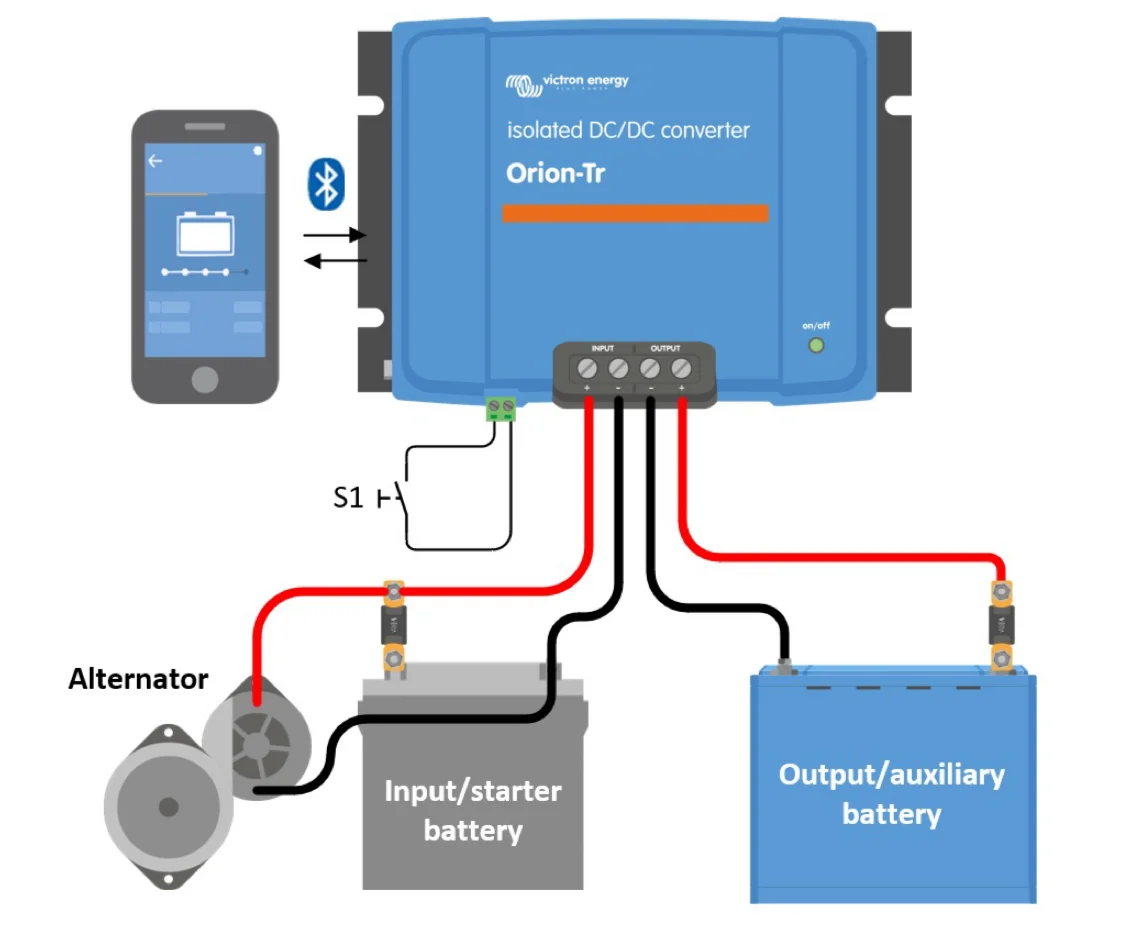

This is great! The only question I have is, why is there a 60amp fuse between the starter battery and Victron and another 60amp fuse between the Victron and house battery?
Because current can flow both ways. Victron recommends a fuse on both sides of the charger as well.
